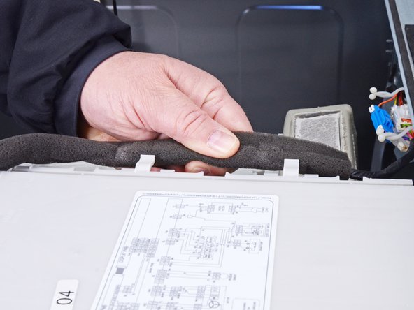

  3. LG Front Load Washing Machine Detergent Dispenser Replacement, Remove the top panel: crwdns2935265:03crwdnd2935265:01crwdnd2935265:02crwdne2935265:0 LG Front Load Washing Machine Detergent Dispenser Replacement, Remove the top panel: crwdns2935265:03crwdnd2935265:02crwdnd2935265:02crwdne2935265:0
    • Slide the top panel towards the rear of the device to disconnect its clips.
  4. LG Front Load Washing Machine Detergent Dispenser Replacement: crwdns2935265:04crwdnd2935265:01crwdnd2935265:02crwdne2935265:0 LG Front Load Washing Machine Detergent Dispenser Replacement: crwdns2935265:04crwdnd2935265:02crwdnd2935265:02crwdne2935265:0
    • Tilt the top panel upward to completely disconnect it from the chassis.
    • Remove the top panel.

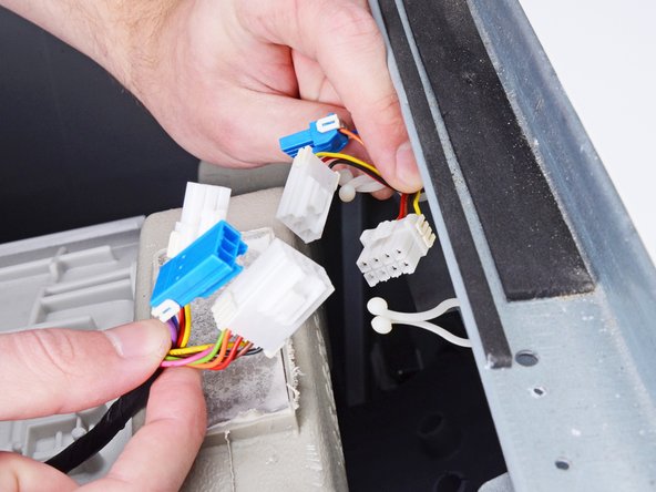

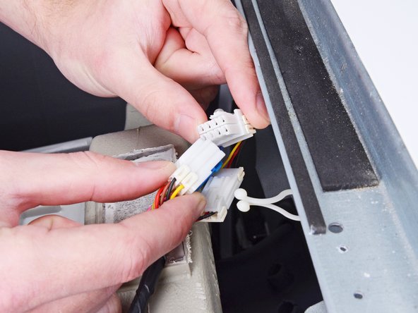

  7. LG Front Load Washing Machine Detergent Dispenser Replacement, Disconnect the control panel: crwdns2935265:07crwdnd2935265:01crwdnd2935265:03crwdne2935265:0 LG Front Load Washing Machine Detergent Dispenser Replacement, Disconnect the control panel: crwdns2935265:07crwdnd2935265:02crwdnd2935265:03crwdne2935265:0 LG Front Load Washing Machine Detergent Dispenser Replacement, Disconnect the control panel: crwdns2935265:07crwdnd2935265:03crwdnd2935265:03crwdne2935265:0
    • Disconnect the connectors attached to the control panel.
    • Always grip cables by their connectors and not the wires themselves.

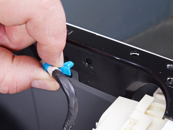

  8. LG Front Load Washing Machine Detergent Dispenser Replacement, Unclip the control panel cable: crwdns2935265:08crwdnd2935265:01crwdnd2935265:03crwdne2935265:0 LG Front Load Washing Machine Detergent Dispenser Replacement, Unclip the control panel cable: crwdns2935265:08crwdnd2935265:02crwdnd2935265:03crwdne2935265:0 LG Front Load Washing Machine Detergent Dispenser Replacement, Unclip the control panel cable: crwdns2935265:08crwdnd2935265:03crwdnd2935265:03crwdne2935265:0
    • Unclip any connections the control panel cable has to the chassis or other components.

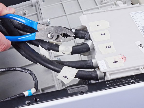

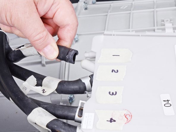

  9. LG Front Load Washing Machine Detergent Dispenser Replacement, Detergent dispenser hose information: crwdns2935265:09crwdnd2935265:01crwdnd2935265:01crwdne2935265:0
    • To prevent confusion, label each detergent hose and its corresponding dispenser connection.
    • You can use masking tape or mark the components themselves.
  10. LG Front Load Washing Machine Detergent Dispenser Replacement: crwdns2935265:010crwdnd2935265:01crwdnd2935265:02crwdne2935265:0 LG Front Load Washing Machine Detergent Dispenser Replacement: crwdns2935265:010crwdnd2935265:02crwdnd2935265:02crwdne2935265:0
    • Use slip joint pliers to pinch the detergent dispenser hose clamp and pull it away from the assembly.
  11. LG Front Load Washing Machine Detergent Dispenser Replacement: crwdns2935265:011crwdnd2935265:01crwdnd2935265:02crwdne2935265:0 LG Front Load Washing Machine Detergent Dispenser Replacement: crwdns2935265:011crwdnd2935265:02crwdnd2935265:02crwdne2935265:0
    • Use slip joint pliers to gently rotate the detergent dispenser hose back and forth around its connection and loosen it.
  12. LG Front Load Washing Machine Detergent Dispenser Replacement: crwdns2935265:012crwdnd2935265:01crwdnd2935265:02crwdne2935265:0 LG Front Load Washing Machine Detergent Dispenser Replacement: crwdns2935265:012crwdnd2935265:02crwdnd2935265:02crwdne2935265:0
    • Pull the detergent dispenser hose straight off its connection on the assembly.
    • Repeat the loosening and removal procedure for each hose.

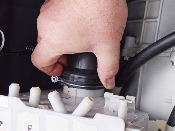

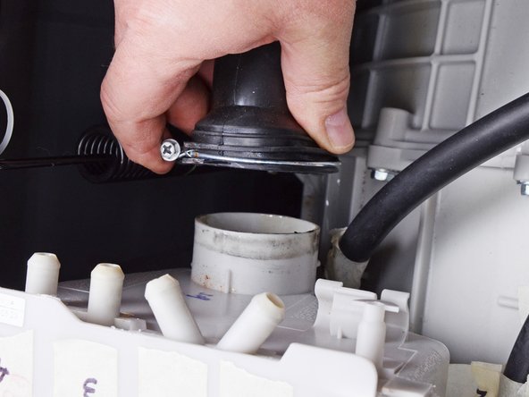

  13. LG Front Load Washing Machine Detergent Dispenser Replacement, Disconnect the dispenser: crwdns2935265:013crwdnd2935265:01crwdnd2935265:03crwdne2935265:0 LG Front Load Washing Machine Detergent Dispenser Replacement, Disconnect the dispenser: crwdns2935265:013crwdnd2935265:02crwdnd2935265:03crwdne2935265:0 LG Front Load Washing Machine Detergent Dispenser Replacement, Disconnect the dispenser: crwdns2935265:013crwdnd2935265:03crwdnd2935265:03crwdne2935265:0
    • Loosen any fasteners securing the bellows to the detergent dispenser.
    • Pull the bellows straight off its connection on the dispenser to disconnect it.
