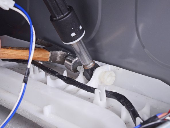

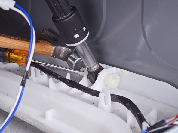

  30. LG Front Load Washing Machine Dampers Replacement, Disconnect the plastic pins: crwdns2935265:030crwdnd2935265:01crwdnd2935265:03crwdne2935265:0 LG Front Load Washing Machine Dampers Replacement, Disconnect the plastic pins: crwdns2935265:030crwdnd2935265:02crwdnd2935265:03crwdne2935265:0 LG Front Load Washing Machine Dampers Replacement, Disconnect the plastic pins: crwdns2935265:030crwdnd2935265:03crwdnd2935265:03crwdne2935265:0
    • Depending on your repair, you might need to access the dampers from the rear, the front, or both ends of the device. Choose whichever method works best for you.
    • Use a flathead screwdriver to press down on the tab securing the plastic pin.
    • You can also used an appropriately-sized box wrench to compress the pins.
    • Use a hammer to tap the pin out of its hole, still making sure the tab is compressed.
    • Repeat this procedure until the pin is loose enough to be removed with your hands.

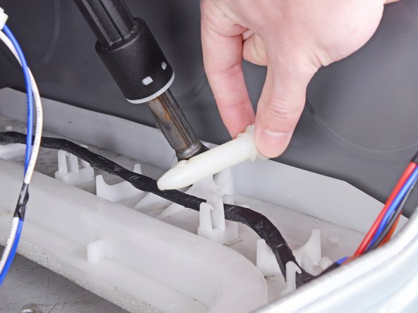

  31. LG Front Load Washing Machine Dampers Replacement, Remove the plastic pin: crwdns2935265:031crwdnd2935265:01crwdnd2935265:02crwdne2935265:0 LG Front Load Washing Machine Dampers Replacement, Remove the plastic pin: crwdns2935265:031crwdnd2935265:02crwdnd2935265:02crwdne2935265:0
    • Remove the plastic pin.
    • Repeat these two steps for the second pin on the damper.
    • If your replacement dampers don't come with new pins, apply silicone grease to the old pins during reassembly.

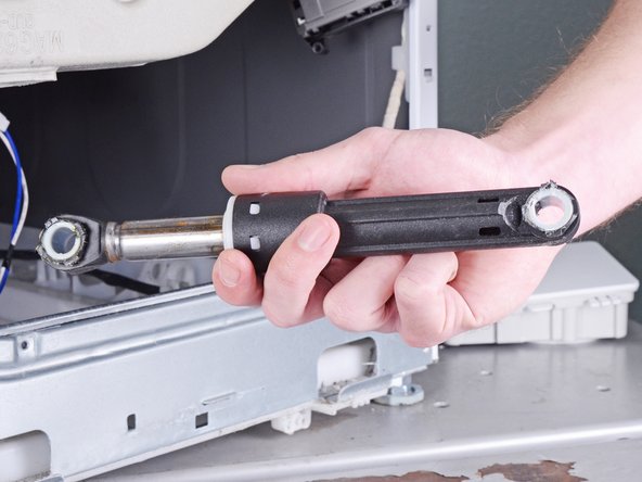

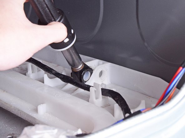

  32. LG Front Load Washing Machine Dampers Replacement, Remove the damper: crwdns2935265:032crwdnd2935265:01crwdnd2935265:03crwdne2935265:0 LG Front Load Washing Machine Dampers Replacement, Remove the damper: crwdns2935265:032crwdnd2935265:02crwdnd2935265:03crwdne2935265:0 LG Front Load Washing Machine Dampers Replacement, Remove the damper: crwdns2935265:032crwdnd2935265:03crwdnd2935265:03crwdne2935265:0
    • Slide the damper out of its slot in the chassis to disconnect it.
    • Remove the damper.
    • If you're having difficulty removing the damper, compress it to shorten its length.
    • Repeat the last two steps for each damper you want to replace.
