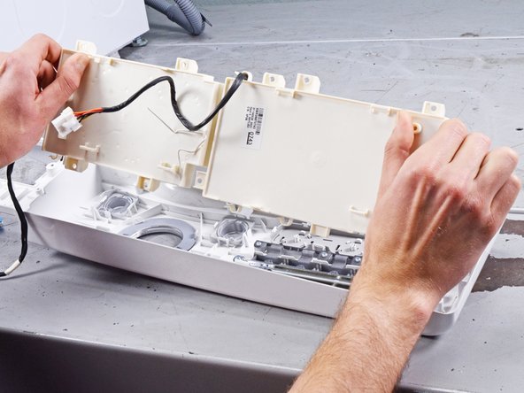

    4. LG Front Load Washing Machine Control Panel Replacement, Unclip the control panel: crwdns2935265:010crwdnd2935265:01crwdnd2935265:03crwdne2935265:0 LG Front Load Washing Machine Control Panel Replacement, Unclip the control panel: crwdns2935265:010crwdnd2935265:02crwdnd2935265:03crwdne2935265:0 LG Front Load Washing Machine Control Panel Replacement, Unclip the control panel: crwdns2935265:010crwdnd2935265:03crwdnd2935265:03crwdne2935265:0
      • Use a flathead screwdriver, or a pry tool, to unclip the control panel from the chassis.
    5. LG Front Load Washing Machine Control Panel Replacement, Remove the control panel: crwdns2935265:011crwdnd2935265:01crwdnd2935265:03crwdne2935265:0 LG Front Load Washing Machine Control Panel Replacement, Remove the control panel: crwdns2935265:011crwdnd2935265:02crwdnd2935265:03crwdne2935265:0 LG Front Load Washing Machine Control Panel Replacement, Remove the control panel: crwdns2935265:011crwdnd2935265:03crwdnd2935265:03crwdne2935265:0
      • Remove the control panel, making sure to thread any cables through the chassis.

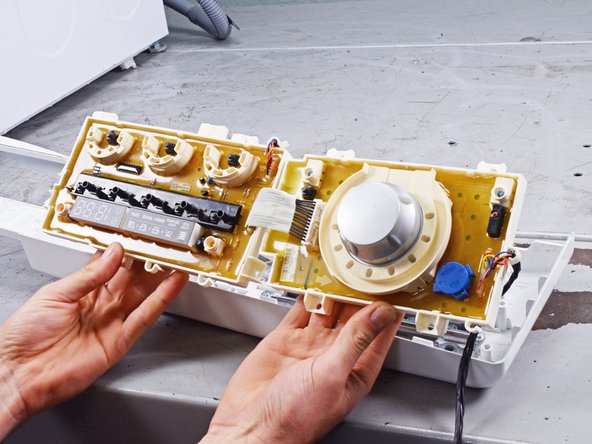

    6. LG Front Load Washing Machine Control Panel Replacement, Unfasten the control panel board: crwdns2935265:012crwdnd2935265:01crwdnd2935265:01crwdne2935265:0
      • Flip the control panel over.
      • Remove the screw(s) securing the control panel board.
    7. LG Front Load Washing Machine Control Panel Replacement, Remove the control panel board: crwdns2935265:013crwdnd2935265:01crwdnd2935265:03crwdne2935265:0 LG Front Load Washing Machine Control Panel Replacement, Remove the control panel board: crwdns2935265:013crwdnd2935265:02crwdnd2935265:03crwdne2935265:0 LG Front Load Washing Machine Control Panel Replacement, Remove the control panel board: crwdns2935265:013crwdnd2935265:03crwdnd2935265:03crwdne2935265:0
      • Pull the control panel board out of its slot and remove it.
