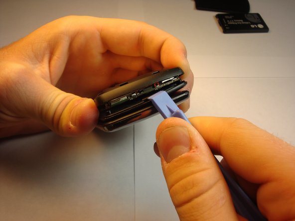

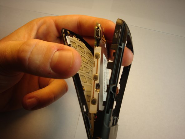

  5. LG Chocolate 3 Display Connector Replacement: crwdns2935265:05crwdnd2935265:01crwdnd2935265:03crwdne2935265:0 LG Chocolate 3 Display Connector Replacement: crwdns2935265:05crwdnd2935265:02crwdnd2935265:03crwdne2935265:0 LG Chocolate 3 Display Connector Replacement: crwdns2935265:05crwdnd2935265:03crwdnd2935265:03crwdne2935265:0
    • Find the seam between the phone’s keypad cover and back cover, and slide a plastic pry tool along the edge to gently pry the two pieces apart without completely separating them.
    • The motherboard should be visible. Do not separate the two covers. They should be held together by a screw at the axis of the phone.

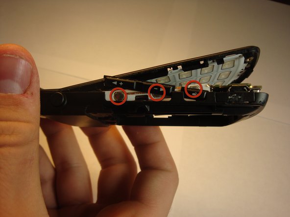

  6. LG Chocolate 3 Display Connector Replacement: crwdns2935265:06crwdnd2935265:01crwdnd2935265:02crwdne2935265:0 LG Chocolate 3 Display Connector Replacement: crwdns2935265:06crwdnd2935265:02crwdnd2935265:02crwdne2935265:0
    • Place the side keys so that they are aligned with the silver circles located on the side of the motherboard.

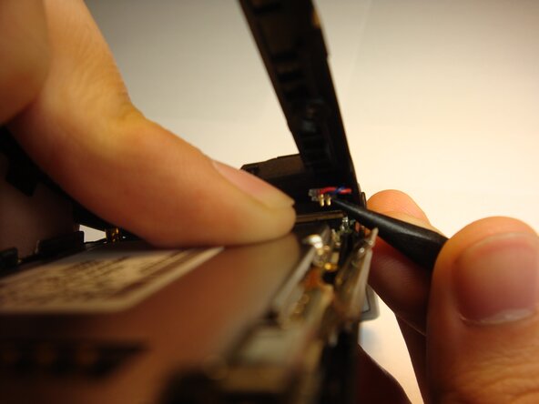

  7. LG Chocolate 3 Display Connector Replacement, Display Connector: crwdns2935265:07crwdnd2935265:01crwdnd2935265:02crwdne2935265:0 LG Chocolate 3 Display Connector Replacement, Display Connector: crwdns2935265:07crwdnd2935265:02crwdnd2935265:02crwdne2935265:0
    • Keep in mind that you will need to reinstall the side keys after completing this repair.
    • Skip this step if the screen blue and red display connector is already detached from the motherboard.
    • Insert the pointed end of a spudger between the plastic end of the wire and the motherboard socket, then carefully lift or push the wire to disconnect it.
    • You should see two golden pins protruding from the plastic connector.
    • To reconnect, align the two golden pins with their corresponding socket on the motherboard and gently press down until you hear a click indicating a secure connection.
    • To reassemble your device, follow the Side Keys Installation guide in reverse order.
