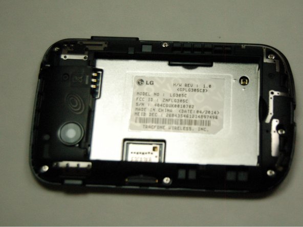

    • Unscrew the back of your device and on the white strip underneath, it should read LG 305C.
    • Note: If it does not read LG305C as the model number, please refer to another guide in order to replace your screen.

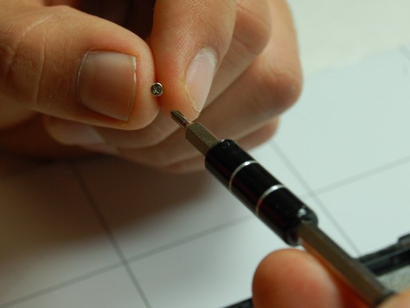

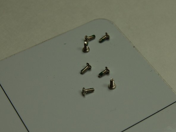

    • Use a Phillips #00 screwdriver to remove the seven screws that are located along the edges of the device.

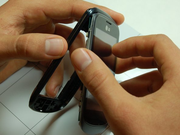

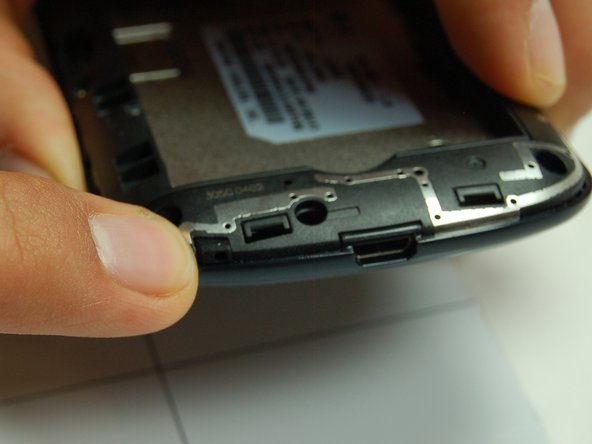

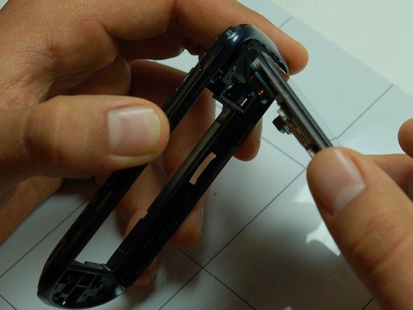

    • Using your plastic pry tool, pry along the edges of plastic side of the screen to loosen and separate the first screen layer.
    • As shown in Picture 2, push in the notch along the edge of the charging port.

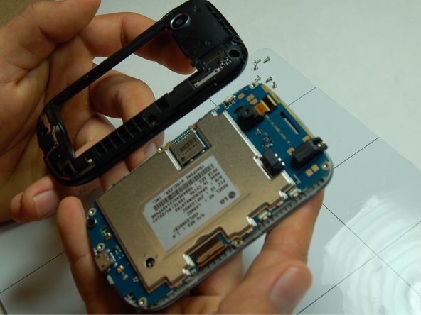

    • Gently pry off the touch screen connection attached to the motherboard with your finger.
    • Once detached, gently separate the motherboard and plastic screen mold. It should look the same as Picture 2
