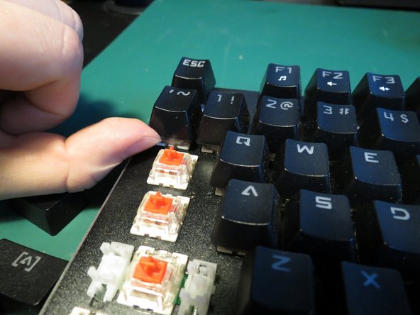

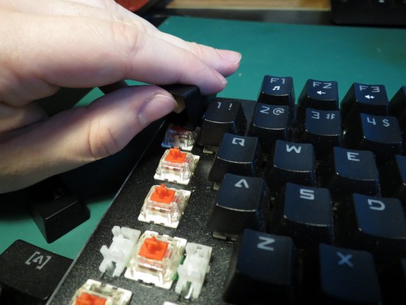

  1. Kogan RGB Mechanical Keyboard Teardown, Remove keycaps: crwdns2935265:01crwdnd2935265:01crwdnd2935265:03crwdne2935265:0 Kogan RGB Mechanical Keyboard Teardown, Remove keycaps: crwdns2935265:01crwdnd2935265:02crwdnd2935265:03crwdne2935265:0 Kogan RGB Mechanical Keyboard Teardown, Remove keycaps: crwdns2935265:01crwdnd2935265:03crwdnd2935265:03crwdne2935265:0
    • Remove keycaps by pulling directly upwards
    • If removing caps by hand it helps to lever the cap from underneath to loosen
    • A keycap removal tool could also be used for best results
    • Ensure safety goggles are worn during this step to avoid injury to the eyes

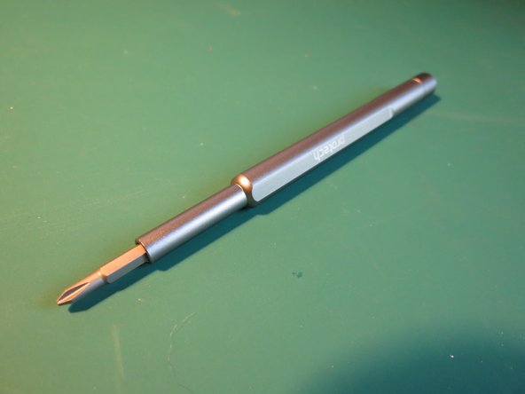

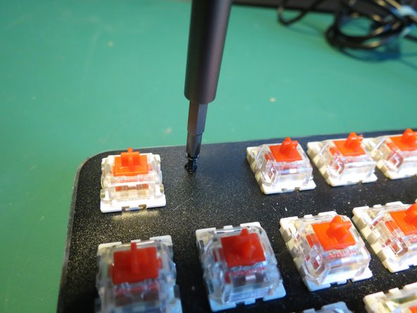

  2. Kogan RGB Mechanical Keyboard Teardown, Remove Screws: crwdns2935265:02crwdnd2935265:01crwdnd2935265:03crwdne2935265:0 Kogan RGB Mechanical Keyboard Teardown, Remove Screws: crwdns2935265:02crwdnd2935265:02crwdnd2935265:03crwdne2935265:0 Kogan RGB Mechanical Keyboard Teardown, Remove Screws: crwdns2935265:02crwdnd2935265:03crwdnd2935265:03crwdne2935265:0
    • The aluminium face plate is held on with 14 Phillips head screws
    • Use a Philips head screwdriver to carefully remove each screw
    • Ensure the correct size head is used to avoid stripping the screw heads

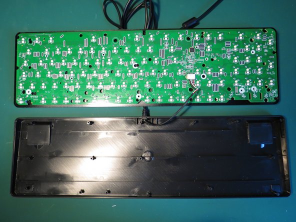

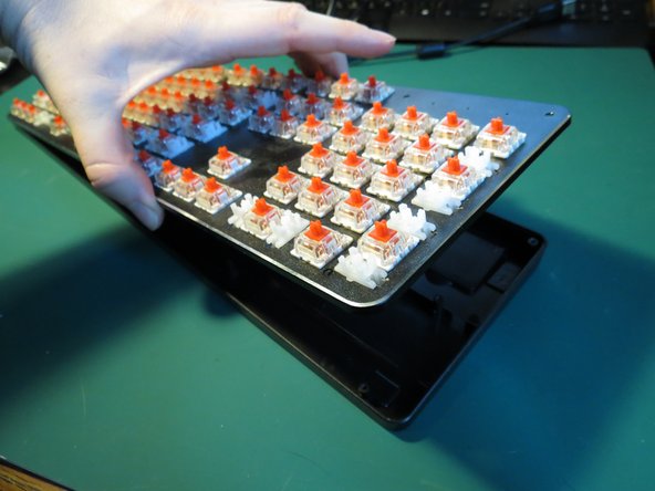

  3. Kogan RGB Mechanical Keyboard Teardown, Separate circuit board from housing: crwdns2935265:03crwdnd2935265:01crwdnd2935265:03crwdne2935265:0 Kogan RGB Mechanical Keyboard Teardown, Separate circuit board from housing: crwdns2935265:03crwdnd2935265:02crwdnd2935265:03crwdne2935265:0 Kogan RGB Mechanical Keyboard Teardown, Separate circuit board from housing: crwdns2935265:03crwdnd2935265:03crwdnd2935265:03crwdne2935265:0
    • The plastic housing can now be separated from the circuit board and key springs
    • The power cable is still connected so first simply lift the circuit board and key spring assembly up and lay it next to the plastic housing
    • Ensure the keyboard is not plugged in to avoid any chance of electrical shock whilst handling

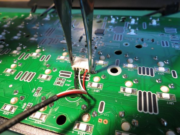

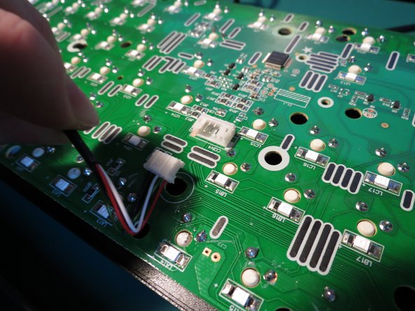

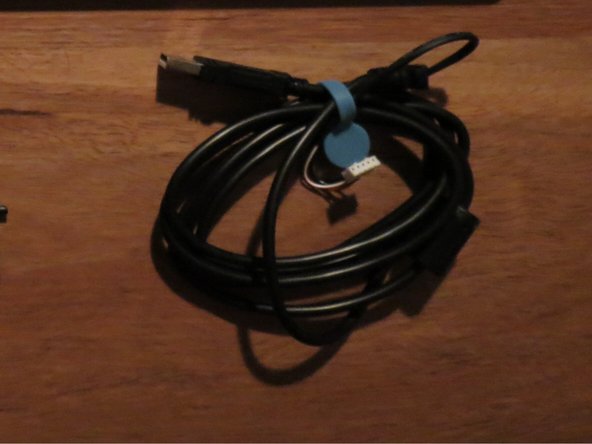

  4. Kogan RGB Mechanical Keyboard Teardown, Disconnect power cable: crwdns2935265:04crwdnd2935265:01crwdnd2935265:03crwdne2935265:0 Kogan RGB Mechanical Keyboard Teardown, Disconnect power cable: crwdns2935265:04crwdnd2935265:02crwdnd2935265:03crwdne2935265:0 Kogan RGB Mechanical Keyboard Teardown, Disconnect power cable: crwdns2935265:04crwdnd2935265:03crwdnd2935265:03crwdne2935265:0
    • The power cable is secured to the circuit board with a white connector
    • Use tweezers to carefully disconnect the connector
    • The connector may need to be shimmied side to side to be able to gently remove it

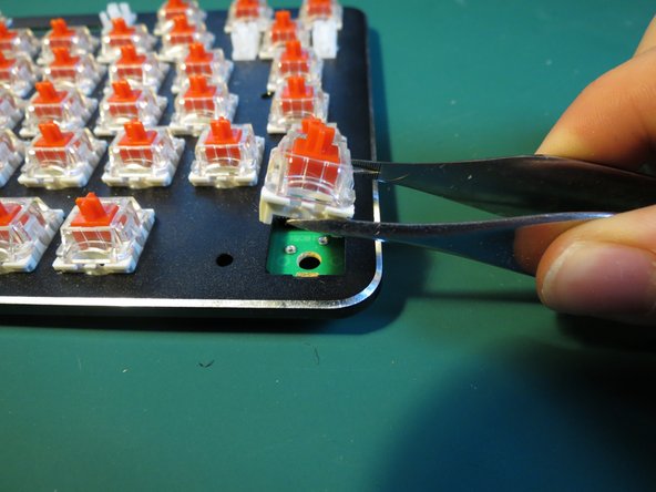

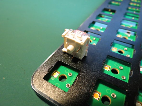

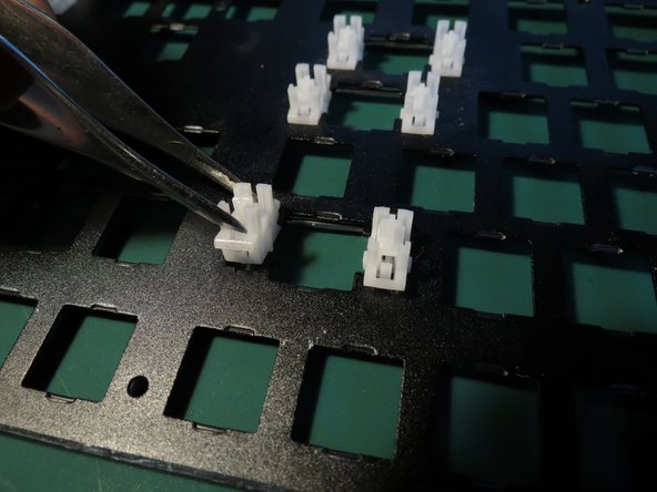

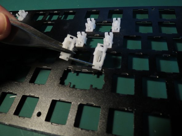

  5. Kogan RGB Mechanical Keyboard Teardown, Remove key springs: crwdns2935265:05crwdnd2935265:01crwdnd2935265:03crwdne2935265:0 Kogan RGB Mechanical Keyboard Teardown, Remove key springs: crwdns2935265:05crwdnd2935265:02crwdnd2935265:03crwdne2935265:0 Kogan RGB Mechanical Keyboard Teardown, Remove key springs: crwdns2935265:05crwdnd2935265:03crwdnd2935265:03crwdne2935265:0
    • If using tweezers gently locate the tines underneath a spring assembly
    • Lever the spring assembly upwards carefully to avoid scratching the aluminium housing or bending the connection pins
    • Aim to pull the spring assembly directly upwards or with minimal misalignment
    • A keycap remover would also be an ideal tool for this step
    • Ensure safety goggles are worn to protect the eyes

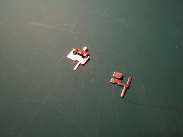

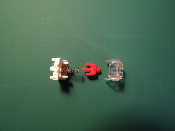

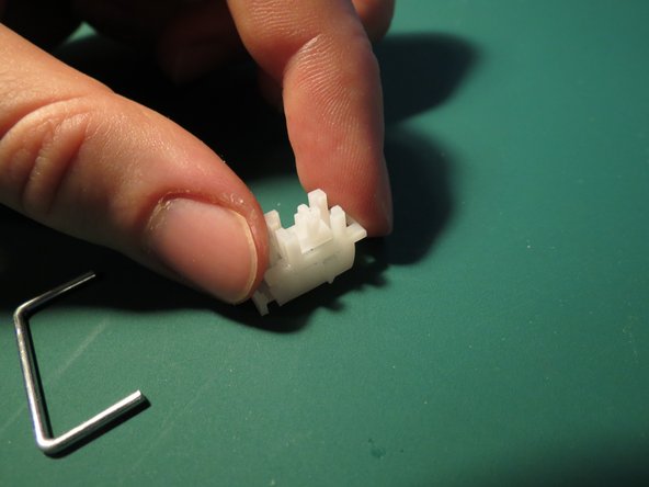

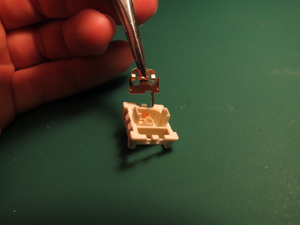

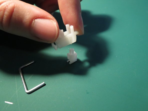

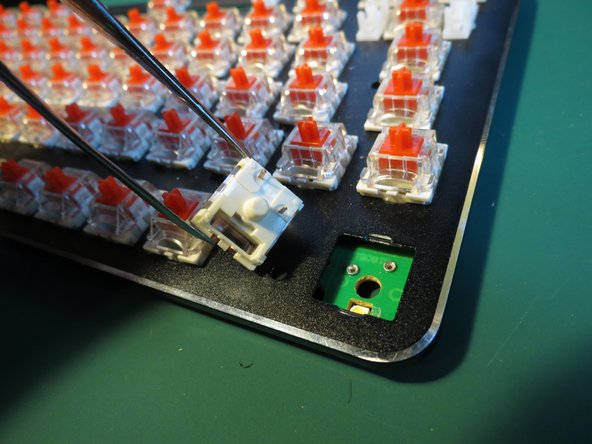

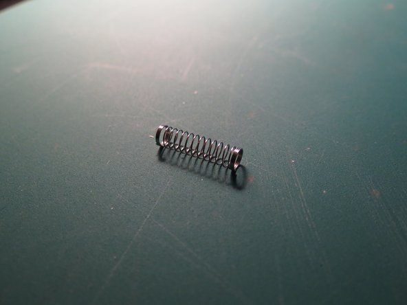

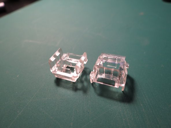

  6. Kogan RGB Mechanical Keyboard Teardown, Disassemble spring assembly: crwdns2935265:06crwdnd2935265:01crwdnd2935265:03crwdne2935265:0 Kogan RGB Mechanical Keyboard Teardown, Disassemble spring assembly: crwdns2935265:06crwdnd2935265:02crwdnd2935265:03crwdne2935265:0 Kogan RGB Mechanical Keyboard Teardown, Disassemble spring assembly: crwdns2935265:06crwdnd2935265:03crwdnd2935265:03crwdne2935265:0
    • Use a small flathead screwdriver to lift up the clear plastic side until it lifts over the white plastic tab
    • Repeat this for both sides
    • Once both sides are lifted over the white tabs the clear plastic cap can be pulled off
    • This will additionally release the red plastic tab and the spring held within
    • Use tweezers to gently pull the two metal pin pieces directly upwards out of the white plastic housing
    • The metal pins bend extremely easily so caution should be taken when removing them to avoid damage
    • Ensure safety goggles are worn for this step as there is the possibility of the plastic pieces chipping or the spring flying out

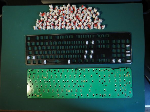

  7. Kogan RGB Mechanical Keyboard Teardown, Separate circuit board: crwdns2935265:07crwdnd2935265:01crwdnd2935265:02crwdne2935265:0 Kogan RGB Mechanical Keyboard Teardown, Separate circuit board: crwdns2935265:07crwdnd2935265:02crwdnd2935265:02crwdne2935265:0
    • Once all the spring assemblies have been removed from the circuit board the aluminium face plate will be free to lift off the circuit board

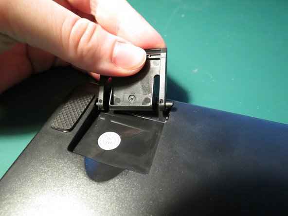

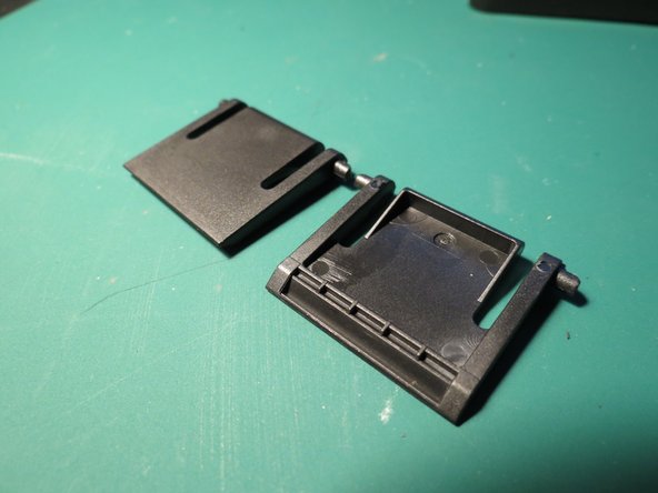

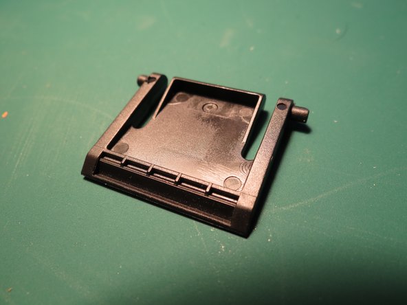

  10. Kogan RGB Mechanical Keyboard Teardown, Remove feet from housing: crwdns2935265:010crwdnd2935265:01crwdnd2935265:03crwdne2935265:0 Kogan RGB Mechanical Keyboard Teardown, Remove feet from housing: crwdns2935265:010crwdnd2935265:02crwdnd2935265:03crwdne2935265:0 Kogan RGB Mechanical Keyboard Teardown, Remove feet from housing: crwdns2935265:010crwdnd2935265:03crwdnd2935265:03crwdne2935265:0
    • Flip the plastic foot upwards
    • Push the foot towards one side and angle it as shown while applying some force upwards
    • The foot should release with relatively minimal force
    • Repeat for the other foot
    • Ensure safety goggles are worn during this step as the plastic components could chip and injure the eyes

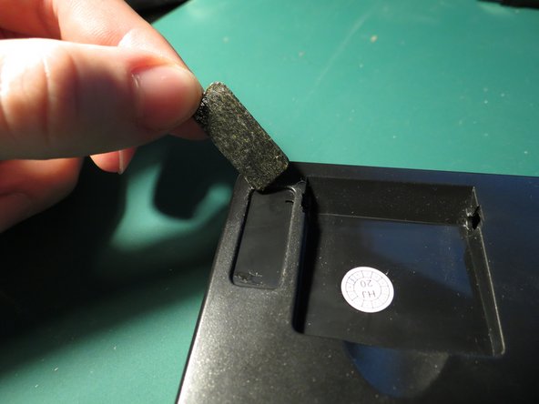

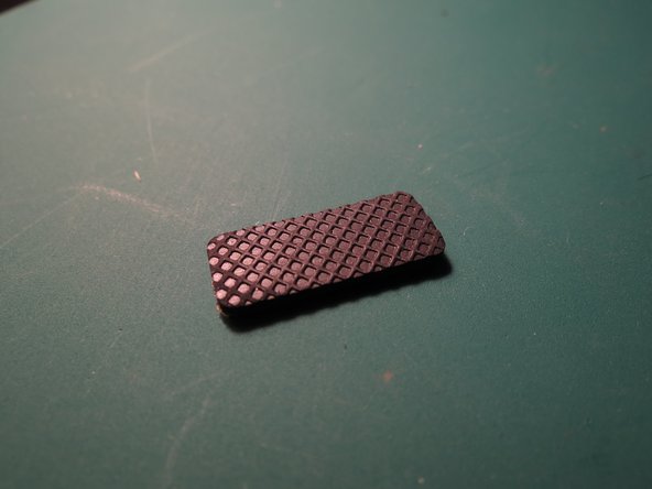

  11. Kogan RGB Mechanical Keyboard Teardown, Remove rubber feet: crwdns2935265:011crwdnd2935265:01crwdnd2935265:03crwdne2935265:0 Kogan RGB Mechanical Keyboard Teardown, Remove rubber feet: crwdns2935265:011crwdnd2935265:02crwdnd2935265:03crwdne2935265:0 Kogan RGB Mechanical Keyboard Teardown, Remove rubber feet: crwdns2935265:011crwdnd2935265:03crwdnd2935265:03crwdne2935265:0
    • Insert a small flathead screwdriver underneath one corner of the rubber foot
    • lift the foot up and pull off
    • The rubber feet should disconnect with minimal force

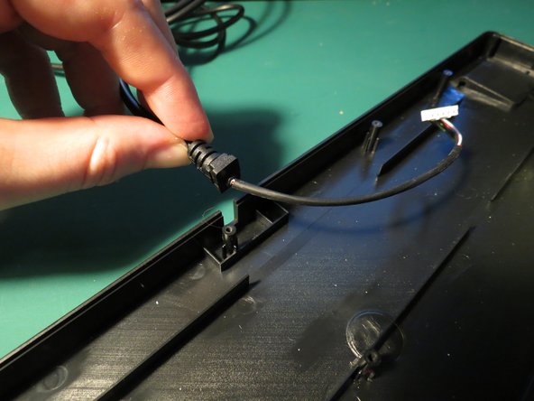

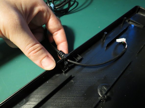

  12. Kogan RGB Mechanical Keyboard Teardown, Remove power cable from housing: crwdns2935265:012crwdnd2935265:01crwdnd2935265:03crwdne2935265:0 Kogan RGB Mechanical Keyboard Teardown, Remove power cable from housing: crwdns2935265:012crwdnd2935265:02crwdnd2935265:03crwdne2935265:0 Kogan RGB Mechanical Keyboard Teardown, Remove power cable from housing: crwdns2935265:012crwdnd2935265:03crwdnd2935265:03crwdne2935265:0
    • The power cable is simply pressed into the plastic housing without any adhesive
    • Pull upwards on the cable whilst ensuring the plastic housing is secured
    • The cable should lift out with minimal force required

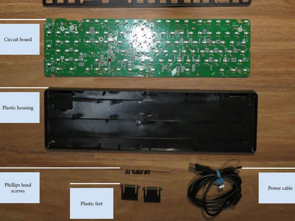

  14. Kogan RGB Mechanical Keyboard Teardown, Component Breakdown: crwdns2935265:014crwdnd2935265:01crwdnd2935265:02crwdne2935265:0 Kogan RGB Mechanical Keyboard Teardown, Component Breakdown: crwdns2935265:014crwdnd2935265:02crwdnd2935265:02crwdne2935265:0
    • Housing
    • Electrical
    • Keys
    • Fasteners

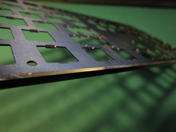

  15. Kogan RGB Mechanical Keyboard Teardown, Face Plate: crwdns2935265:015crwdnd2935265:01crwdnd2935265:02crwdne2935265:0 Kogan RGB Mechanical Keyboard Teardown, Face Plate: crwdns2935265:015crwdnd2935265:02crwdnd2935265:02crwdne2935265:0
    • The face plate protects the circuit board from dust and damage. It also provides a unique aesthetic quality through the chrome bezel.
    • The plate was cut and pressed from aluminium sheet metal then powder coated black.
    • Dimensions: 435x127x4 mm. Weight: 162g

    • The base is comprised of three main components, the plastic base, plastic feet, and rubber feet. These components work together to provide protection to the circuit board, support for the keys, and an aesthetic quality to the product.
    • The plastic base and feet are black injection moulded ABS and the rubber feet are moulded and stamped silicone.
    • Plastic base | Dimensions: 433x125x15 mm Weight: 162g
    • Plastic feet | Dimensions: 30x40x5 mm Weight: 1 g
    • Rubber feet | Dimensions: 25x10x2 mm Weight: <1g

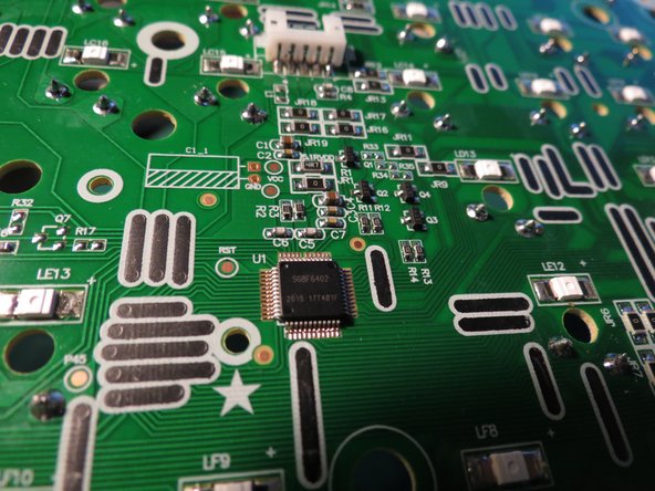

  17. Kogan RGB Mechanical Keyboard Teardown, Electrical: crwdns2935265:017crwdnd2935265:01crwdnd2935265:03crwdne2935265:0 Kogan RGB Mechanical Keyboard Teardown, Electrical: crwdns2935265:017crwdnd2935265:02crwdnd2935265:03crwdne2935265:0 Kogan RGB Mechanical Keyboard Teardown, Electrical: crwdns2935265:017crwdnd2935265:03crwdnd2935265:03crwdne2935265:0
    • The electrical system is comprised of the circuit board and power cable
    • The circuit board connects to the computer and keys, processes inputs and sends outputs. The power cable provides power to the product by USB connection to a computer.

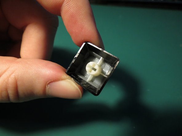

  18. Kogan RGB Mechanical Keyboard Teardown, Keycaps: crwdns2935265:018crwdnd2935265:01crwdnd2935265:02crwdne2935265:0 Kogan RGB Mechanical Keyboard Teardown, Keycaps: crwdns2935265:018crwdnd2935265:02crwdnd2935265:02crwdne2935265:0
    • The keycaps provide the tactile surface for users and allows light to shine though to aid in labelling keys.
    • The keycaps are made by double-shot injection moulding ABS to combine two colours of plastic together. This is done to permanently provide a label for each key and let the RGB light shine through.
    • Dimensions: 130x12x12 mm max. Weight: 4g max.

  21. Kogan RGB Mechanical Keyboard Teardown, Spring Housing: crwdns2935265:021crwdnd2935265:01crwdnd2935265:02crwdne2935265:0 Kogan RGB Mechanical Keyboard Teardown, Spring Housing: crwdns2935265:021crwdnd2935265:02crwdnd2935265:02crwdne2935265:0
    • The housing assembly protects and holds together other key spring components. The lower white component locates the circuit pins and spring to the correct positions. The upper clear component clips onto the white lower housing and secures the keycap connector.
    • Both components are injection moulded however to achieve the clear finish the upper component is manufactured from acrylic whereas the lower opaque component is ABS.
    • Upper component | Dimensions: 13x15x10 mm
    • Lower component | Dimensions: 13x15x13
  22. Kogan RGB Mechanical Keyboard Teardown, Keycap Connector, Spring, and Pins: crwdns2935265:022crwdnd2935265:01crwdnd2935265:03crwdne2935265:0 Kogan RGB Mechanical Keyboard Teardown, Keycap Connector, Spring, and Pins: crwdns2935265:022crwdnd2935265:02crwdnd2935265:03crwdne2935265:0 Kogan RGB Mechanical Keyboard Teardown, Keycap Connector, Spring, and Pins: crwdns2935265:022crwdnd2935265:03crwdnd2935265:03crwdne2935265:0
    • The keycap connector and spring work together to attach the keycap to the spring assembly and push the keys to the upwards position once pressed down. Additionally the red key connector pushes against the larger electrical pin which opens the electrical circuit, sending a signal to the circuit board that the key has been pressed.
    • The keycap connector is injection moulded red ABS. The spring is thinly extruded and coiled steel. Finally, the pins are stamped, pressed, and bent from copper sheet. These components all fit within the spring housing.
    • Keycap connector | Dimensions: 13x7x9 mm
    • Spring | 15x4x4 mm
    • Large pin | 23x10x0.1 mm
    • Small pin | 10x10x0.1 mm
