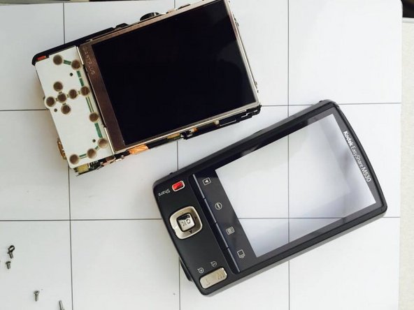

    • Front and Back view of camera. Use a Philips Head screw driver to unscrew the sides of the camera. There are six screws total.
  2. Kodak EasyShare M530 Control Buttons Replacement: crwdns2935265:02crwdnd2935265:01crwdnd2935265:02crwdne2935265:0 Kodak EasyShare M530 Control Buttons Replacement: crwdns2935265:02crwdnd2935265:02crwdnd2935265:02crwdne2935265:0
    • Use a Philips Head screw driver to unscrew the sides of the camera. There are two screws on each side except for the top of the camera. Carefully remove face plate of camera. Place alongside near screws.

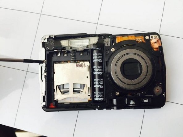

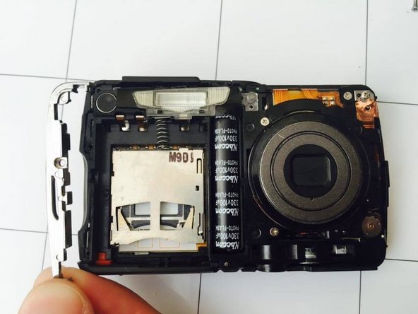

    • To get to control buttons, use a Phillips Head screw driver to unscrew the three screws near lens.
  4. Kodak EasyShare M530 Control Buttons Replacement: crwdns2935265:04crwdnd2935265:01crwdnd2935265:03crwdne2935265:0 Kodak EasyShare M530 Control Buttons Replacement: crwdns2935265:04crwdnd2935265:02crwdnd2935265:03crwdne2935265:0 Kodak EasyShare M530 Control Buttons Replacement: crwdns2935265:04crwdnd2935265:03crwdnd2935265:03crwdne2935265:0

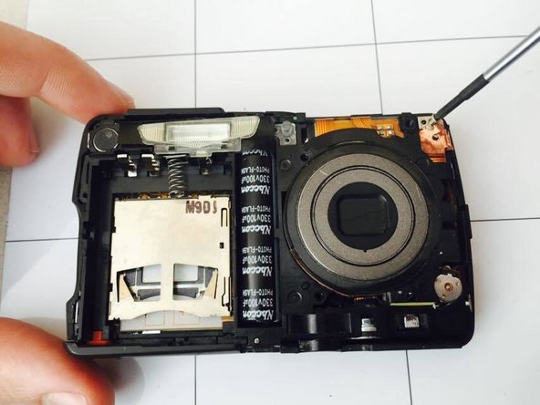

    • Unscrew the screw near the rechargeable battery compartment. The metal piece then can be removed.
  5. Kodak EasyShare M530 Control Buttons Replacement: crwdns2935265:05crwdnd2935265:01crwdnd2935265:02crwdne2935265:0 Kodak EasyShare M530 Control Buttons Replacement: crwdns2935265:05crwdnd2935265:02crwdnd2935265:02crwdne2935265:0

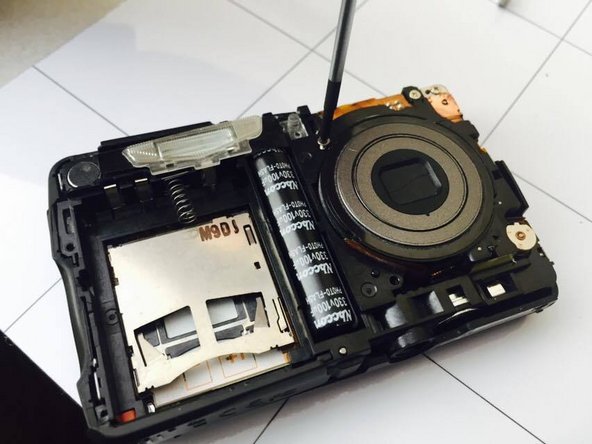

    • Remove additional screws near lens.
  6. Kodak EasyShare M530 Control Buttons Replacement: crwdns2935265:06crwdnd2935265:01crwdnd2935265:02crwdne2935265:0 Kodak EasyShare M530 Control Buttons Replacement: crwdns2935265:06crwdnd2935265:02crwdnd2935265:02crwdne2935265:0

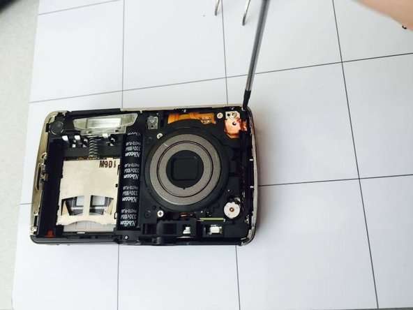

    • This is what the camera should look like with all screws are removed. Flip camera over to carefully remove the screen cover.

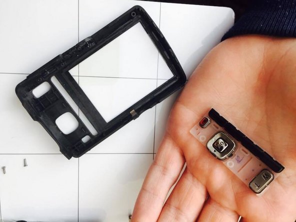

    • Remove buttons from back case of screen cover. Replace with new set of buttons.
