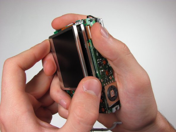

  5. Kodak EasyShare C913 LCD Screen Replacement, LCD Screen: crwdns2935265:05crwdnd2935265:01crwdnd2935265:03crwdne2935265:0 Kodak EasyShare C913 LCD Screen Replacement, LCD Screen: crwdns2935265:05crwdnd2935265:02crwdnd2935265:03crwdne2935265:0 Kodak EasyShare C913 LCD Screen Replacement, LCD Screen: crwdns2935265:05crwdnd2935265:03crwdnd2935265:03crwdne2935265:0

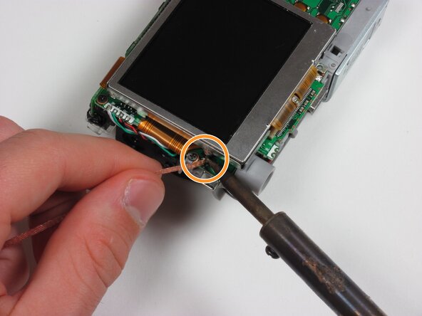

    • Look at the LCD casing and find the two smaller solder joints. One on either side of the camera secures the circuit board's casing. These are usually shiny and metallic points where the casing connects to the board.
    • Apply the tip of the heated smolder to the first joint to remove it. Contiune with the other side.

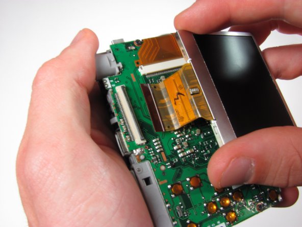

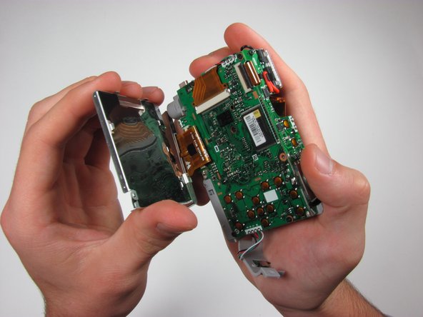

  6. Kodak EasyShare C913 LCD Screen Replacement: crwdns2935265:06crwdnd2935265:01crwdnd2935265:03crwdne2935265:0 Kodak EasyShare C913 LCD Screen Replacement: crwdns2935265:06crwdnd2935265:02crwdnd2935265:03crwdne2935265:0 Kodak EasyShare C913 LCD Screen Replacement: crwdns2935265:06crwdnd2935265:03crwdnd2935265:03crwdne2935265:0
    • Gently grasp the lower right side of LCD screen.
    • Lift the screen out of its casing.

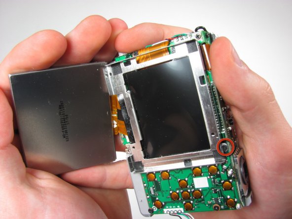

    • Remove the 3 mm screw from the LCD casing using a #00 screwdriver.

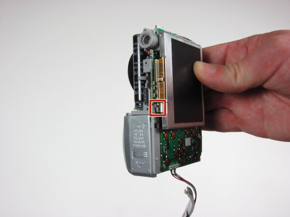

  7. Kodak EasyShare C913 LCD Screen Replacement: crwdns2935265:07crwdnd2935265:01crwdnd2935265:03crwdne2935265:0 Kodak EasyShare C913 LCD Screen Replacement: crwdns2935265:07crwdnd2935265:02crwdnd2935265:03crwdne2935265:0 Kodak EasyShare C913 LCD Screen Replacement: crwdns2935265:07crwdnd2935265:03crwdnd2935265:03crwdne2935265:0
    • Gently grab the sides of the LCD casing and remove it from the camera.

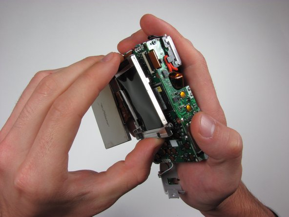

  8. Kodak EasyShare C913 LCD Screen Replacement: crwdns2935265:08crwdnd2935265:01crwdnd2935265:02crwdne2935265:0 Kodak EasyShare C913 LCD Screen Replacement: crwdns2935265:08crwdnd2935265:02crwdnd2935265:02crwdne2935265:0
    • Lift the black tab gently with your finger.
    • Gently remove ribbon from underneath black tab.
