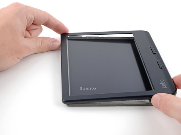

  10. Kobo Libra Colour Front Cover Replacement, Heat the front cover: crwdns2935265:010crwdnd2935265:01crwdnd2935265:03crwdne2935265:0 Kobo Libra Colour Front Cover Replacement, Heat the front cover: crwdns2935265:010crwdnd2935265:02crwdnd2935265:03crwdne2935265:0 Kobo Libra Colour Front Cover Replacement, Heat the front cover: crwdns2935265:010crwdnd2935265:03crwdnd2935265:03crwdne2935265:0
    • The front cover is secured with clips and adhesive.
    • Flip your eReader over so the screen is facing up.
    • Heat an iOpener and lay it on the top edge of the front cover for 90 seconds to soften the adhesive underneath.
    • Alternatively, you can use a hair dryer or a heat gun.
  11. Kobo Libra Colour Front Cover Replacement, Unclip the front cover: crwdns2935265:011crwdnd2935265:01crwdnd2935265:03crwdne2935265:0 Kobo Libra Colour Front Cover Replacement, Unclip the front cover: crwdns2935265:011crwdnd2935265:02crwdnd2935265:03crwdne2935265:0 Kobo Libra Colour Front Cover Replacement, Unclip the front cover: crwdns2935265:011crwdnd2935265:03crwdnd2935265:03crwdne2935265:0
    • Hold the eReader so your thumbs can push the underside of the front cover off its clips while your other fingers can pull the screen in the opposite direction.
    • Push the top left corner of the front cover while pulling the screen in the opposite direction to release the clips and separate the adhesive.
    • You'll hear and feel the adhesive slowly separate as you push on the front cover.
    • If you're having trouble, reheat the top edge for one minute before trying again.

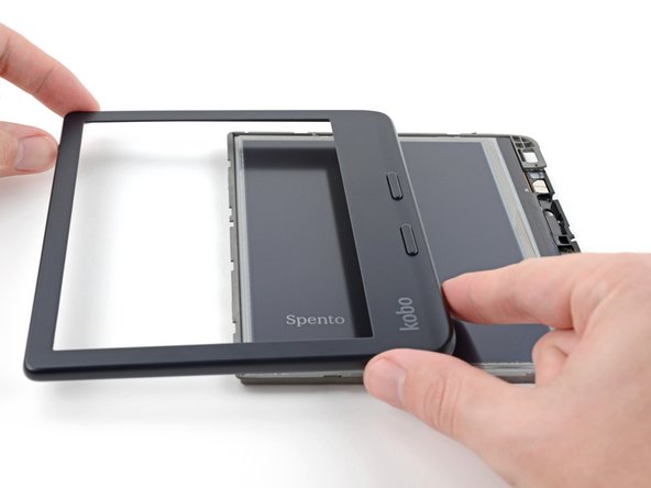

  12. Kobo Libra Colour Front Cover Replacement: crwdns2935265:012crwdnd2935265:01crwdnd2935265:03crwdne2935265:0 Kobo Libra Colour Front Cover Replacement: crwdns2935265:012crwdnd2935265:02crwdnd2935265:03crwdne2935265:0 Kobo Libra Colour Front Cover Replacement: crwdns2935265:012crwdnd2935265:03crwdnd2935265:03crwdne2935265:0
    • While keeping the corner of the front cover separated with one hand, use your other hand to peel the left edge of the front cover off the screen.
  13. Kobo Libra Colour Front Cover Replacement: crwdns2935265:013crwdnd2935265:01crwdnd2935265:03crwdne2935265:0 Kobo Libra Colour Front Cover Replacement: crwdns2935265:013crwdnd2935265:02crwdnd2935265:03crwdne2935265:0 Kobo Libra Colour Front Cover Replacement: crwdns2935265:013crwdnd2935265:03crwdnd2935265:03crwdne2935265:0
    • Continue working around the perimeter of the front cover until all of the clips release and the adhesive is completely separated.
    • Heat the edges of the front cover when necessary.
    • The larger, rounded corners take more force to release their clips.
  14. Kobo Libra Colour Front Cover Replacement, Remove the front cover: crwdns2935265:014crwdnd2935265:01crwdnd2935265:03crwdne2935265:0 Kobo Libra Colour Front Cover Replacement, Remove the front cover: crwdns2935265:014crwdnd2935265:02crwdnd2935265:03crwdne2935265:0 Kobo Libra Colour Front Cover Replacement, Remove the front cover: crwdns2935265:014crwdnd2935265:03crwdnd2935265:03crwdne2935265:0
    Tesa 61395 Tape
    $2.99
    • Lift the front cover off the screen and remove it.
    • During reassembly:
    • If your replacement front cover comes with pre‑installed adhesive, remove the liner. Otherwise, use a thin double-sided tape like Tesa tape to replace the adhesive.
    • Align the front cover over the frame and press down around the perimeter until the clips snap back into place.
