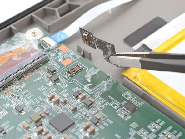

  9. Kobo Libra Colour Battery Replacement, Peel up the battery cable: crwdns2935265:09crwdnd2935265:01crwdnd2935265:02crwdne2935265:0 Kobo Libra Colour Battery Replacement, Peel up the battery cable: crwdns2935265:09crwdnd2935265:02crwdnd2935265:02crwdne2935265:0
    • Use tweezers, or your fingers, to peel the battery cable away the motherboard and separate the coating.
  10. Kobo Libra Colour Battery Replacement, Battery information: crwdns2935265:010crwdnd2935265:01crwdnd2935265:01crwdne2935265:0
    • When working on or near the battery, don't use sharp metal tools to avoid puncturing and shorting the battery! A punctured battery can leak dangerous chemicals and catch fire.
    • If your battery comes with stretch release adhesive, follow the next two steps to remove them.
