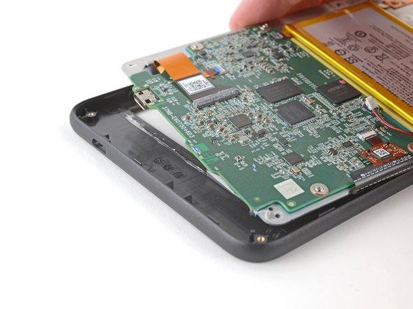

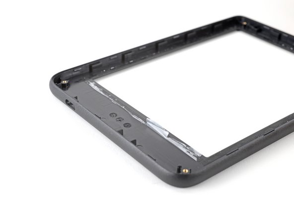

  12. Kobo Clara BW (N365) Front Cover Replacement, Remove the front cover screws: crwdns2935265:012crwdnd2935265:01crwdnd2935265:02crwdne2935265:0 Kobo Clara BW (N365) Front Cover Replacement, Remove the front cover screws: crwdns2935265:012crwdnd2935265:02crwdnd2935265:02crwdne2935265:0
    • Use a Phillips screwdriver to remove the four 3 mm‑long screws securing the corners of the front cover.

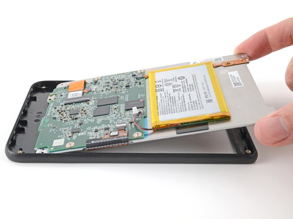

  13. Kobo Clara BW (N365) Front Cover Replacement, Separate the adhesive: crwdns2935265:013crwdnd2935265:01crwdnd2935265:03crwdne2935265:0 Kobo Clara BW (N365) Front Cover Replacement, Separate the adhesive: crwdns2935265:013crwdnd2935265:02crwdnd2935265:03crwdne2935265:0 Kobo Clara BW (N365) Front Cover Replacement, Separate the adhesive: crwdns2935265:013crwdnd2935265:03crwdnd2935265:03crwdne2935265:0
    • The screen is secured by weak adhesive along the perimeter of the front cover and a layer of coating at the bottom edge.
    • Bend the top edge of the front cover around the screen to separate the adhesive.

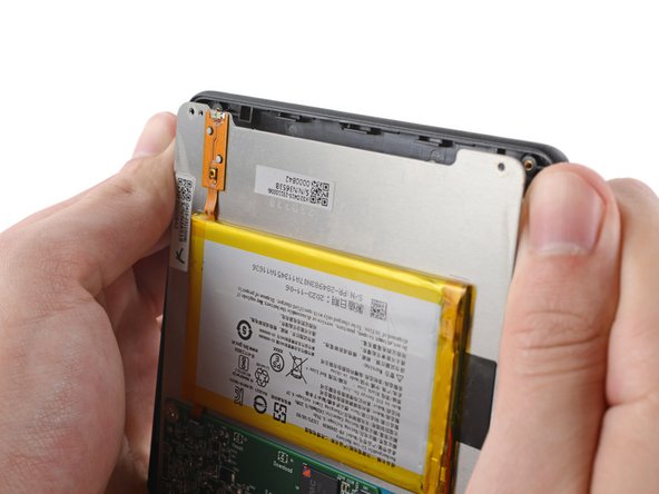

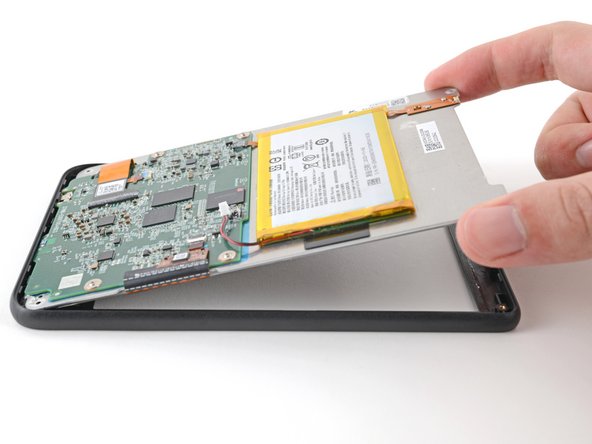

  14. Kobo Clara BW (N365) Front Cover Replacement: crwdns2935265:014crwdnd2935265:01crwdnd2935265:03crwdne2935265:0 Kobo Clara BW (N365) Front Cover Replacement: crwdns2935265:014crwdnd2935265:02crwdnd2935265:03crwdne2935265:0 Kobo Clara BW (N365) Front Cover Replacement: crwdns2935265:014crwdnd2935265:03crwdnd2935265:03crwdne2935265:0
    • Lift the top edge of the screen to separate any remaining adhesive around the perimeter of the front cover.
    • Slide the screen toward the top of the eReader to expose the coating at the bottom edge.
  15. Kobo Clara BW (N365) Front Cover Replacement, Remove the screen assembly: crwdns2935265:015crwdnd2935265:01crwdnd2935265:03crwdne2935265:0 Kobo Clara BW (N365) Front Cover Replacement, Remove the screen assembly: crwdns2935265:015crwdnd2935265:02crwdnd2935265:03crwdne2935265:0 Kobo Clara BW (N365) Front Cover Replacement, Remove the screen assembly: crwdns2935265:015crwdnd2935265:03crwdnd2935265:03crwdne2935265:0
    Tesa 61395 Tape
    $2.99
    • Lift and rotate the screen off the bottom edge of the front cover to separate the coating.
    • Remove the screen. Only the front cover remains.
