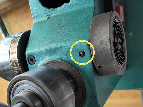

    • Make sure the drill press is turned off and the power cord is unplugged.
    • Remove the chuck from the spindle and support the quill to prevent it from dropping uncontrollably when the spring tension is released.

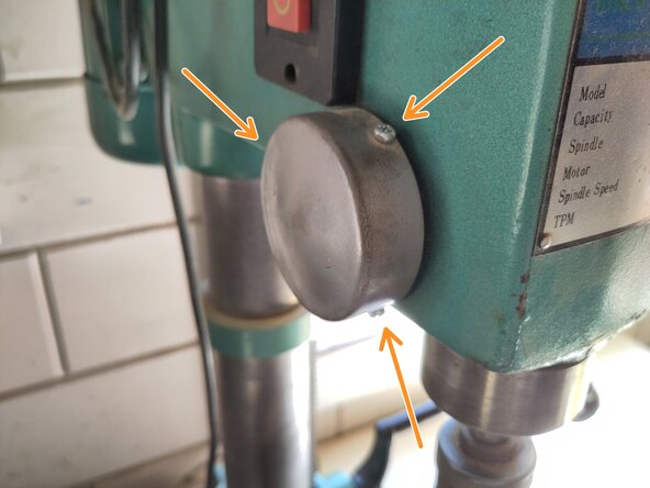

    • Remove the 3 bolts that hold the spring cover in place and remove the cover.

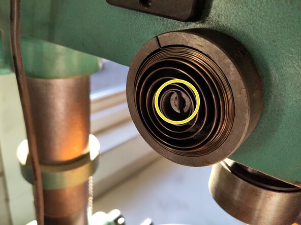

    • Turn the spring lock screw left to release the spring tension.

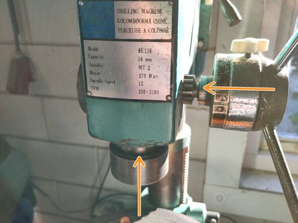

  2. Kinzo 8E116 Spindle Bearing Replacement, remove quill from frame: crwdns2935265:02crwdnd2935265:01crwdnd2935265:03crwdne2935265:0 Kinzo 8E116 Spindle Bearing Replacement, remove quill from frame: crwdns2935265:02crwdnd2935265:02crwdnd2935265:03crwdne2935265:0 Kinzo 8E116 Spindle Bearing Replacement, remove quill from frame: crwdns2935265:02crwdnd2935265:03crwdnd2935265:03crwdne2935265:0
    • Pull out the feed lever pinion.
    • Remove the supports and remove the quill from the drill press frame.

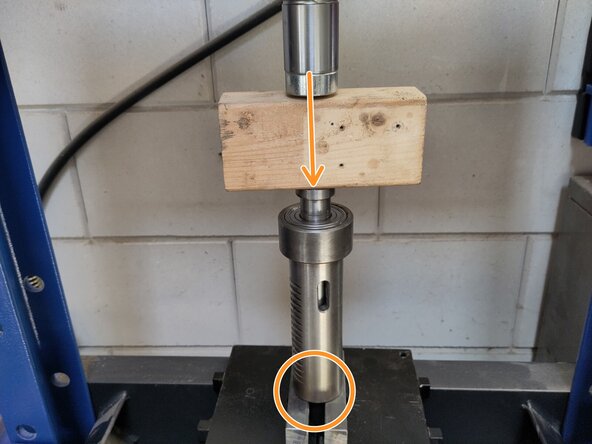

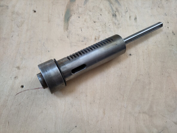

  3. Kinzo 8E116 Spindle Bearing Replacement, press spindle from quill: crwdns2935265:03crwdnd2935265:01crwdnd2935265:02crwdne2935265:0 Kinzo 8E116 Spindle Bearing Replacement, press spindle from quill: crwdns2935265:03crwdnd2935265:02crwdnd2935265:02crwdne2935265:0

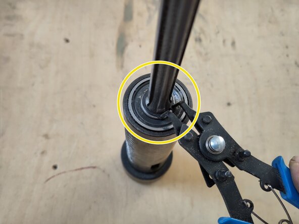

    • Remove the snap ring holding the top bearing in place.

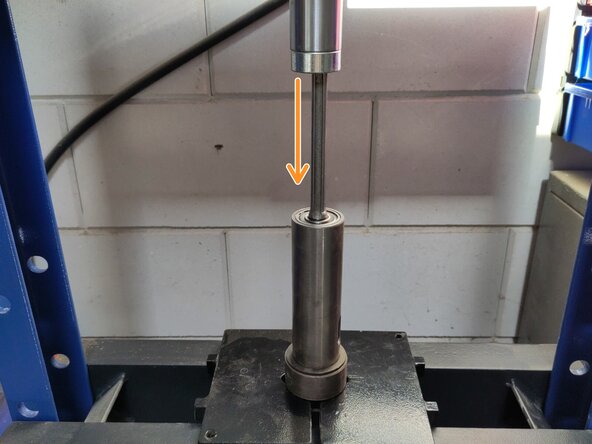

    • Use the press to press the spindle from the quill.
  4. Kinzo 8E116 Spindle Bearing Replacement, remove bearings: crwdns2935265:04crwdnd2935265:01crwdnd2935265:03crwdne2935265:0 Kinzo 8E116 Spindle Bearing Replacement, remove bearings: crwdns2935265:04crwdnd2935265:02crwdnd2935265:03crwdne2935265:0 Kinzo 8E116 Spindle Bearing Replacement, remove bearings: crwdns2935265:04crwdnd2935265:03crwdnd2935265:03crwdne2935265:0

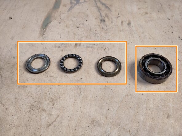

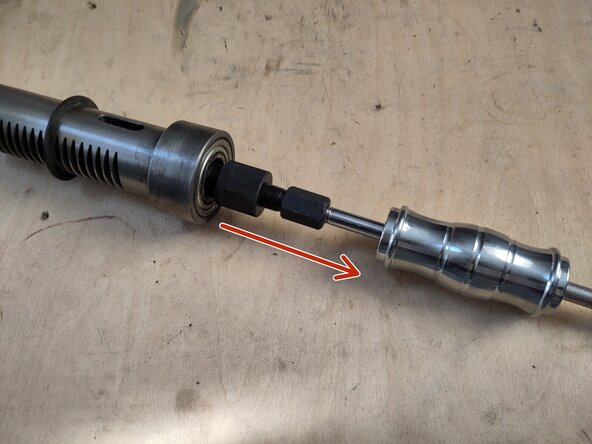

    • The bearings are press fit into the quill, remove the bearings with the bearing removal tool.
    • The bottom bearings consists of a thrust bearing on top of "regular" deep groove ball bearing.
  5. Kinzo 8E116 Spindle Bearing Replacement, insert new bearings: crwdns2935265:05crwdnd2935265:01crwdnd2935265:03crwdne2935265:0 Kinzo 8E116 Spindle Bearing Replacement, insert new bearings: crwdns2935265:05crwdnd2935265:02crwdnd2935265:03crwdne2935265:0 Kinzo 8E116 Spindle Bearing Replacement, insert new bearings: crwdns2935265:05crwdnd2935265:03crwdnd2935265:03crwdne2935265:0

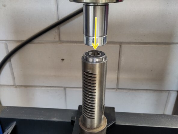

    • Clean the quill and insert the thrust bearing.
    • Press in the bottom bearing on top of the thrust bearing.
    • Next, press in the top bearing.
  6. Kinzo 8E116 Spindle Bearing Replacement, insert spindle: crwdns2935265:06crwdnd2935265:01crwdnd2935265:03crwdne2935265:0 Kinzo 8E116 Spindle Bearing Replacement, insert spindle: crwdns2935265:06crwdnd2935265:02crwdnd2935265:03crwdne2935265:0 Kinzo 8E116 Spindle Bearing Replacement, insert spindle: crwdns2935265:06crwdnd2935265:03crwdnd2935265:03crwdne2935265:0
    • Slide the spindle back into the quill.

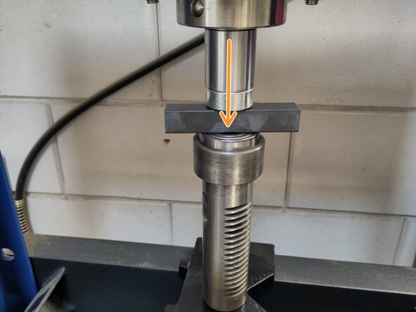

    • Use the press to press the spindle fully into the quill. Make sure the top bearing is not pressed out again by supporting it from beneath.
    • Add the snap ring back on top of the quill.

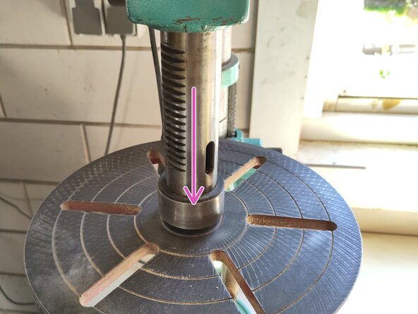

  7. Kinzo 8E116 Spindle Bearing Replacement, insert quill into frame: crwdns2935265:07crwdnd2935265:01crwdnd2935265:03crwdne2935265:0 Kinzo 8E116 Spindle Bearing Replacement, insert quill into frame: crwdns2935265:07crwdnd2935265:02crwdnd2935265:03crwdne2935265:0 Kinzo 8E116 Spindle Bearing Replacement, insert quill into frame: crwdns2935265:07crwdnd2935265:03crwdnd2935265:03crwdne2935265:0
    • Insert the quill back into the frame.
    • While pushing and holding the quill up, slide the feed lever pinion back in connecting with the quill rack.
    • Insert the end of the pinion into the spiral spring.
    • At this point, if the quill is not supported, it will fall if you let go of the lever or the quill. Make sure to support it before continuing to the final step.
