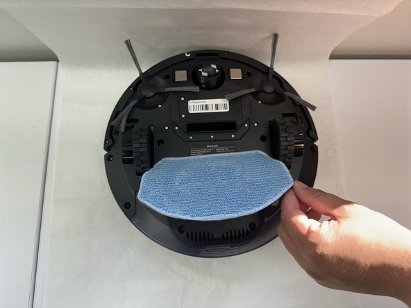

  1. Kilgone G20 Battery Replacement, Battery: crwdns2935265:01crwdnd2935265:01crwdnd2935265:02crwdne2935265:0 Kilgone G20 Battery Replacement, Battery: crwdns2935265:01crwdnd2935265:02crwdnd2935265:02crwdne2935265:0
    • Remove the mop pad.

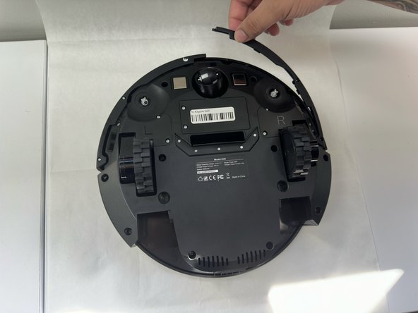

  2. Kilgone G20 Battery Replacement: crwdns2935265:02crwdnd2935265:01crwdnd2935265:02crwdne2935265:0 Kilgone G20 Battery Replacement: crwdns2935265:02crwdnd2935265:02crwdnd2935265:02crwdne2935265:0

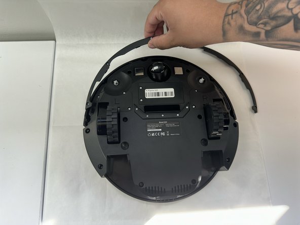

    • One at a time, grab and pull up on each of the side brushes to remove them.
    • Don't be afraid to use some force when pulling up on each of the brushes.

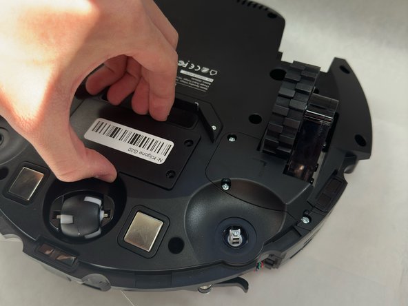

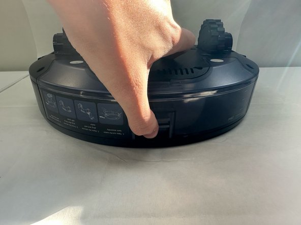

  3. Kilgone G20 Battery Replacement: crwdns2935265:03crwdnd2935265:01crwdnd2935265:03crwdne2935265:0 Kilgone G20 Battery Replacement: crwdns2935265:03crwdnd2935265:02crwdnd2935265:03crwdne2935265:0 Kilgone G20 Battery Replacement: crwdns2935265:03crwdnd2935265:03crwdnd2935265:03crwdne2935265:0

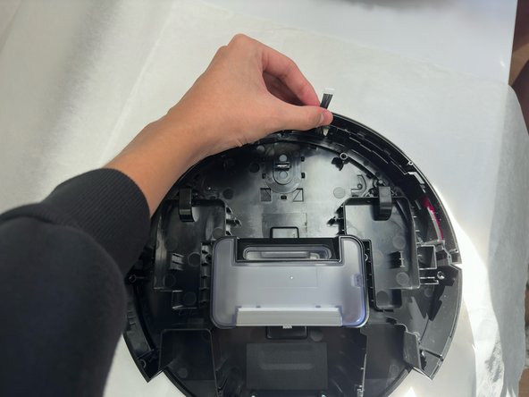

    • Pinch on the tab and pull out the mopping solution container.

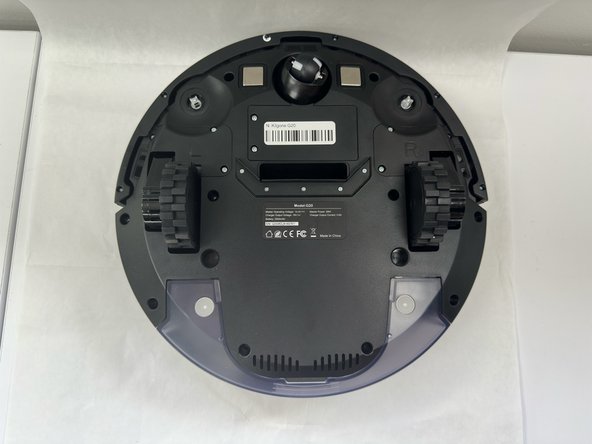

  4. Kilgone G20 Battery Replacement: crwdns2935265:04crwdnd2935265:01crwdnd2935265:01crwdne2935265:0
    • Use a Phillips #1 screwdriver to remove the ten 3.8 mm x 12.28 mm screws on the underside of the device.

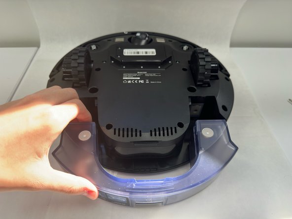

  5. Kilgone G20 Battery Replacement: crwdns2935265:05crwdnd2935265:01crwdnd2935265:03crwdne2935265:0 Kilgone G20 Battery Replacement: crwdns2935265:05crwdnd2935265:02crwdnd2935265:03crwdne2935265:0 Kilgone G20 Battery Replacement: crwdns2935265:05crwdnd2935265:03crwdnd2935265:03crwdne2935265:0
    • Remove the six 2.3 mm screws on the underside of the bumper.
    • Lift the undersides of the bumper off.

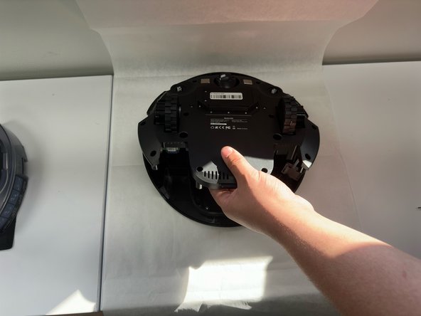

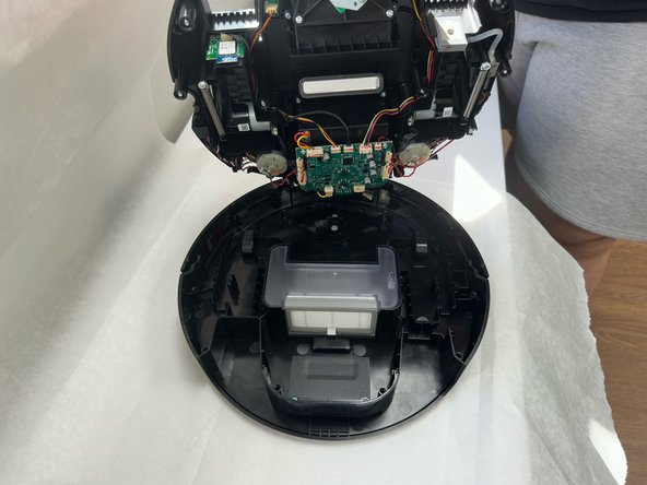

  6. Kilgone G20 Battery Replacement: crwdns2935265:06crwdnd2935265:01crwdnd2935265:03crwdne2935265:0 Kilgone G20 Battery Replacement: crwdns2935265:06crwdnd2935265:02crwdnd2935265:03crwdne2935265:0 Kilgone G20 Battery Replacement: crwdns2935265:06crwdnd2935265:03crwdnd2935265:03crwdne2935265:0
    • Lift the entire underside up cautiously.
    • Make sure not to pull or snap the wire connected to the main board.

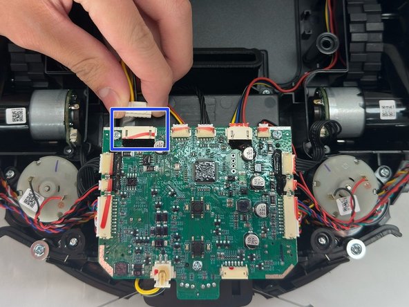

  7. Kilgone G20 Battery Replacement: crwdns2935265:07crwdnd2935265:01crwdnd2935265:02crwdne2935265:0 Kilgone G20 Battery Replacement: crwdns2935265:07crwdnd2935265:02crwdnd2935265:02crwdne2935265:0
    • Grab the main circuit board and look for which port the bumper is attached to.
    • Carefully pull out the connection and put the bumper off to the side.

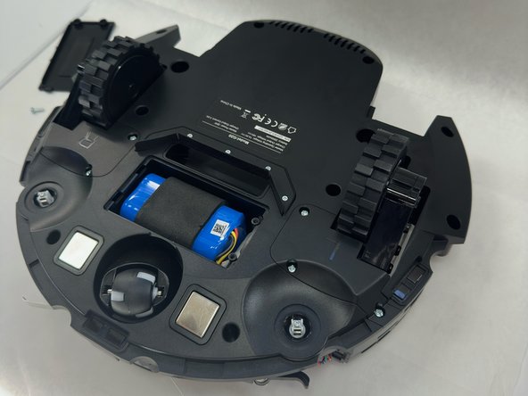

    • Flip over the G20.
    • Remove the two M3 x 10 screws that secure the battery cover.
    • Remove the battery cover.
  9. Kilgone G20 Battery Replacement: crwdns2935265:09crwdnd2935265:01crwdnd2935265:02crwdne2935265:0 Kilgone G20 Battery Replacement: crwdns2935265:09crwdnd2935265:02crwdnd2935265:02crwdne2935265:0
    • Unplug the cable that's connected to the battery from the port on the motherboard.
    • Make sure you only disconnect the cable that is highlighted in the image.

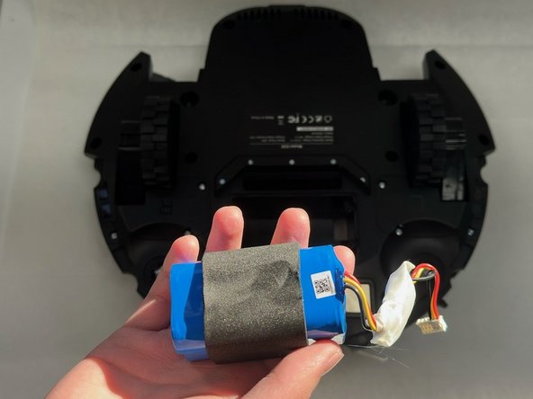

  10. Kilgone G20 Battery Replacement: crwdns2935265:010crwdnd2935265:01crwdnd2935265:02crwdne2935265:0 Kilgone G20 Battery Replacement: crwdns2935265:010crwdnd2935265:02crwdnd2935265:02crwdne2935265:0
    • Flip over the G20 again, and gently lift out the battery along with the wire that it's connected to.
