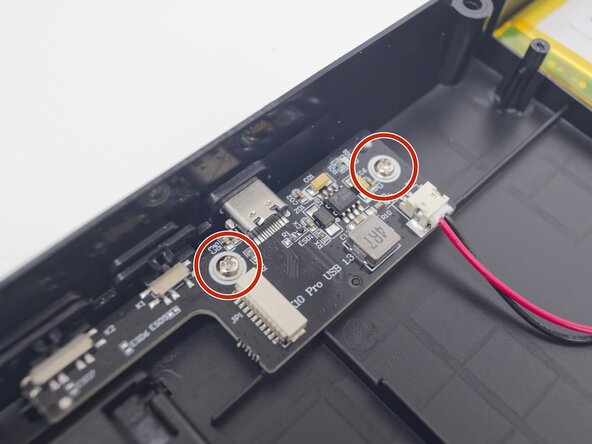

      • Remove the two 4.0 mm Phillips #1 screws securing the I/O charging port board.
      • Carefully slide the charging PCB out of the frame.

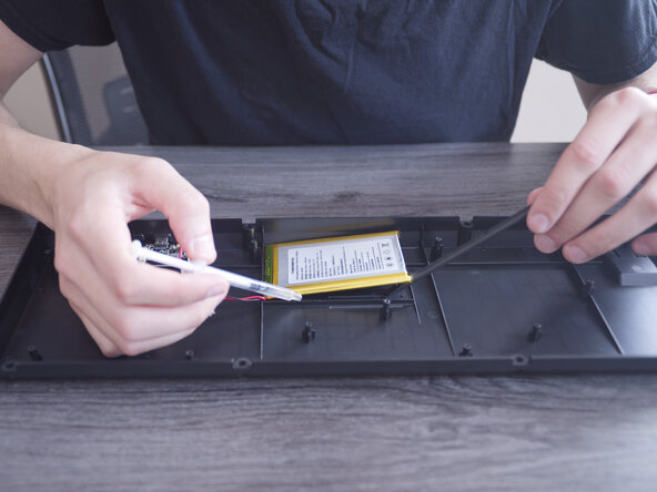

      • Do not bend, puncture, crush, or aggressively pry against the battery. A damaged lithium-ion battery can leak, overheat, or catch fire.
      • The battery is held down with a simple adhesive that covers the entire bottom of the battery. Use isopropyl alcohol with a syringe to loosen the adhesive.
      • Tilt the frame slightly to help the isopropyl alcohol flow underneath the battery. Once you get an edge lifted off slightly, start applying more isopropyl alcohol under the battery.
      • Be slow and patient while removing the battery. Just keep applying small amounts of isopropyl alcohol to weaken the adhesive, and give it time to soak in before prying.
      • Do not force the battery loose, as bending or puncturing a lithium-ion battery can cause it to leak, overheat, or catch fire.
      • Once the battery is removed, place it adhesive side up so it does not stick to the work surface
      • If the adhesive remains intact, it may be reused during reassembly.
