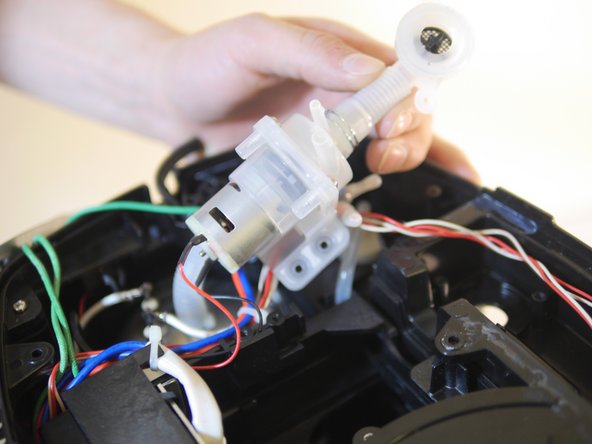

    • Rotate the Keurig on its side so that the base plate is accessible.
  2. Keurig K70 Water Pump Replacement: crwdns2935265:02crwdnd2935265:01crwdnd2935265:02crwdne2935265:0 Keurig K70 Water Pump Replacement: crwdns2935265:02crwdnd2935265:02crwdnd2935265:02crwdne2935265:0
    • Remove the five 12mm Phillips #2 screws from the base plate.
  3. Keurig K70 Water Pump Replacement: crwdns2935265:03crwdnd2935265:01crwdnd2935265:01crwdne2935265:0
    • Remove the base plate by sliding it towards the power cord and then out.
  4. Keurig K70 Water Pump Replacement, Water Pump: crwdns2935265:04crwdnd2935265:01crwdnd2935265:01crwdne2935265:0
    • Unscrew the indicated 12mm Phillips #2 screws.
  5. Keurig K70 Water Pump Replacement: crwdns2935265:05crwdnd2935265:01crwdnd2935265:02crwdne2935265:0 Keurig K70 Water Pump Replacement: crwdns2935265:05crwdnd2935265:02crwdnd2935265:02crwdne2935265:0
    • Cut the indicated zipties with scissors.
    • Pull the two tubes out of the water pump. This may require a little force.
  6. Keurig K70 Water Pump Replacement: crwdns2935265:06crwdnd2935265:01crwdnd2935265:01crwdne2935265:0

This was encouraging (and helpful), but mostly because I’d already worked my way up to Step 5 all on my own. It would have been nice to see a picture of the what I’m sure is the miniature impeller pump motor out of its fitting/housing - but I’m 100% certain I can figure that on my own. I'm about 95% sure that my pump motor has begun to experience intermittent failures - and that’s the source of my problem. Any hints on a confirmed source for a compatible replacement motor? Thanks!

Kuerig does not sell replacement water pumps. E-bay sells used ones they say have been tested to be good . Yes they have been tested and pump water but not tested to adequate pressure head to flow water thru the K-cup at rate require for each timer flow setting. Hence where can one purchase a new (K70 or B70) pump?
Jack - crwdns2934203:0crwdne2934203:0
I disassembled mine because of a leak whenever the reservoir is inserted in the machine. I found that the suction tube to the pump had a very small knick in the plunger seal. My problem is finding the parts to complete the repair. I would like to just replace the suction tube but I'm not sure if that is available separately from the pump. Any leads on where to find those replacement parts?

Your instructions were spot on still not pumping water to the cup
