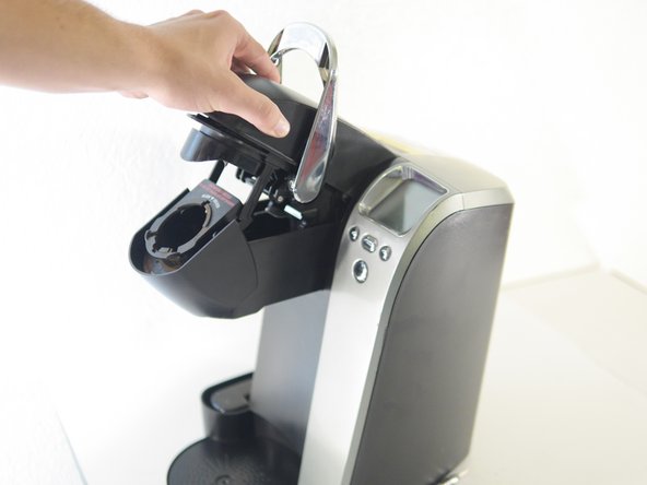

    • Open the K-Cup Holder by lifting the handle.

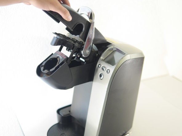

    • While looking upwards from underneath the Keurig, remove the two 8mm Phillips #2 screws from underneath the black plastic "shroud".
  3. Keurig K70 Limit Switch Replacement: crwdns2935265:03crwdnd2935265:01crwdnd2935265:03crwdne2935265:0 Keurig K70 Limit Switch Replacement: crwdns2935265:03crwdnd2935265:02crwdnd2935265:03crwdne2935265:0 Keurig K70 Limit Switch Replacement: crwdns2935265:03crwdnd2935265:03crwdnd2935265:03crwdne2935265:0
    • Remove the black plastic "shroud" by pushing inwards and then pulling upwards to disengage the plastic hooks that are not visible.

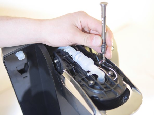

  4. Keurig K70 Limit Switch Replacement: crwdns2935265:04crwdnd2935265:01crwdnd2935265:02crwdne2935265:0 Keurig K70 Limit Switch Replacement: crwdns2935265:04crwdnd2935265:02crwdnd2935265:02crwdne2935265:0
    • Remove the two 10mm Phillips #1 screws from the switch.

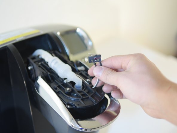

  5. Keurig K70 Limit Switch Replacement: crwdns2935265:05crwdnd2935265:01crwdnd2935265:02crwdne2935265:0 Keurig K70 Limit Switch Replacement: crwdns2935265:05crwdnd2935265:02crwdnd2935265:02crwdne2935265:0
