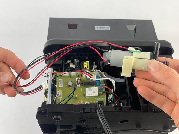

  4. Keurig K-Duo Water Pump Replacement, Water Pump: crwdns2935265:04crwdnd2935265:01crwdnd2935265:02crwdne2935265:0 Keurig K-Duo Water Pump Replacement, Water Pump: crwdns2935265:04crwdnd2935265:02crwdnd2935265:02crwdne2935265:0
    • There are two terminal blocks to remove from the motherboard.
    • Gently disconnect the 2-pin terminal block that has the label "Water Pump" on the motherboard.
    • Gently disconnect the 4-pin terminal block that has the label "IR Sensor."
  5. Keurig K-Duo Water Pump Replacement: crwdns2935265:05crwdnd2935265:01crwdnd2935265:03crwdne2935265:0 Keurig K-Duo Water Pump Replacement: crwdns2935265:05crwdnd2935265:02crwdnd2935265:03crwdne2935265:0 Keurig K-Duo Water Pump Replacement: crwdns2935265:05crwdnd2935265:03crwdnd2935265:03crwdne2935265:0
    • Pull out the water pump from its socket by twisting it so that the bottom is facing you.
    • Remove the plastic tubes from water pump.
  6. Keurig K-Duo Water Pump Replacement: crwdns2935265:06crwdnd2935265:01crwdnd2935265:02crwdne2935265:0 Keurig K-Duo Water Pump Replacement: crwdns2935265:06crwdnd2935265:02crwdnd2935265:02crwdne2935265:0
    • Fully access the water pump by pulling it straight out.
    • Make sure none of the disconnected wires are caught on any of the motherboard components to avoid damage.
