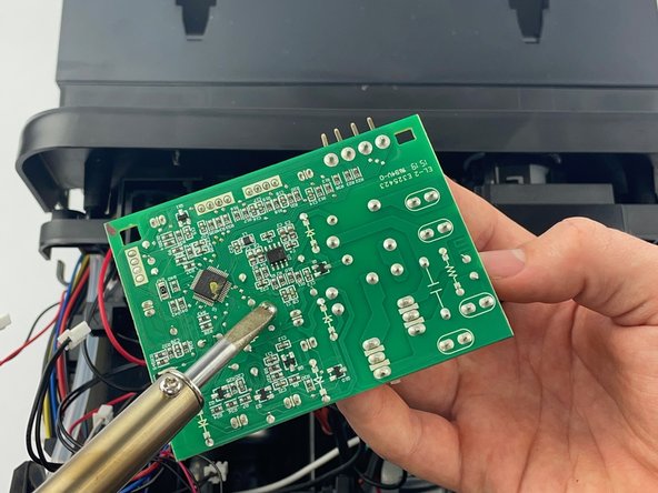

  4. Keurig K-Duo Motherboard Replacement, Motherboard: crwdns2935265:04crwdnd2935265:01crwdnd2935265:02crwdne2935265:0 Keurig K-Duo Motherboard Replacement, Motherboard: crwdns2935265:04crwdnd2935265:02crwdnd2935265:02crwdne2935265:0
    • Gently disconnect all eleven connectors from the motherboard.
    • Gently pull off the four remaining wire terminals.
    • It may be helpful to label each terminal for its original corresponding connection.
    • Be careful not to damage green wire. It will have to be removed by soldering.
  5. Keurig K-Duo Motherboard Replacement: crwdns2935265:05crwdnd2935265:01crwdnd2935265:02crwdne2935265:0 Keurig K-Duo Motherboard Replacement: crwdns2935265:05crwdnd2935265:02crwdnd2935265:02crwdne2935265:0
    • Pull out and flip the motherboard so the back is now facing you.
    • Desolder the solder pad connected to the green wire.
    • Re-solder the existing green wire to the new motherboard.
