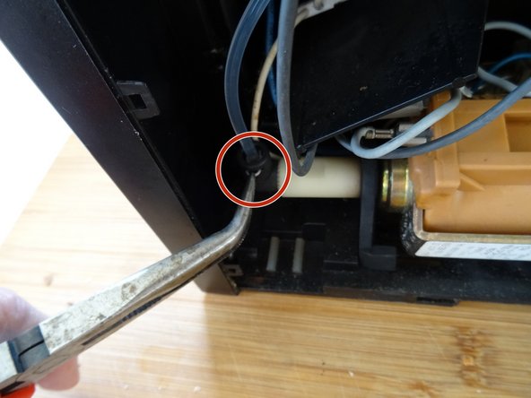

    • The pressure hoses are secured against slipping out with metal clips. Pull out the metal clamp on the hose between the pump and the heating cartridge
    • Disconnect the hose from the pump. Pay attention to the little seal, it probably lingers afterwards. It is good to replace them with a new one when assembling.

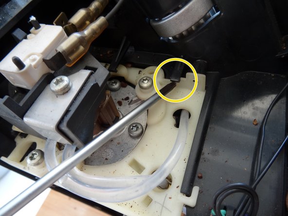

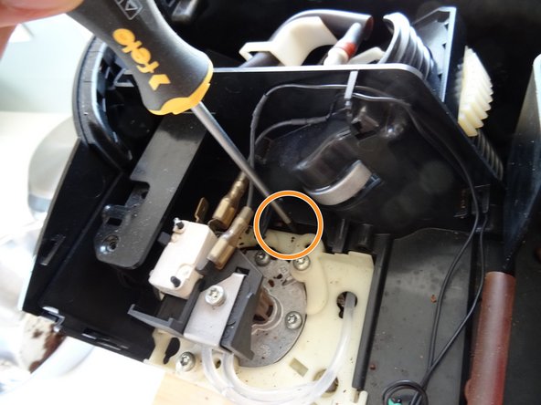

    • The carriage of the heating cartridge is held with two black plastic frames. Press it up with a screwdriver until the carriage comes free.
    • Put the screwdriver into the gap that has opened behind the carriage and lift the carriage forward about 5 mm.

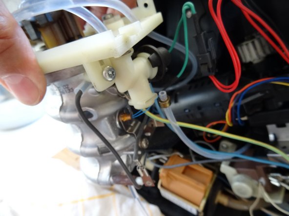

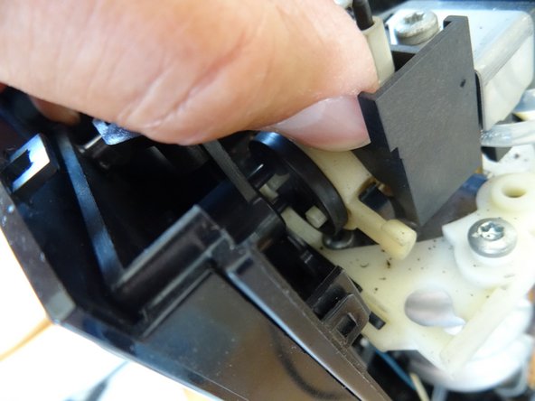

    • In this step, you must disconnect the connection between the steam knob and the steam valve. The button has two pins stuck in a round plate with a cruciform incision. The steam valve also has two pins which engage in this plate from the other side.
    • Pull the front forward about 1 cm until the pins of the knuckle release from the round plate. Then pull out the carriage with the heating cartridge about 2 cm.

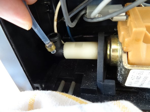

    • Pull out the clamp on the pressure hose that comes out of the outlet valve.
    • Detach the pressure hose. Watch out for the little seal, it's probably stuck in the valve. It is good to replace them with a new one when assembling.

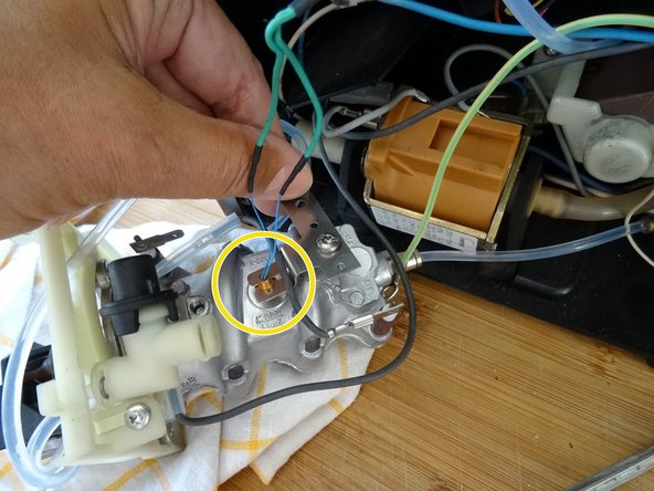

    • There is a thermal fuse on the gray cable between the heater and the pump. It is attached to the heating cartridge with a retaining plate.
    • Loosen the Torx 15 screw on the retaining plate of the thermal fuse.
    • Remove the thermal fuse from the thermoblock.
    • Disconnect the cable lug from the gray cable on the heater.
  15. Jura heating cartridge replacement: crwdns2935265:015crwdnd2935265:01crwdnd2935265:01crwdne2935265:0

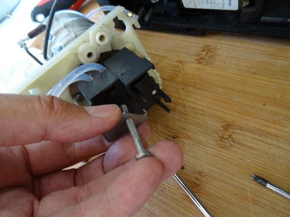

    • When the steam valve is removed, you can finally replace the sled. To do this, turn out three Torx 20 screws.
    • That's the screw on the steam valve, which you removed in the last step.
