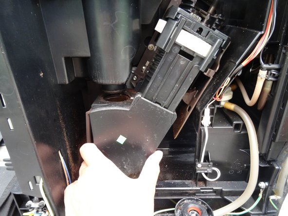

    • Unscrew the two Torx T15 machine screws.
    • Unscrew the Torx T15 screw at the bottom of the hot water inlet.

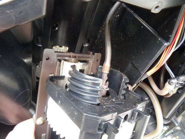

    • Pull the brewing unit out to you. The hose to the coffee spout is still attached at the top.
    • Pull off the hose to the coffee spout.

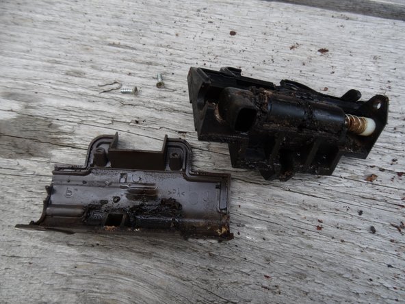

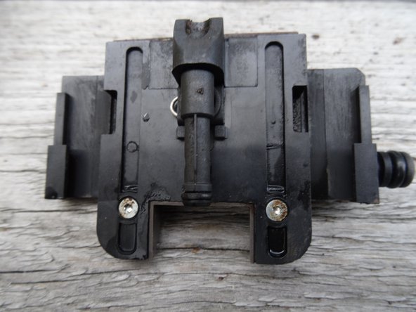

    • Start now with the replacement or revision of the brewing unit.
    • If you want to disassemble the brewing unit for cleaning and installing new seals, follow this or this guides.
    • There is one small difference with this brewing group: the drainage valve is fitted with a cover, but this is easy to remove. Unscrew the two Torx T8 screws.
    • Use these instructions to overhaul the drainage valve.
