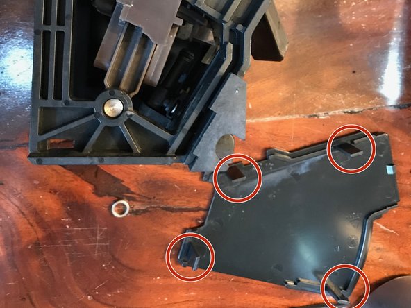

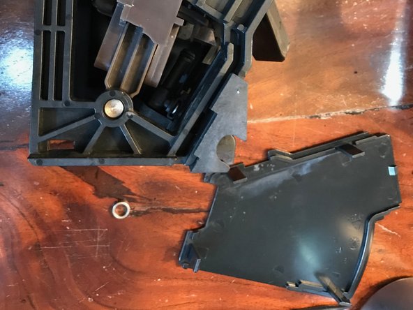

    6. Brewgroup Disassembly, External Lower Left and Right Plates 1 of 3: crwdns2935265:025crwdnd2935265:01crwdnd2935265:03crwdne2935265:0 Brewgroup Disassembly, External Lower Left and Right Plates 1 of 3: crwdns2935265:025crwdnd2935265:02crwdnd2935265:03crwdne2935265:0 Brewgroup Disassembly, External Lower Left and Right Plates 1 of 3: crwdns2935265:025crwdnd2935265:03crwdnd2935265:03crwdne2935265:0
      • removing the plate shown behind the metal poker
      • there are four tabs circled in RED on the already removed plates
      • Next step shows where to release them

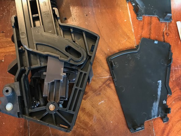

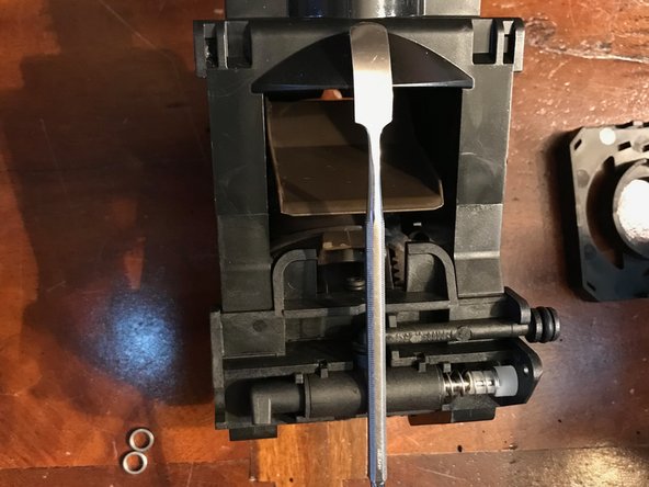

    7. Brewgroup Disassembly, External Lower Left and Right Plates 2 of 3: crwdns2935265:026crwdnd2935265:01crwdnd2935265:03crwdne2935265:0 Brewgroup Disassembly, External Lower Left and Right Plates 2 of 3: crwdns2935265:026crwdnd2935265:02crwdnd2935265:03crwdne2935265:0 Brewgroup Disassembly, External Lower Left and Right Plates 2 of 3: crwdns2935265:026crwdnd2935265:03crwdnd2935265:03crwdne2935265:0
      • Two are easy to see and get to with your finger
      • the other two a little more hidden but not too bad
      • Refer to the previous step showing the plate already removed to get an idea of where they are too.
      • I try to point to them in the pictures with the metal poker.

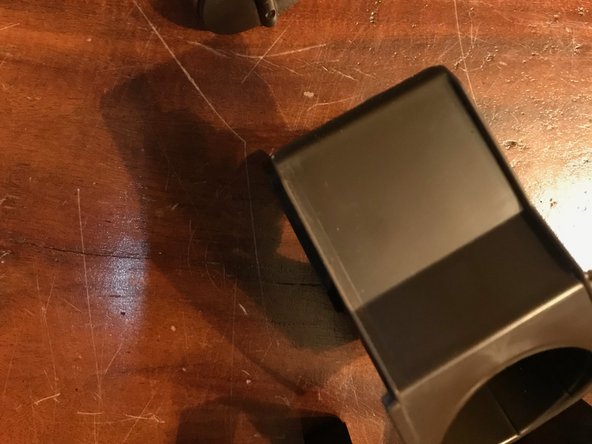

    9. Brewgroup Disassembly, Top removal: crwdns2935265:028crwdnd2935265:01crwdnd2935265:03crwdne2935265:0 Brewgroup Disassembly, Top removal: crwdns2935265:028crwdnd2935265:02crwdnd2935265:03crwdne2935265:0 Brewgroup Disassembly, Top removal: crwdns2935265:028crwdnd2935265:03crwdnd2935265:03crwdne2935265:0
      • Just lifts off, if memory serves me?
      • the part shown under the green rectangle

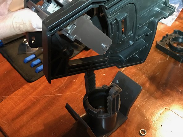

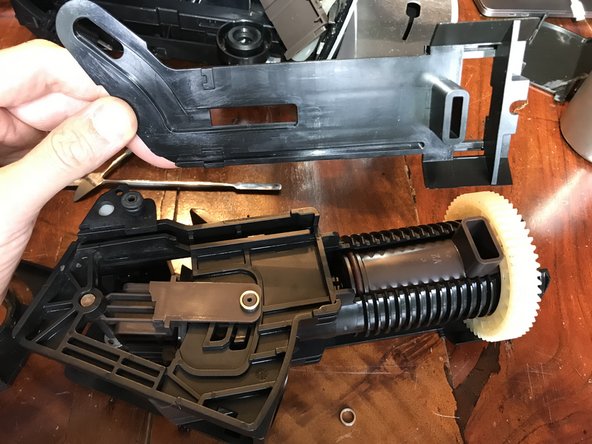

    10. Brewgroup Disassembly, L Bearing guides left and right: crwdns2935265:029crwdnd2935265:01crwdnd2935265:03crwdne2935265:0 Brewgroup Disassembly, L Bearing guides left and right: crwdns2935265:029crwdnd2935265:02crwdnd2935265:03crwdne2935265:0 Brewgroup Disassembly, L Bearing guides left and right: crwdns2935265:029crwdnd2935265:03crwdnd2935265:03crwdne2935265:0
      • Bearing makes an L shaped path on these left and right plates
      • lift the hose out of the way before you remove the plate
      • they just come off no clips

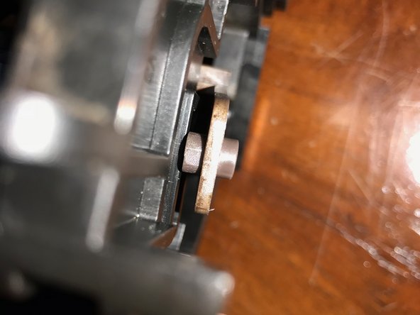

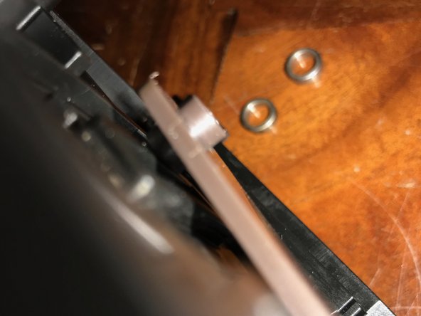

      • CAREFUL there are four small metal bearing parts that can just fall off
      • I clarify where they go in the next step

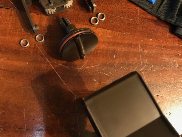

    11. Brewgroup Disassembly, Metal bearing location pictures: crwdns2935265:030crwdnd2935265:01crwdnd2935265:03crwdne2935265:0 Brewgroup Disassembly, Metal bearing location pictures: crwdns2935265:030crwdnd2935265:02crwdnd2935265:03crwdne2935265:0 Brewgroup Disassembly, Metal bearing location pictures: crwdns2935265:030crwdnd2935265:03crwdnd2935265:03crwdne2935265:0
      • These can fall out at any point during assembly / disassembly, so good luck.

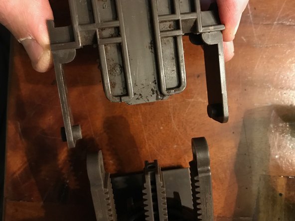

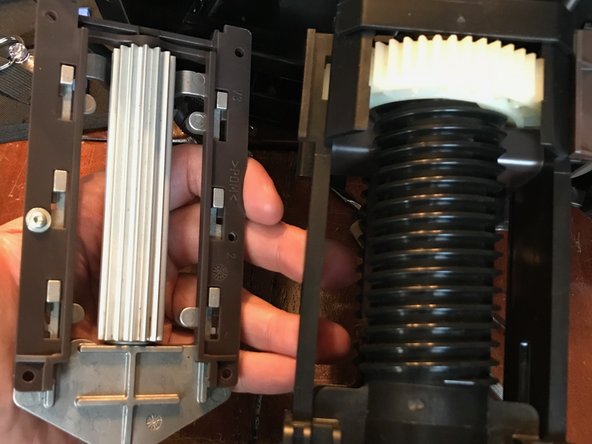

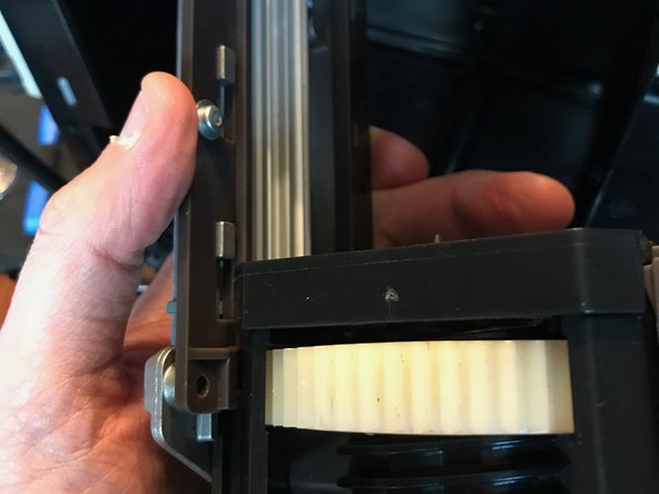

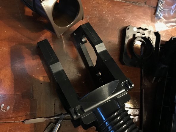

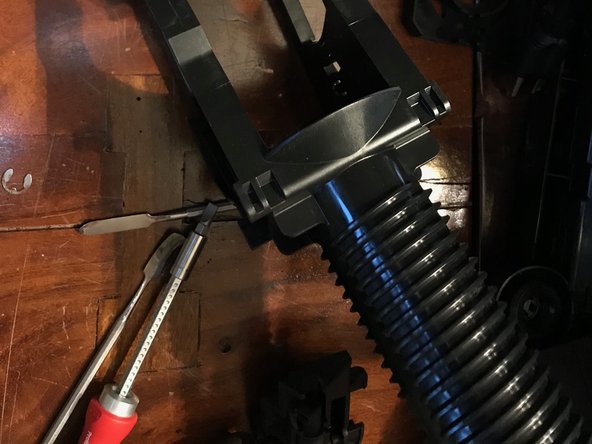

    12. Brewgroup Disassembly, Upper Horizontal Gear and Tamper: crwdns2935265:031crwdnd2935265:01crwdnd2935265:03crwdne2935265:0 Brewgroup Disassembly, Upper Horizontal Gear and Tamper: crwdns2935265:031crwdnd2935265:02crwdnd2935265:03crwdne2935265:0 Brewgroup Disassembly, Upper Horizontal Gear and Tamper: crwdns2935265:031crwdnd2935265:03crwdnd2935265:03crwdne2935265:0
      • The 3rd photo shows the orientation of the upper hose in relation to the lower alignment knob mentioned in step 2

    14. Brewgroup Disassembly, Front Lower assembly: crwdns2935265:033crwdnd2935265:01crwdnd2935265:03crwdne2935265:0 Brewgroup Disassembly, Front Lower assembly: crwdns2935265:033crwdnd2935265:02crwdnd2935265:03crwdne2935265:0 Brewgroup Disassembly, Front Lower assembly: crwdns2935265:033crwdnd2935265:03crwdnd2935265:03crwdne2935265:0
      • Just slides off
      • I think this is similar to the Drainage valve referred to in this other guide
      • except that this appears to be a different model?

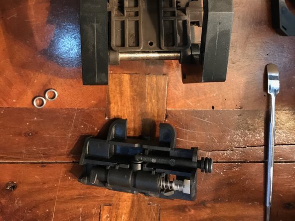

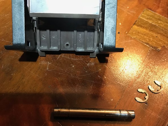

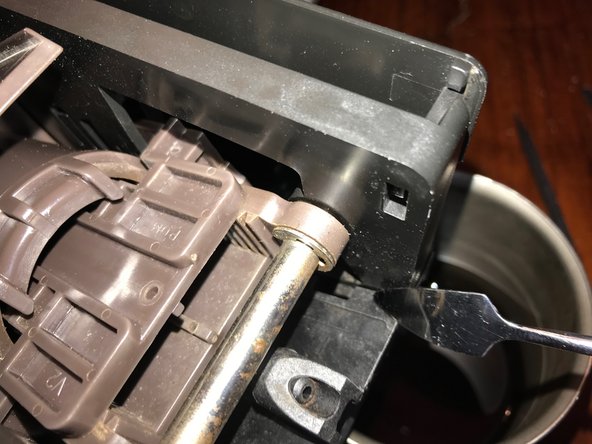

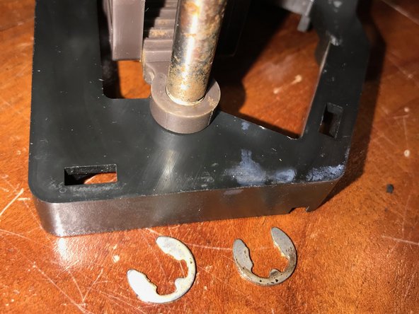

    15. Brewgroup Disassembly, Lower Shaft and snap rings: crwdns2935265:034crwdnd2935265:01crwdnd2935265:03crwdne2935265:0 Brewgroup Disassembly, Lower Shaft and snap rings: crwdns2935265:034crwdnd2935265:02crwdnd2935265:03crwdne2935265:0 Brewgroup Disassembly, Lower Shaft and snap rings: crwdns2935265:034crwdnd2935265:03crwdnd2935265:03crwdne2935265:0
      • remove with a small flat screw driver reattach with needle nose pliers
    16. Brewgroup Disassembly, Lower shaft clean up: crwdns2935265:035crwdnd2935265:01crwdnd2935265:01crwdne2935265:0
      • scrubbed clean with a little soap and water

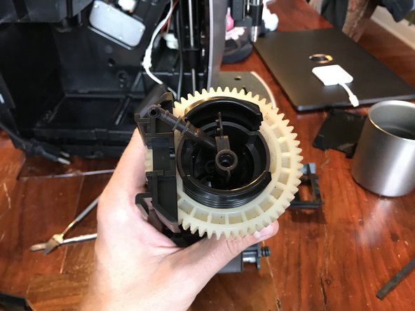

    17. Brewgroup Disassembly, Lower Inner 1 of 2: crwdns2935265:036crwdnd2935265:01crwdnd2935265:03crwdne2935265:0 Brewgroup Disassembly, Lower Inner 1 of 2: crwdns2935265:036crwdnd2935265:02crwdnd2935265:03crwdne2935265:0 Brewgroup Disassembly, Lower Inner 1 of 2: crwdns2935265:036crwdnd2935265:03crwdnd2935265:03crwdne2935265:0
      • Just gently wiggle and twist it apart

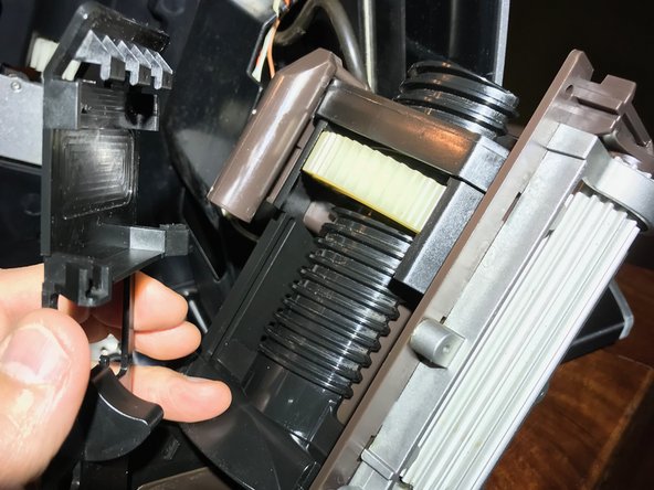

    18. Brewgroup Disassembly, Lower Inner 2 of 2: crwdns2935265:037crwdnd2935265:01crwdnd2935265:01crwdne2935265:0

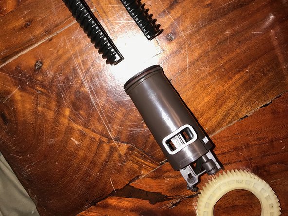

      • CRUCIAL STEP: I messed this up the first time I reassembled this nearly broke the gearing and generated an error 8
      • Error 8: I think is failure of the brewgroup to home.
      • Place lower portion with the white gears at the top of motion inside the cylinder
      • then slide in upper portion with the red o-ring then slide both together to the bottom
      • I put a little vegetable oil with my finger on the inner cylinder wall other wise it was super dry and hard to move.
