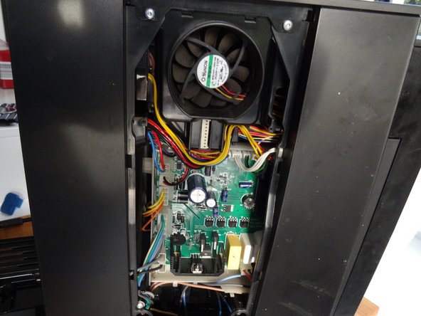

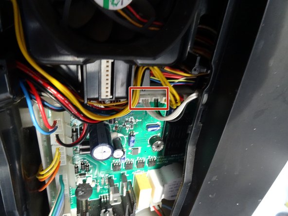

    • The oval head screws are on the back this time. Grasp the ribbed bezel and lift it a few millimeters upwards. Then pull it out at the bottom and lift it off.
    • These screws have an oval head that makes them look like rivets (picture 2). You need a special key or the iFixit bit to open them. Here is a do-it-yourself guide. If necessary, you can also use pointed pliers. Jura wants to keep us out of our own machines!
    • Remove the four oval head screws.
    • Disconnect the blue plug for Jura Connect.
    • Lift the black panel away from the back. The power board is now visible.
