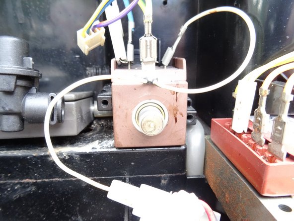

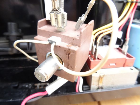

  12. Jura Z Model heat exchanger replacement, Jura Z5 Drain valve magnet: crwdns2935265:012crwdnd2935265:01crwdnd2935265:03crwdne2935265:0 Jura Z Model heat exchanger replacement, Jura Z5 Drain valve magnet: crwdns2935265:012crwdnd2935265:02crwdnd2935265:03crwdne2935265:0 Jura Z Model heat exchanger replacement, Jura Z5 Drain valve magnet: crwdns2935265:012crwdnd2935265:03crwdnd2935265:03crwdne2935265:0
    • The solenoid is secured with a bracket held in place by two Torx T10 screws
    • Remove the two screws.
    • Take off the bracket
    • Take the solenoid out.
    • Disconnect the cables from the solenoid.
    • If the solenoid is only removed to access other parts, the cables can remain connected.
  13. Jura Z Model heat exchanger replacement: crwdns2935265:013crwdnd2935265:01crwdnd2935265:01crwdne2935265:0
    • In newer models, there is a drainage motor instead of a magnet. In principle, it is removed in the same way as the magnet. Use these instructions
    • Remove the two Torx T15 screws on the drain motor and take out the motor. The side with the blue cable is marked with a dot.
    • If you have only removed the motor to make further repairs, you can proceed to the next step.
    • First leave the motor connected. Trigger a flush and observe if the pin moves back and forth.
    • The motor does not necessarily need to be replaced. Bend away the four metal tabs on the motor flange and detach the metal housing from the black gear case. Now you can try to turn the armature. The pin should move smoothly back and forth. If not, some silicone grease on the drive worm can help.

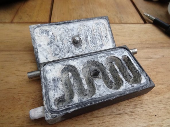

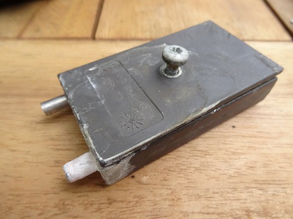

  14. Jura Z Model heat exchanger replacement, Heat exchanger: crwdns2935265:014crwdnd2935265:01crwdnd2935265:03crwdne2935265:0 Jura Z Model heat exchanger replacement, Heat exchanger: crwdns2935265:014crwdnd2935265:02crwdnd2935265:03crwdne2935265:0 Jura Z Model heat exchanger replacement, Heat exchanger: crwdns2935265:014crwdnd2935265:03crwdnd2935265:03crwdne2935265:0
    • The heat exchanger is located at the bottom of the unit.
    • The two pictures show traces of lime everywhere. The heat exchanger was no longer tight.
    • To get to it better, you should remove the ceramic valve, the motor, and the solenoid for the drain valve, all work is quite easy to do.
    • We assume that you have already done this

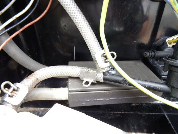

  15. Jura Z Model heat exchanger replacement: crwdns2935265:015crwdnd2935265:01crwdnd2935265:02crwdne2935265:0 Jura Z Model heat exchanger replacement: crwdns2935265:015crwdnd2935265:02crwdnd2935265:02crwdne2935265:0
    • The heat exchanger is connected with three hoses, and there is also an outlet in the base plate. When assembling, make sure that the seal is still in place when you push the heat exchanger in. Note which hose is where.
    • One of the exhaust valves runs above the heat exchanger. It is much more convenient if you pull out the clamp on the exhaust valve and disconnect the exhaust valve. Pay attention to the O-ring.
    • Pull off the three hoses and lift the heat exchanger up.
Work through the steps in reverse order to reassemble your device.
