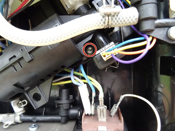

  9. Jura Z Model Motor replacement, Motor: crwdns2935265:09crwdnd2935265:01crwdnd2935265:03crwdne2935265:0 Jura Z Model Motor replacement, Motor: crwdns2935265:09crwdnd2935265:02crwdnd2935265:03crwdne2935265:0 Jura Z Model Motor replacement, Motor: crwdns2935265:09crwdnd2935265:03crwdnd2935265:03crwdne2935265:0
    • The drive motor is fastened with two Torx T20 screws.
    • Remove the two screws.
    • Take out the motor

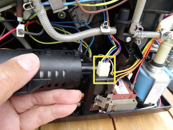

    • The encoder that counts the revolutions is located on the motor shaft. Disconnect the plug from the encoder
  10. Jura Z Model Motor replacement: crwdns2935265:010crwdnd2935265:01crwdnd2935265:01crwdne2935265:0
    • The motor is only connected with two cables. If you want to replace it completely, you have to follow the cables and disconnect them. You can also cut them and solder them, but make sure that they are well insulated, e.g. with heat shrink tubing.
