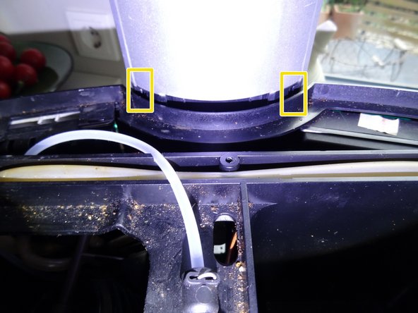

    • Various hoses hinder the further opening of the front cover. You need to remove the steam valve keypad from the cover.
    • Use a spudger to lift the two notches at the top of the front cover a bit to release the keypad at the top.
    • Lift the keypad upwards and pull it to the back. The steam pipe will slide out from its connection.
    • All hoses can remain connected.

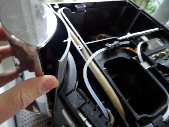

    • Remove the silicone hose leading from the steam valve to the coffee spout. If it is secured with a cable tie which must be removed first.
    • The front cover is now free and can be opened.

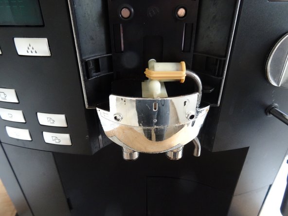

    • Turn the machine so that the back is facing you and push the coffee spout up as far as it will go.
    • Directly above the upper edge of the housing are two openings on the back of the coffee spout. In them you will see two detents. Carefully press the latches inwards, then you can remove the cover of the coffee spout.
  9. Jura Impressa S models dispensing head revision: crwdns2935265:09crwdnd2935265:01crwdnd2935265:02crwdne2935265:0 Jura Impressa S models dispensing head revision: crwdns2935265:09crwdnd2935265:02crwdnd2935265:02crwdne2935265:0
    • The opened coffee dispenser looks like this.

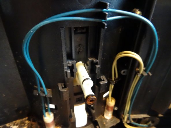

    • Open the front panel like a door.

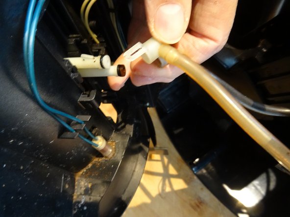

    • The supply lines are connected with an angle piece. Above on the angle piece is a clip. Carefully bend it little upwards and pull out the angle piece. It might be stuck a little at first.
