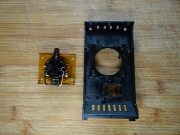

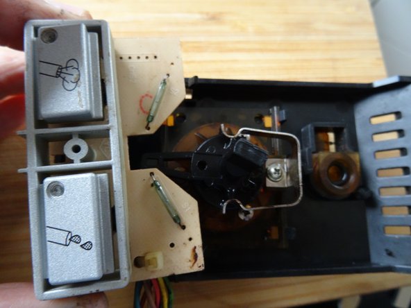

  10. Jura Impressa S Model Water Boiler repair/replacment: crwdns2935265:010crwdnd2935265:01crwdnd2935265:02crwdne2935265:0 Jura Impressa S Model Water Boiler repair/replacment: crwdns2935265:010crwdnd2935265:02crwdnd2935265:02crwdne2935265:0
    • Carefully unclip the circuit board with the switches. Caution: the two reed switches (marked green) are made of glass and break very easily.
    • Release the two latches on the pushbutton board.
    • Lift the board very carefully by the bottom and pull it off the unit.
    • The unit is free.

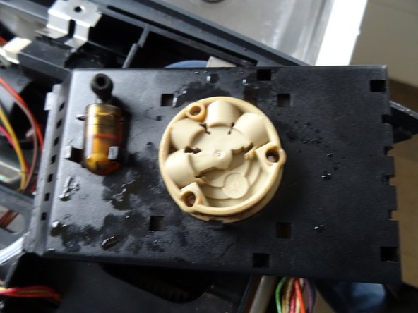

  11. Jura Impressa S Model Water Boiler repair/replacment: crwdns2935265:011crwdnd2935265:01crwdnd2935265:02crwdne2935265:0 Jura Impressa S Model Water Boiler repair/replacment: crwdns2935265:011crwdnd2935265:02crwdnd2935265:02crwdne2935265:0
    • Loosen the four latches on the steam valve.
    • Gently lift the steam valve upwards.
  12. Jura Impressa S Model Water Boiler repair/replacment: crwdns2935265:012crwdnd2935265:01crwdnd2935265:01crwdne2935265:0
    • In the next steps you have to be very careful: inside the valve there are two ceramic discs that stick easily. If they fall off, they break easily and are broken.
    • Loosen the three Phillips screws on the black valve bonnet and very slowly lift it upwards off the valve body.

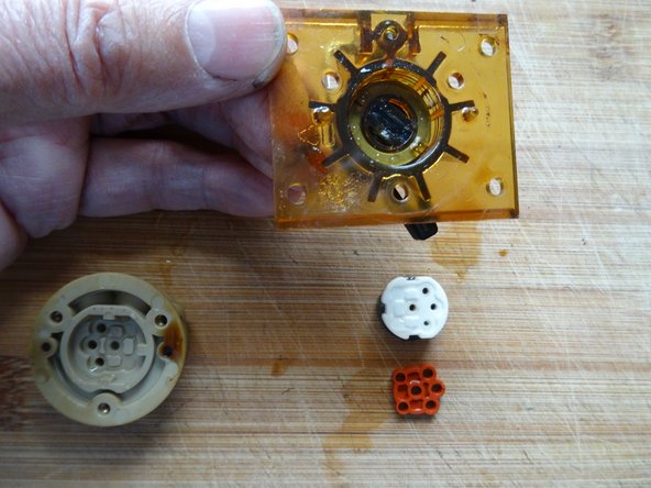

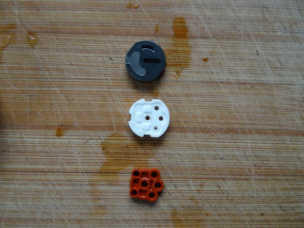

  13. Jura Impressa S Model Water Boiler repair/replacment: crwdns2935265:013crwdnd2935265:01crwdnd2935265:03crwdne2935265:0 Jura Impressa S Model Water Boiler repair/replacment: crwdns2935265:013crwdnd2935265:02crwdnd2935265:03crwdne2935265:0 Jura Impressa S Model Water Boiler repair/replacment: crwdns2935265:013crwdnd2935265:03crwdnd2935265:03crwdne2935265:0
    • Turn the valve bonnet over. The molded seal becomes visible. Make sure that it is seated correctly; it must be seated in the valve body again later, otherwise the valve will not work.
    • Carefully lift out the molded seal and the two ceramic washers. Note the exact installation position.
    • Now you can clean all parts. If the seal is defective, you need to replace it.
    • Pay close attention to the correct orientation when assembling.
