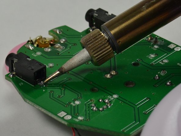

    • Preheat the soldering iron .
    • Locate the wires that connect to the transducer.
    • Use a soldering iron and solder vacuum to unsolder the wires connected to the transducer.

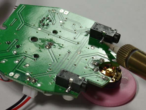

  10. Jumper Angelsounds JPD-100S Headphone Jacks Replacement: crwdns2935265:010crwdnd2935265:01crwdnd2935265:02crwdne2935265:0 Jumper Angelsounds JPD-100S Headphone Jacks Replacement: crwdns2935265:010crwdnd2935265:02crwdnd2935265:02crwdne2935265:0
    • Place the motherboard in a position that allows easy access to the jacks.
  11. Jumper Angelsounds JPD-100S Headphone Jacks Replacement: crwdns2935265:011crwdnd2935265:01crwdnd2935265:03crwdne2935265:0 Jumper Angelsounds JPD-100S Headphone Jacks Replacement: crwdns2935265:011crwdnd2935265:02crwdnd2935265:03crwdne2935265:0 Jumper Angelsounds JPD-100S Headphone Jacks Replacement: crwdns2935265:011crwdnd2935265:03crwdnd2935265:03crwdne2935265:0
    • Desolder the three solder joints securing each of the headphone jacks.
    • Try not to melt the motherboard when removing solder that secures the jacks.
  12. Jumper Angelsounds JPD-100S Headphone Jacks Replacement: crwdns2935265:012crwdnd2935265:01crwdnd2935265:01crwdne2935265:0
    • Remove the jacks by pulling them out of the motherboard.
