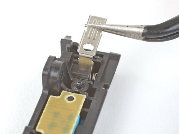

    6. Joy-Con Buckle Lock Replacement, Remove the buckle lock bracket: crwdns2935265:06crwdnd2935265:01crwdnd2935265:01crwdne2935265:0
      • Use a Phillips #00 driver to remove the screw securing the buckle lock retaining bracket.
    7. Joy-Con Buckle Lock Replacement: crwdns2935265:07crwdnd2935265:01crwdnd2935265:03crwdne2935265:0 Joy-Con Buckle Lock Replacement: crwdns2935265:07crwdnd2935265:02crwdnd2935265:03crwdne2935265:0 Joy-Con Buckle Lock Replacement: crwdns2935265:07crwdnd2935265:03crwdnd2935265:03crwdne2935265:0
      • Slide one side of a pair of pointed tweezers under the flat part in the middle of the buckle lock bracket.
      • Grasp the bracket with the tweezers and pull the bracket straight away from the charging rail to remove it.
      • Be careful when you remove the bracket, as the spring and old buckle lock may shoot out and be easily lost.

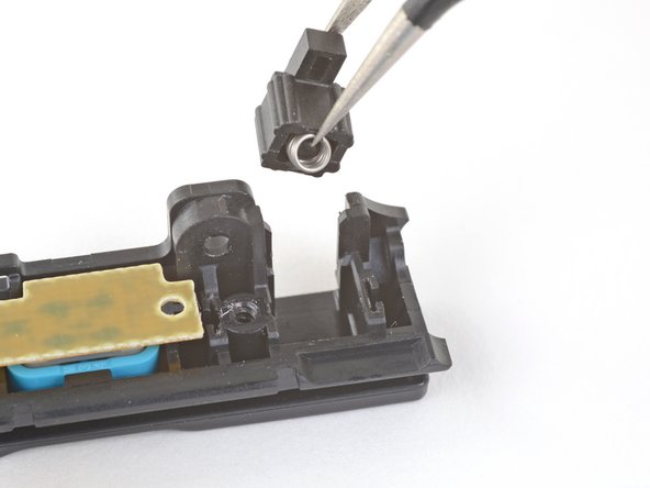

    8. Joy-Con Buckle Lock Replacement, Remove the buckle lock: crwdns2935265:08crwdnd2935265:01crwdnd2935265:03crwdne2935265:0 Joy-Con Buckle Lock Replacement, Remove the buckle lock: crwdns2935265:08crwdnd2935265:02crwdnd2935265:03crwdne2935265:0 Joy-Con Buckle Lock Replacement, Remove the buckle lock: crwdns2935265:08crwdnd2935265:03crwdnd2935265:03crwdne2935265:0
      • Lift the buckle lock slightly out of its slot in the charging rail, just until the spring is exposed enough that you can grab it with tweezers.
      • Grab the buckle lock such that the tweezers are around both sides of the lock and holding the spring inside the lock.
      • When you pull the lock out, the spring can shoot out. Make sure you have a firm grip with the tweezers.
      • Pull the buckle lock out of its slot in the charging rail.
      • During reassembly, make sure to move the spring from the old lock to the new one.
