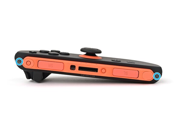

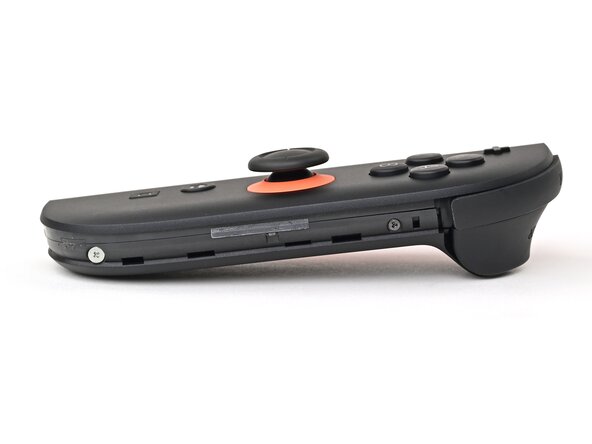

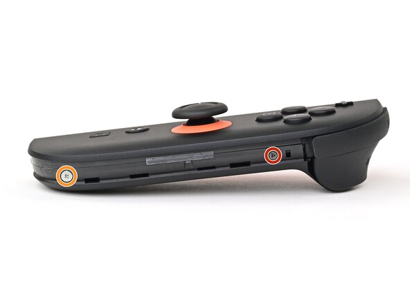

  1. Joy-Con 2 (Right) Joystick Replacement, Remove the left edge screws: crwdns2935265:01crwdnd2935265:01crwdnd2935265:02crwdne2935265:0 Joy-Con 2 (Right) Joystick Replacement, Remove the left edge screws: crwdns2935265:01crwdnd2935265:02crwdnd2935265:02crwdne2935265:0
    • Use a tri-point Y00 driver to remove the two 3.1 mm‑long black screws on the left edge of the controller.

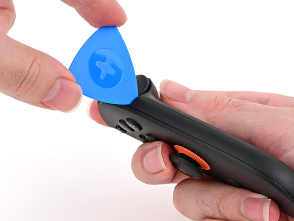

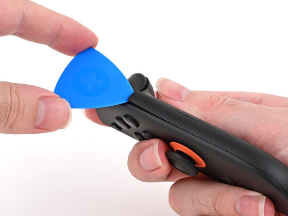

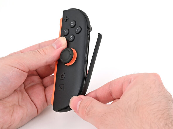

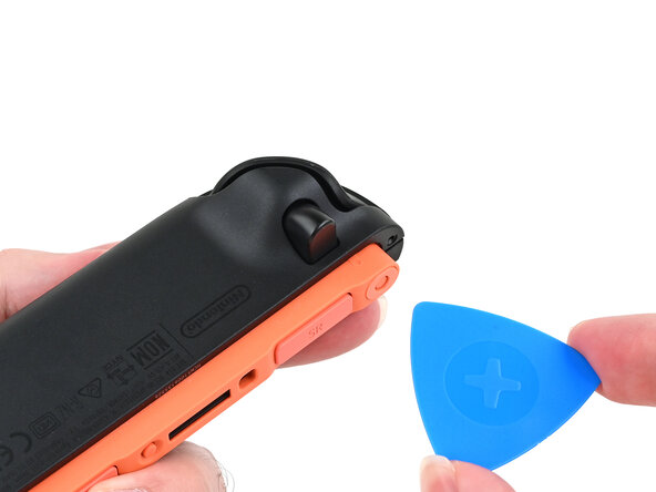

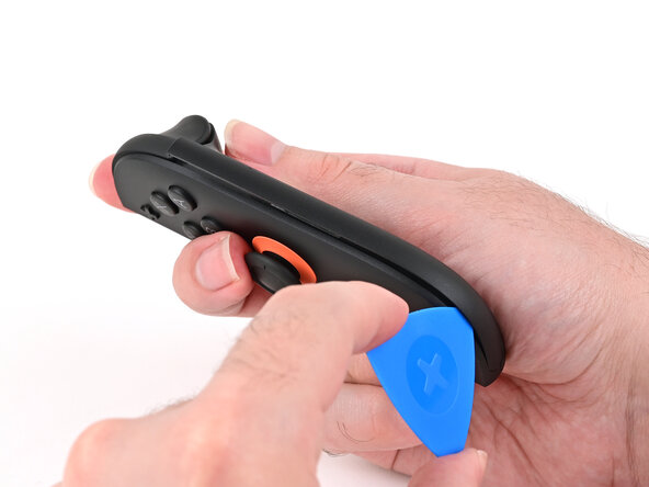

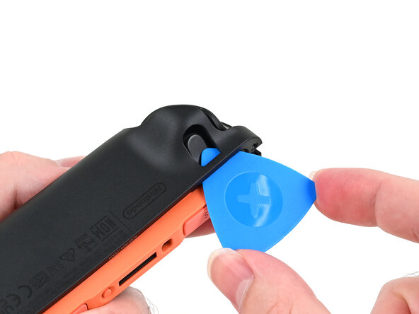

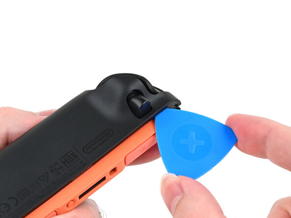

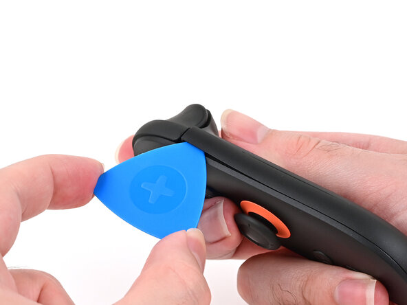

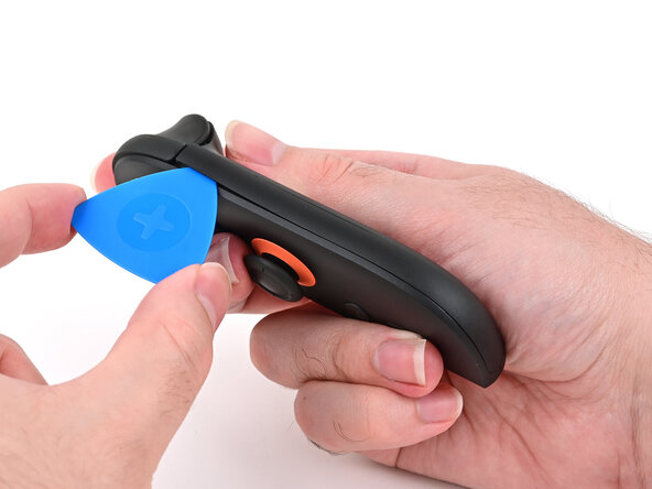

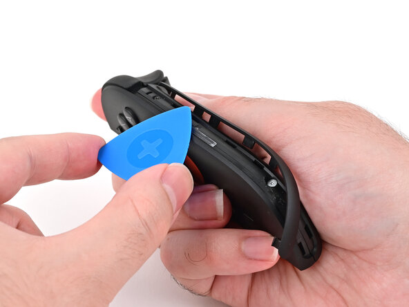

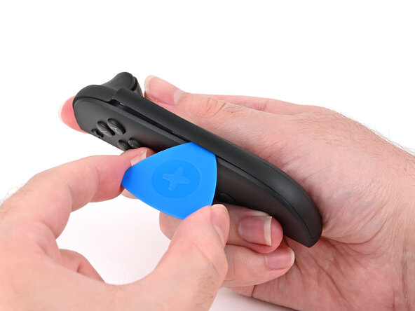

  2. Joy-Con 2 (Right) Joystick Replacement, Insert an opening pick: crwdns2935265:02crwdnd2935265:01crwdnd2935265:03crwdne2935265:0 Joy-Con 2 (Right) Joystick Replacement, Insert an opening pick: crwdns2935265:02crwdnd2935265:02crwdnd2935265:03crwdne2935265:0 Joy-Con 2 (Right) Joystick Replacement, Insert an opening pick: crwdns2935265:02crwdnd2935265:03crwdnd2935265:03crwdne2935265:0
    • Insert an opening pick into the gap underneath the bumper button on the right side of the controller, with a point of the pick pointing downwards.
    • Pry up to slightly lift the plastic strip running across the right edge of the controller.
    • Slide the opening pick around to the front of the controller.

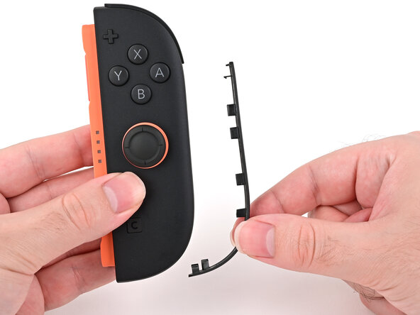

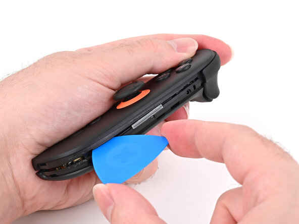

  3. Joy-Con 2 (Right) Joystick Replacement, Separate the plastic strip: crwdns2935265:03crwdnd2935265:01crwdnd2935265:03crwdne2935265:0 Joy-Con 2 (Right) Joystick Replacement, Separate the plastic strip: crwdns2935265:03crwdnd2935265:02crwdnd2935265:03crwdne2935265:0 Joy-Con 2 (Right) Joystick Replacement, Separate the plastic strip: crwdns2935265:03crwdnd2935265:03crwdnd2935265:03crwdne2935265:0
    • Slide the opening pick down the plastic strip to separate the clips and adhesive securing it to the controller's body.

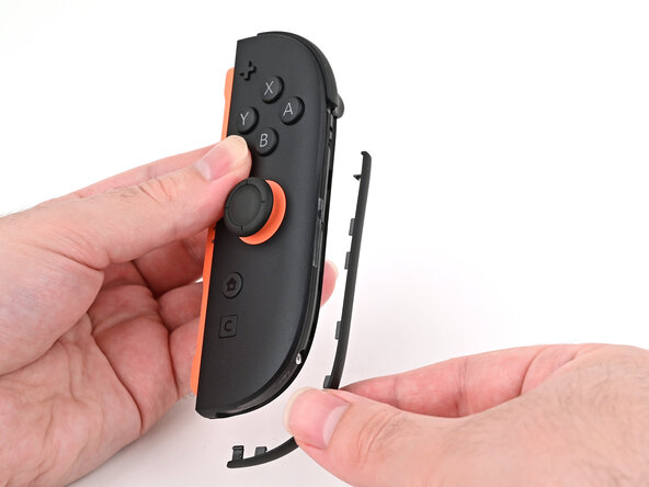

  4. Joy-Con 2 (Right) Joystick Replacement, Remove the plastic strip: crwdns2935265:04crwdnd2935265:01crwdnd2935265:03crwdne2935265:0 Joy-Con 2 (Right) Joystick Replacement, Remove the plastic strip: crwdns2935265:04crwdnd2935265:02crwdnd2935265:03crwdne2935265:0 Joy-Con 2 (Right) Joystick Replacement, Remove the plastic strip: crwdns2935265:04crwdnd2935265:03crwdnd2935265:03crwdne2935265:0
    • Pry up on the bottom edge of the plastic strip with slow, steady force.
    • Repeat this prying action along the length of the strip until it's fully detached.
  5. Joy-Con 2 (Right) Joystick Replacement: crwdns2935265:05crwdnd2935265:01crwdnd2935265:01crwdne2935265:0
    • Remove the plastic strip.

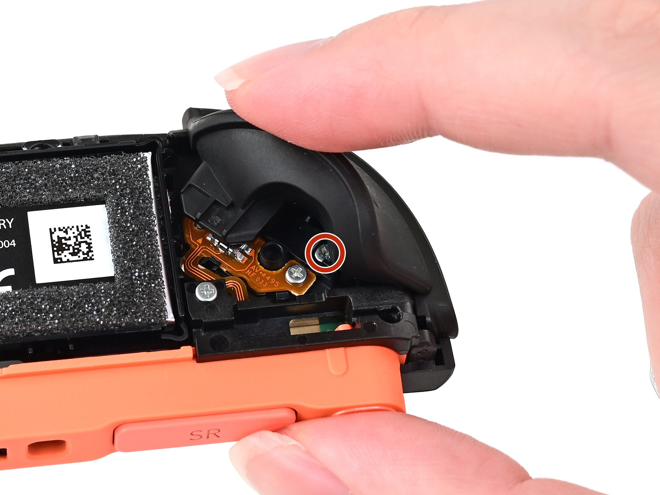

  6. Joy-Con 2 (Right) Joystick Replacement, Remove the right edge screws: crwdns2935265:06crwdnd2935265:01crwdnd2935265:02crwdne2935265:0 Joy-Con 2 (Right) Joystick Replacement, Remove the right edge screws: crwdns2935265:06crwdnd2935265:02crwdnd2935265:02crwdne2935265:0
    • Remove the two screws on the right edge of the controller:
    • One 3.1 mm‑long tri-point Y00 black screw
    • One 3.0 mm‑long JIS 00 silver screw
    • You can use a Phillips screwdriver in a pinch, but you risk damaging or stripping the screw. Push down firmly on the screwdriver and twist slowly. Often, switching drivers may help, even if they're the same size.

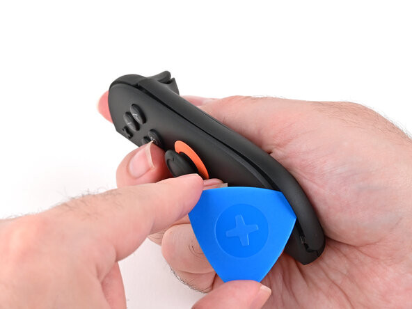

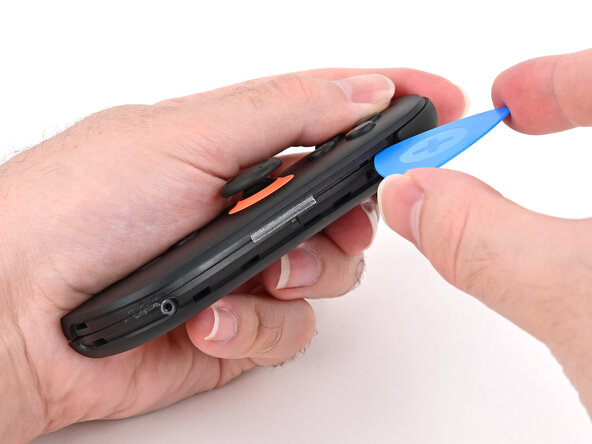

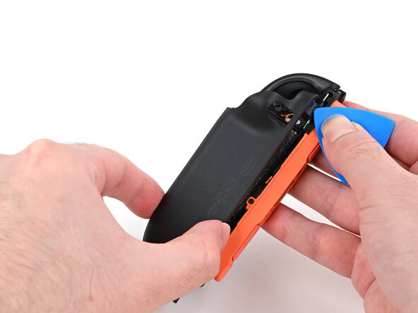

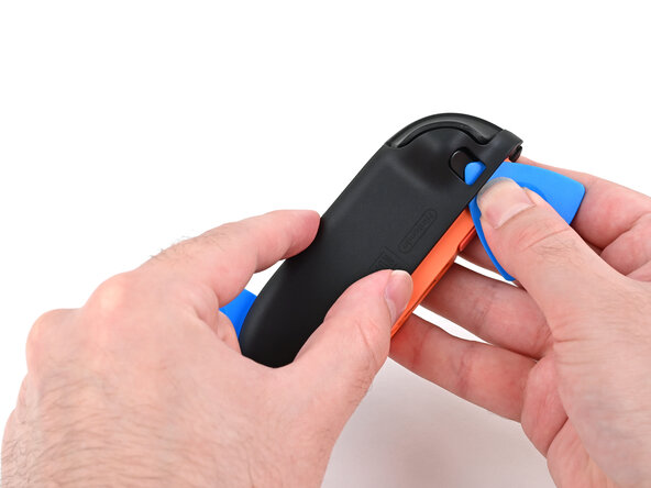

  7. Joy-Con 2 (Right) Joystick Replacement, Insert an opening pick: crwdns2935265:07crwdnd2935265:01crwdnd2935265:02crwdne2935265:0 Joy-Con 2 (Right) Joystick Replacement, Insert an opening pick: crwdns2935265:07crwdnd2935265:02crwdnd2935265:02crwdne2935265:0
    • Don't try to remove the back cover yet.
    • Insert an opening pick into the gap between the front and back halves of the controller on its right side.
    • Slide the pick down the controller to disengage the clips.
    • Leave the opening pick at the bottom of the controller's right edge, just before its curve.
    • The opening pick will fall out once the back cover is removed. If it falls out before then, put it back to keep the two halves separated.

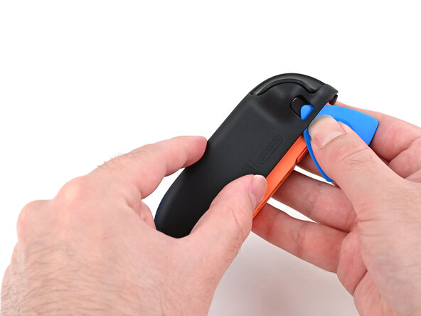

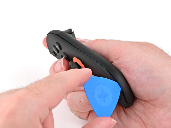

  8. Joy-Con 2 (Right) Joystick Replacement, Insert a second opening pick: crwdns2935265:08crwdnd2935265:01crwdnd2935265:03crwdne2935265:0 Joy-Con 2 (Right) Joystick Replacement, Insert a second opening pick: crwdns2935265:08crwdnd2935265:02crwdnd2935265:03crwdne2935265:0 Joy-Con 2 (Right) Joystick Replacement, Insert a second opening pick: crwdns2935265:08crwdnd2935265:03crwdnd2935265:03crwdne2935265:0
    • Hold the controller upside-down.
    • Insert a point of another opening pick next to the release button towards the top of the controller.
    • Use the opening pick to press the release button through the gap.

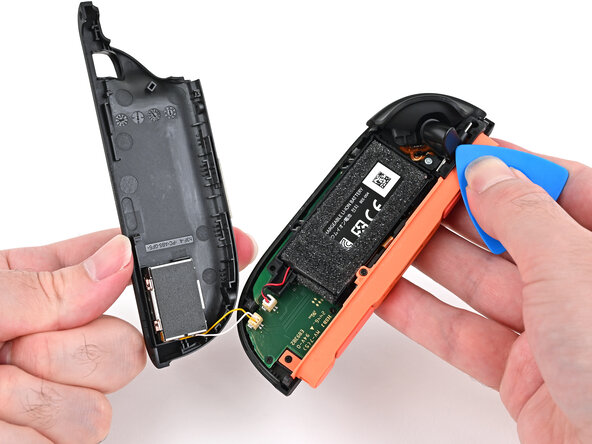

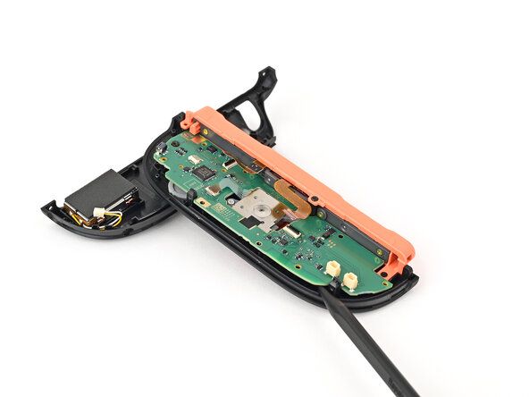

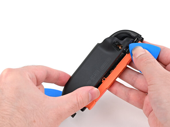

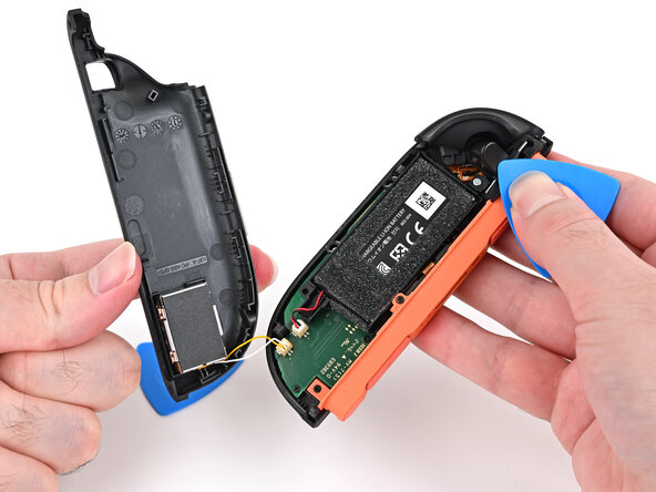

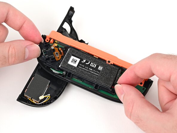

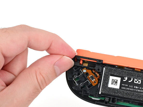

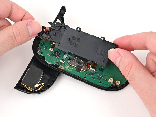

  9. Joy-Con 2 (Right) Joystick Replacement, Release the back cover: crwdns2935265:09crwdnd2935265:01crwdnd2935265:03crwdne2935265:0 Joy-Con 2 (Right) Joystick Replacement, Release the back cover: crwdns2935265:09crwdnd2935265:02crwdnd2935265:03crwdne2935265:0 Joy-Con 2 (Right) Joystick Replacement, Release the back cover: crwdns2935265:09crwdnd2935265:03crwdnd2935265:03crwdne2935265:0
    • The back cover is connected to the controller by a cable at the bottom. Don't try to remove it completely yet.
    • While holding the release button with the opening pick, use your other hand to slide the back cover down to release the clips securing it to the controller's body.
    • Open the back cover.

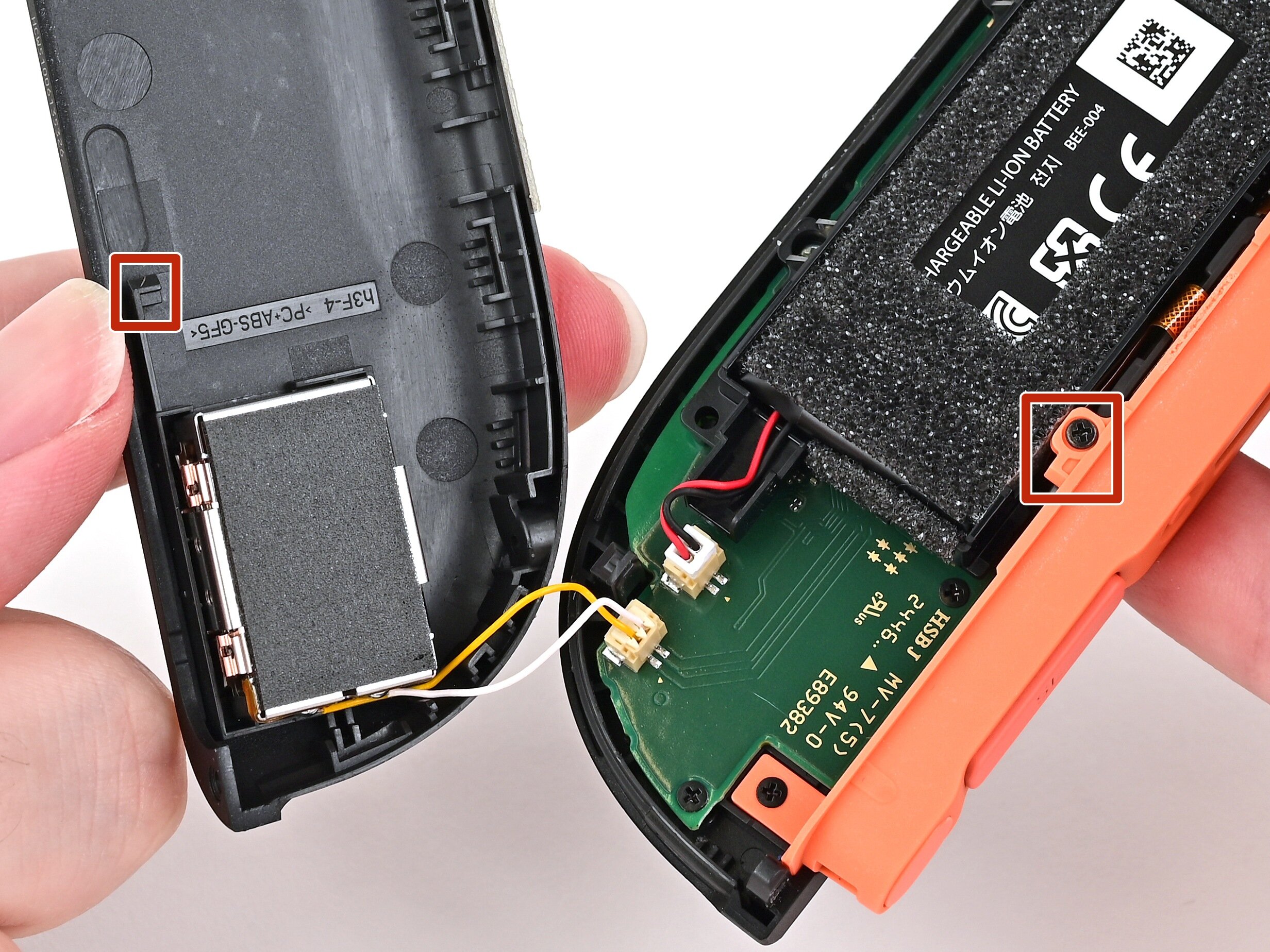

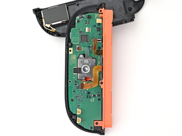

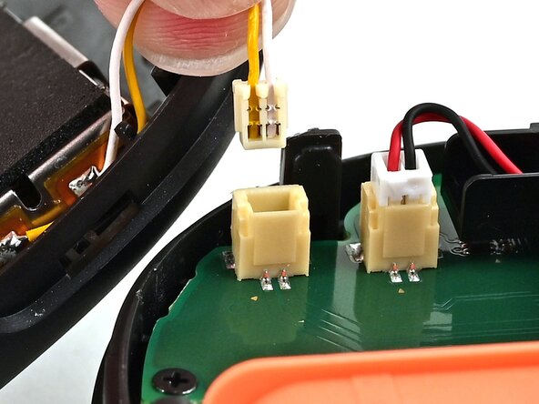

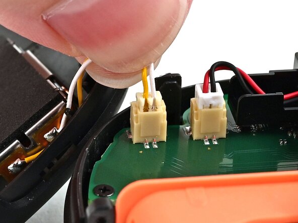

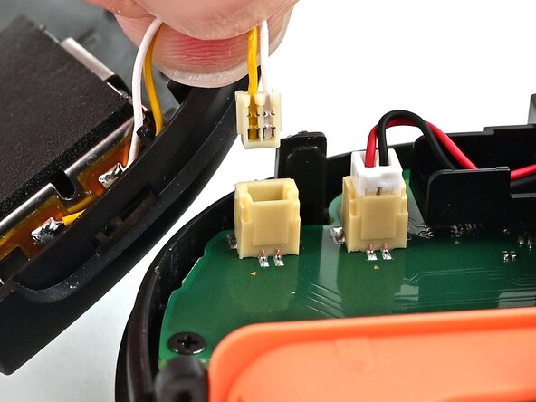

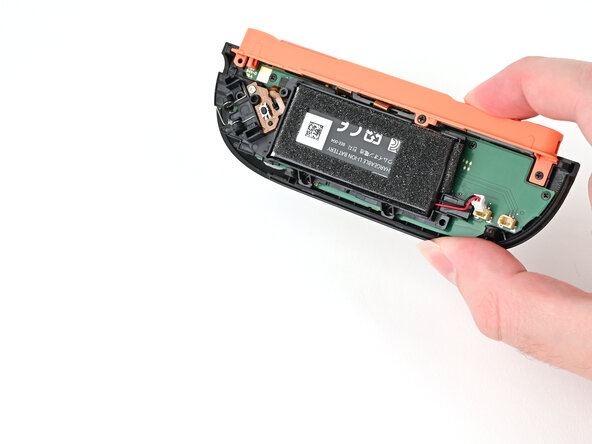

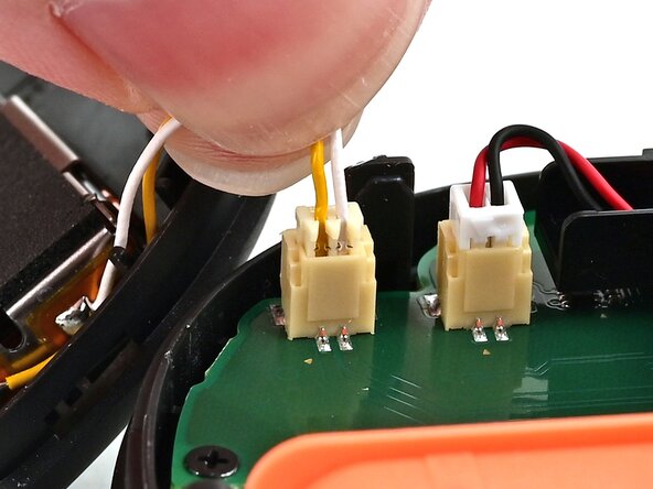

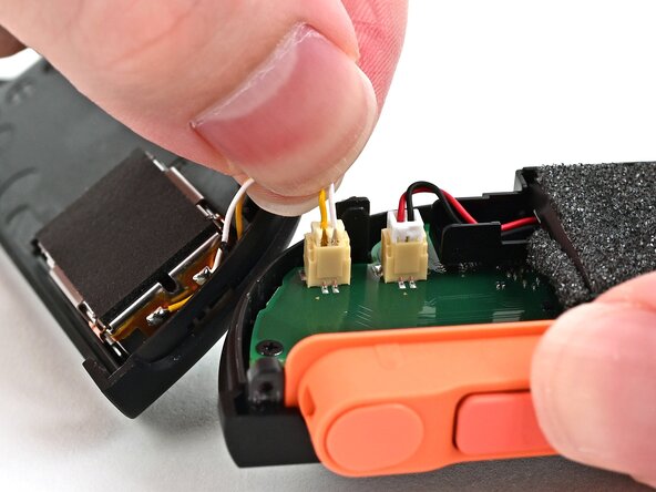

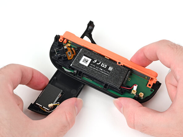

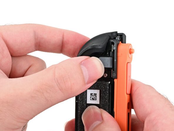

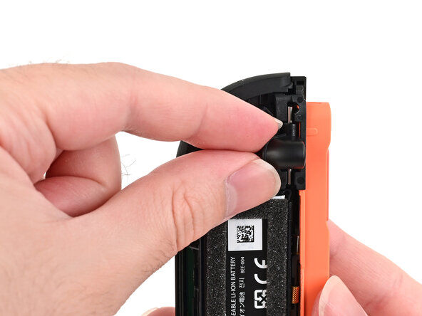

  10. Joy-Con 2 (Right) Joystick Replacement, Remove the back cover: crwdns2935265:010crwdnd2935265:01crwdnd2935265:03crwdne2935265:0 Joy-Con 2 (Right) Joystick Replacement, Remove the back cover: crwdns2935265:010crwdnd2935265:02crwdnd2935265:03crwdne2935265:0 Joy-Con 2 (Right) Joystick Replacement, Remove the back cover: crwdns2935265:010crwdnd2935265:03crwdnd2935265:03crwdne2935265:0
    • Firmly grasp the two wires (yellow and white) above the rumble motor connector, located at the bottom of the controller's board, and pull the beige connector out of its socket.
    • Pulling the cable won't damage it, but don't dig your nails into the plastic sheathing.
    • Remove the back cover.

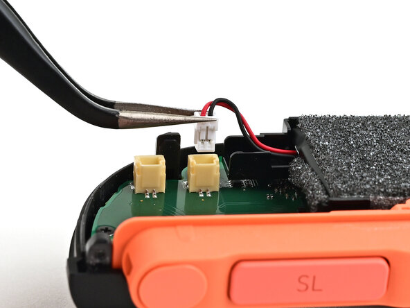

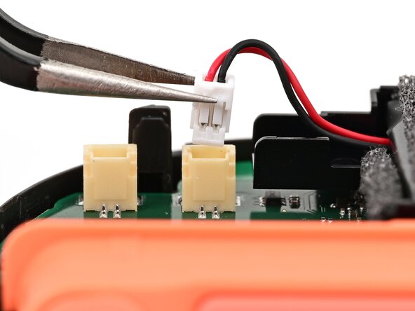

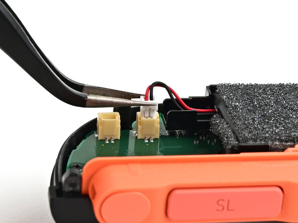

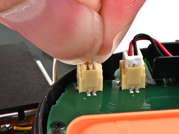

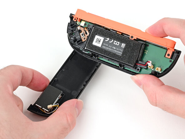

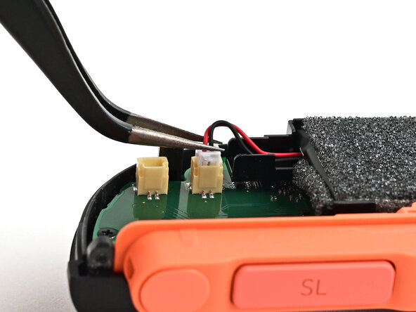

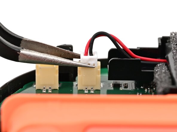

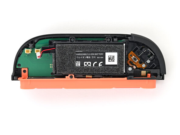

  11. Joy-Con 2 (Right) Joystick Replacement, Disconnect the battery: crwdns2935265:011crwdnd2935265:01crwdnd2935265:02crwdne2935265:0 Joy-Con 2 (Right) Joystick Replacement, Disconnect the battery: crwdns2935265:011crwdnd2935265:02crwdnd2935265:02crwdne2935265:0
    • Use tweezers or your fingers to firmly grip the battery cable's white JST connector and pull straight away from its socket to disconnect it.
    • Once partially lifted, reposition your fingers/tweezers to beneath the connector's upper lip to increase your grip.

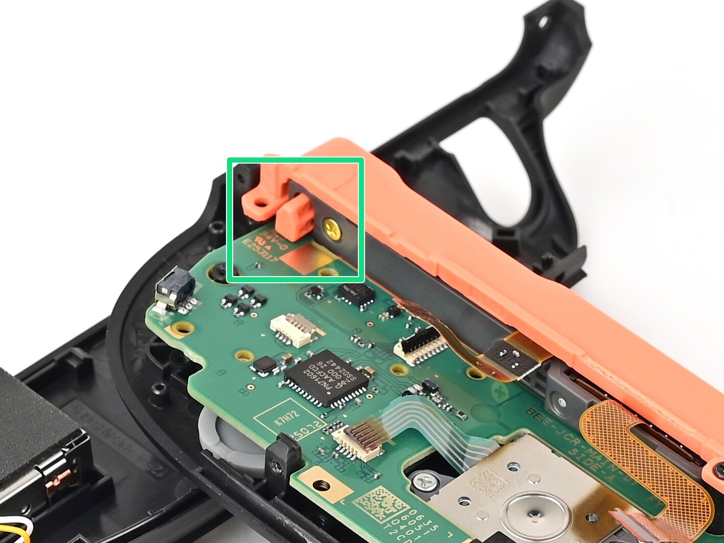

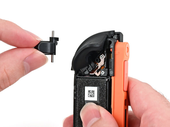

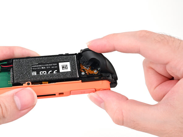

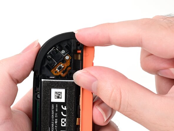

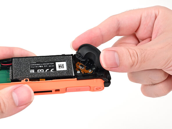

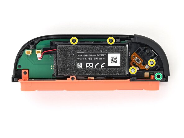

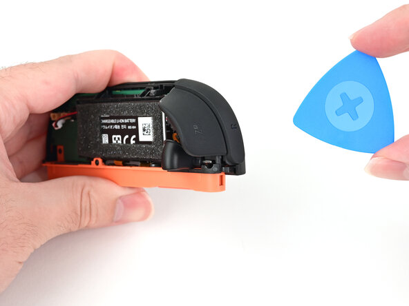

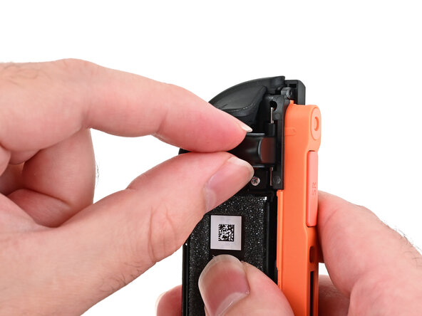

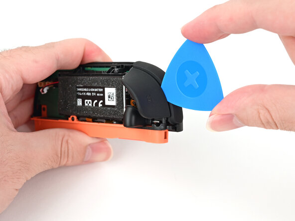

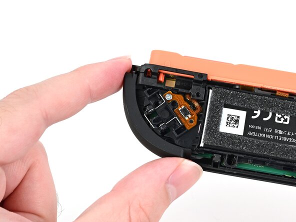

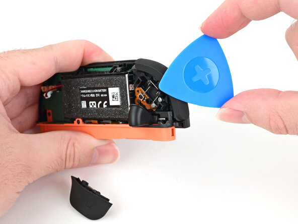

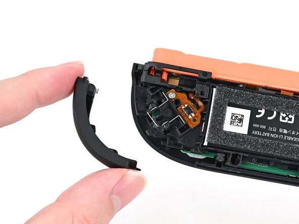

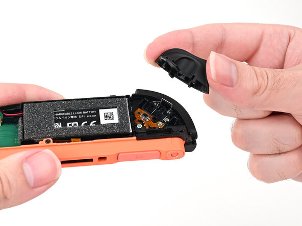

  12. Joy-Con 2 (Right) Joystick Replacement, Remove the trigger: crwdns2935265:012crwdnd2935265:01crwdnd2935265:03crwdne2935265:0 Joy-Con 2 (Right) Joystick Replacement, Remove the trigger: crwdns2935265:012crwdnd2935265:02crwdnd2935265:03crwdne2935265:0 Joy-Con 2 (Right) Joystick Replacement, Remove the trigger: crwdns2935265:012crwdnd2935265:03crwdnd2935265:03crwdne2935265:0
    • If your JIS 00 driver is able to access the screw underneath the trigger button, you may skip this step.
    • Insert an opening pick between the bumper (R) and trigger (ZR) buttons at the top of the controller.
    • Use the opening pick to pry the trigger away from the bumper until it pops off the controller.
    • You can lightly hold the ZR button with your finger to avoid launching it.

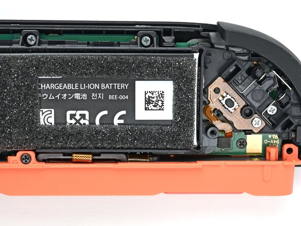

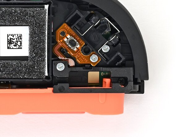

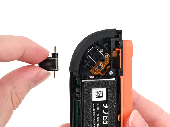

  13. Joy-Con 2 (Right) Joystick Replacement, Remove the release button: crwdns2935265:013crwdnd2935265:01crwdnd2935265:02crwdne2935265:0 Joy-Con 2 (Right) Joystick Replacement, Remove the release button: crwdns2935265:013crwdnd2935265:02crwdnd2935265:02crwdne2935265:0
    • Pick up the release button and remove it.

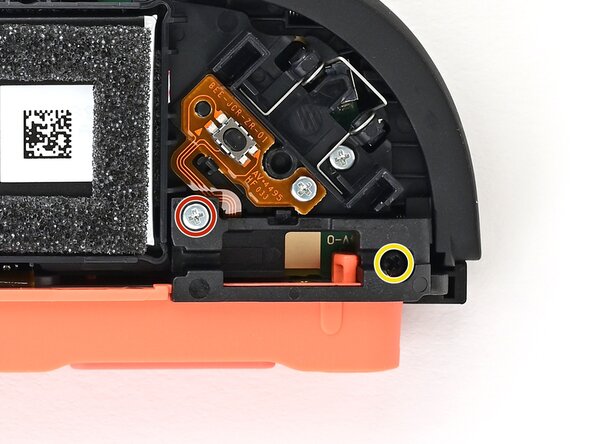

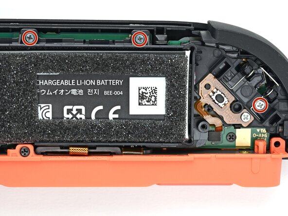

  14. Joy-Con 2 (Right) Joystick Replacement, Remove the screws: crwdns2935265:014crwdnd2935265:01crwdnd2935265:02crwdne2935265:0 Joy-Con 2 (Right) Joystick Replacement, Remove the screws: crwdns2935265:014crwdnd2935265:02crwdnd2935265:02crwdne2935265:0
    • Use a JIS 00 driver to remove the five screws securing the midframe:
    • Four 3.9 mm‑long silver screws
    • One 6.2 mm‑long black screw

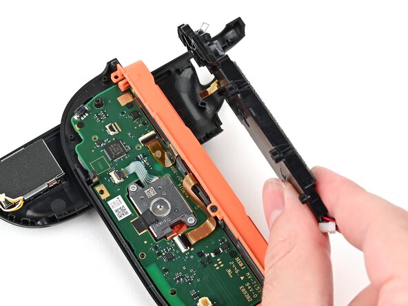

  15. Joy-Con 2 (Right) Joystick Replacement, Remove the bumper: crwdns2935265:015crwdnd2935265:01crwdnd2935265:02crwdne2935265:0 Joy-Con 2 (Right) Joystick Replacement, Remove the bumper: crwdns2935265:015crwdnd2935265:02crwdnd2935265:02crwdne2935265:0
    • Hold the midframe lightly in place.
    • Pull the bumper (R) button off its mounting pegs and remove it.
    • The midframe will lift slightly when removing this button.

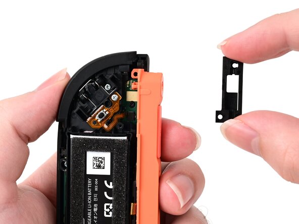

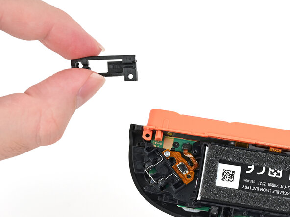

  16. Joy-Con 2 (Right) Joystick Replacement, Remove the bracket: crwdns2935265:016crwdnd2935265:01crwdnd2935265:02crwdne2935265:0 Joy-Con 2 (Right) Joystick Replacement, Remove the bracket: crwdns2935265:016crwdnd2935265:02crwdnd2935265:02crwdne2935265:0
    • Pick up the release button mounting bracket and remove it.

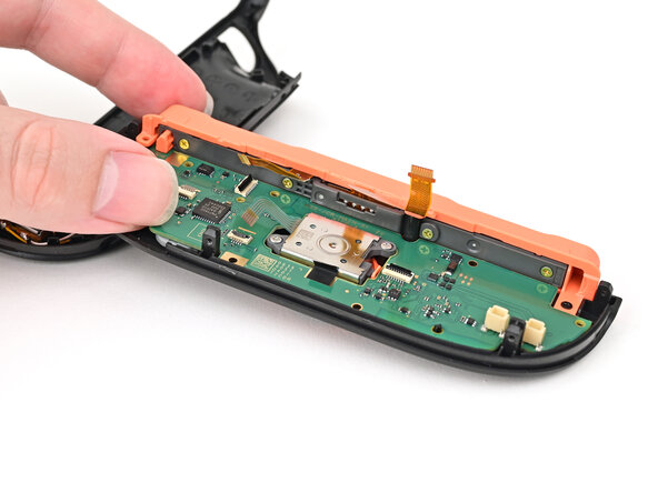

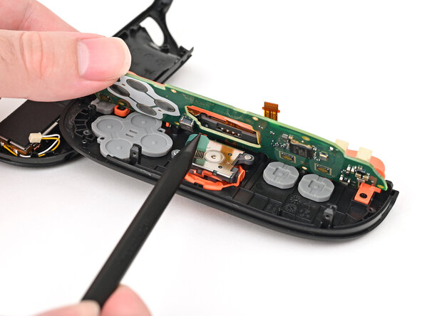

  18. Joy-Con 2 (Right) Joystick Replacement, Reposition the midframe: crwdns2935265:018crwdnd2935265:01crwdnd2935265:03crwdne2935265:0 Joy-Con 2 (Right) Joystick Replacement, Reposition the midframe: crwdns2935265:018crwdnd2935265:02crwdnd2935265:03crwdne2935265:0 Joy-Con 2 (Right) Joystick Replacement, Reposition the midframe: crwdns2935265:018crwdnd2935265:03crwdnd2935265:03crwdne2935265:0
    • Flip the controller's mid-frame over so it rests on the Joy-Con's inner edge (the edge with the shoulder buttons).

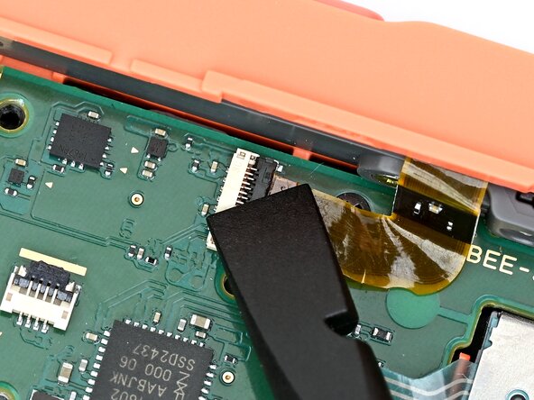

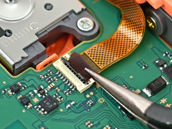

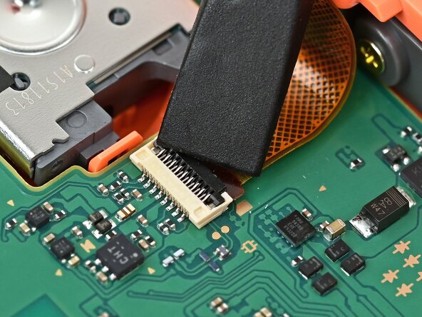

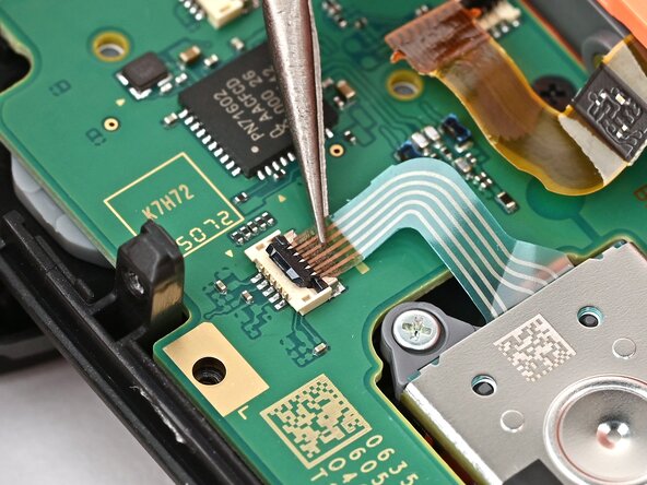

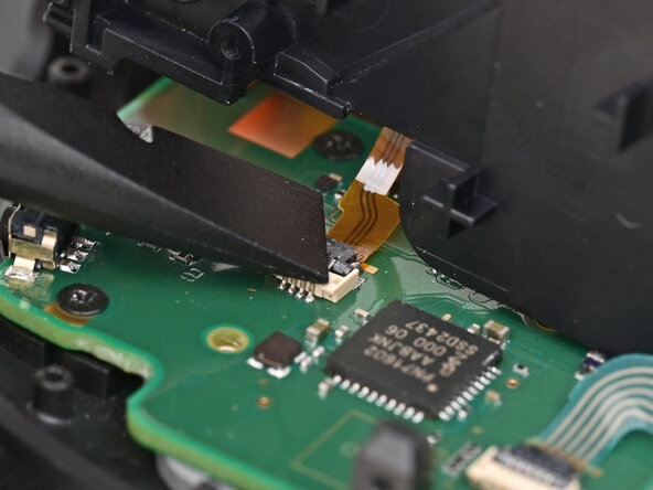

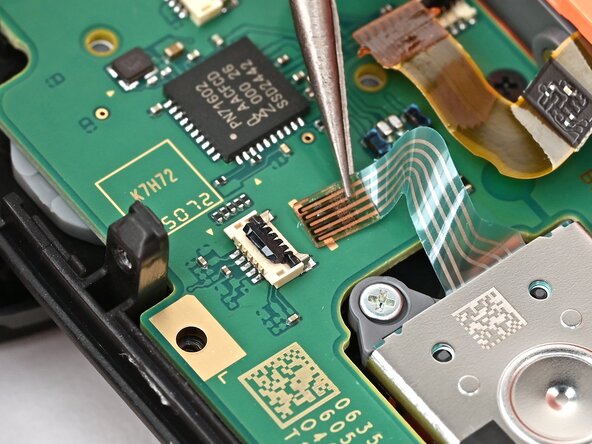

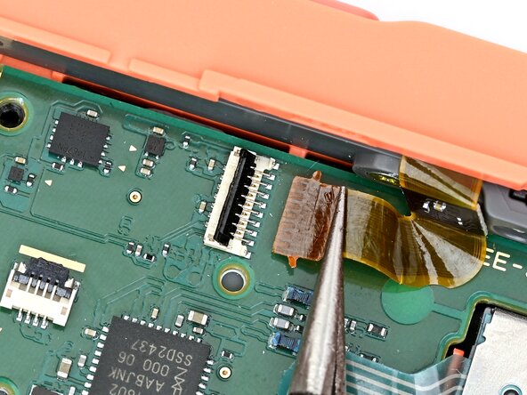

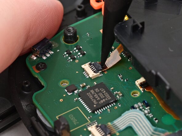

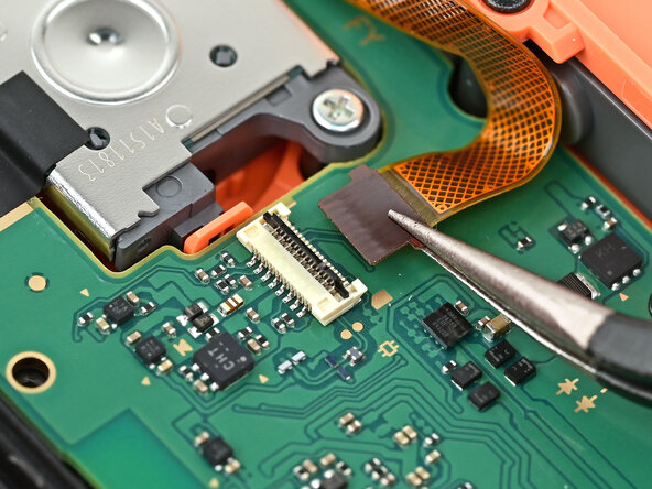

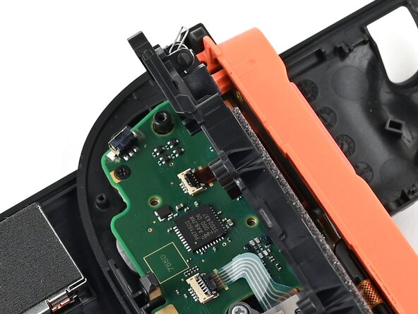

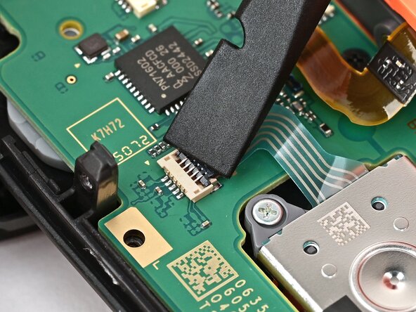

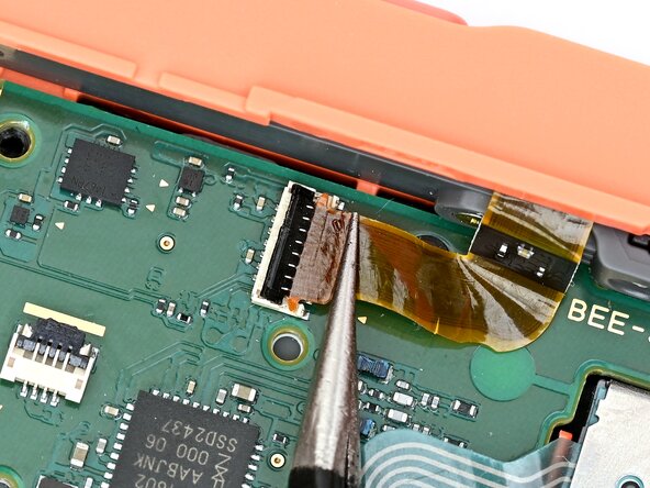

  19. Joy-Con 2 (Right) Joystick Replacement, Disconnect the midframe: crwdns2935265:019crwdnd2935265:01crwdnd2935265:03crwdne2935265:0 Joy-Con 2 (Right) Joystick Replacement, Disconnect the midframe: crwdns2935265:019crwdnd2935265:02crwdnd2935265:03crwdne2935265:0 Joy-Con 2 (Right) Joystick Replacement, Disconnect the midframe: crwdns2935265:019crwdnd2935265:03crwdnd2935265:03crwdne2935265:0
    • Use the point of a spudger to flip up the locking flap on the midframe cable ZIF connector, located on the controller's board.
  20. Joy-Con 2 (Right) Joystick Replacement: crwdns2935265:020crwdnd2935265:01crwdnd2935265:02crwdne2935265:0 Joy-Con 2 (Right) Joystick Replacement: crwdns2935265:020crwdnd2935265:02crwdnd2935265:02crwdne2935265:0
    • Use tweezers or your fingers to gently pull the cable out of its socket.
  21. Joy-Con 2 (Right) Joystick Replacement, Remove the midframe: crwdns2935265:021crwdnd2935265:01crwdnd2935265:02crwdne2935265:0 Joy-Con 2 (Right) Joystick Replacement, Remove the midframe: crwdns2935265:021crwdnd2935265:02crwdnd2935265:02crwdne2935265:0
    • Pick up and remove the midframe.

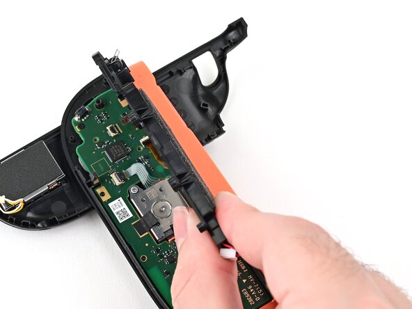

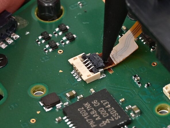

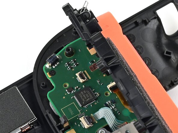

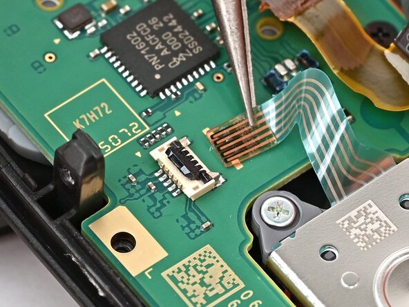

  22. Joy-Con 2 (Right) Joystick Replacement, Disconnect the board: crwdns2935265:022crwdnd2935265:01crwdnd2935265:03crwdne2935265:0 Joy-Con 2 (Right) Joystick Replacement, Disconnect the board: crwdns2935265:022crwdnd2935265:02crwdnd2935265:03crwdne2935265:0 Joy-Con 2 (Right) Joystick Replacement, Disconnect the board: crwdns2935265:022crwdnd2935265:03crwdnd2935265:03crwdne2935265:0
    • Repeat this procedure to disconnect the remaining three ZIF connectors on the controller's board.

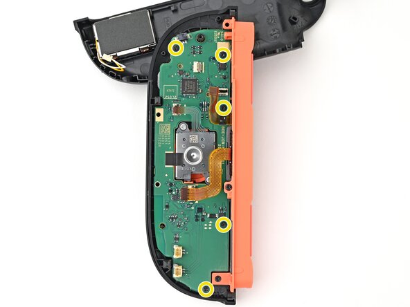

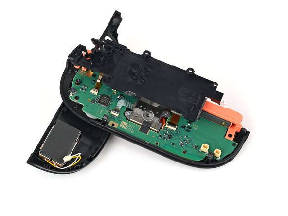

  23. Joy-Con 2 (Right) Joystick Replacement, Remove the board screws: crwdns2935265:023crwdnd2935265:01crwdnd2935265:02crwdne2935265:0 Joy-Con 2 (Right) Joystick Replacement, Remove the board screws: crwdns2935265:023crwdnd2935265:02crwdnd2935265:02crwdne2935265:0
    • Use a JIS 00 driver to remove the five 3.1 mm‑long black screws securing the board to the controller.

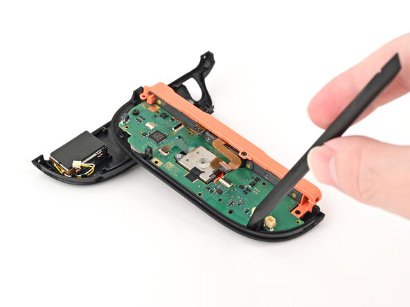

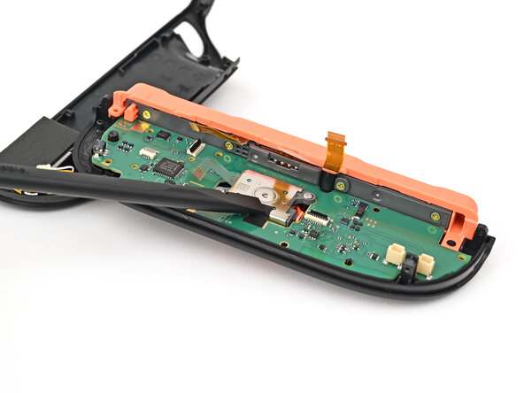

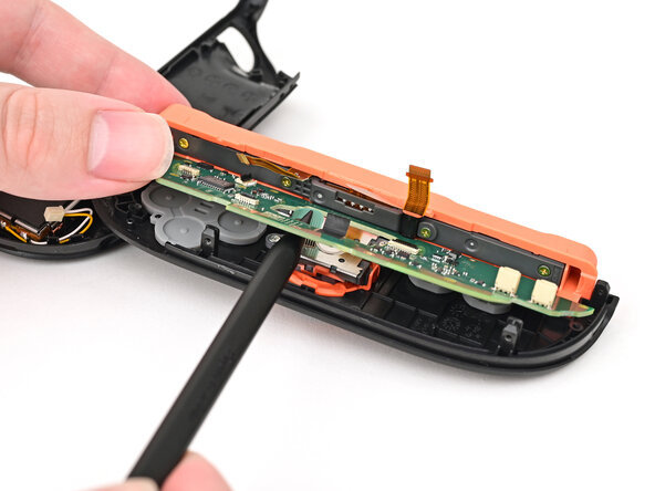

  24. Joy-Con 2 (Right) Joystick Replacement, Lift the board: crwdns2935265:024crwdnd2935265:01crwdnd2935265:02crwdne2935265:0 Joy-Con 2 (Right) Joystick Replacement, Lift the board: crwdns2935265:024crwdnd2935265:02crwdnd2935265:02crwdne2935265:0
    • Insert the point of a spudger between the board and the controller, near the battery connector socket.
    • Pry up on the board enough to grasp its edge with your fingertips.

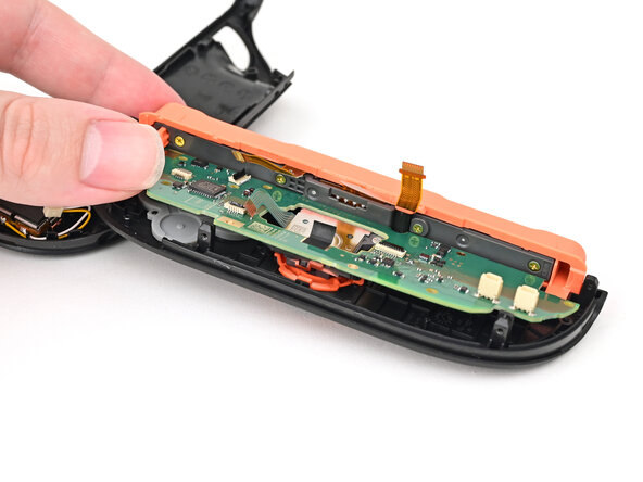

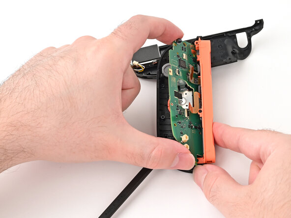

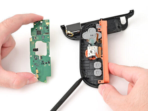

  25. Joy-Con 2 (Right) Joystick Replacement, Remove the board: crwdns2935265:025crwdnd2935265:01crwdnd2935265:03crwdne2935265:0 Joy-Con 2 (Right) Joystick Replacement, Remove the board: crwdns2935265:025crwdnd2935265:02crwdnd2935265:03crwdne2935265:0 Joy-Con 2 (Right) Joystick Replacement, Remove the board: crwdns2935265:025crwdnd2935265:03crwdnd2935265:03crwdne2935265:0
    • Lift the board by its outer edges to a roughly 45-degree angle, so it's no longer being blocked by the joystick assembly.
    • Make sure the black tape is fully lifted off the back of the joystick module. Work slowly to avoid tearing the tape.
    • Remove the board.

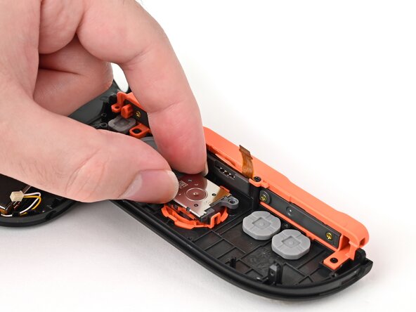

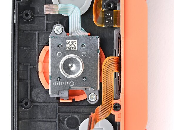

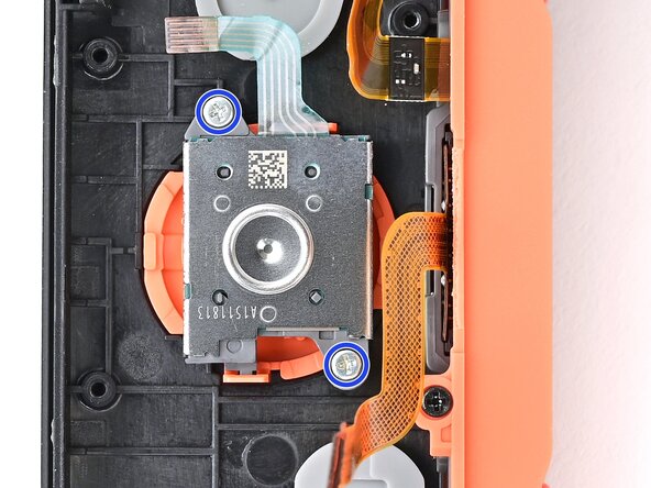

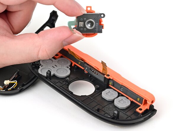

  26. Joy-Con 2 (Right) Joystick Replacement, Remove the joystick: crwdns2935265:026crwdnd2935265:01crwdnd2935265:02crwdne2935265:0 Joy-Con 2 (Right) Joystick Replacement, Remove the joystick: crwdns2935265:026crwdnd2935265:02crwdnd2935265:02crwdne2935265:0
    • Use a JIS 00 driver to remove the two 3.9 mm‑long silver screws securing the joystick.
  27. Joy-Con 2 (Right) Joystick Replacement: crwdns2935265:027crwdnd2935265:01crwdnd2935265:02crwdne2935265:0 Joy-Con 2 (Right) Joystick Replacement: crwdns2935265:027crwdnd2935265:02crwdnd2935265:02crwdne2935265:0
    • Pick up and remove the joystick.

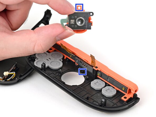

  29. Joy-Con 2 (Right) Joystick Replacement, Install the joystick: crwdns2935265:029crwdnd2935265:01crwdnd2935265:02crwdne2935265:0 Joy-Con 2 (Right) Joystick Replacement, Install the joystick: crwdns2935265:029crwdnd2935265:02crwdnd2935265:02crwdne2935265:0
    • Align the cut-out in the joystick's plastic frame with its peg on the controller.
    • Set the joystick in the controller. Gently wiggle the joystick to ensure it's fully seated.
  30. Joy-Con 2 (Right) Joystick Replacement: crwdns2935265:030crwdnd2935265:01crwdnd2935265:02crwdne2935265:0 Joy-Con 2 (Right) Joystick Replacement: crwdns2935265:030crwdnd2935265:02crwdnd2935265:02crwdne2935265:0
    • Use a JIS 00 driver to install the two 3.9 mm‑long silver screws securing the joystick.

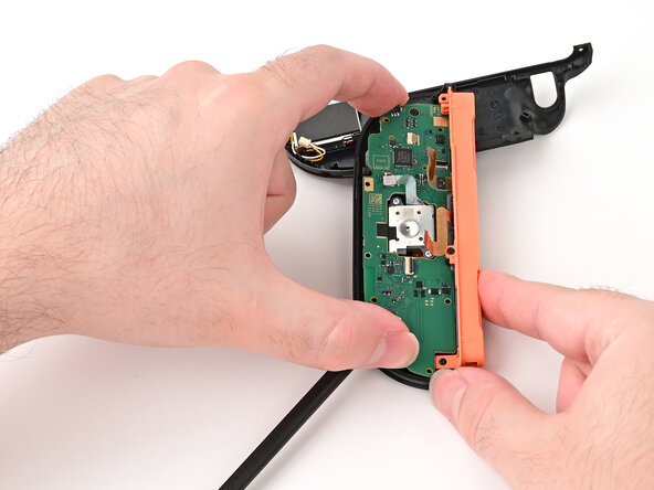

  31. Joy-Con 2 (Right) Joystick Replacement, Install the board: crwdns2935265:031crwdnd2935265:01crwdnd2935265:03crwdne2935265:0 Joy-Con 2 (Right) Joystick Replacement, Install the board: crwdns2935265:031crwdnd2935265:02crwdnd2935265:03crwdne2935265:0 Joy-Con 2 (Right) Joystick Replacement, Install the board: crwdns2935265:031crwdnd2935265:03crwdnd2935265:03crwdne2935265:0
    • Lower the board's flat side into the controller at an angle.
    • Use a spudger to bend the joystick's ribbon cable so it's perpendicular with the joystick.
    • Lower the board so the joystick's ribbon cable routes through the joystick cut-out in the board. Ensure the board is sitting underneath the locking tab on the frame.
  32. Joy-Con 2 (Right) Joystick Replacement: crwdns2935265:032crwdnd2935265:01crwdnd2935265:03crwdne2935265:0 Joy-Con 2 (Right) Joystick Replacement: crwdns2935265:032crwdnd2935265:02crwdnd2935265:03crwdne2935265:0 Joy-Con 2 (Right) Joystick Replacement: crwdns2935265:032crwdnd2935265:03crwdnd2935265:03crwdne2935265:0
    • Push the board towards the controller's inner edge (the side with the shoulder buttons) to prevent it from colliding with the joystick module.
    • Lower the board into the frame.
    • Use your finger or the flat end of a spudger to press the black tape onto the back of the joystick module.

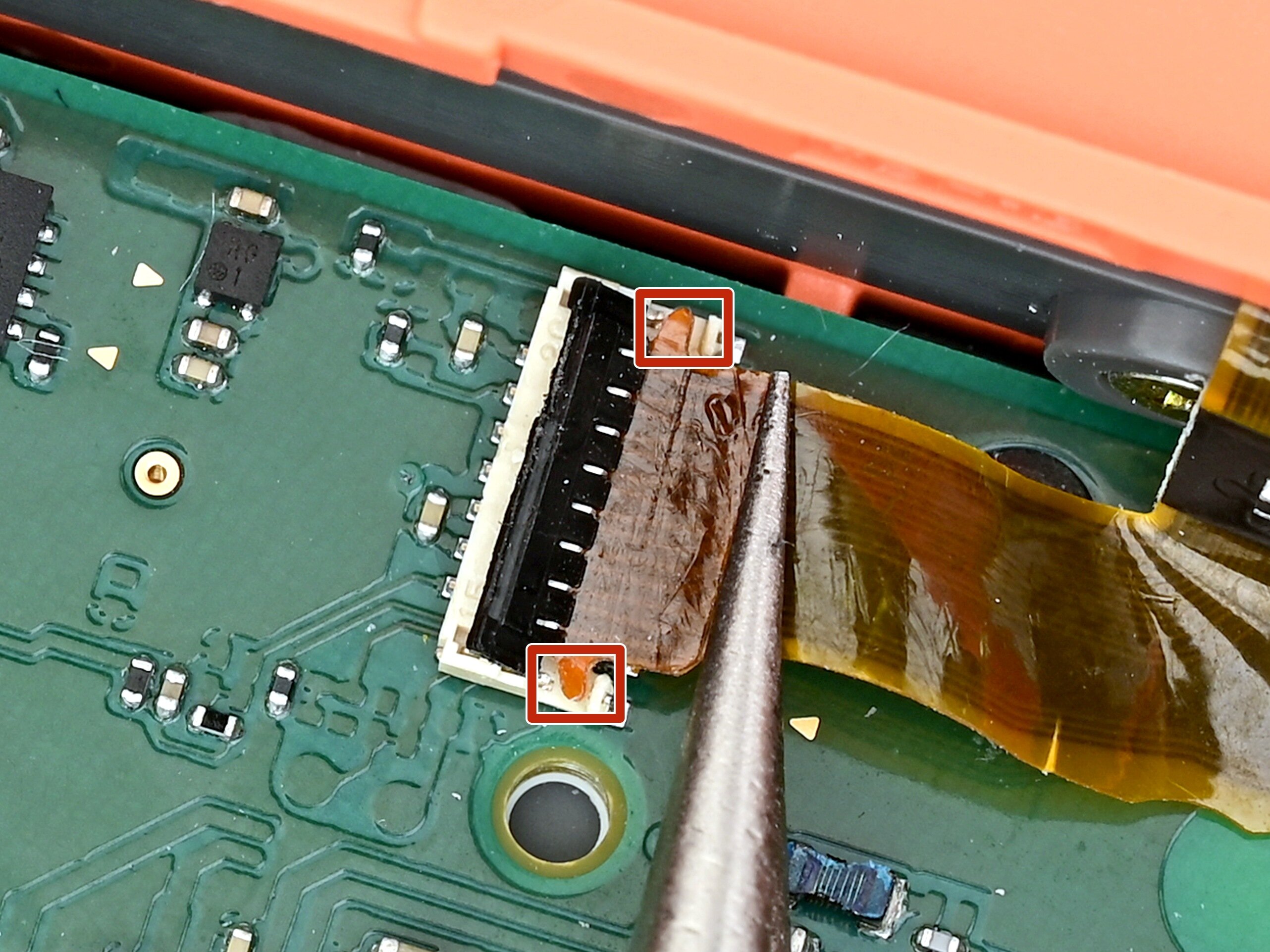

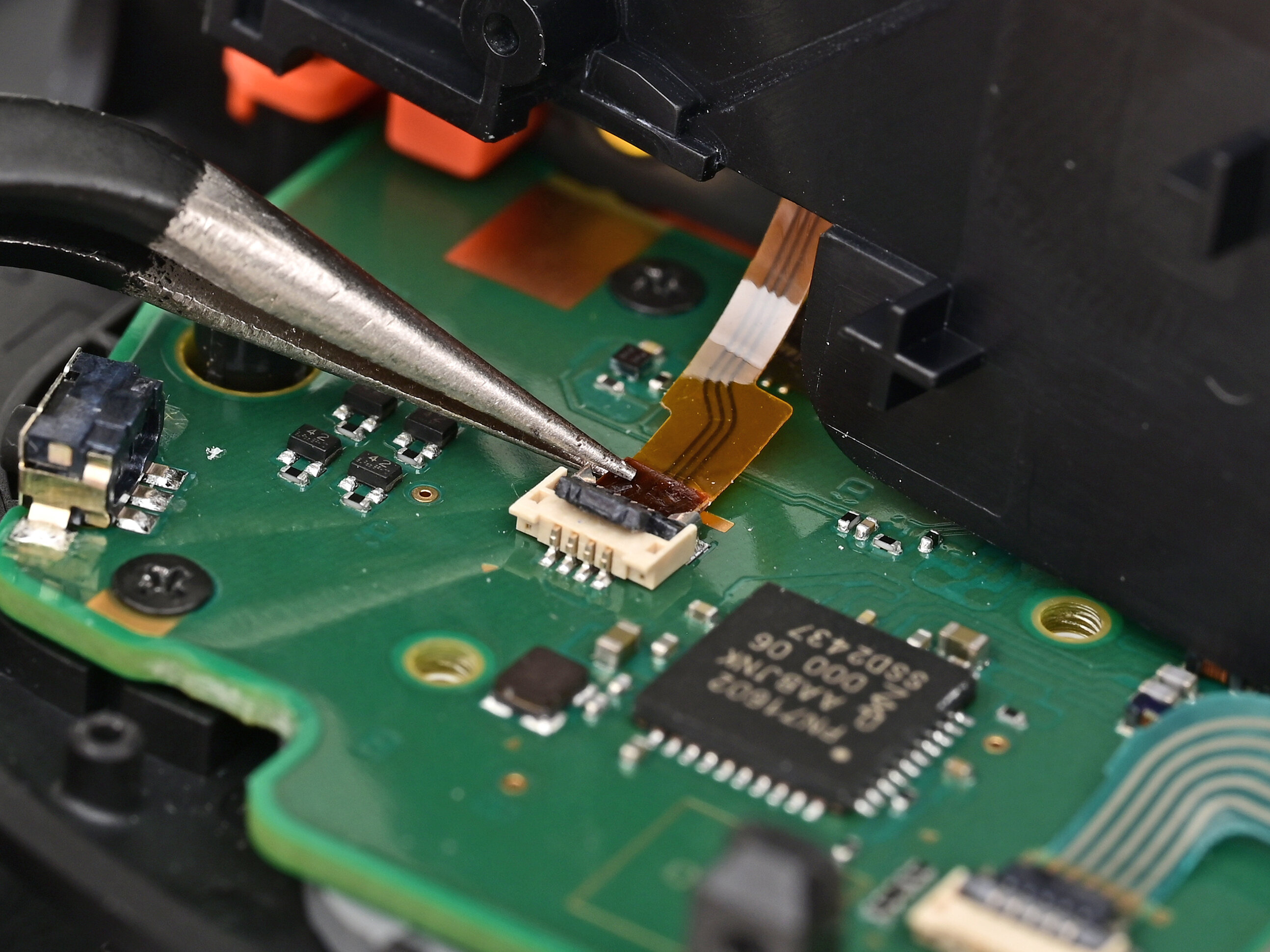

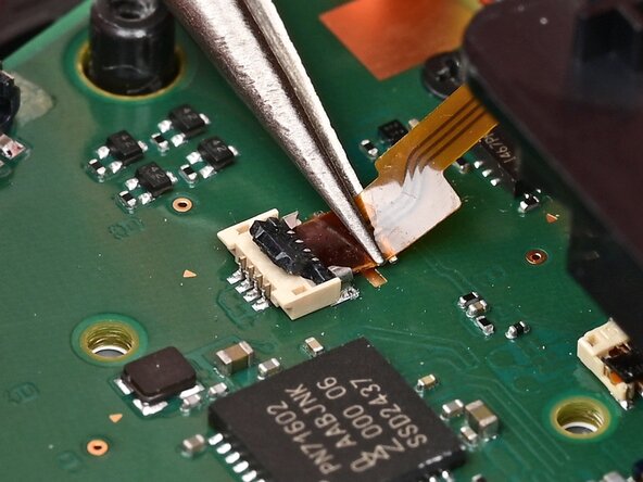

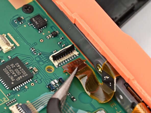

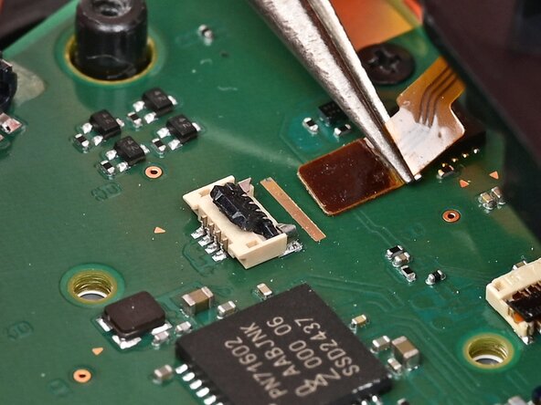

  34. Joy-Con 2 (Right) Joystick Replacement, Connect the cables: crwdns2935265:034crwdnd2935265:01crwdnd2935265:03crwdne2935265:0 Joy-Con 2 (Right) Joystick Replacement, Connect the cables: crwdns2935265:034crwdnd2935265:02crwdnd2935265:03crwdne2935265:0 Joy-Con 2 (Right) Joystick Replacement, Connect the cables: crwdns2935265:034crwdnd2935265:03crwdnd2935265:03crwdne2935265:0
    • Make sure the locking flap is flipped up on the joystick cable ZIF connector.
    • Insert the joystick ribbon cable into its ZIF connector until it's fully seated.
    • The brown portion of the cable should end at the golden line on the board.
    • Use your finger or a spudger to flip the locking flap down to secure the cable.

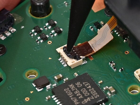

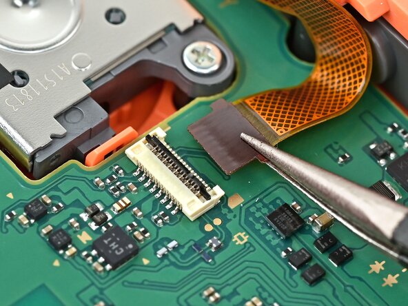

  35. Joy-Con 2 (Right) Joystick Replacement: crwdns2935265:035crwdnd2935265:01crwdnd2935265:03crwdne2935265:0 Joy-Con 2 (Right) Joystick Replacement: crwdns2935265:035crwdnd2935265:02crwdnd2935265:03crwdne2935265:0 Joy-Con 2 (Right) Joystick Replacement: crwdns2935265:035crwdnd2935265:03crwdnd2935265:03crwdne2935265:0
    • Make sure the locking flap is flipped up on the Joy-Con connector cable ZIF connector.
    • Insert the Joy-Con connector ribbon cable into its ZIF connector until it's fully seated.

  40. Joy-Con 2 (Right) Joystick Replacement, Install the bracket: crwdns2935265:040crwdnd2935265:01crwdnd2935265:02crwdne2935265:0 Joy-Con 2 (Right) Joystick Replacement, Install the bracket: crwdns2935265:040crwdnd2935265:02crwdnd2935265:02crwdne2935265:0
    • Align the release button mounting bracket with its screw holes and press it in the frame so it snaps into place.
    • The corner with the protruding square should be facing the battery.
  41. Joy-Con 2 (Right) Joystick Replacement: crwdns2935265:041crwdnd2935265:01crwdnd2935265:02crwdne2935265:0 Joy-Con 2 (Right) Joystick Replacement: crwdns2935265:041crwdnd2935265:02crwdnd2935265:02crwdne2935265:0
    • Use a JIS 00 driver to install the two screws securing the release button bracket.
    • One 3.9 mm‑long silver screw

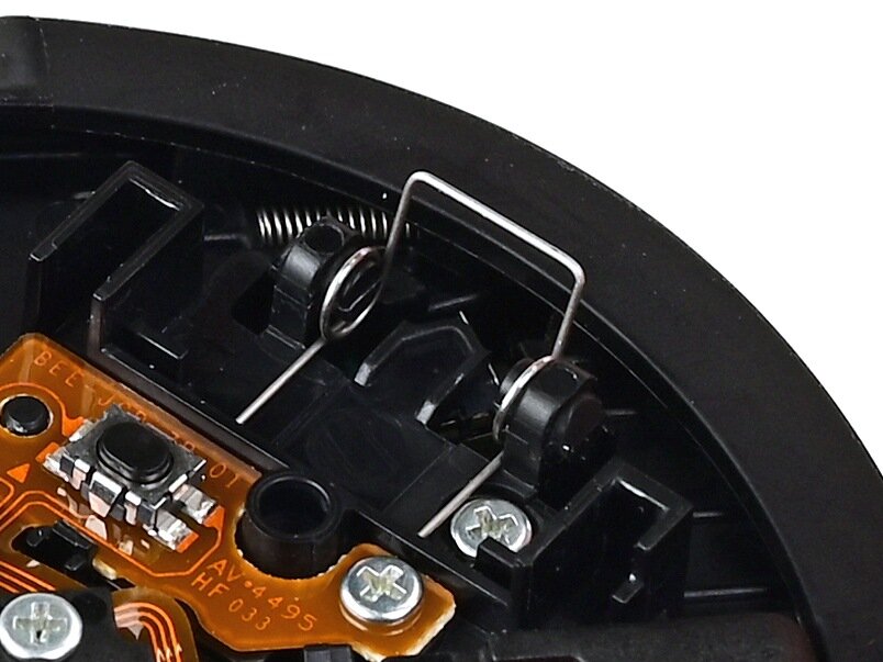

  42. Joy-Con 2 (Right) Joystick Replacement, Install the buttons: crwdns2935265:042crwdnd2935265:01crwdnd2935265:03crwdne2935265:0 Joy-Con 2 (Right) Joystick Replacement, Install the buttons: crwdns2935265:042crwdnd2935265:02crwdnd2935265:03crwdne2935265:0 Joy-Con 2 (Right) Joystick Replacement, Install the buttons: crwdns2935265:042crwdnd2935265:03crwdnd2935265:03crwdne2935265:0
    • If you left the trigger button in place, skip this step.
    • Align the trigger button with the top of the controller, with the "ZR" engraving facing out.
    • Set the trigger button onto its metal spring. Ensure the legs of the spring are seated properly in their channels on the midframe.
    • Press firmly on the trigger button to snap it into place.
    • Check that the metal stabilizer didn't fall out of position. If it did, remove the trigger, place it back into position, and try again.

    • Hold the release button so its smooth face is perpendicular to the controller.
    • Insert the release button into its bracket.
    • If the release pin doesn't stick out of the controller when the button is pressed, the button isn't installed correctly. Re-insert or flip the button and try again.
  44. Joy-Con 2 (Right) Joystick Replacement, Connect the battery: crwdns2935265:044crwdnd2935265:01crwdnd2935265:03crwdne2935265:0 Joy-Con 2 (Right) Joystick Replacement, Connect the battery: crwdns2935265:044crwdnd2935265:02crwdnd2935265:03crwdne2935265:0 Joy-Con 2 (Right) Joystick Replacement, Connect the battery: crwdns2935265:044crwdnd2935265:03crwdnd2935265:03crwdne2935265:0
    • Align the battery connector with its socket on the board.
    • Press down on the connector until it's fully seated.
  45. Joy-Con 2 (Right) Joystick Replacement, Connect the rumble motor: crwdns2935265:045crwdnd2935265:01crwdnd2935265:03crwdne2935265:0 Joy-Con 2 (Right) Joystick Replacement, Connect the rumble motor: crwdns2935265:045crwdnd2935265:02crwdnd2935265:03crwdne2935265:0 Joy-Con 2 (Right) Joystick Replacement, Connect the rumble motor: crwdns2935265:045crwdnd2935265:03crwdnd2935265:03crwdne2935265:0
    • Align the rumble motor connector to its socket on the bottom edge of the board, and push down until it's fully seated to connect it.
  46. Joy-Con 2 (Right) Joystick Replacement, Install the back cover: crwdns2935265:046crwdnd2935265:01crwdnd2935265:03crwdne2935265:0 Joy-Con 2 (Right) Joystick Replacement, Install the back cover: crwdns2935265:046crwdnd2935265:02crwdnd2935265:03crwdne2935265:0 Joy-Con 2 (Right) Joystick Replacement, Install the back cover: crwdns2935265:046crwdnd2935265:03crwdnd2935265:03crwdne2935265:0
    • Use an opening pick to press and hold the release button.
    • Place the back cover over the controller body so the release button cutout is slightly below the release button.
    • The release button is held down when the release pin is protruding from the frame. If the release button falls out of position, put it back and try again.
    • Press and slide the back cover up until the cut-out for the release button is aligned with the button itself.
    • Ensure the rumble motor wires (yellow & white) are fully within the frame.
  47. Joy-Con 2 (Right) Joystick Replacement: crwdns2935265:047crwdnd2935265:01crwdnd2935265:02crwdne2935265:0 Joy-Con 2 (Right) Joystick Replacement: crwdns2935265:047crwdnd2935265:02crwdnd2935265:02crwdne2935265:0
    • Remove the opening pick.
  48. Joy-Con 2 (Right) Joystick Replacement, Install the right edge screws: crwdns2935265:048crwdnd2935265:01crwdnd2935265:02crwdne2935265:0 Joy-Con 2 (Right) Joystick Replacement, Install the right edge screws: crwdns2935265:048crwdnd2935265:02crwdnd2935265:02crwdne2935265:0
    • Install the two screws on the right edge of the controller:
  49. Joy-Con 2 (Right) Joystick Replacement, Install the plastic strip: crwdns2935265:049crwdnd2935265:01crwdnd2935265:03crwdne2935265:0 Joy-Con 2 (Right) Joystick Replacement, Install the plastic strip: crwdns2935265:049crwdnd2935265:02crwdnd2935265:03crwdne2935265:0 Joy-Con 2 (Right) Joystick Replacement, Install the plastic strip: crwdns2935265:049crwdnd2935265:03crwdnd2935265:03crwdne2935265:0
    • Align the clips on the plastic strip with their cut-outs on the right edge of the controller body.
    • Insert the clips on the bottom edge first, then insert the rest so the plastic strip sits flush.
