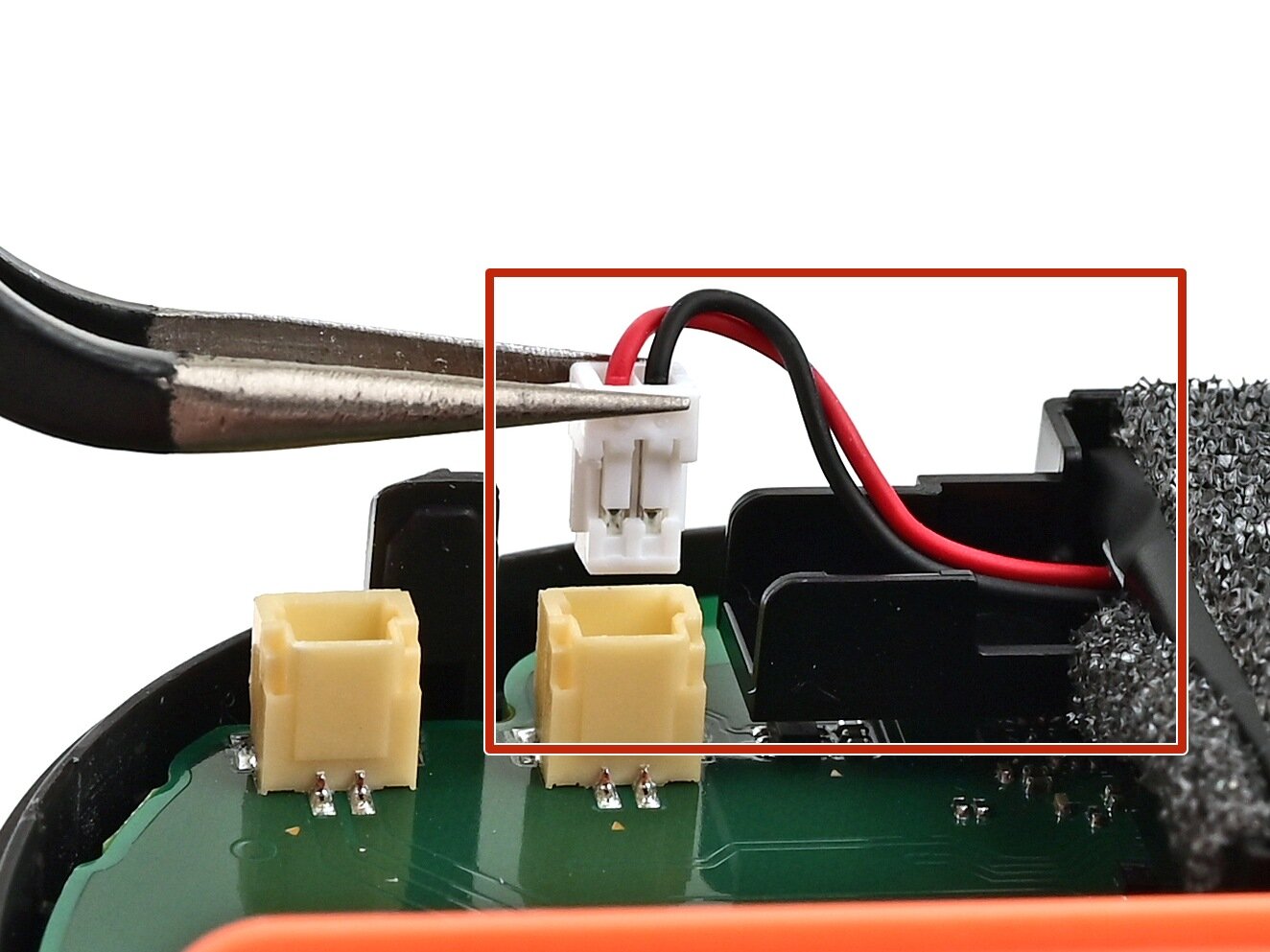

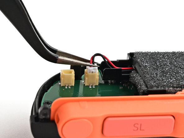

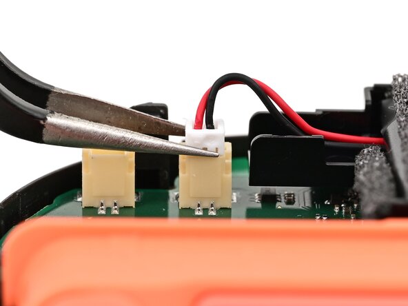

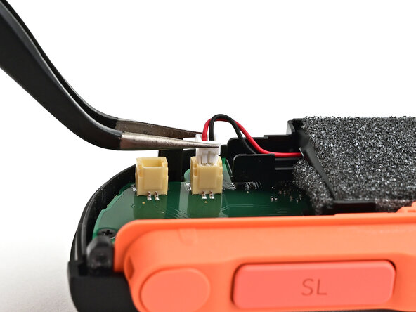

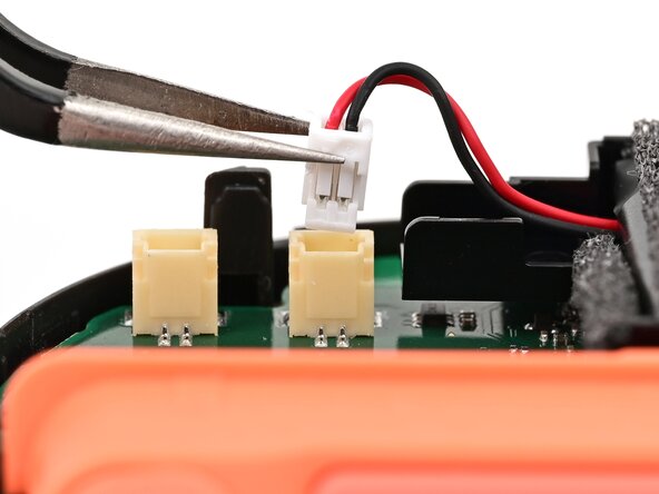

  11. Joy-Con 2 (Right) Battery Replacement, Disconnect the battery: crwdns2935265:011crwdnd2935265:01crwdnd2935265:02crwdne2935265:0 Joy-Con 2 (Right) Battery Replacement, Disconnect the battery: crwdns2935265:011crwdnd2935265:02crwdnd2935265:02crwdne2935265:0
    • Use tweezers or your fingers to firmly grip the battery cable's white JST connector and pull straight away from its socket to disconnect it.
    • Once partially lifted, reposition your fingers/tweezers to beneath the connector's upper lip to increase your grip.

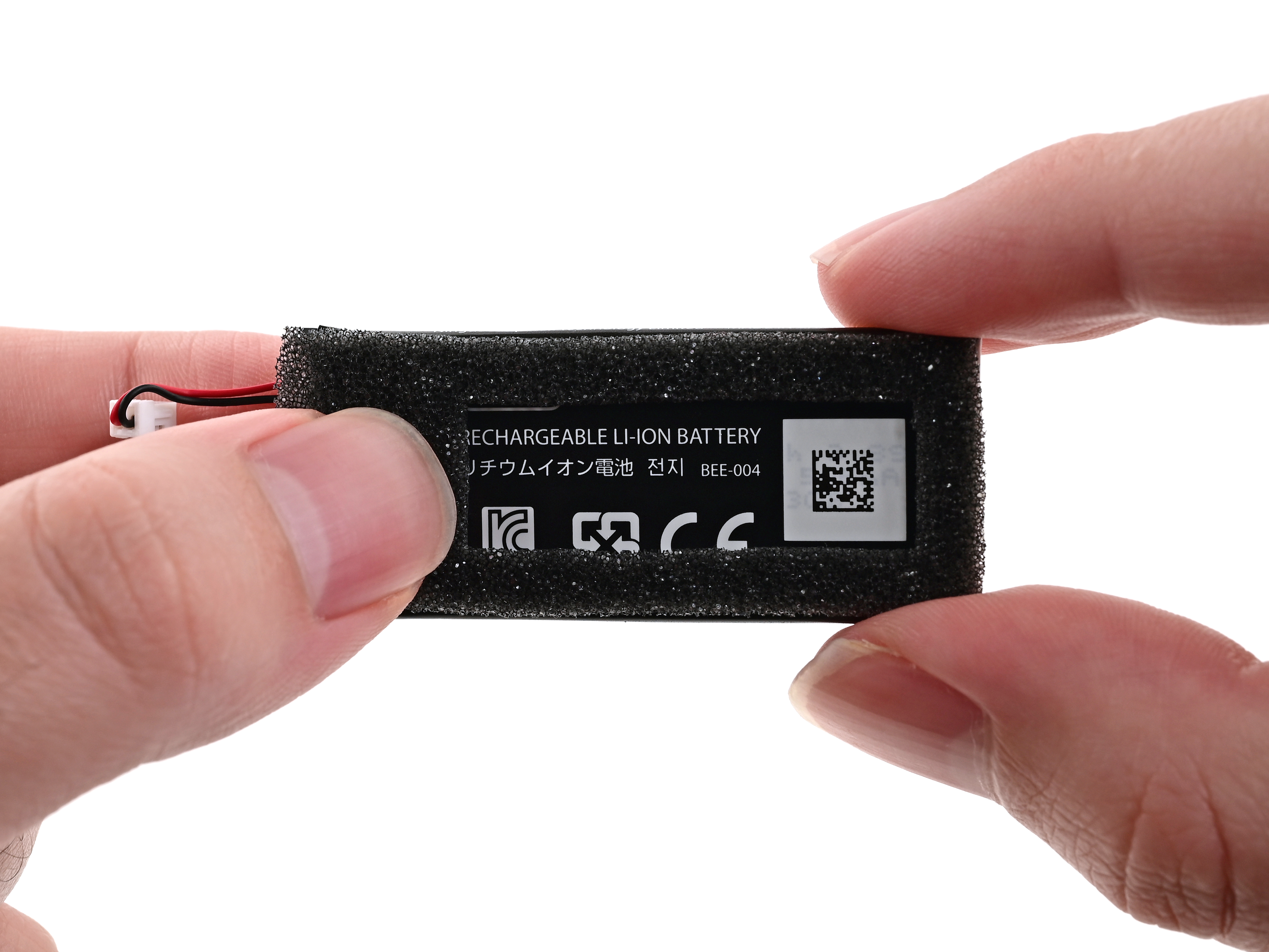

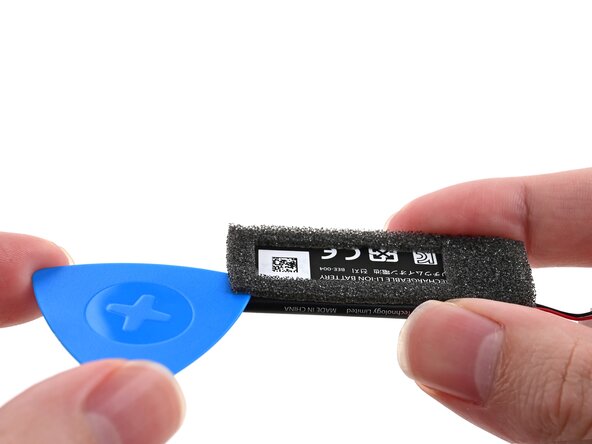

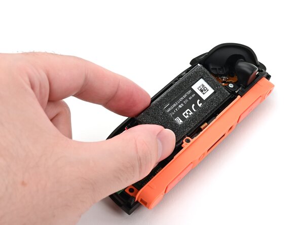

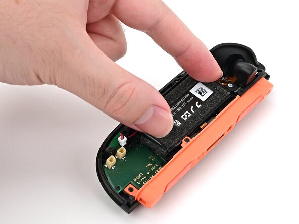

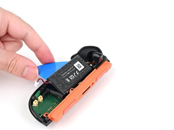

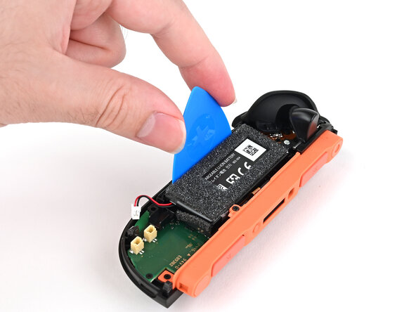

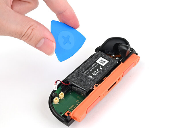

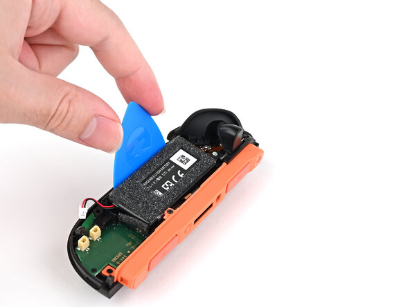

  12. Joy-Con 2 (Right) Battery Replacement, Remove the battery: crwdns2935265:012crwdnd2935265:01crwdnd2935265:02crwdne2935265:0 Joy-Con 2 (Right) Battery Replacement, Remove the battery: crwdns2935265:012crwdnd2935265:02crwdnd2935265:02crwdne2935265:0
    • Insert a flat edge of an opening pick into the gap between the battery and the battery well.
  13. Joy-Con 2 (Right) Battery Replacement: crwdns2935265:013crwdnd2935265:01crwdnd2935265:03crwdne2935265:0 Joy-Con 2 (Right) Battery Replacement: crwdns2935265:013crwdnd2935265:02crwdnd2935265:03crwdne2935265:0 Joy-Con 2 (Right) Battery Replacement: crwdns2935265:013crwdnd2935265:03crwdnd2935265:03crwdne2935265:0
    iFixit Adhesive Remover
    $19.99

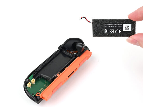

    • Pry the battery up slowly with steady force to release the adhesive.
    • Don't bend or crease the battery—apply steady force and give the adhesive time to release.
    • If it feels stubborn, apply a few drops of adhesive remover or high-concentration (90% or higher) isopropyl alcohol to the battery side of the pick while it's inserted and allow it to run under the battery. Be careful not to spill it elsewhere in the controller.
    • If you're using adhesive remover, follow these preparation steps first.
    • Remove the battery.

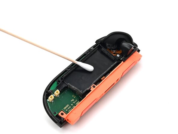

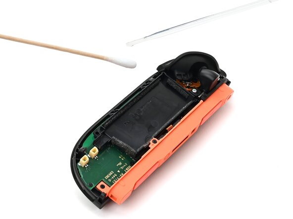

  15. Joy-Con 2 (Right) Battery Replacement, Clean the frame: crwdns2935265:015crwdnd2935265:01crwdnd2935265:02crwdne2935265:0 Joy-Con 2 (Right) Battery Replacement, Clean the frame: crwdns2935265:015crwdnd2935265:02crwdnd2935265:02crwdne2935265:0
    Cotton Swabs
    • Apply isopropyl alcohol to a cotton swab and wipe any adhesive residue from the frame.
    • The foam on the inside walls of the frame dissolves in isopropyl alcohol. Avoid damaging the foam.

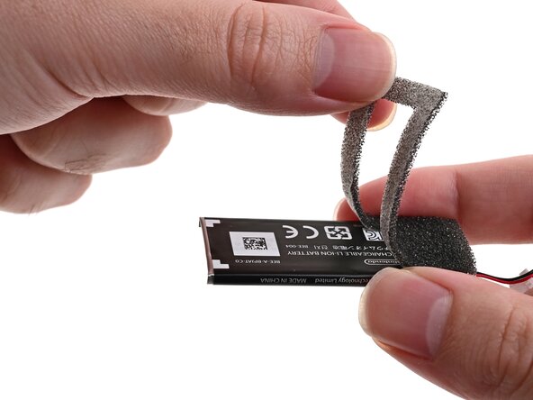

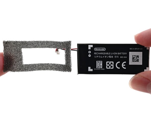

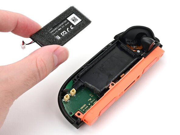

  16. Joy-Con 2 (Right) Battery Replacement, Transfer the foam: crwdns2935265:016crwdnd2935265:01crwdnd2935265:03crwdne2935265:0 Joy-Con 2 (Right) Battery Replacement, Transfer the foam: crwdns2935265:016crwdnd2935265:02crwdnd2935265:03crwdne2935265:0 Joy-Con 2 (Right) Battery Replacement, Transfer the foam: crwdns2935265:016crwdnd2935265:03crwdnd2935265:03crwdne2935265:0
    • If your replacement battery includes new foam, skip this step.
    • Use an opening pick or your fingernail to lift the foam off the battery by its adhesive, not the foam itself.
    • Carefully peel the foam sticker off the old battery. Avoid stretching or tearing the foam.
    • If the foam does tear, apply the pieces to the replacement battery in their original shape.
    • Apply the foam sticker to the new battery so the edges of the foam are aligned with the edges of the battery.

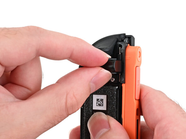

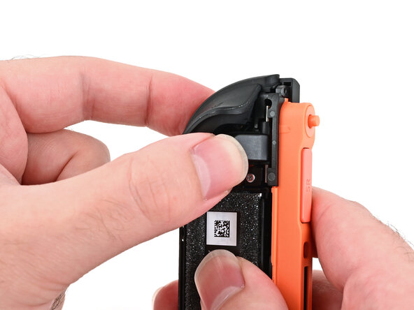

  18. Joy-Con 2 (Right) Battery Replacement, Check the release button: crwdns2935265:018crwdnd2935265:01crwdnd2935265:03crwdne2935265:0 Joy-Con 2 (Right) Battery Replacement, Check the release button: crwdns2935265:018crwdnd2935265:02crwdnd2935265:03crwdne2935265:0 Joy-Con 2 (Right) Battery Replacement, Check the release button: crwdns2935265:018crwdnd2935265:03crwdnd2935265:03crwdne2935265:0

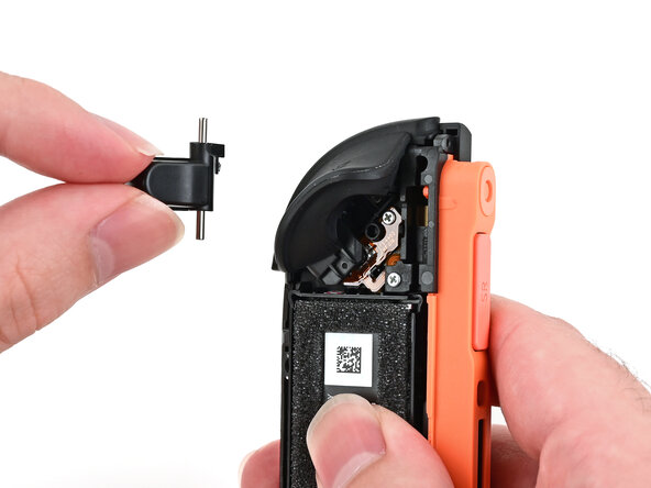

    • The release button isn't secured, and falls out easily.
    • Check that the release pin sticks out of the controller when the release button is pressed. If it doesn't, or if the button fell out entirely, re-insert the button and try again.

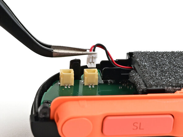

  19. Joy-Con 2 (Right) Battery Replacement, Connect the battery: crwdns2935265:019crwdnd2935265:01crwdnd2935265:03crwdne2935265:0 Joy-Con 2 (Right) Battery Replacement, Connect the battery: crwdns2935265:019crwdnd2935265:02crwdnd2935265:03crwdne2935265:0 Joy-Con 2 (Right) Battery Replacement, Connect the battery: crwdns2935265:019crwdnd2935265:03crwdnd2935265:03crwdne2935265:0
    • Align the battery connector over its socket on the board.
    • Press down on the connector until it's fully seated.
