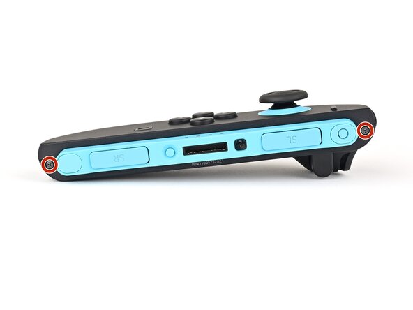

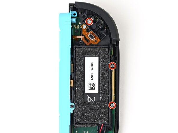

  1. Joy-Con 2 (Left) Joystick Replacement, Remove the right edge screws: crwdns2935265:01crwdnd2935265:01crwdnd2935265:02crwdne2935265:0 Joy-Con 2 (Left) Joystick Replacement, Remove the right edge screws: crwdns2935265:01crwdnd2935265:02crwdnd2935265:02crwdne2935265:0
    • Use a tri‑point Y00 driver to remove the two 3.1 mm‑long black screws on the right edge of the controller.

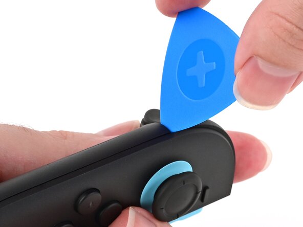

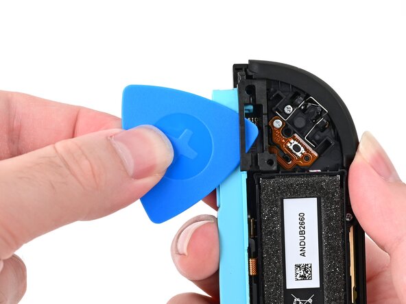

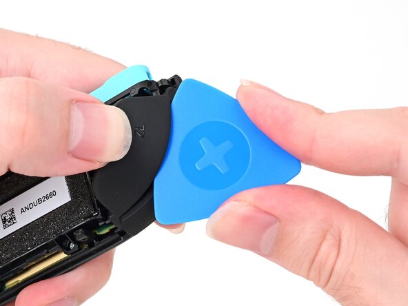

  2. Joy-Con 2 (Left) Joystick Replacement, Insert an opening pick: crwdns2935265:02crwdnd2935265:01crwdnd2935265:02crwdne2935265:0 Joy-Con 2 (Left) Joystick Replacement, Insert an opening pick: crwdns2935265:02crwdnd2935265:02crwdnd2935265:02crwdne2935265:0
    • Insert an opening pick into the gap underneath the bumper button on the left side of the controller, with a point of the pick pointing downwards.
    • Pry up to slightly lift the plastic strip running across the left edge of the controller.

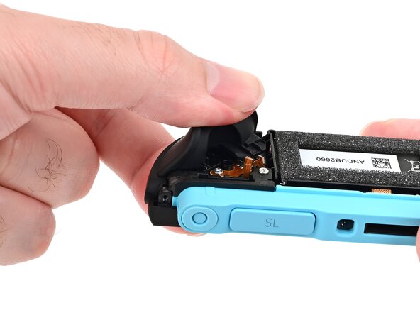

  3. Joy-Con 2 (Left) Joystick Replacement, Separate the plastic strip: crwdns2935265:03crwdnd2935265:01crwdnd2935265:03crwdne2935265:0 Joy-Con 2 (Left) Joystick Replacement, Separate the plastic strip: crwdns2935265:03crwdnd2935265:02crwdnd2935265:03crwdne2935265:0 Joy-Con 2 (Left) Joystick Replacement, Separate the plastic strip: crwdns2935265:03crwdnd2935265:03crwdnd2935265:03crwdne2935265:0
    • Slide the opening pick around to the front of the controller.
    • Slide the opening pick down the plastic strip to separate the clips and adhesive securing it to the controller's body.
  4. Joy-Con 2 (Left) Joystick Replacement, Remove the plastic strip: crwdns2935265:04crwdnd2935265:01crwdnd2935265:03crwdne2935265:0 Joy-Con 2 (Left) Joystick Replacement, Remove the plastic strip: crwdns2935265:04crwdnd2935265:02crwdnd2935265:03crwdne2935265:0 Joy-Con 2 (Left) Joystick Replacement, Remove the plastic strip: crwdns2935265:04crwdnd2935265:03crwdnd2935265:03crwdne2935265:0
    • Pry up on the bottom edge of the plastic strip with slow, steady force.
    • Repeat this prying action along the length of the strip until it's fully detached.

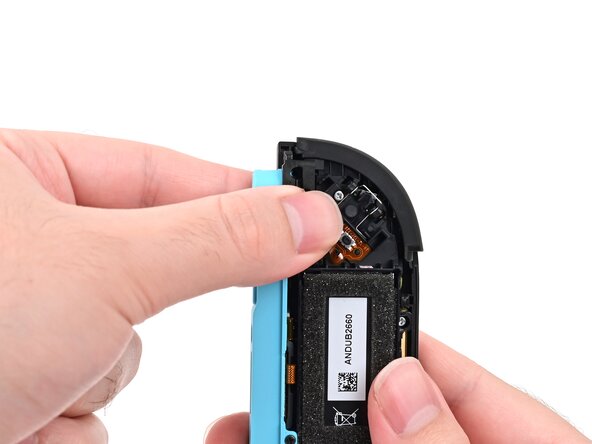

  5. Joy-Con 2 (Left) Joystick Replacement: crwdns2935265:05crwdnd2935265:01crwdnd2935265:01crwdne2935265:0
    • Remove the plastic strip.

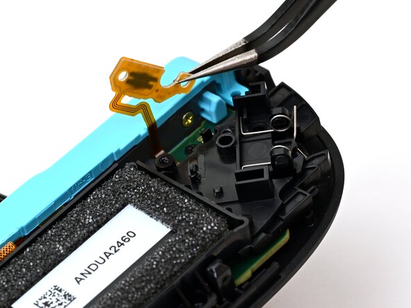

  6. Joy-Con 2 (Left) Joystick Replacement, Remove the left edge screws: crwdns2935265:06crwdnd2935265:01crwdnd2935265:02crwdne2935265:0 Joy-Con 2 (Left) Joystick Replacement, Remove the left edge screws: crwdns2935265:06crwdnd2935265:02crwdnd2935265:02crwdne2935265:0
    • Remove the two screws on the left edge of the controller:
    • One 3.1 mm‑long tri‑point Y00 black screw
    • One 3.0 mm‑long JIS 00 silver screw
    • You can use a Phillips screwdriver in a pinch, but you risk damaging or stripping the screw. Push down firmly on the screwdriver and twist slowly. Often, switching drivers may help, even if they're the same size.

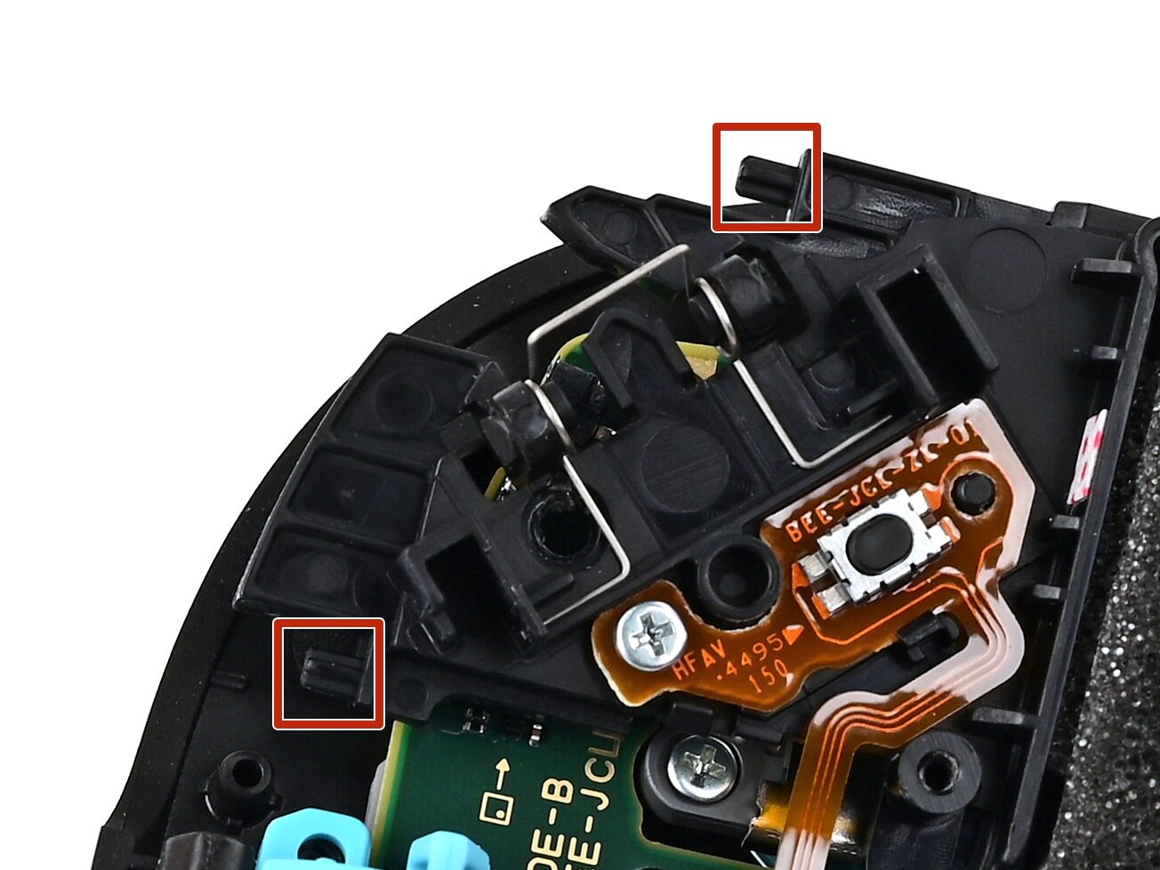

  8. Joy-Con 2 (Left) Joystick Replacement, Insert a second opening pick: crwdns2935265:08crwdnd2935265:01crwdnd2935265:03crwdne2935265:0 Joy-Con 2 (Left) Joystick Replacement, Insert a second opening pick: crwdns2935265:08crwdnd2935265:02crwdnd2935265:03crwdne2935265:0 Joy-Con 2 (Left) Joystick Replacement, Insert a second opening pick: crwdns2935265:08crwdnd2935265:03crwdnd2935265:03crwdne2935265:0
    • Hold the controller upside-down.
    • Insert a point of another opening pick next to the release button at the top of the controller.
    • Use the opening pick to press the release button through the gap.

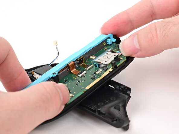

  9. Joy-Con 2 (Left) Joystick Replacement, Release the back cover: crwdns2935265:09crwdnd2935265:01crwdnd2935265:03crwdne2935265:0 Joy-Con 2 (Left) Joystick Replacement, Release the back cover: crwdns2935265:09crwdnd2935265:02crwdnd2935265:03crwdne2935265:0 Joy-Con 2 (Left) Joystick Replacement, Release the back cover: crwdns2935265:09crwdnd2935265:03crwdnd2935265:03crwdne2935265:0
    • The back cover is connected to the controller by a cable at the bottom. Don't try to remove it completely yet.
    • While holding the release button with the opening pick, use your other hand to slide the back cover down to release the clips securing it to the controller's body.
    • Open the back cover.

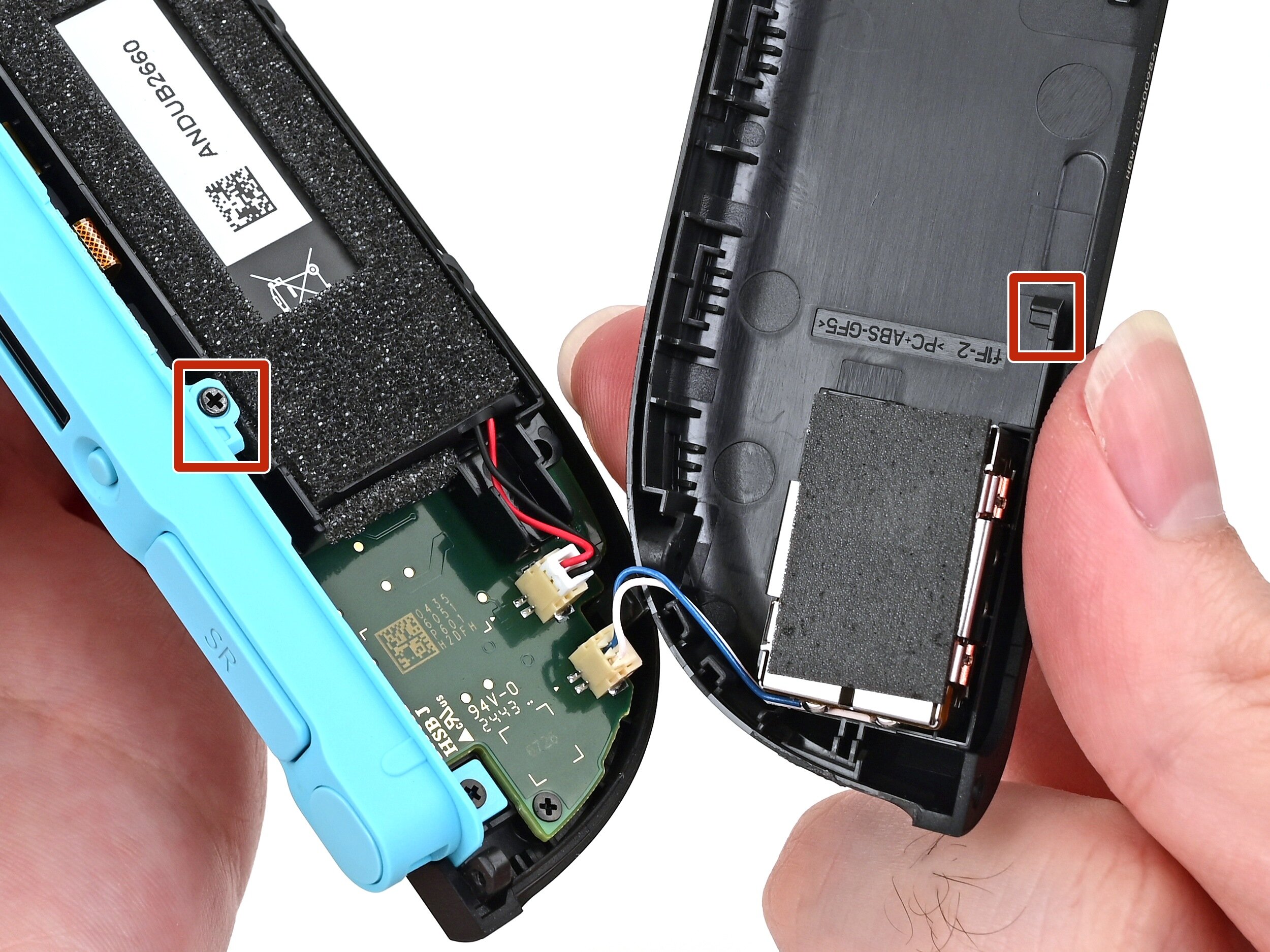

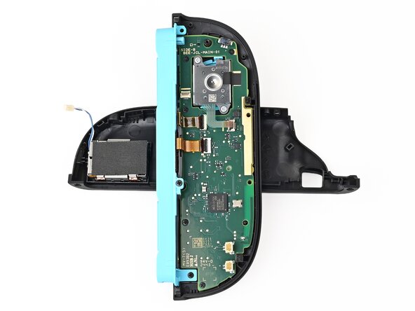

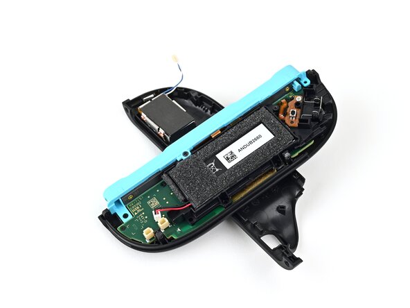

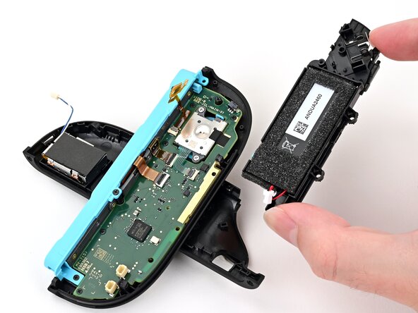

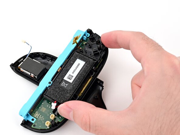

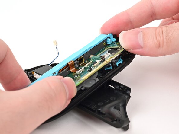

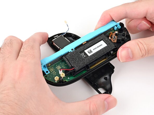

  10. Joy-Con 2 (Left) Joystick Replacement, Remove the back cover: crwdns2935265:010crwdnd2935265:01crwdnd2935265:02crwdne2935265:0 Joy-Con 2 (Left) Joystick Replacement, Remove the back cover: crwdns2935265:010crwdnd2935265:02crwdnd2935265:02crwdne2935265:0
    • Firmly grasp the two wires (blue and white) above the rumble motor connector, located at the bottom of the controller's board, and pull the beige connector out of its socket.
    • Pulling the cable won't damage it, but don't dig your nails into the plastic sheathing.
    • Remove the back cover.

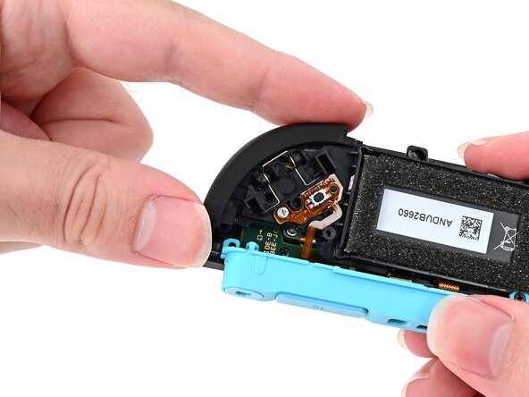

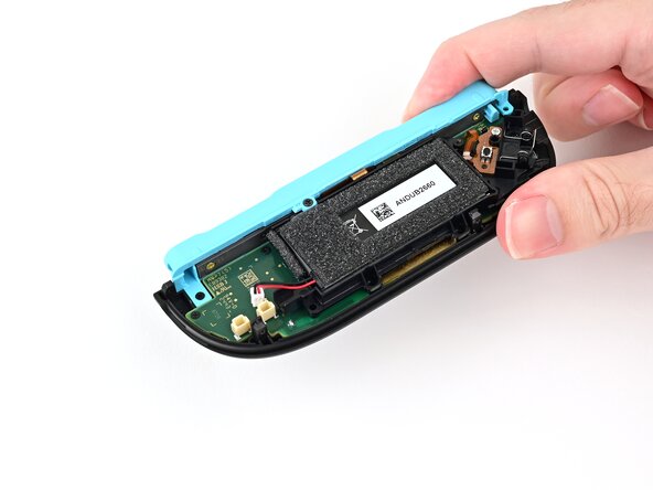

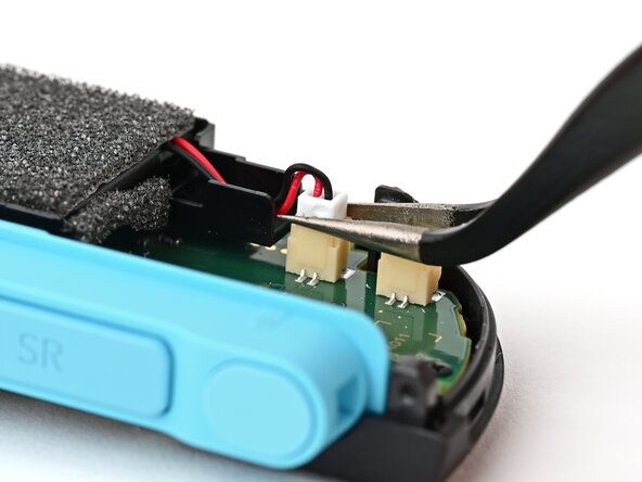

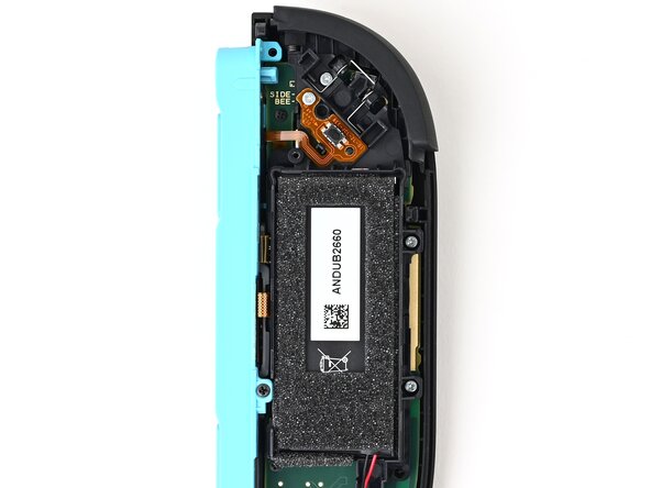

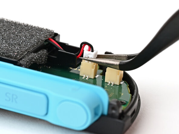

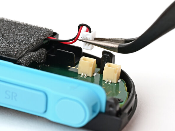

  11. Joy-Con 2 (Left) Joystick Replacement, Disconnect the battery: crwdns2935265:011crwdnd2935265:01crwdnd2935265:03crwdne2935265:0 Joy-Con 2 (Left) Joystick Replacement, Disconnect the battery: crwdns2935265:011crwdnd2935265:02crwdnd2935265:03crwdne2935265:0 Joy-Con 2 (Left) Joystick Replacement, Disconnect the battery: crwdns2935265:011crwdnd2935265:03crwdnd2935265:03crwdne2935265:0
    • Use tweezers or your fingers to firmly grip the white JST connector and pull straight away from its socket to disconnect it.
    • Once partially lifted, reposition your fingers/tweezers to beneath the connector's upper lip to increase your grip.

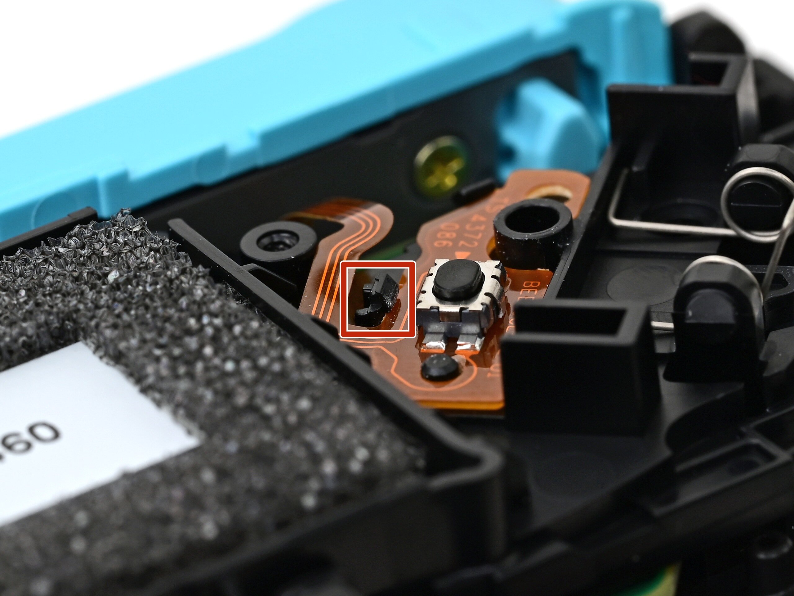

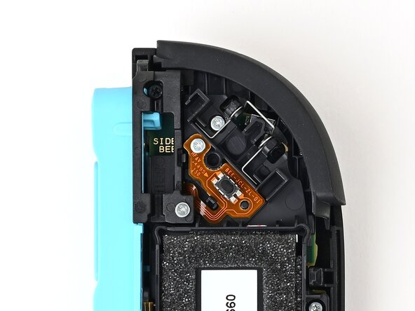

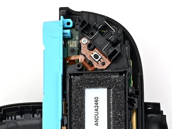

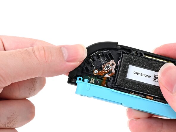

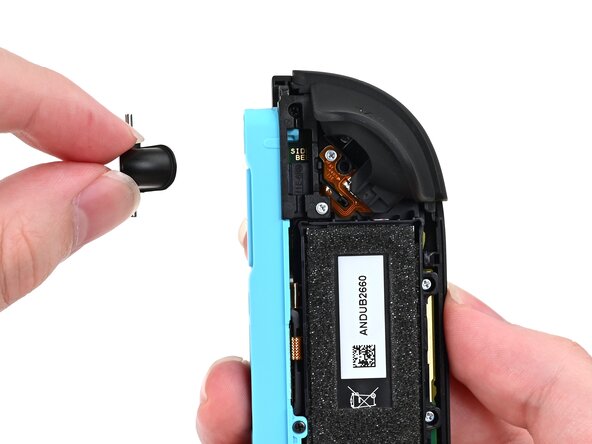

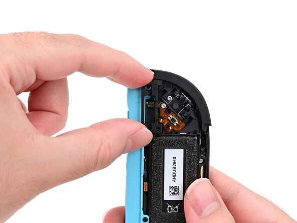

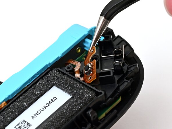

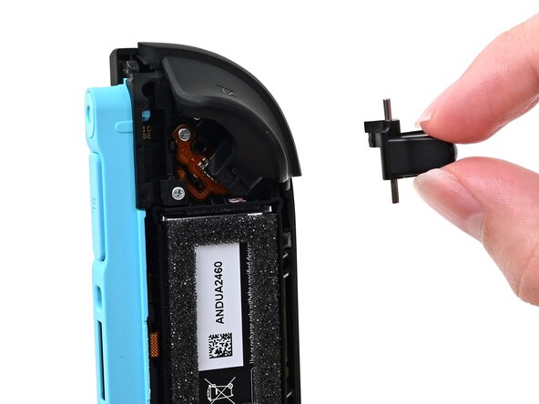

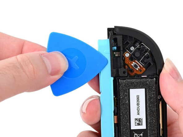

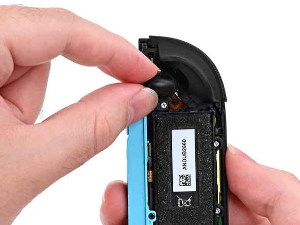

  12. Joy-Con 2 (Left) Joystick Replacement, Remove the release button: crwdns2935265:012crwdnd2935265:01crwdnd2935265:02crwdne2935265:0 Joy-Con 2 (Left) Joystick Replacement, Remove the release button: crwdns2935265:012crwdnd2935265:02crwdnd2935265:02crwdne2935265:0
    • Pick up the release button and remove it.

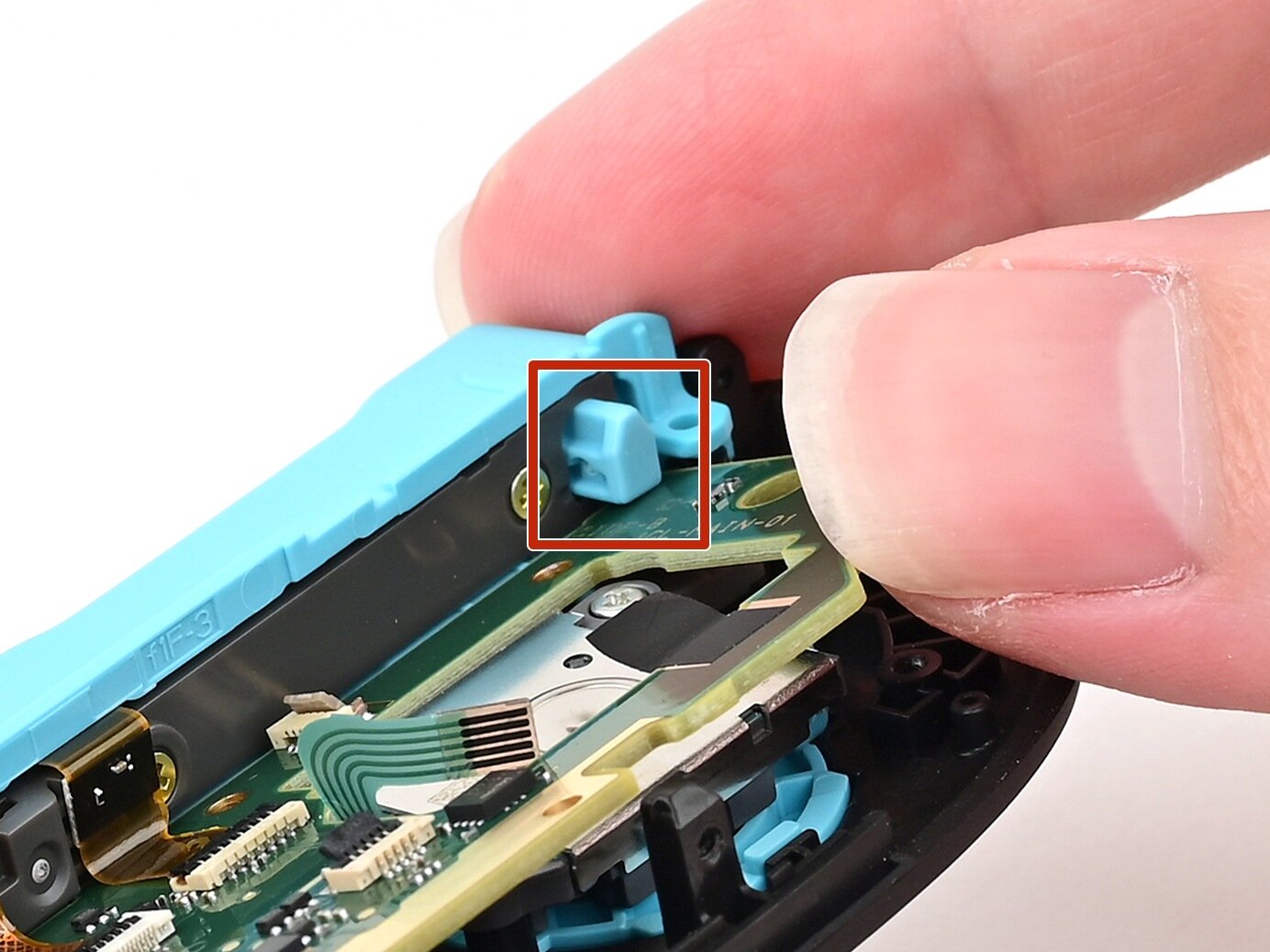

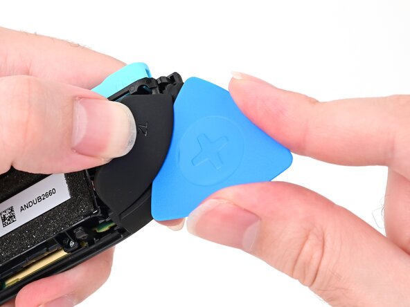

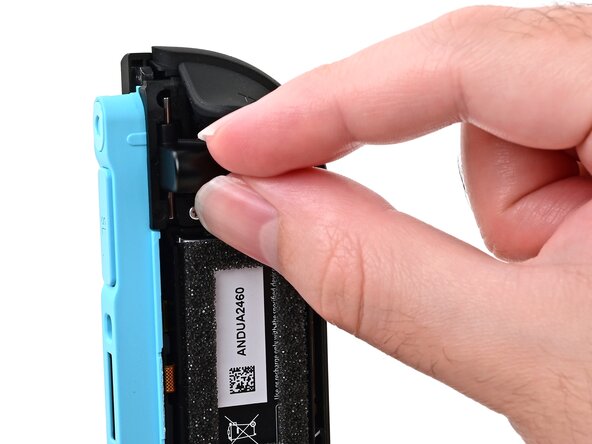

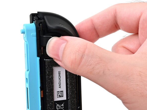

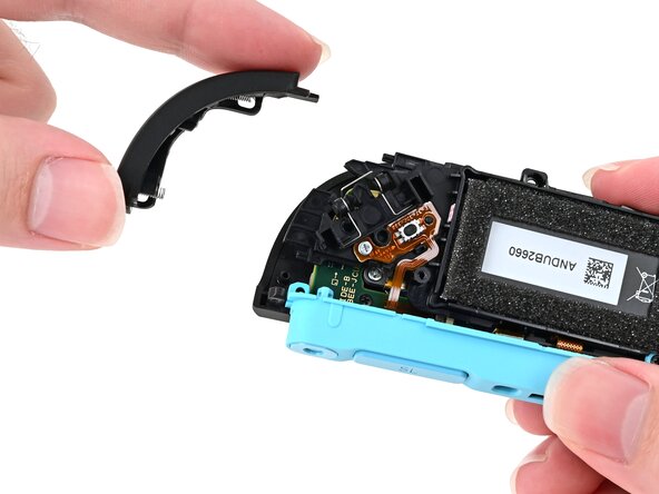

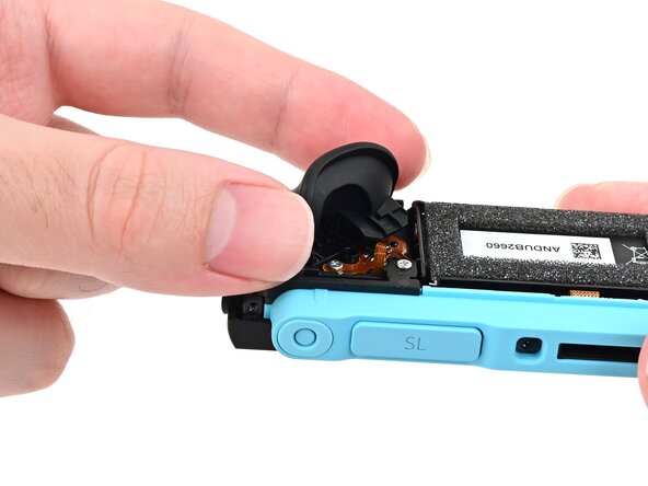

  13. Joy-Con 2 (Left) Joystick Replacement, Remove the trigger: crwdns2935265:013crwdnd2935265:01crwdnd2935265:03crwdne2935265:0 Joy-Con 2 (Left) Joystick Replacement, Remove the trigger: crwdns2935265:013crwdnd2935265:02crwdnd2935265:03crwdne2935265:0 Joy-Con 2 (Left) Joystick Replacement, Remove the trigger: crwdns2935265:013crwdnd2935265:03crwdnd2935265:03crwdne2935265:0
    • Insert an opening pick into the gap between the bumper (L) and trigger (ZL) buttons at the top of the controller.
    • Pry up on the ZL button to pop it off and remove it.
    • You can lightly hold the ZL button with your finger to avoid launching it.

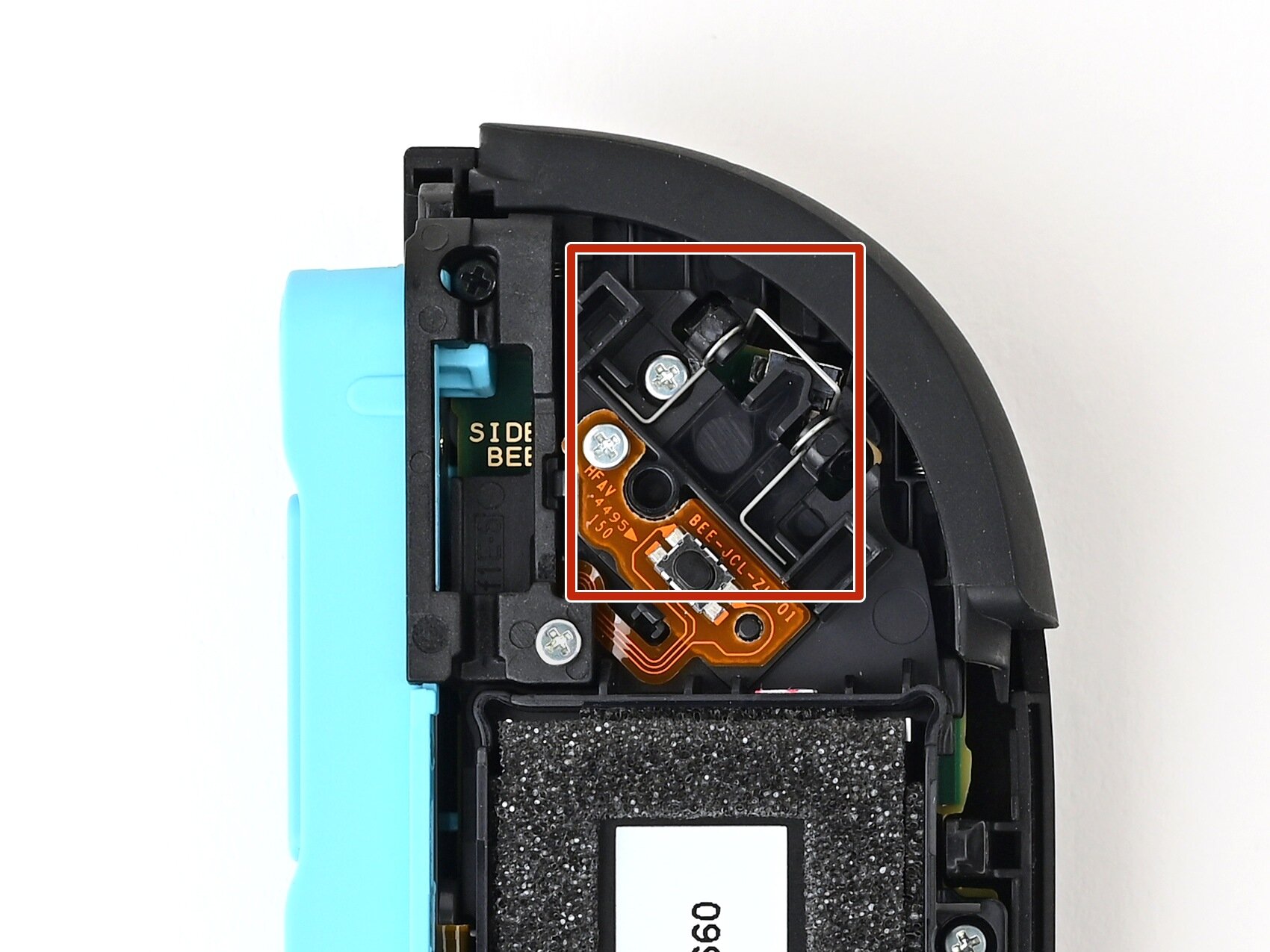

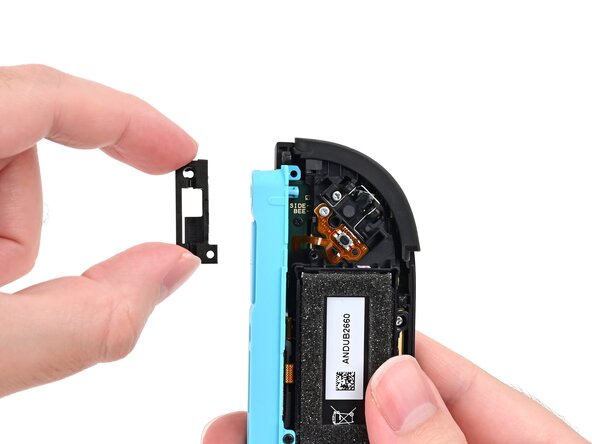

  14. Joy-Con 2 (Left) Joystick Replacement, Remove the screws: crwdns2935265:014crwdnd2935265:01crwdnd2935265:02crwdne2935265:0 Joy-Con 2 (Left) Joystick Replacement, Remove the screws: crwdns2935265:014crwdnd2935265:02crwdnd2935265:02crwdne2935265:0
    • Use a JIS 00 driver to remove the two screws securing the release button mounting bracket:
    • One 3.9 mm‑long silver screw
    • One 6.2 mm‑long black screw

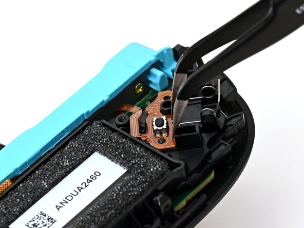

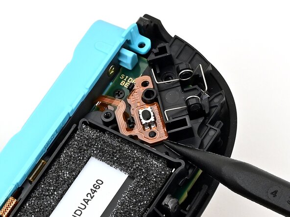

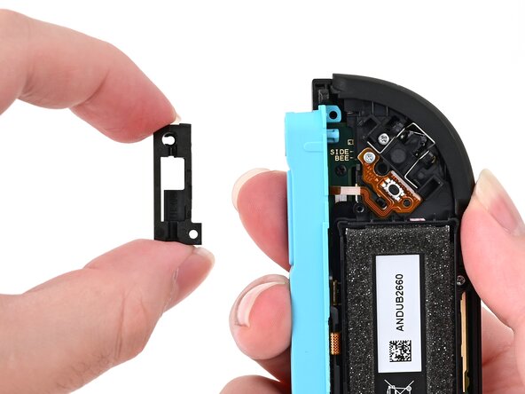

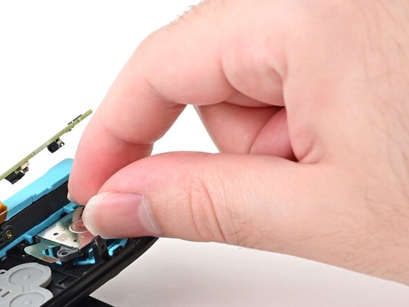

  15. Joy-Con 2 (Left) Joystick Replacement, Remove the bracket: crwdns2935265:015crwdnd2935265:01crwdnd2935265:03crwdne2935265:0 Joy-Con 2 (Left) Joystick Replacement, Remove the bracket: crwdns2935265:015crwdnd2935265:02crwdnd2935265:03crwdne2935265:0 Joy-Con 2 (Left) Joystick Replacement, Remove the bracket: crwdns2935265:015crwdnd2935265:03crwdnd2935265:03crwdne2935265:0
    • Insert an opening pick underneath the release button bracket.
    • Pry it away from the controller to remove it.

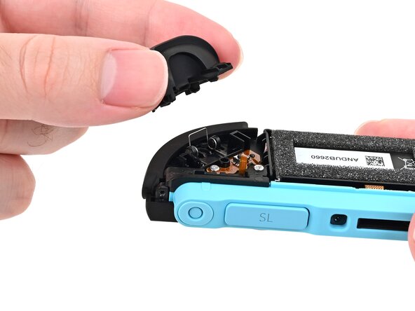

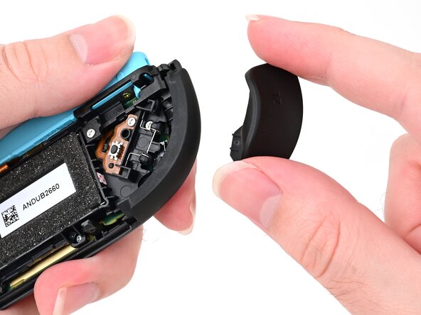

  17. Joy-Con 2 (Left) Joystick Replacement, Remove the bumper: crwdns2935265:017crwdnd2935265:01crwdnd2935265:02crwdne2935265:0 Joy-Con 2 (Left) Joystick Replacement, Remove the bumper: crwdns2935265:017crwdnd2935265:02crwdnd2935265:02crwdne2935265:0
    • Hold the midframe lightly in place.
    • Pull the L bumper button off its mounting pegs and remove it.
    • The midframe will lift slightly when removing this button.

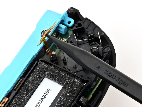

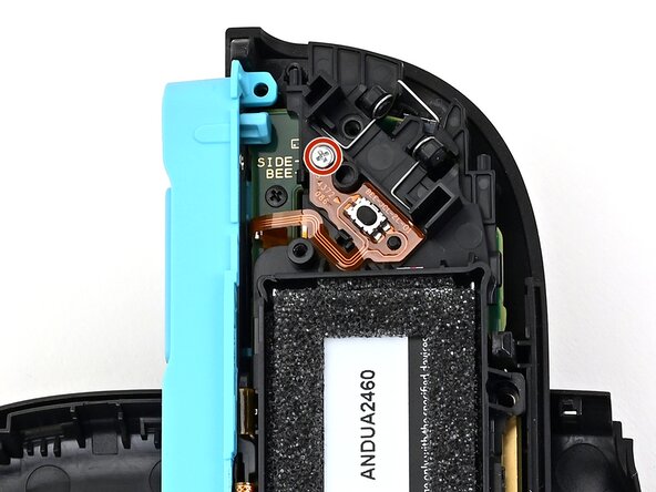

  19. Joy-Con 2 (Left) Joystick Replacement, Lift the trigger board: crwdns2935265:019crwdnd2935265:01crwdnd2935265:02crwdne2935265:0 Joy-Con 2 (Left) Joystick Replacement, Lift the trigger board: crwdns2935265:019crwdnd2935265:02crwdnd2935265:02crwdne2935265:0
    • Use a JIS 00 driver to remove the 3.9 mm‑long silver screw securing the trigger button board.
  20. Joy-Con 2 (Left) Joystick Replacement: crwdns2935265:020crwdnd2935265:01crwdnd2935265:02crwdne2935265:0 Joy-Con 2 (Left) Joystick Replacement: crwdns2935265:020crwdnd2935265:02crwdnd2935265:02crwdne2935265:0
    • Insert the point of a spudger underneath the board, and lift it until it pops up.

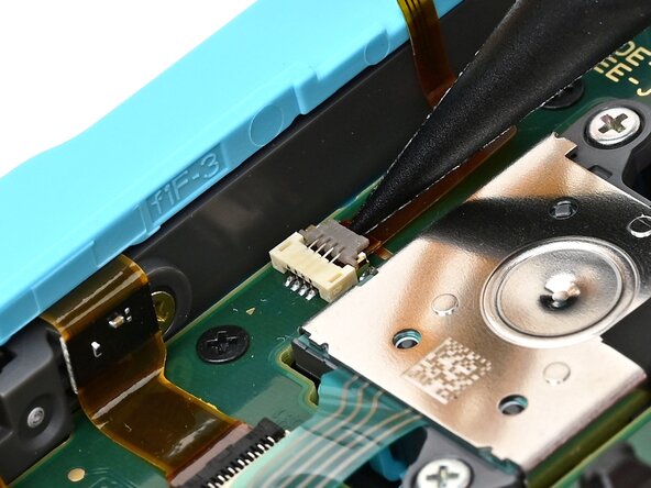

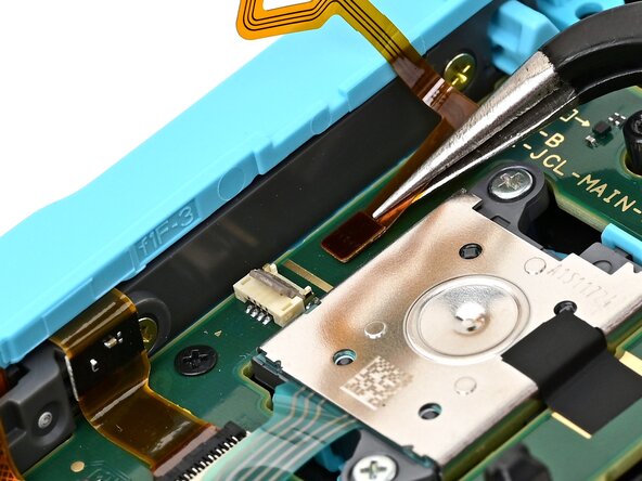

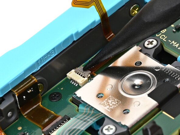

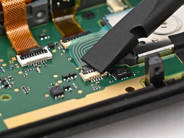

  22. Joy-Con 2 (Left) Joystick Replacement, Disconnect the trigger board: crwdns2935265:022crwdnd2935265:01crwdnd2935265:03crwdne2935265:0 Joy-Con 2 (Left) Joystick Replacement, Disconnect the trigger board: crwdns2935265:022crwdnd2935265:02crwdnd2935265:03crwdne2935265:0 Joy-Con 2 (Left) Joystick Replacement, Disconnect the trigger board: crwdns2935265:022crwdnd2935265:03crwdnd2935265:03crwdne2935265:0
    • Use the point of a spudger to flip up the locking flap on the trigger button ZIF connector, located on the controller's board.
  23. Joy-Con 2 (Left) Joystick Replacement, Remove the trigger board: crwdns2935265:023crwdnd2935265:01crwdnd2935265:02crwdne2935265:0 Joy-Con 2 (Left) Joystick Replacement, Remove the trigger board: crwdns2935265:023crwdnd2935265:02crwdnd2935265:02crwdne2935265:0
    • Use tweezers or your fingers to gently pull the cable out of its socket.
    • Remove the trigger button board.

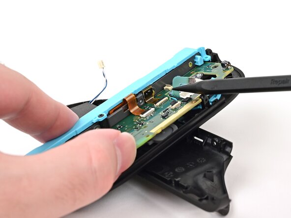

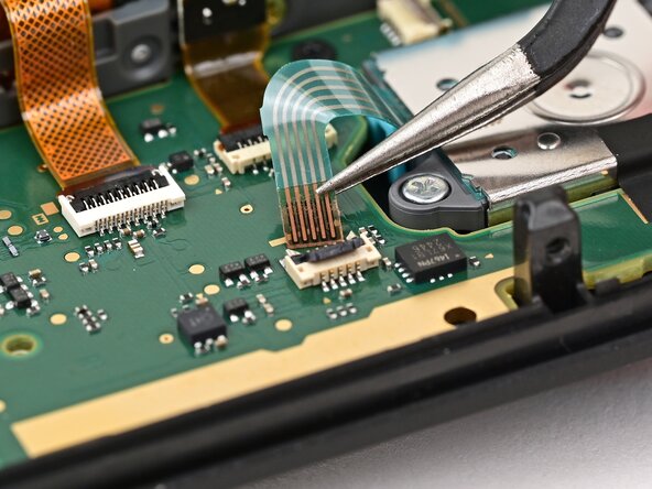

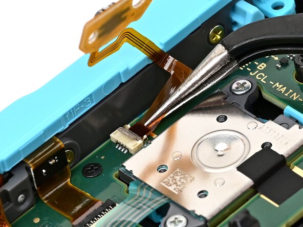

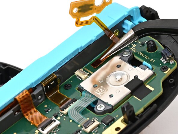

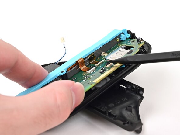

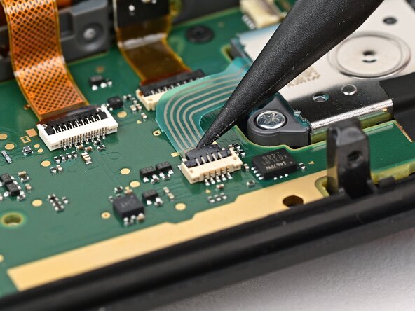

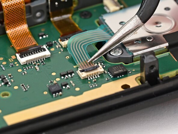

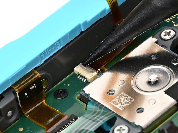

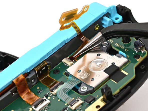

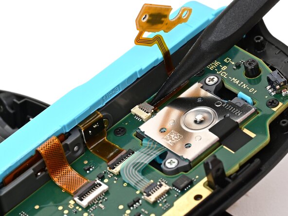

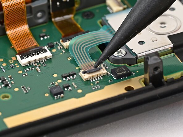

  24. Joy-Con 2 (Left) Joystick Replacement, Disconnect the joystick: crwdns2935265:024crwdnd2935265:01crwdnd2935265:02crwdne2935265:0 Joy-Con 2 (Left) Joystick Replacement, Disconnect the joystick: crwdns2935265:024crwdnd2935265:02crwdnd2935265:02crwdne2935265:0
    • Use the point of a spudger to flip up the locking flap on the joystick cable ZIF connector, located in the center of the board.
  25. Joy-Con 2 (Left) Joystick Replacement: crwdns2935265:025crwdnd2935265:01crwdnd2935265:02crwdne2935265:0 Joy-Con 2 (Left) Joystick Replacement: crwdns2935265:025crwdnd2935265:02crwdnd2935265:02crwdne2935265:0
    • Use tweezers or your fingers to grab the brown part of the cable and gently pull the cable out of its socket.

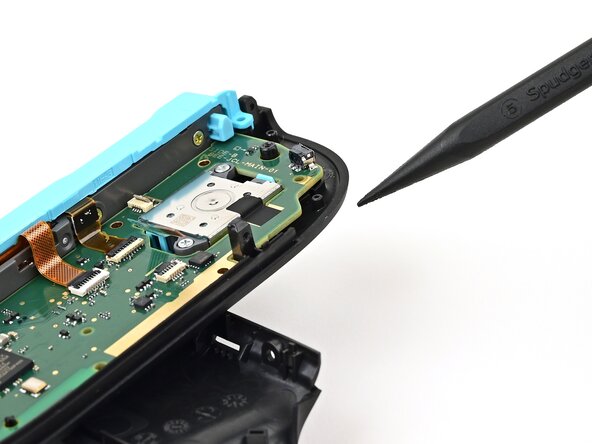

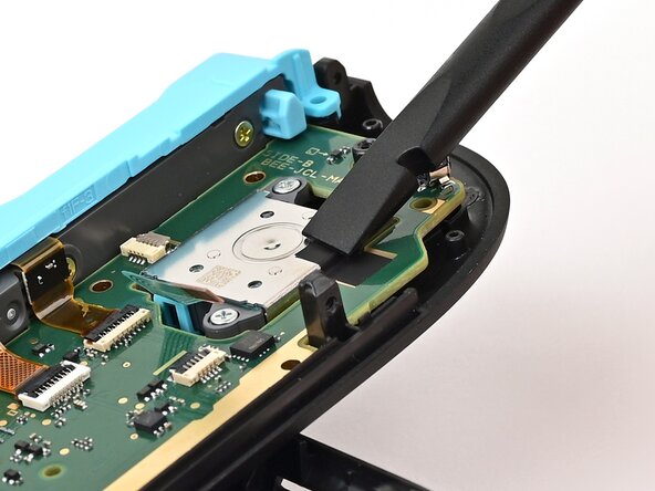

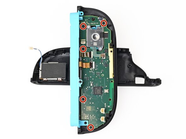

  26. Joy-Con 2 (Left) Joystick Replacement, Remove the board screws: crwdns2935265:026crwdnd2935265:01crwdnd2935265:02crwdne2935265:0 Joy-Con 2 (Left) Joystick Replacement, Remove the board screws: crwdns2935265:026crwdnd2935265:02crwdnd2935265:02crwdne2935265:0
    • Use a JIS 00 driver to remove the five 3.1 mm‑long black screws securing the board to the controller.

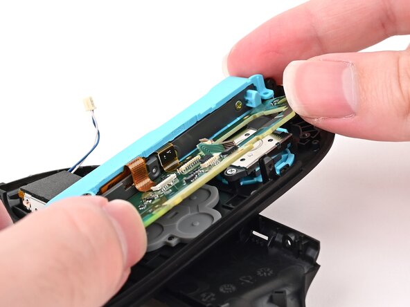

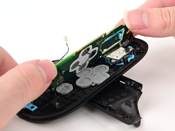

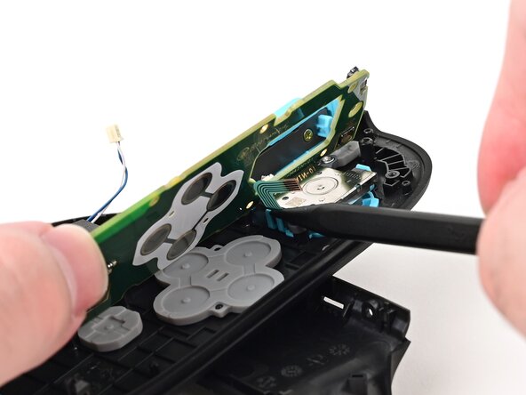

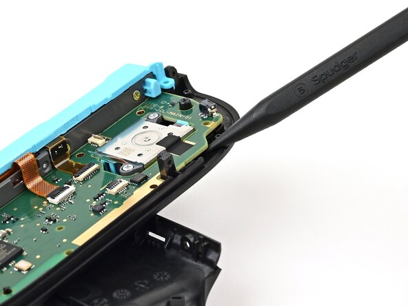

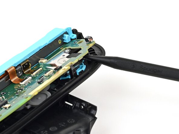

  27. Joy-Con 2 (Left) Joystick Replacement, Lift the board: crwdns2935265:027crwdnd2935265:01crwdnd2935265:03crwdne2935265:0 Joy-Con 2 (Left) Joystick Replacement, Lift the board: crwdns2935265:027crwdnd2935265:02crwdnd2935265:03crwdne2935265:0 Joy-Con 2 (Left) Joystick Replacement, Lift the board: crwdns2935265:027crwdnd2935265:03crwdnd2935265:03crwdne2935265:0
    • Insert the point of a spudger underneath the board, next to the joystick, between the board and the frame.
    • Pry up slowly on the board to lift it until you can grab it with your fingers.
    • The black tape stuck to the joystick will stay with the board. Work slowly to avoid tearing the tape.

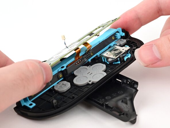

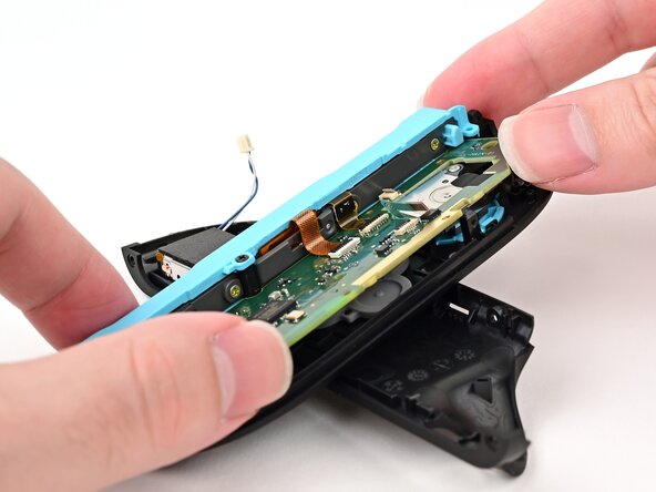

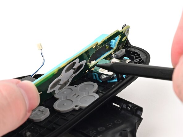

  28. Joy-Con 2 (Left) Joystick Replacement: crwdns2935265:028crwdnd2935265:01crwdnd2935265:02crwdne2935265:0 Joy-Con 2 (Left) Joystick Replacement: crwdns2935265:028crwdnd2935265:02crwdnd2935265:02crwdne2935265:0
    • Use your fingers or a spudger to lift the joystick cable up so it's perpendicular to the joystick module.
  29. Joy-Con 2 (Left) Joystick Replacement: crwdns2935265:029crwdnd2935265:01crwdnd2935265:03crwdne2935265:0 Joy-Con 2 (Left) Joystick Replacement: crwdns2935265:029crwdnd2935265:02crwdnd2935265:03crwdne2935265:0 Joy-Con 2 (Left) Joystick Replacement: crwdns2935265:029crwdnd2935265:03crwdnd2935265:03crwdne2935265:0
    • Lift the board and flip it over the controller's inner edge.
    • Be careful not to crease or tear the two ribbon cables connecting the board to the controller.

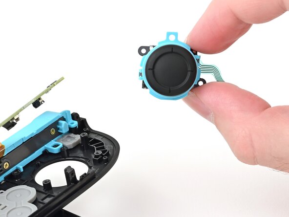

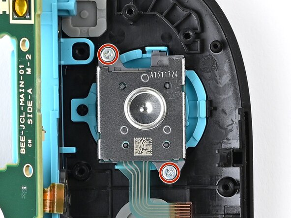

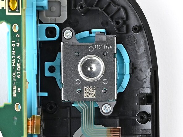

  30. Joy-Con 2 (Left) Joystick Replacement, Remove the joystick: crwdns2935265:030crwdnd2935265:01crwdnd2935265:02crwdne2935265:0 Joy-Con 2 (Left) Joystick Replacement, Remove the joystick: crwdns2935265:030crwdnd2935265:02crwdnd2935265:02crwdne2935265:0
    • Use a JIS 00 driver to remove the two 3.9 mm‑long silver screws securing the joystick.

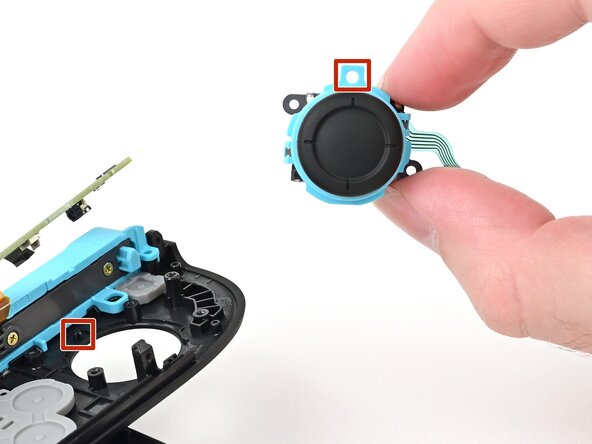

  31. Joy-Con 2 (Left) Joystick Replacement: crwdns2935265:031crwdnd2935265:01crwdnd2935265:02crwdne2935265:0 Joy-Con 2 (Left) Joystick Replacement: crwdns2935265:031crwdnd2935265:02crwdnd2935265:02crwdne2935265:0
    • Use tweezers or your fingers to pick up and remove the joystick.
  32. Joy-Con 2 (Left) Joystick Replacement, Disassembly complete: crwdns2935265:032crwdnd2935265:01crwdnd2935265:01crwdne2935265:0
    • Congratulations on completing disassembly! The remaining steps will show how to reassemble your console.
  33. Joy-Con 2 (Left) Joystick Replacement, Install the joystick: crwdns2935265:033crwdnd2935265:01crwdnd2935265:02crwdne2935265:0 Joy-Con 2 (Left) Joystick Replacement, Install the joystick: crwdns2935265:033crwdnd2935265:02crwdnd2935265:02crwdne2935265:0
    • Align the circular cut-out in the joystick's frame with the peg near the controller's inner edge.
    • Set the joystick in the controller. Gently wiggle the joystick to ensure it's fully seated.
  34. Joy-Con 2 (Left) Joystick Replacement: crwdns2935265:034crwdnd2935265:01crwdnd2935265:02crwdne2935265:0 Joy-Con 2 (Left) Joystick Replacement: crwdns2935265:034crwdnd2935265:02crwdnd2935265:02crwdne2935265:0
    • Use a JIS 00 driver to install the two 3.9 mm‑long silver screws securing the joystick.

    • Use a JIS 00 driver to install the five 3.1 mm‑long black screws securing the board to the controller.

  42. Joy-Con 2 (Left) Joystick Replacement: crwdns2935265:042crwdnd2935265:01crwdnd2935265:02crwdne2935265:0 Joy-Con 2 (Left) Joystick Replacement: crwdns2935265:042crwdnd2935265:02crwdnd2935265:02crwdne2935265:0
    • Use a JIS 00 driver to install the 3.9 mm‑long silver screw securing the trigger button board.

    • Align the release button bracket with its screw holes and set it in the frame so it snaps into place.
    • The corner with the protruding square should be facing the battery.
  46. Joy-Con 2 (Left) Joystick Replacement: crwdns2935265:046crwdnd2935265:01crwdnd2935265:02crwdne2935265:0 Joy-Con 2 (Left) Joystick Replacement: crwdns2935265:046crwdnd2935265:02crwdnd2935265:02crwdne2935265:0
    • Use a JIS 00 driver to install the two screws securing the release button bracket:
  47. Joy-Con 2 (Left) Joystick Replacement, Install the trigger: crwdns2935265:047crwdnd2935265:01crwdnd2935265:03crwdne2935265:0 Joy-Con 2 (Left) Joystick Replacement, Install the trigger: crwdns2935265:047crwdnd2935265:02crwdnd2935265:03crwdne2935265:0 Joy-Con 2 (Left) Joystick Replacement, Install the trigger: crwdns2935265:047crwdnd2935265:03crwdnd2935265:03crwdne2935265:0
    • Align the trigger button with the top of the controller, with the ZL engraving facing out.
    • Set the trigger button onto its metal spring. Ensure the legs of the metal spring are seated properly in their channels on the midframe.
    • Press firmly on the trigger button to snap it into place.
    • Check that the metal stabilizer didn't fall out of position. If it did, remove the trigger, place it back into position, and try again.

  49. Joy-Con 2 (Left) Joystick Replacement, Connect the battery: crwdns2935265:049crwdnd2935265:01crwdnd2935265:03crwdne2935265:0 Joy-Con 2 (Left) Joystick Replacement, Connect the battery: crwdns2935265:049crwdnd2935265:02crwdnd2935265:03crwdne2935265:0 Joy-Con 2 (Left) Joystick Replacement, Connect the battery: crwdns2935265:049crwdnd2935265:03crwdnd2935265:03crwdne2935265:0
    • Align the battery connector over its socket on the board.
    • Press down on the connector until it's fully seated.

  51. Joy-Con 2 (Left) Joystick Replacement, Install the back cover: crwdns2935265:051crwdnd2935265:01crwdnd2935265:03crwdne2935265:0 Joy-Con 2 (Left) Joystick Replacement, Install the back cover: crwdns2935265:051crwdnd2935265:02crwdnd2935265:03crwdne2935265:0 Joy-Con 2 (Left) Joystick Replacement, Install the back cover: crwdns2935265:051crwdnd2935265:03crwdnd2935265:03crwdne2935265:0
    • Use an opening pick to press and hold the release button.
    • Place the back cover over the controller body so the release button cutout is slightly below the release button.
    • The release button is held down when the release pin is protruding from the frame. If the release button falls out of position, put it back and try again.
    • Press and slide the back cover up until the cutout for the release button is aligned with the button itself.
    • Ensure the rumble motor wires (blue & white) are fully within the frame.

  54. Joy-Con 2 (Left) Joystick Replacement, Install the plastic strip: crwdns2935265:054crwdnd2935265:01crwdnd2935265:03crwdne2935265:0 Joy-Con 2 (Left) Joystick Replacement, Install the plastic strip: crwdns2935265:054crwdnd2935265:02crwdnd2935265:03crwdne2935265:0 Joy-Con 2 (Left) Joystick Replacement, Install the plastic strip: crwdns2935265:054crwdnd2935265:03crwdnd2935265:03crwdne2935265:0
    • Align the clips on the plastic strip with their cut-outs on the controller body.
    • Insert the clips on the bottom edge first, then insert the rest so the plastic strip sits flush.
  55. Joy-Con 2 (Left) Joystick Replacement, Install the right edge screws: crwdns2935265:055crwdnd2935265:01crwdnd2935265:02crwdne2935265:0 Joy-Con 2 (Left) Joystick Replacement, Install the right edge screws: crwdns2935265:055crwdnd2935265:02crwdnd2935265:02crwdne2935265:0
    • Use a tri‑point Y00 driver to install the two 3.1 mm‑long black screws on the right edge of the controller.
