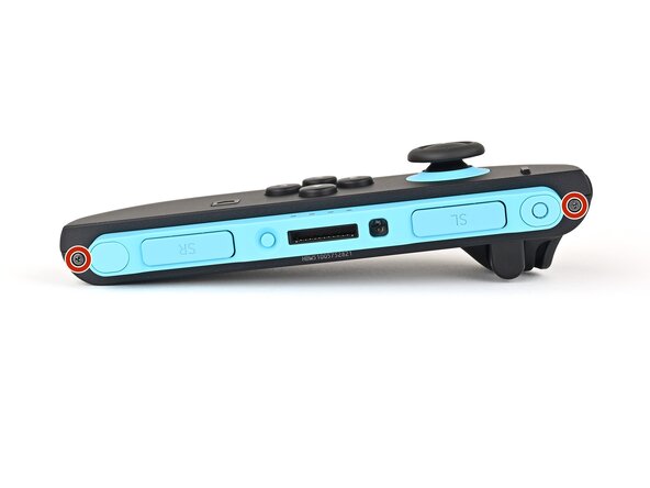

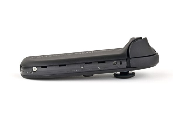

  1. Joy-Con 2 (Left) Battery Replacement, Remove the right edge screws: crwdns2935265:01crwdnd2935265:01crwdnd2935265:02crwdne2935265:0 Joy-Con 2 (Left) Battery Replacement, Remove the right edge screws: crwdns2935265:01crwdnd2935265:02crwdnd2935265:02crwdne2935265:0
    • Use a tri‑point Y00 driver to remove the two 3.1 mm‑long black screws on the right edge of the controller.

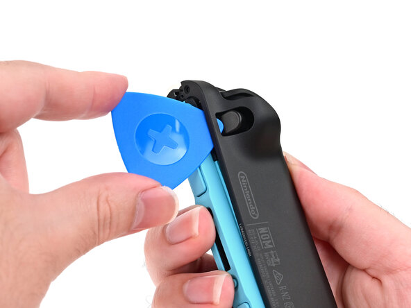

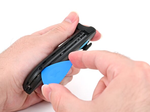

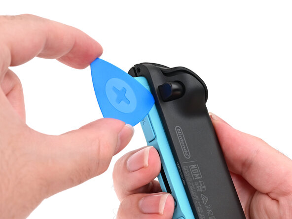

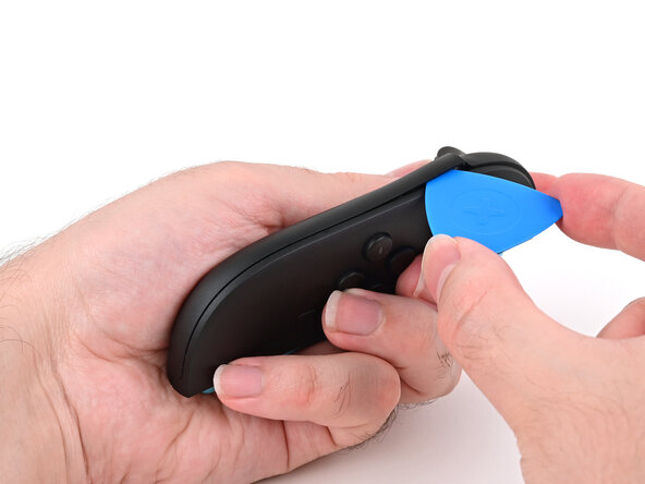

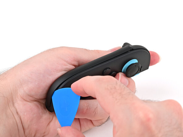

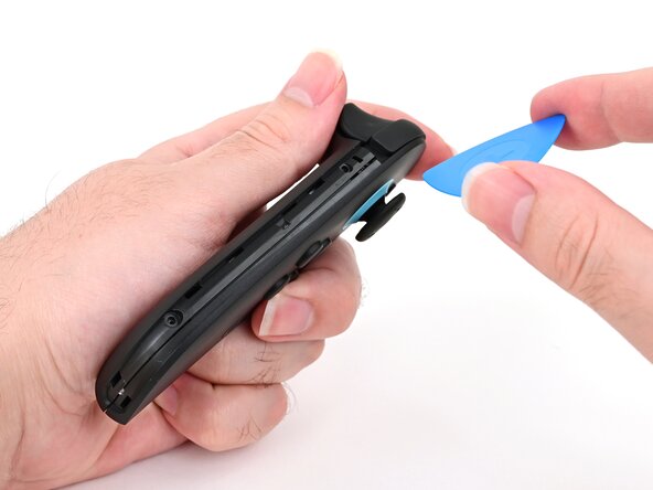

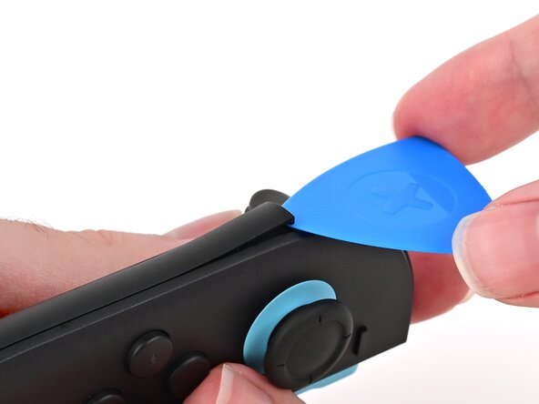

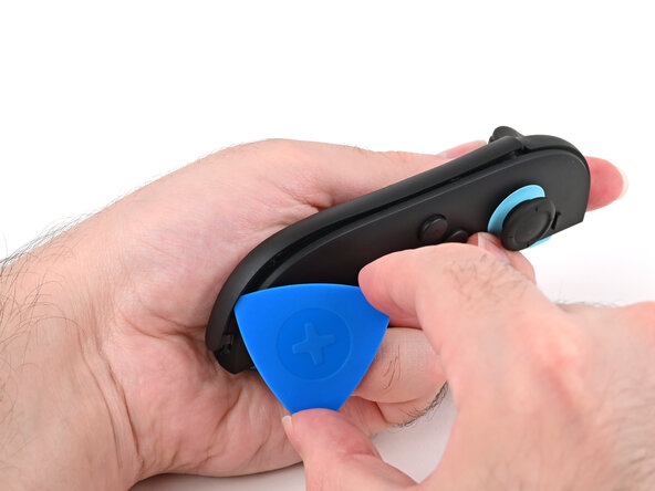

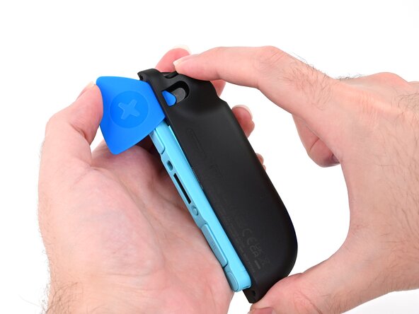

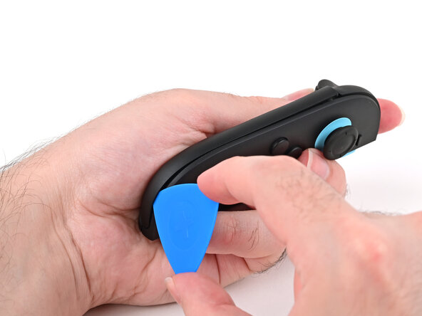

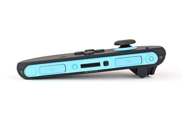

  2. Joy-Con 2 (Left) Battery Replacement, Insert an opening pick: crwdns2935265:02crwdnd2935265:01crwdnd2935265:02crwdne2935265:0 Joy-Con 2 (Left) Battery Replacement, Insert an opening pick: crwdns2935265:02crwdnd2935265:02crwdnd2935265:02crwdne2935265:0
    • Insert an opening pick into the gap underneath the bumper button on the left side of the controller, with a point of the pick pointing downwards.
    • Pry up to slightly lift the plastic strip running across the left edge of the controller.

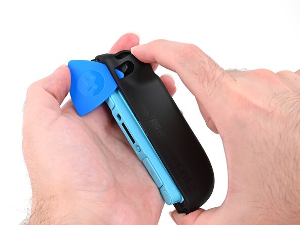

  3. Joy-Con 2 (Left) Battery Replacement, Separate the plastic strip: crwdns2935265:03crwdnd2935265:01crwdnd2935265:03crwdne2935265:0 Joy-Con 2 (Left) Battery Replacement, Separate the plastic strip: crwdns2935265:03crwdnd2935265:02crwdnd2935265:03crwdne2935265:0 Joy-Con 2 (Left) Battery Replacement, Separate the plastic strip: crwdns2935265:03crwdnd2935265:03crwdnd2935265:03crwdne2935265:0
    • Slide the opening pick around to the front of the controller.
    • Slide the opening pick down the plastic strip to separate the clips and adhesive securing it to the controller's body.

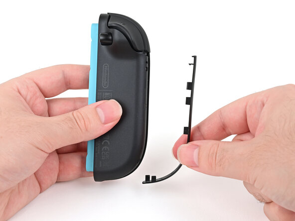

  4. Joy-Con 2 (Left) Battery Replacement, Remove the plastic strip: crwdns2935265:04crwdnd2935265:01crwdnd2935265:03crwdne2935265:0 Joy-Con 2 (Left) Battery Replacement, Remove the plastic strip: crwdns2935265:04crwdnd2935265:02crwdnd2935265:03crwdne2935265:0 Joy-Con 2 (Left) Battery Replacement, Remove the plastic strip: crwdns2935265:04crwdnd2935265:03crwdnd2935265:03crwdne2935265:0
    • Pry up on the bottom edge of the plastic strip with slow, steady force.
    • Repeat this prying action along the length of the strip until it's fully detached.
  5. Joy-Con 2 (Left) Battery Replacement: crwdns2935265:05crwdnd2935265:01crwdnd2935265:01crwdne2935265:0
    • Remove the plastic strip.

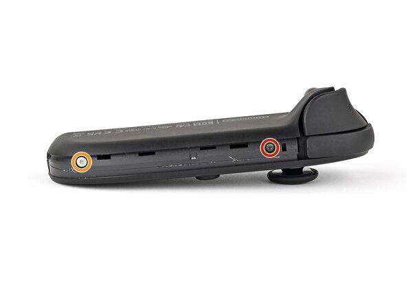

  6. Joy-Con 2 (Left) Battery Replacement, Remove the left edge screws: crwdns2935265:06crwdnd2935265:01crwdnd2935265:02crwdne2935265:0 Joy-Con 2 (Left) Battery Replacement, Remove the left edge screws: crwdns2935265:06crwdnd2935265:02crwdnd2935265:02crwdne2935265:0
    • Remove the two screws on the left edge of the controller:
    • One 3.1 mm‑long tri‑point Y00 black screw
    • One 3.0 mm‑long JIS 00 silver screw

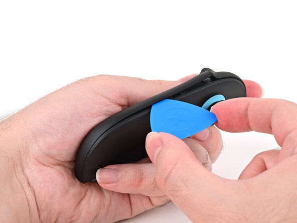

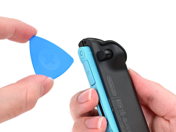

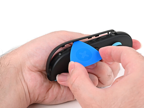

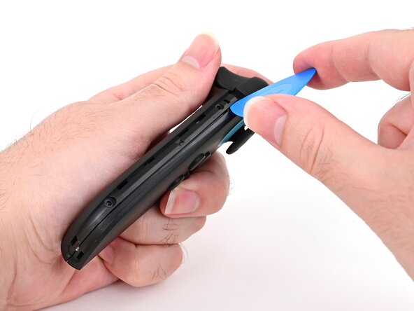

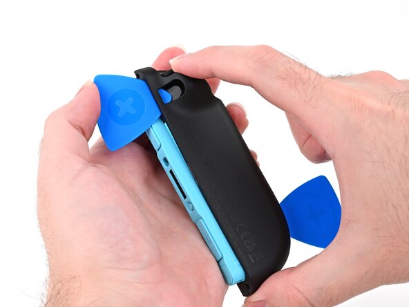

  7. Joy-Con 2 (Left) Battery Replacement, Insert an opening pick: crwdns2935265:07crwdnd2935265:01crwdnd2935265:03crwdne2935265:0 Joy-Con 2 (Left) Battery Replacement, Insert an opening pick: crwdns2935265:07crwdnd2935265:02crwdnd2935265:03crwdne2935265:0 Joy-Con 2 (Left) Battery Replacement, Insert an opening pick: crwdns2935265:07crwdnd2935265:03crwdnd2935265:03crwdne2935265:0
    • Don't try to remove the back cover yet.
    • Insert an opening pick into the gap between the front and back halves of the controller on its left side.
    • Slide the pick down the controller to disengage the clips.
    • Leave the opening pick at the bottom of the controller's left edge, just before its curve.
    • The opening pick will fall out once the back cover is removed. If it falls out before then, put it back to keep the two halves separated.

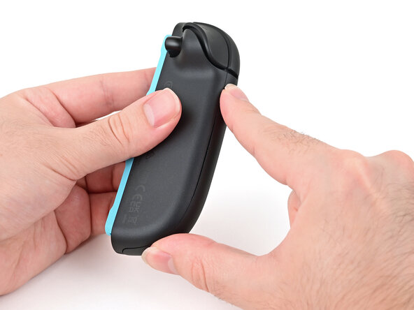

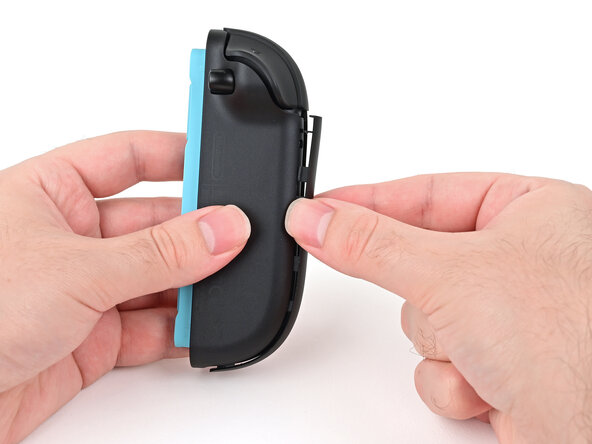

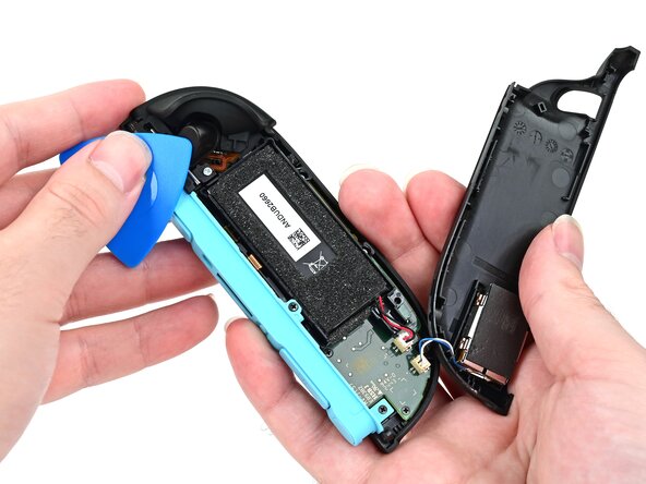

  9. Joy-Con 2 (Left) Battery Replacement, Release the back cover: crwdns2935265:09crwdnd2935265:01crwdnd2935265:03crwdne2935265:0 Joy-Con 2 (Left) Battery Replacement, Release the back cover: crwdns2935265:09crwdnd2935265:02crwdnd2935265:03crwdne2935265:0 Joy-Con 2 (Left) Battery Replacement, Release the back cover: crwdns2935265:09crwdnd2935265:03crwdnd2935265:03crwdne2935265:0
    • The back cover is connected to the controller by a cable at the bottom. Don't try to remove it completely yet.
    • While holding the release button with the opening pick, use your other hand to slide the back cover down to release the clips securing it to the controller's body.
    • Open the back cover.

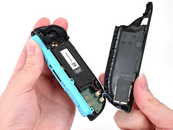

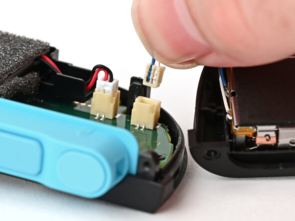

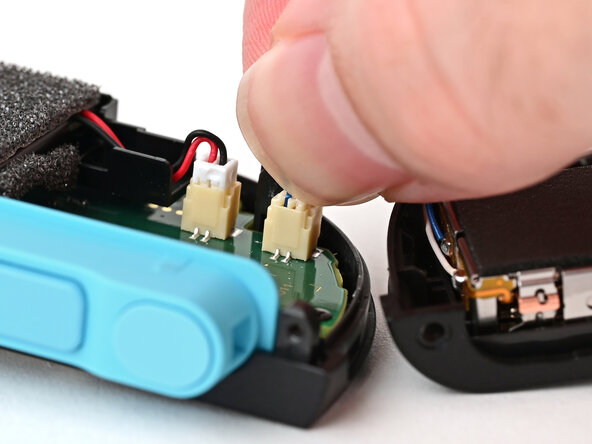

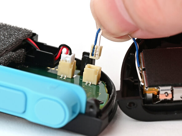

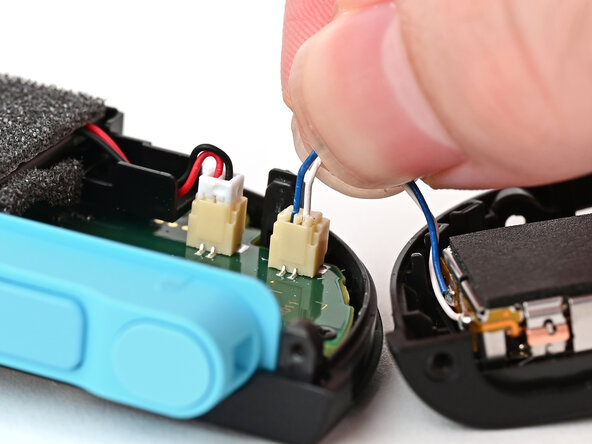

  10. Joy-Con 2 (Left) Battery Replacement, Remove the back cover: crwdns2935265:010crwdnd2935265:01crwdnd2935265:02crwdne2935265:0 Joy-Con 2 (Left) Battery Replacement, Remove the back cover: crwdns2935265:010crwdnd2935265:02crwdnd2935265:02crwdne2935265:0
    • Firmly grasp the two wires (blue and white) above the rumble motor connector, located at the bottom of the controller's board, and pull the beige connector out of its socket.
    • Pulling the cable won't damage it, but don't dig your nails into the plastic sheathing.
    • Remove the back cover.

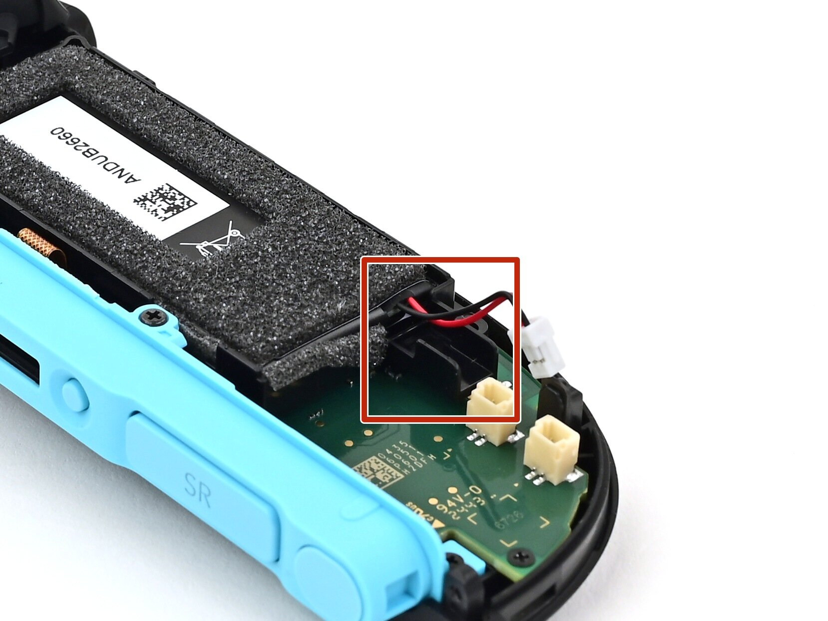

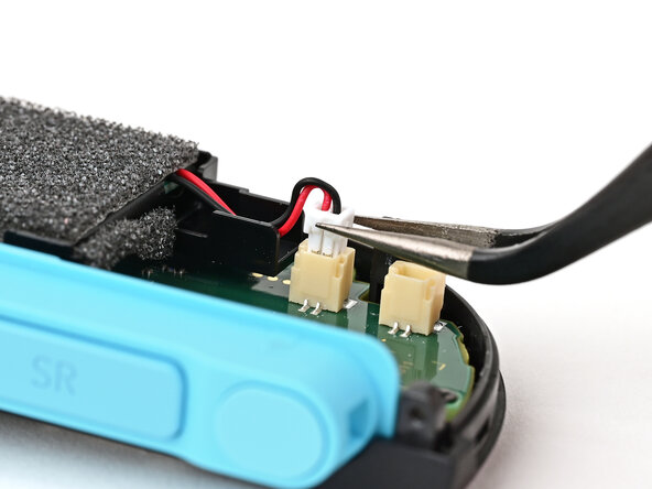

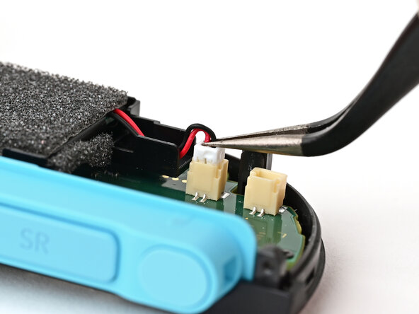

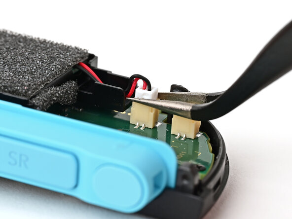

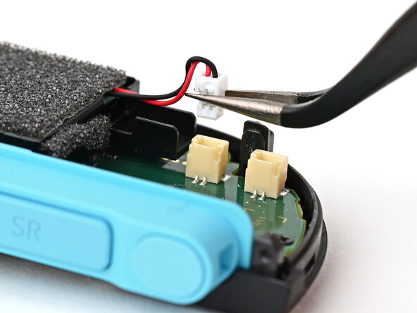

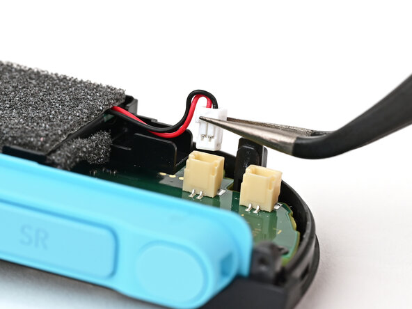

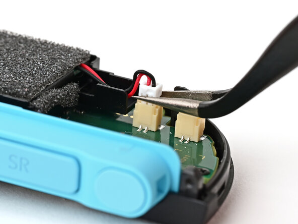

  11. Joy-Con 2 (Left) Battery Replacement, Disconnect the battery: crwdns2935265:011crwdnd2935265:01crwdnd2935265:03crwdne2935265:0 Joy-Con 2 (Left) Battery Replacement, Disconnect the battery: crwdns2935265:011crwdnd2935265:02crwdnd2935265:03crwdne2935265:0 Joy-Con 2 (Left) Battery Replacement, Disconnect the battery: crwdns2935265:011crwdnd2935265:03crwdnd2935265:03crwdne2935265:0
    • Use tweezers or your fingers to firmly grip the battery cable's white JST connector and pull straight away from its socket to disconnect it.
    • Once partially lifted, reposition your fingers/tweezers to beneath the connector's upper lip to increase your grip.

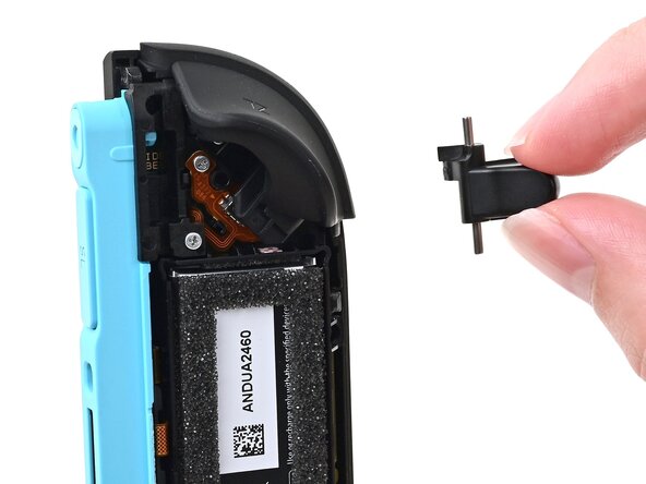

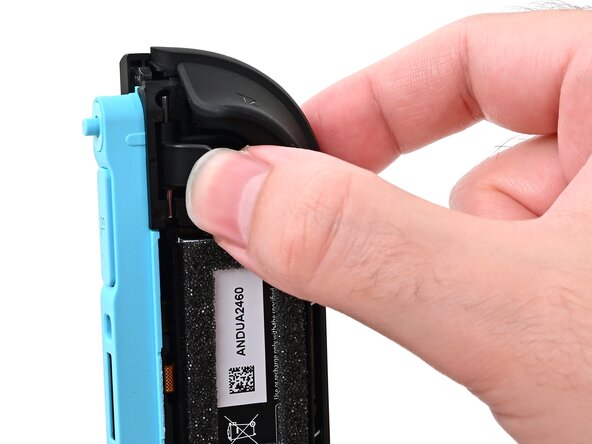

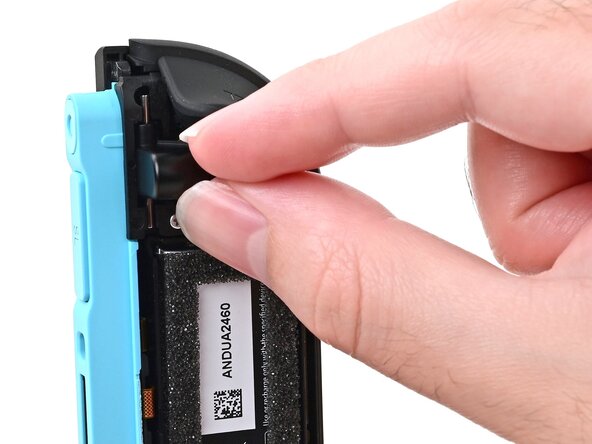

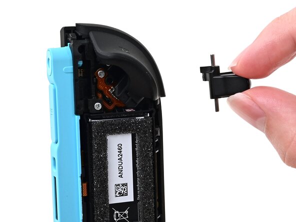

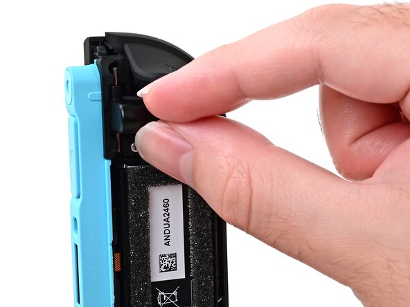

  12. Joy-Con 2 (Left) Battery Replacement, Remove the release button: crwdns2935265:012crwdnd2935265:01crwdnd2935265:02crwdne2935265:0 Joy-Con 2 (Left) Battery Replacement, Remove the release button: crwdns2935265:012crwdnd2935265:02crwdnd2935265:02crwdne2935265:0
    • Pick up the release button and remove it.

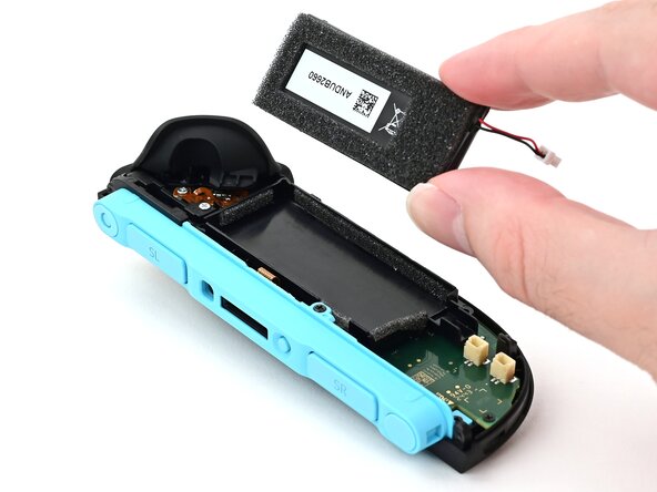

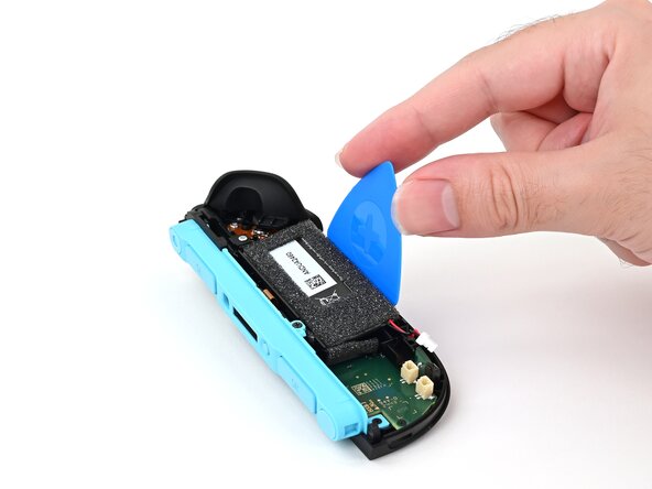

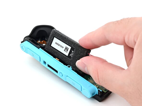

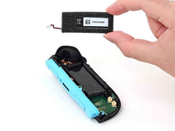

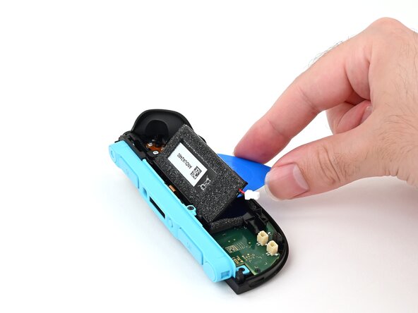

  13. Joy-Con 2 (Left) Battery Replacement, Remove the battery: crwdns2935265:013crwdnd2935265:01crwdnd2935265:03crwdne2935265:0 Joy-Con 2 (Left) Battery Replacement, Remove the battery: crwdns2935265:013crwdnd2935265:02crwdnd2935265:03crwdne2935265:0 Joy-Con 2 (Left) Battery Replacement, Remove the battery: crwdns2935265:013crwdnd2935265:03crwdnd2935265:03crwdne2935265:0
    iFixit Adhesive Remover
    $19.99
    • Insert a flat edge of an opening pick into the gap between the battery and the battery well.
    • Pry the battery up slowly with steady force to release the adhesive.
    • Don't bend or crease the battery—apply steady force and give the adhesive time to release.
    • If it feels stubborn, apply a few drops of adhesive remover or high-concentration (90% or higher) isopropyl alcohol to the battery side of the pick while it's inserted and allow it to run under the battery. Be careful not to spill it elsewhere in the controller.
    • If you're using adhesive remover, follow these preparation steps first.
    • Remove the battery.

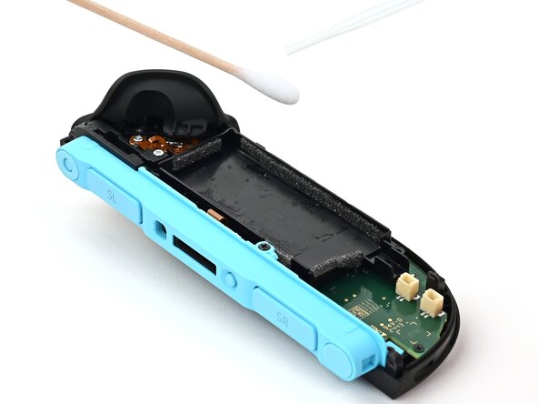

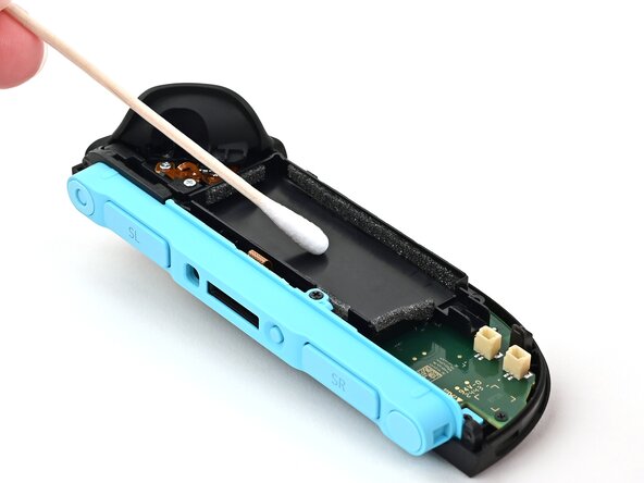

  15. Joy-Con 2 (Left) Battery Replacement, Clean the frame: crwdns2935265:015crwdnd2935265:01crwdnd2935265:02crwdne2935265:0 Joy-Con 2 (Left) Battery Replacement, Clean the frame: crwdns2935265:015crwdnd2935265:02crwdnd2935265:02crwdne2935265:0
    Cotton Swabs
    • Apply isopropyl alcohol to a cotton swab and wipe any adhesive residue from the frame.
    • The foam on the inside walls of the frame dissolves in isopropyl alcohol. Avoid damaging the foam.

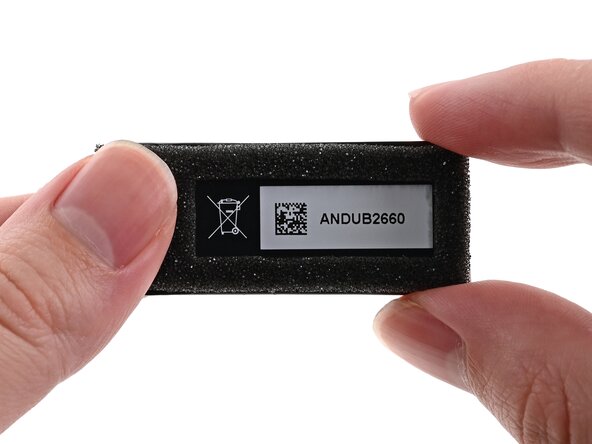

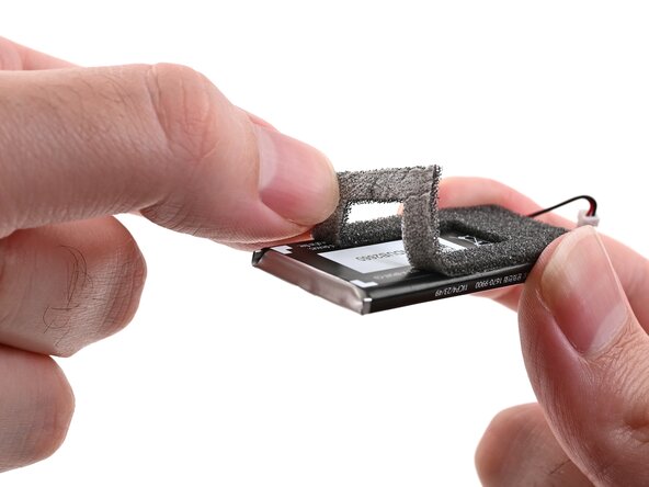

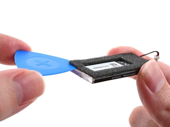

  16. Joy-Con 2 (Left) Battery Replacement, Transfer the foam: crwdns2935265:016crwdnd2935265:01crwdnd2935265:03crwdne2935265:0 Joy-Con 2 (Left) Battery Replacement, Transfer the foam: crwdns2935265:016crwdnd2935265:02crwdnd2935265:03crwdne2935265:0 Joy-Con 2 (Left) Battery Replacement, Transfer the foam: crwdns2935265:016crwdnd2935265:03crwdnd2935265:03crwdne2935265:0
    • If your replacement battery includes new foam, skip this step.
    • Slide an opening pick or fingernail between the foam and the battery, making sure it's completely below the foam's adhesive.
    • Carefully peel the foam sticker, including its adhesive, off the old battery. Avoid stretching or tearing the foam.
    • If the foam does tear, apply the pieces to the replacement battery in their original shape.
    • Apply the foam sticker to the new battery so the edges of the foam are aligned with the edges of the battery.

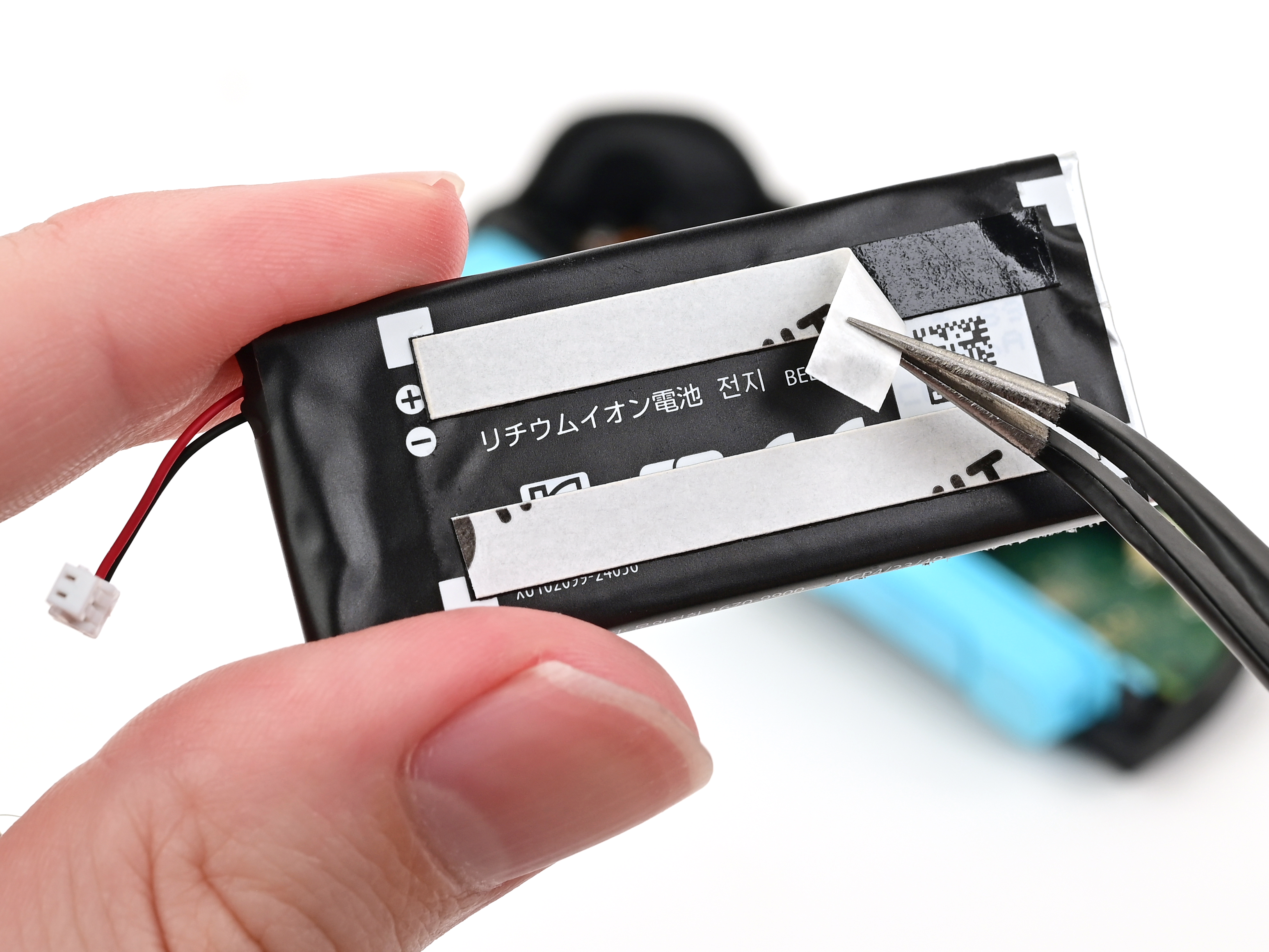

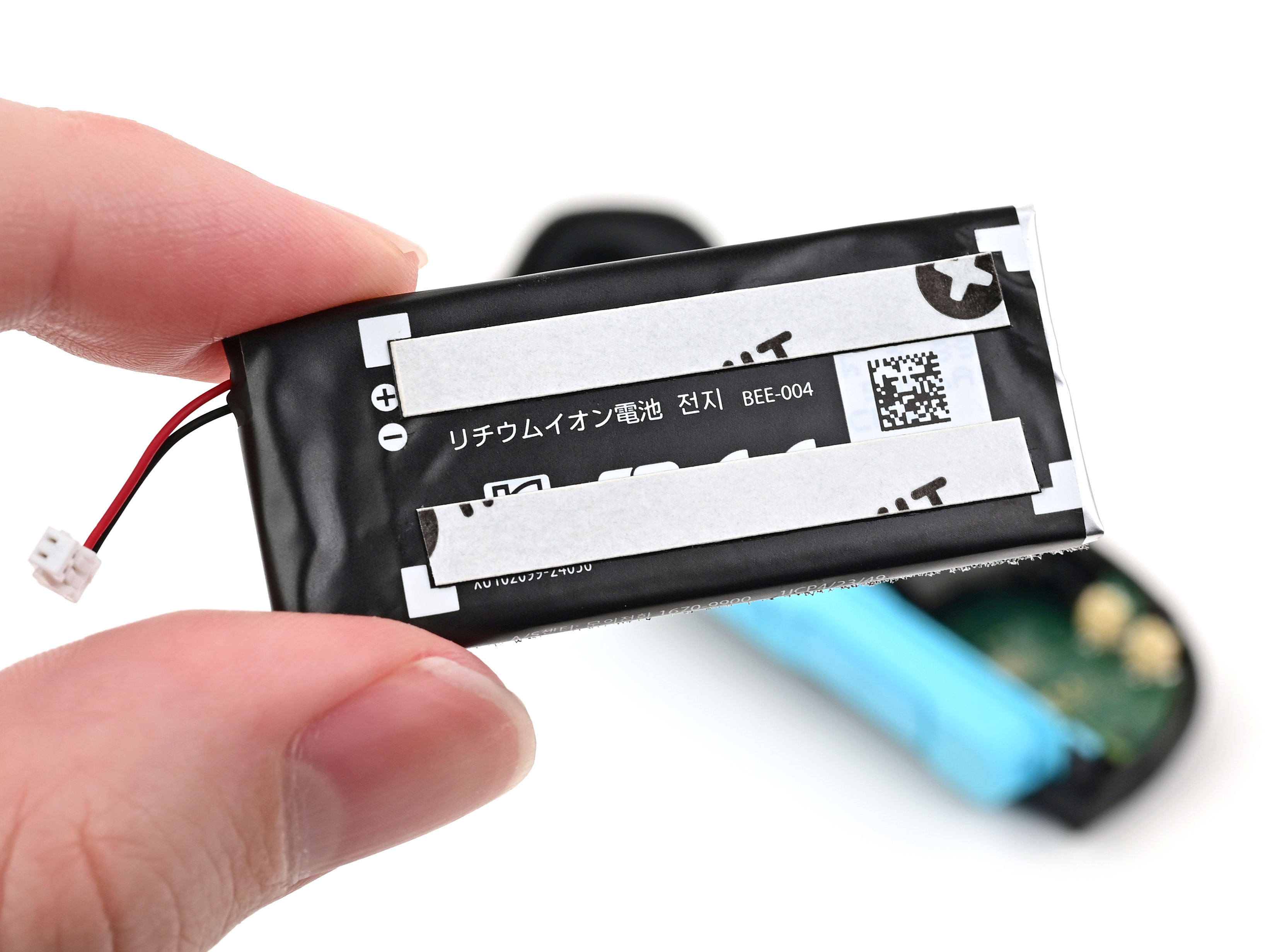

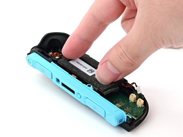

  17. Joy-Con 2 (Left) Battery Replacement, Install the battery: crwdns2935265:017crwdnd2935265:01crwdnd2935265:03crwdne2935265:0 Joy-Con 2 (Left) Battery Replacement, Install the battery: crwdns2935265:017crwdnd2935265:02crwdnd2935265:03crwdne2935265:0 Joy-Con 2 (Left) Battery Replacement, Install the battery: crwdns2935265:017crwdnd2935265:03crwdnd2935265:03crwdne2935265:0
    Tesa 61395 Tape
    $2.99
    • If your replacement battery came with adhesive pre-installed, peel off any adhesive liners.
    • If your replacement battery doesn't include new adhesive, use thin, double-sided tape instead. If you're using our pre-cut card, cut one of the 5 mm strips so it's half as long, and apply the strips to the back of the battery.
    • Align the battery with its housing. Ensure the battery cable lines up with its channel.
    • Lower one side of the battery, then the other, into its housing.
    • Press and hold on the battery for 10 seconds to bond the adhesive.
  18. Joy-Con 2 (Left) Battery Replacement, Install the release button: crwdns2935265:018crwdnd2935265:01crwdnd2935265:03crwdne2935265:0 Joy-Con 2 (Left) Battery Replacement, Install the release button: crwdns2935265:018crwdnd2935265:02crwdnd2935265:03crwdne2935265:0 Joy-Con 2 (Left) Battery Replacement, Install the release button: crwdns2935265:018crwdnd2935265:03crwdnd2935265:03crwdne2935265:0
    • Hold the release button so its smooth face is perpendicular to the controller.
    • Insert the release button into its bracket.
    • If the release pin doesn't stick out of the controller when the button is pressed, the button isn't installed correctly. Re-insert or flip the button and try again.
