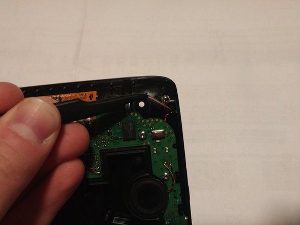

    • Gently lift the front panel off of the device and carefully rest it to the side.
  4. Jabra Freeway Microphone Replacement, Microphone: crwdns2935265:04crwdnd2935265:01crwdnd2935265:03crwdne2935265:0 Jabra Freeway Microphone Replacement, Microphone: crwdns2935265:04crwdnd2935265:02crwdnd2935265:03crwdne2935265:0 Jabra Freeway Microphone Replacement, Microphone: crwdns2935265:04crwdnd2935265:03crwdnd2935265:03crwdne2935265:0
    • Remove the microphone from the microphone holding slot.
  5. Jabra Freeway Microphone Replacement: crwdns2935265:05crwdnd2935265:01crwdnd2935265:01crwdne2935265:0
    • Desolder the two wires connecting to the microphone.
    • Please refer to the soldering technique guide for instructions on desoldering and soldering.

Based on my limited experience with this device, the component being replaced here is the secondary, or noise-cancelling microphone - not to be confused with the primary microphone. The other video showing replacement of the motion detector seems to be actually replacing the primary microphone.
