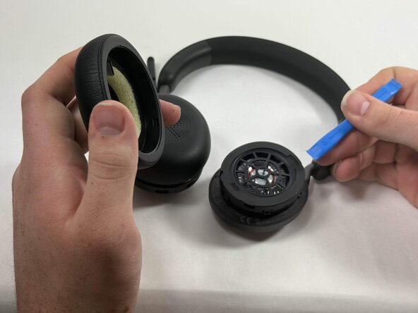

Jabra Evolve2 65 Speaker Replacement
  1. Jabra Evolve2 65 Speaker Replacement, Ear Pads: crwdns2935265:01crwdnd2935265:01crwdnd2935265:01crwdne2935265:0
    • Lay your headphones down on a flat, solid surface.
  2. Jabra Evolve2 65 Speaker Replacement: crwdns2935265:02crwdnd2935265:01crwdnd2935265:02crwdne2935265:0 Jabra Evolve2 65 Speaker Replacement: crwdns2935265:02crwdnd2935265:02crwdnd2935265:02crwdne2935265:0
    • Insert an opening tool into the seam between the ear pad and driver housing, near the hinge.
    • Gently pry the ear pad away from the driver housing until it releases.
  3. Jabra Evolve2 65 Speaker Replacement: crwdns2935265:03crwdnd2935265:01crwdnd2935265:02crwdne2935265:0 Jabra Evolve2 65 Speaker Replacement: crwdns2935265:03crwdnd2935265:02crwdnd2935265:02crwdne2935265:0
    • Pry off the other ear pad in the same manner.

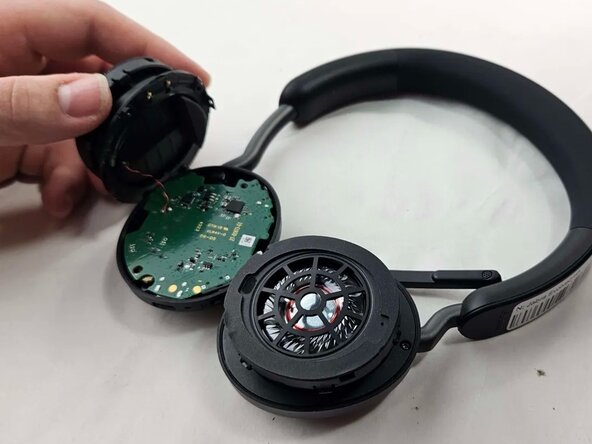

  7. Jabra Evolve2 65 Speaker Replacement: crwdns2935265:07crwdnd2935265:01crwdnd2935265:03crwdne2935265:0 Jabra Evolve2 65 Speaker Replacement: crwdns2935265:07crwdnd2935265:02crwdnd2935265:03crwdne2935265:0 Jabra Evolve2 65 Speaker Replacement: crwdns2935265:07crwdnd2935265:03crwdnd2935265:03crwdne2935265:0
    • Use an opening tool to pry up and set aside the driver housing.
    • Gently remove the motherboard from the housing..
  8. Jabra Evolve2 65 Speaker Replacement: crwdns2935265:08crwdnd2935265:01crwdnd2935265:03crwdne2935265:0 Jabra Evolve2 65 Speaker Replacement: crwdns2935265:08crwdnd2935265:02crwdnd2935265:03crwdne2935265:0 Jabra Evolve2 65 Speaker Replacement: crwdns2935265:08crwdnd2935265:03crwdnd2935265:03crwdne2935265:0
    • After locating the battery underneath, use a pair of tweezers to disconnect all connected cables.
    • Using tweezers, gently wiggle out the connector that joins the battery to the motherboard. The correct connector will be labeled on the motherboard and is the one that contains 2 wires, one black and one red.
  9. Jabra Evolve2 65 Speaker Replacement: crwdns2935265:09crwdnd2935265:01crwdnd2935265:01crwdne2935265:0
    • Using a soldering iron, desolder the driver connections from the motherboard.
    • When reinstalling the driver to the motherboard, make sure you solder the driver connections to the correct terminals. The red wire goes to the "P" and the black wire goes to the "N."
  10. Jabra Evolve2 65 Speaker Replacement, Speaker: crwdns2935265:010crwdnd2935265:01crwdnd2935265:02crwdne2935265:0 Jabra Evolve2 65 Speaker Replacement, Speaker: crwdns2935265:010crwdnd2935265:02crwdnd2935265:02crwdne2935265:0
    • Remove the driver assembly.
