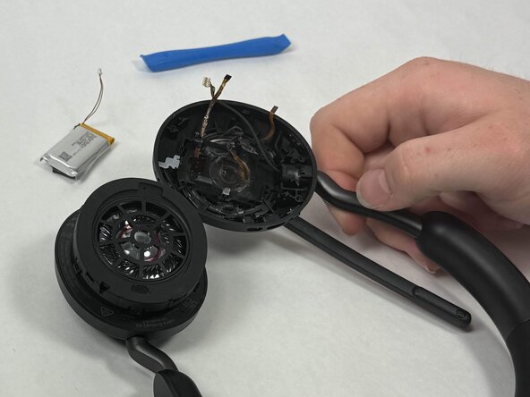

    • Use an opening tool to pry up and set aside the driver housing.
    • Gently remove the motherboard from the housing..
  8. Jabra Evolve2 65 Microphone Replacement: crwdns2935265:08crwdnd2935265:01crwdnd2935265:03crwdne2935265:0 Jabra Evolve2 65 Microphone Replacement: crwdns2935265:08crwdnd2935265:02crwdnd2935265:03crwdne2935265:0 Jabra Evolve2 65 Microphone Replacement: crwdns2935265:08crwdnd2935265:03crwdnd2935265:03crwdne2935265:0
    • After locating the battery underneath, use a pair of tweezers to disconnect all connected cables.
    • Using tweezers, gently wiggle out the connector that joins the battery to the motherboard. The correct connector will be labeled on the motherboard and is the one that contains 2 wires, one black and one red.
  9. Jabra Evolve2 65 Microphone Replacement: crwdns2935265:09crwdnd2935265:01crwdnd2935265:01crwdne2935265:0
    • Using a soldering iron, desolder the driver connections from the motherboard.
    • When reinstalling the driver to the motherboard, make sure you solder the driver connections to the correct terminals. The red wire goes to the "P" and the black wire goes to the "N."
  10. Jabra Evolve2 65 Microphone Replacement, Battery: crwdns2935265:010crwdnd2935265:01crwdnd2935265:03crwdne2935265:0 Jabra Evolve2 65 Microphone Replacement, Battery: crwdns2935265:010crwdnd2935265:02crwdnd2935265:03crwdne2935265:0 Jabra Evolve2 65 Microphone Replacement, Battery: crwdns2935265:010crwdnd2935265:03crwdnd2935265:03crwdne2935265:0
    • Using an opening tool, gently pry out the battery.
  11. Jabra Evolve2 65 Microphone Replacement, Microphone: crwdns2935265:011crwdnd2935265:01crwdnd2935265:02crwdne2935265:0 Jabra Evolve2 65 Microphone Replacement, Microphone: crwdns2935265:011crwdnd2935265:02crwdnd2935265:02crwdne2935265:0
    • Hold the microphone arm in place tightly.
    • Twist the arm downwards and pull gently, but firmly until it comes off.
    • If microphone does not disconnect right away, wiggle the microphone arm slightly up and down until it pops out of place.
