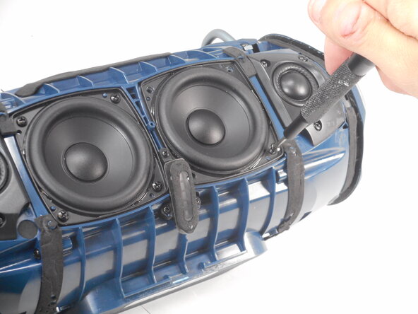

  7. JBL Xtreme 4 Woofers Replacement, Woofers: crwdns2935265:07crwdnd2935265:01crwdnd2935265:02crwdne2935265:0 JBL Xtreme 4 Woofers Replacement, Woofers: crwdns2935265:07crwdnd2935265:02crwdnd2935265:02crwdne2935265:0
    • Use a Phillips screwdriver to remove the four 10.3 mm screws that secure the woofer.

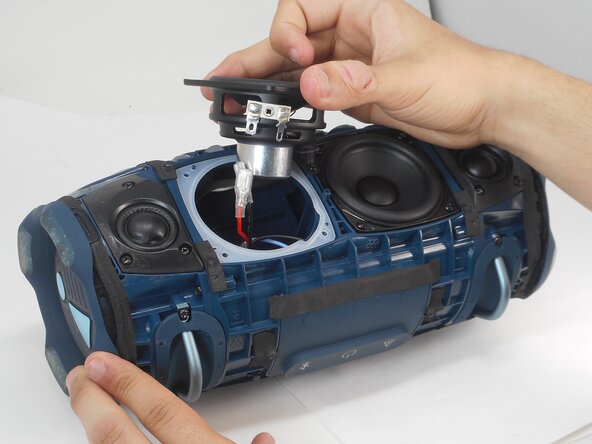

  8. JBL Xtreme 4 Woofers Replacement: crwdns2935265:08crwdnd2935265:01crwdnd2935265:02crwdne2935265:0 JBL Xtreme 4 Woofers Replacement: crwdns2935265:08crwdnd2935265:02crwdnd2935265:02crwdne2935265:0
    • Use an opening tool to lift the woofer out of the chassis.
    • Take care not to strain the connected cables.

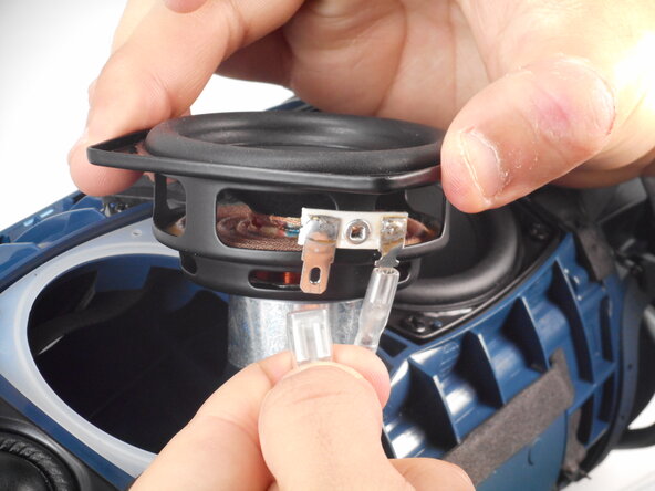

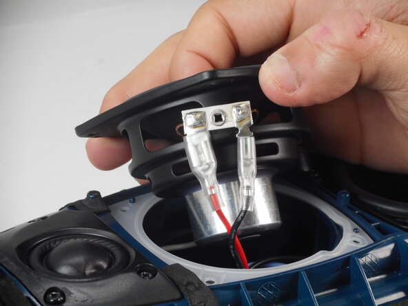

  9. JBL Xtreme 4 Woofers Replacement: crwdns2935265:09crwdnd2935265:01crwdnd2935265:03crwdne2935265:0 JBL Xtreme 4 Woofers Replacement: crwdns2935265:09crwdnd2935265:02crwdnd2935265:03crwdne2935265:0 JBL Xtreme 4 Woofers Replacement: crwdns2935265:09crwdnd2935265:03crwdnd2935265:03crwdne2935265:0
    • Disconnect both of the cables by pinching the tab and pulling them off the terminals.
  10. JBL Xtreme 4 Woofers Replacement: crwdns2935265:010crwdnd2935265:01crwdnd2935265:02crwdne2935265:0 JBL Xtreme 4 Woofers Replacement: crwdns2935265:010crwdnd2935265:02crwdnd2935265:02crwdne2935265:0
    • Remove the woofer from the device body.
    • Repeat the procedure for the other woofer.
