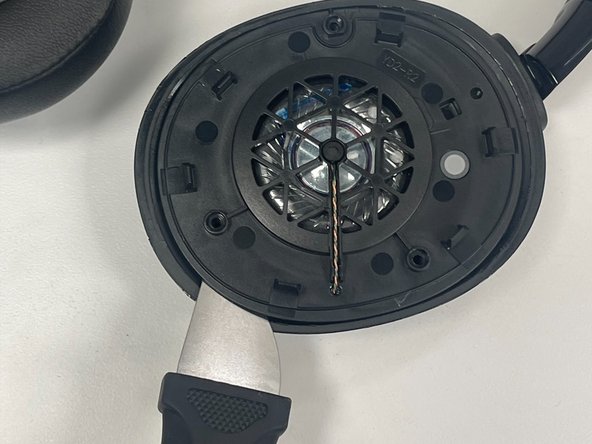

  4. JBL Tune 770NC Speaker Replacement, Speaker: crwdns2935265:04crwdnd2935265:01crwdnd2935265:01crwdne2935265:0
    • Use a Phillips screwdriver to remove the three screws securing the speaker bracket.
  5. JBL Tune 770NC Speaker Replacement: crwdns2935265:05crwdnd2935265:01crwdnd2935265:03crwdne2935265:0 JBL Tune 770NC Speaker Replacement: crwdns2935265:05crwdnd2935265:02crwdnd2935265:03crwdne2935265:0 JBL Tune 770NC Speaker Replacement: crwdns2935265:05crwdnd2935265:03crwdnd2935265:03crwdne2935265:0
    • Insert a Jimmy tool between the speaker bracket and chassis and pry around the perimeter until it fully releases.
    • Remove the speaker bracket.

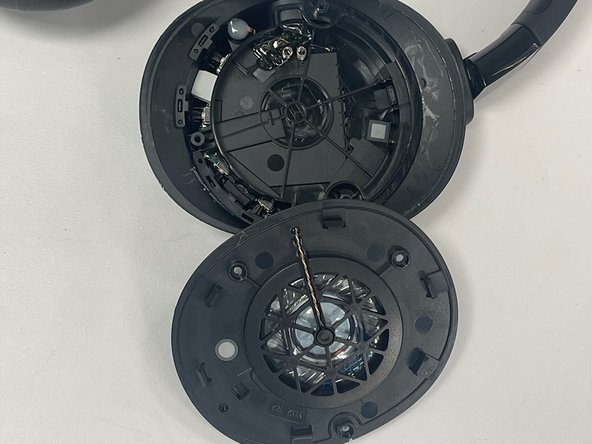

  6. JBL Tune 770NC Speaker Replacement: crwdns2935265:06crwdnd2935265:01crwdnd2935265:01crwdne2935265:0
    • Use tweezers to gently fold back the six clips that are holding the speaker in place.
  7. JBL Tune 770NC Speaker Replacement: crwdns2935265:07crwdnd2935265:01crwdnd2935265:01crwdne2935265:0
    • Rotate the speaker case and push on the front of the speaker using your tweezers, applying moderate force.
  8. JBL Tune 770NC Speaker Replacement: crwdns2935265:08crwdnd2935265:01crwdnd2935265:01crwdne2935265:0
    • Remove the speaker.
    • IMPORTANT: Make sure that you align the new speaker properly, the same way that the old speaker was placed, to ensure proper contact.
