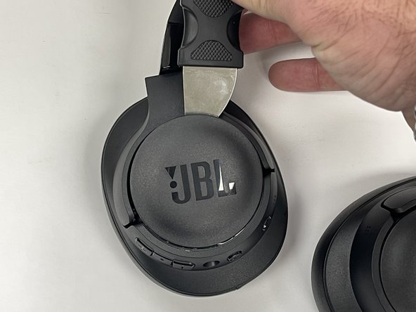

    • Insert a jimmy into the seam between the cap and chassis.
    • Pry around the perimeter of the cap until it fully releases.
    • Remove the cap.

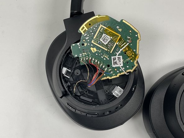

    • Use a Phillips screwdriver to remove the three screws that secure the motherboard.
    • Desolder all of the connected wires.

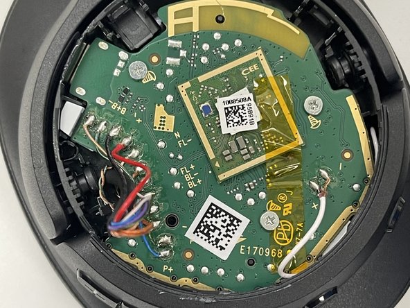

  3. JBL Tune 770NC Motherboard Replacement: crwdns2935265:03crwdnd2935265:01crwdnd2935265:03crwdne2935265:0 JBL Tune 770NC Motherboard Replacement: crwdns2935265:03crwdnd2935265:02crwdnd2935265:03crwdne2935265:0 JBL Tune 770NC Motherboard Replacement: crwdns2935265:03crwdnd2935265:03crwdnd2935265:03crwdne2935265:0
    • Solder on the new motherboard, using the color coded image provided.
