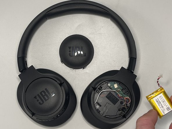

    • Insert a spudger into the seam of the LEFT JBL side plate.
    • Maneuver the tool around side to side in order to loosen the clips inside the plate, working your way around the circular edges.
    • When the plate fully releases, lift it off.

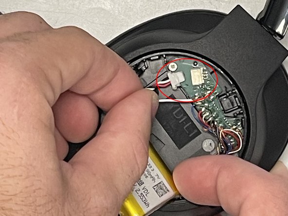

    • Use your fingernails to gently "walk" the battery connector directly out of its socket.
    • The plug may be hot-glued on, but it should disconnect with moderate force.

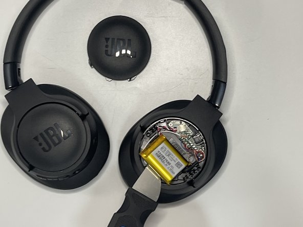

    • Use a spudger to gently pry the battery out of the chassis.
    • Take care not to bend or puncture the battery.
