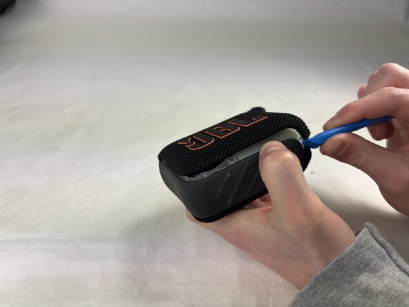

    • Remove the speaker's grille by inserting the tip of an opening tool into the top corner, opposite the strap.
    • Slide the tool along the edge of the housing until it pops off. Place it to the side.
    • Be sure that the battery has been drained completely before attempting this replacement.

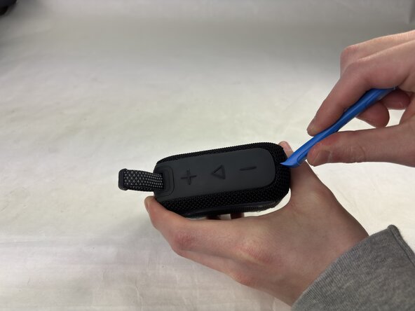

    • Insert the same opening tool in the opposite corner, lifting carefully.
    • Slide the tool along the edge until the cover pops off.

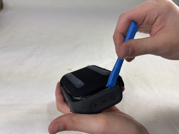

    • Gently pull the housing up and to the side.
    • When the plate becomes loose, be incredibly gentle to avoid damaging the cable that connects the battery to the housing.

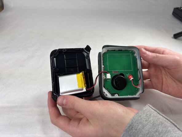

  3. JBL Go 4 Outer Shell Replacement: crwdns2935265:03crwdnd2935265:01crwdnd2935265:01crwdne2935265:0
    • At this point, you should switch over to the JBL Go 4 Battery Replacement, and follow the steps to remove the battery
    • Once the battery is removed, use a strong adhesive to adhere it to the new shell and follow the steps in reverse.
