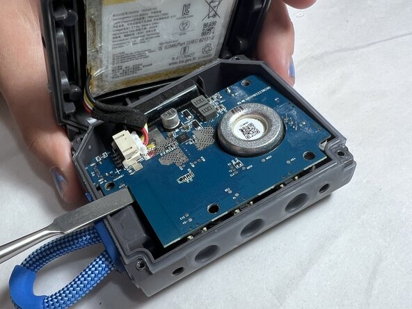

    • Using an iFixit Opening Pick or a Jimmy, pry along the seam between the rubber outer layer and the hard shell.
    • Work your way around the edges until the shell loosens and can be fully removed.
  2. JBL Go 3 Motherboard Replacement: crwdns2935265:02crwdnd2935265:01crwdnd2935265:03crwdne2935265:0 JBL Go 3 Motherboard Replacement: crwdns2935265:02crwdnd2935265:02crwdnd2935265:03crwdne2935265:0 JBL Go 3 Motherboard Replacement: crwdns2935265:02crwdnd2935265:03crwdnd2935265:03crwdne2935265:0
    • Once the shell is loosened on all sides, gently lift and remove it completely.
    • Align the new shell with the speaker’s body, making sure all edges are properly positioned.
    • Press firmly around the edges until the shell snaps securely into place.

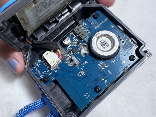

  3. JBL Go 3 Motherboard Replacement, Motherboard: crwdns2935265:03crwdnd2935265:01crwdnd2935265:02crwdne2935265:0 JBL Go 3 Motherboard Replacement, Motherboard: crwdns2935265:03crwdnd2935265:02crwdnd2935265:02crwdne2935265:0
    • Locate the internal screws underneath the outer shell.
    • Use your precision screwdriver to remove all screws securing the plastic enclosure.
    • Carefully lift the casing to expose the motherboard and other internal components.
  4. JBL Go 3 Motherboard Replacement: crwdns2935265:04crwdnd2935265:01crwdnd2935265:02crwdne2935265:0 JBL Go 3 Motherboard Replacement: crwdns2935265:04crwdnd2935265:02crwdnd2935265:02crwdne2935265:0
    • Unscrew the motherboard to the internal casing of the speaker.
    • Unscrew the speaker attached to the casing as well.
    • The speaker and part of the battery may be soldered onto the motherboard, proceed with caution when removing attachments
