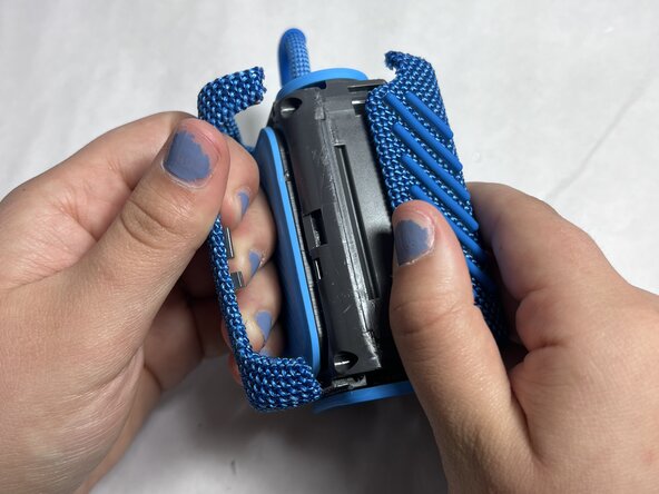

    • Hold the power button until the JBL Go 3 shuts off
    • Disconnect any charging cables
    • Use jimmy to remove the hard shell
    • Work your way around the edges slowly—be patient as it's glued or snapped in tightly

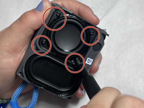

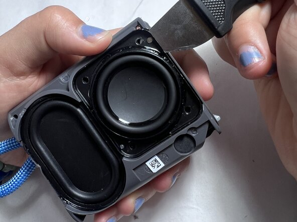

    • Once the hard shell is removed,use jimmy to lift up the speaker part.
    • Locate the internal screws underneath the outer shell.
    • Use your precision screwdriver to remove all screws securing the plastic enclosure.
    • Carefully lift the casing to expose the speaker and other internal components.
