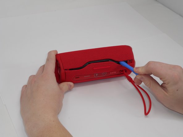

    • Using the iFixit opening tool, pry up on the button side of the slot on the case until the clips release.

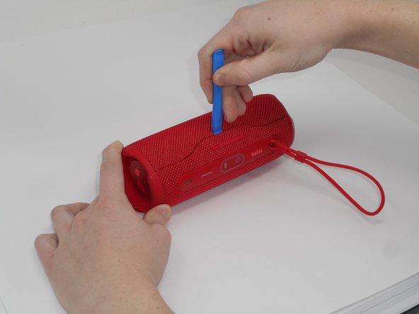

    • Now that the gap is larger, using the same tool, pry up on the other side until the clips release.

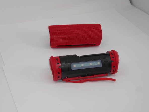

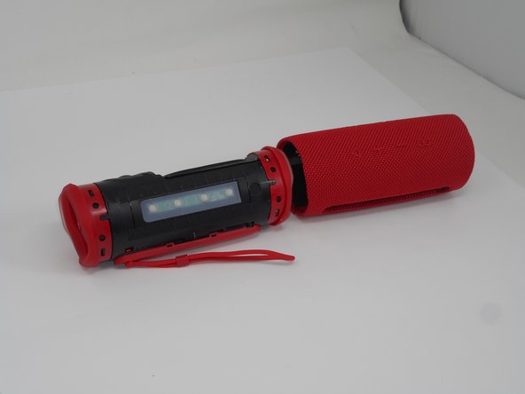

  3. JBL Flip 6 Woofer Replacement: crwdns2935265:03crwdnd2935265:01crwdnd2935265:03crwdne2935265:0 JBL Flip 6 Woofer Replacement: crwdns2935265:03crwdnd2935265:02crwdnd2935265:03crwdne2935265:0 JBL Flip 6 Woofer Replacement: crwdns2935265:03crwdnd2935265:03crwdnd2935265:03crwdne2935265:0
    • With all clips released, slide the case off longways.
    • You may need to spread it a bit with your hands so that the clips do not become caught on the end pieces.

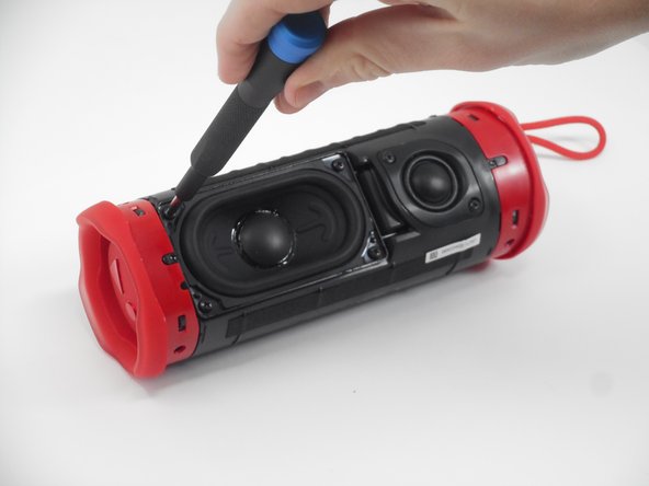

  4. JBL Flip 6 Woofer Replacement, Woofer: crwdns2935265:04crwdnd2935265:01crwdnd2935265:03crwdne2935265:0 JBL Flip 6 Woofer Replacement, Woofer: crwdns2935265:04crwdnd2935265:02crwdnd2935265:03crwdne2935265:0 JBL Flip 6 Woofer Replacement, Woofer: crwdns2935265:04crwdnd2935265:03crwdnd2935265:03crwdne2935265:0
    • Remove the four 9.5 mm Philips #1 screws securing the woofer to the device.

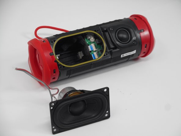

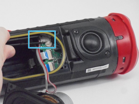

  5. JBL Flip 6 Woofer Replacement: crwdns2935265:05crwdnd2935265:01crwdnd2935265:03crwdne2935265:0 JBL Flip 6 Woofer Replacement: crwdns2935265:05crwdnd2935265:02crwdnd2935265:03crwdne2935265:0 JBL Flip 6 Woofer Replacement: crwdns2935265:05crwdnd2935265:03crwdnd2935265:03crwdne2935265:0
    • Carefully disconnect the white connector linking the woofer and the motherboard.
    • If there is a lot of resistance when removing the plug, there could be a clip holding it in place. Check for any sort of fasteners before using much strength as you could damage the motherboard.
