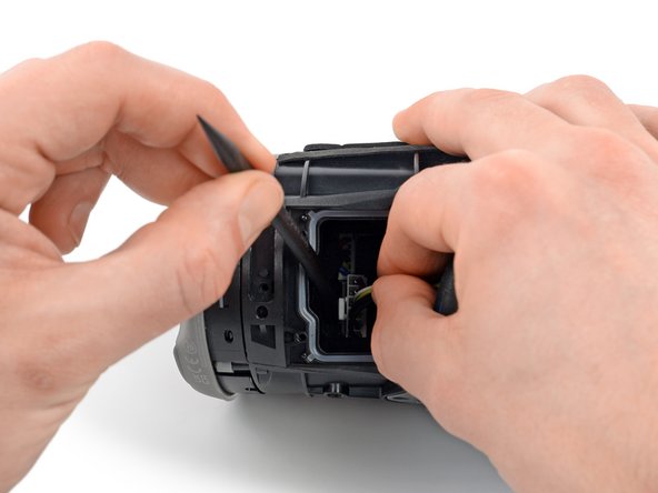

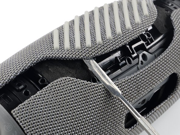

  1. JBL Charge 5 Motherboard Replacement, Pry up the fabric cover: crwdns2935265:01crwdnd2935265:01crwdnd2935265:03crwdne2935265:0 JBL Charge 5 Motherboard Replacement, Pry up the fabric cover: crwdns2935265:01crwdnd2935265:02crwdnd2935265:03crwdne2935265:0 JBL Charge 5 Motherboard Replacement, Pry up the fabric cover: crwdns2935265:01crwdnd2935265:03crwdnd2935265:03crwdne2935265:0
    • Before starting repairs, turn off your device and unplug any cables.
    • Depending on the model, some fabric covers are secured only by plastic clips, while others use both plastic clips and screws.
    • Begin prying only on the edge shown in the photos. Otherwise, you run the risk of damaging the fabric cover's clips if your model's cover is also secured with screws.
    • Insert the flat end of a metal spudger into the seam between the two halves of the fabric cover.
    • Push the spudger underneath the edge of the fabric cover without the textured rubber and pry upwards to release its plastic clips.
  2. JBL Charge 5 Motherboard Replacement, Release the plastic clips: crwdns2935265:02crwdnd2935265:01crwdnd2935265:03crwdne2935265:0 JBL Charge 5 Motherboard Replacement, Release the plastic clips: crwdns2935265:02crwdnd2935265:02crwdnd2935265:03crwdne2935265:0 JBL Charge 5 Motherboard Replacement, Release the plastic clips: crwdns2935265:02crwdnd2935265:03crwdnd2935265:03crwdne2935265:0
    • Repeat the previous step, using your spudger to work your way along the entire seam to release the remaining plastic clips.

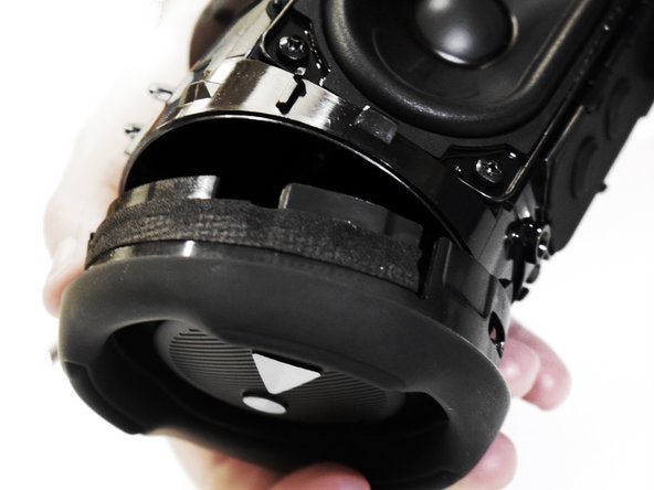

  4. JBL Charge 5 Motherboard Replacement, Pry up the fabric cover's other side: crwdns2935265:04crwdnd2935265:01crwdnd2935265:03crwdne2935265:0 JBL Charge 5 Motherboard Replacement, Pry up the fabric cover's other side: crwdns2935265:04crwdnd2935265:02crwdnd2935265:03crwdne2935265:0 JBL Charge 5 Motherboard Replacement, Pry up the fabric cover's other side: crwdns2935265:04crwdnd2935265:03crwdnd2935265:03crwdne2935265:0
    • Use your metal spudger to pry up the other edge of the fabric cover—the side with the textured rubber—to release the remaining plastic clips.

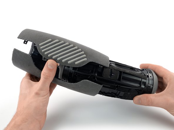

  5. JBL Charge 5 Motherboard Replacement, Remove the fabric cover: crwdns2935265:05crwdnd2935265:01crwdnd2935265:03crwdne2935265:0 JBL Charge 5 Motherboard Replacement, Remove the fabric cover: crwdns2935265:05crwdnd2935265:02crwdnd2935265:03crwdne2935265:0 JBL Charge 5 Motherboard Replacement, Remove the fabric cover: crwdns2935265:05crwdnd2935265:03crwdnd2935265:03crwdne2935265:0
    • Use one hand to spread the edges of the fabric cover apart and your other hand to pull the speaker assembly away from the cover.
    • Remove the fabric cover.

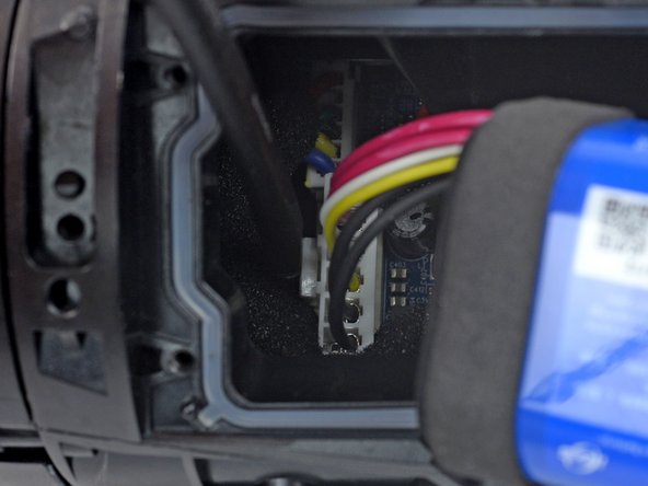

  9. JBL Charge 5 Motherboard Replacement, Battery connector information: crwdns2935265:09crwdnd2935265:01crwdnd2935265:03crwdne2935265:0 JBL Charge 5 Motherboard Replacement, Battery connector information: crwdns2935265:09crwdnd2935265:02crwdnd2935265:03crwdne2935265:0 JBL Charge 5 Motherboard Replacement, Battery connector information: crwdns2935265:09crwdnd2935265:03crwdnd2935265:03crwdne2935265:0
    • The battery is connected to the motherboard with a power cable connector that has a small tab on the side that locks it in place.
    • To release a connector like this you need to squeeze the tab against the connector, and pull the connector straight up from its socket to disconnect the battery.
  10. JBL Charge 5 Motherboard Replacement, Disconnect the battery: crwdns2935265:010crwdnd2935265:01crwdnd2935265:03crwdne2935265:0 JBL Charge 5 Motherboard Replacement, Disconnect the battery: crwdns2935265:010crwdnd2935265:02crwdnd2935265:03crwdne2935265:0 JBL Charge 5 Motherboard Replacement, Disconnect the battery: crwdns2935265:010crwdnd2935265:03crwdnd2935265:03crwdne2935265:0
    • Insert a plastic spudger into the battery connector cutout.
    • Use your spudger to squeeze the tab against the connector to release it.
    • Use your free hand to grab the battery cables just above the connector and pull the connector straight up from its socket wiggling it left and right to loosen the clips securing it.

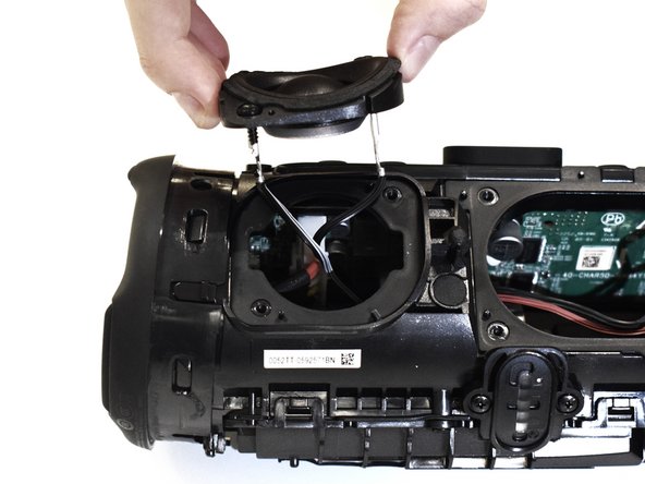

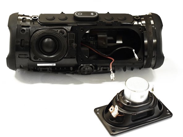

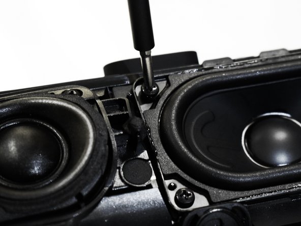

  12. JBL Charge 5 Motherboard Replacement, Speakers: crwdns2935265:012crwdnd2935265:01crwdnd2935265:03crwdne2935265:0 JBL Charge 5 Motherboard Replacement, Speakers: crwdns2935265:012crwdnd2935265:02crwdnd2935265:03crwdne2935265:0 JBL Charge 5 Motherboard Replacement, Speakers: crwdns2935265:012crwdnd2935265:03crwdnd2935265:03crwdne2935265:0
    • Using a Phillips #1 screwdriver, remove the four 16.5 mm screws on the corners around the oval speaker.

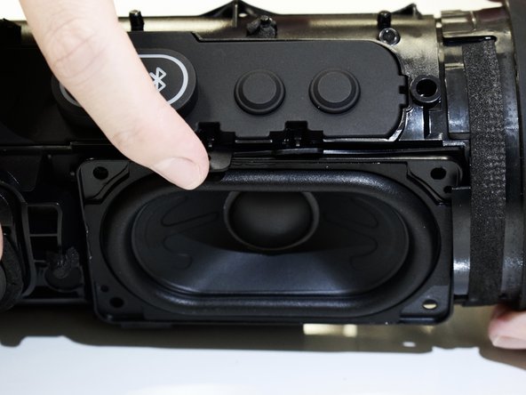

  13. JBL Charge 5 Motherboard Replacement: crwdns2935265:013crwdnd2935265:01crwdnd2935265:03crwdne2935265:0 JBL Charge 5 Motherboard Replacement: crwdns2935265:013crwdnd2935265:02crwdnd2935265:03crwdne2935265:0 JBL Charge 5 Motherboard Replacement: crwdns2935265:013crwdnd2935265:03crwdnd2935265:03crwdne2935265:0
    • Gently use your hands to undo the flaps located at the top of the speaker.
    • Grip the speaker on the top and bottom left of the square platform.
    • Gently remove the speaker from the casing.
    • Be careful of the wires attached to the back of the speaker when removing.

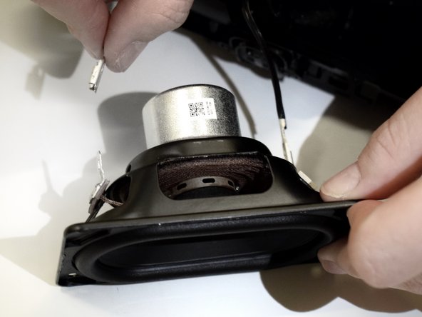

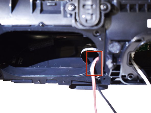

  14. JBL Charge 5 Motherboard Replacement: crwdns2935265:014crwdnd2935265:01crwdnd2935265:03crwdne2935265:0 JBL Charge 5 Motherboard Replacement: crwdns2935265:014crwdnd2935265:02crwdnd2935265:03crwdne2935265:0 JBL Charge 5 Motherboard Replacement: crwdns2935265:014crwdnd2935265:03crwdnd2935265:03crwdne2935265:0
    • Holding the speaker firmly in place, gently remove the red wire from the speaker by pinching it at the silver base near the connection and pulling.
  15. JBL Charge 5 Motherboard Replacement: crwdns2935265:015crwdnd2935265:01crwdnd2935265:02crwdne2935265:0 JBL Charge 5 Motherboard Replacement: crwdns2935265:015crwdnd2935265:02crwdnd2935265:02crwdne2935265:0
    • Repeat the previous step for the black wire.

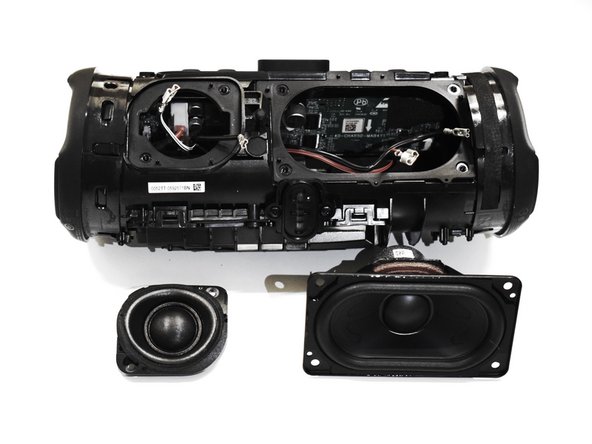

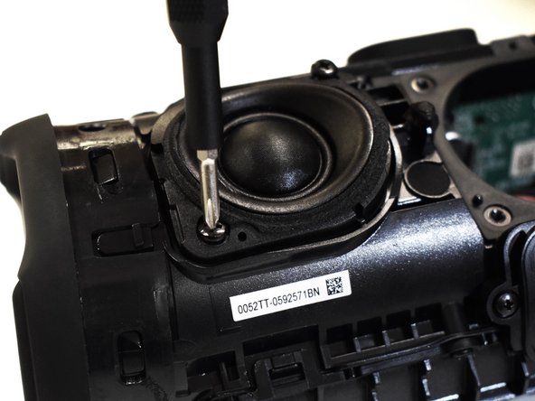

  16. JBL Charge 5 Motherboard Replacement: crwdns2935265:016crwdnd2935265:01crwdnd2935265:03crwdne2935265:0 JBL Charge 5 Motherboard Replacement: crwdns2935265:016crwdnd2935265:02crwdnd2935265:03crwdne2935265:0 JBL Charge 5 Motherboard Replacement: crwdns2935265:016crwdnd2935265:03crwdnd2935265:03crwdne2935265:0
    • Using a Phillips #1 screwdriver, remove the two 16.5 mm screws in the small round speaker's top right and bottom left corners.
    • Gently use your hands to grip the speaker and remove it from the device.
  17. JBL Charge 5 Motherboard Replacement: crwdns2935265:017crwdnd2935265:01crwdnd2935265:02crwdne2935265:0 JBL Charge 5 Motherboard Replacement: crwdns2935265:017crwdnd2935265:02crwdnd2935265:02crwdne2935265:0
    • Pinch the white wire gently at the silver base near the connection.
    • Carefully disconnect the wire from the speaker by pulling it.
  18. JBL Charge 5 Motherboard Replacement: crwdns2935265:018crwdnd2935265:01crwdnd2935265:02crwdne2935265:0 JBL Charge 5 Motherboard Replacement: crwdns2935265:018crwdnd2935265:02crwdnd2935265:02crwdne2935265:0
    • Repeat the previous steps for the black wire.
    • Both speakers should be properly detached.

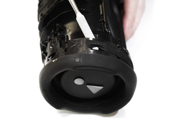

  19. JBL Charge 5 Motherboard Replacement, Passive Bass Radiators: crwdns2935265:019crwdnd2935265:01crwdnd2935265:03crwdne2935265:0 JBL Charge 5 Motherboard Replacement, Passive Bass Radiators: crwdns2935265:019crwdnd2935265:02crwdnd2935265:03crwdne2935265:0 JBL Charge 5 Motherboard Replacement, Passive Bass Radiators: crwdns2935265:019crwdnd2935265:03crwdnd2935265:03crwdne2935265:0
    • Using a spudger, pry the radiator off of the frame of the device.
    • Repeat on the other side if necessary.

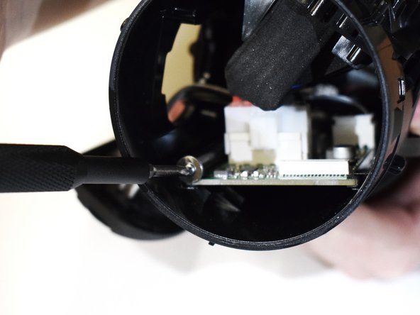

  20. JBL Charge 5 Motherboard Replacement, Motherboard: crwdns2935265:020crwdnd2935265:01crwdnd2935265:03crwdne2935265:0 JBL Charge 5 Motherboard Replacement, Motherboard: crwdns2935265:020crwdnd2935265:02crwdnd2935265:03crwdne2935265:0 JBL Charge 5 Motherboard Replacement, Motherboard: crwdns2935265:020crwdnd2935265:03crwdnd2935265:03crwdne2935265:0
    • Use a Phillips #0 screwdriver to remove the single 10.6 mm screw.

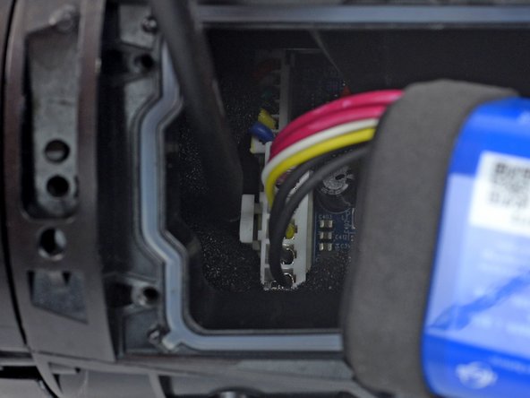

  22. JBL Charge 5 Motherboard Replacement: crwdns2935265:022crwdnd2935265:01crwdnd2935265:01crwdne2935265:0
    • Softly pinch the white connector to release and pull out the foam-covered cable with a blue tip from the motherboard.
  23. JBL Charge 5 Motherboard Replacement: crwdns2935265:023crwdnd2935265:01crwdnd2935265:01crwdne2935265:0
    • Carefully pull the bundled cable with the red-wrapped wires from the connector.
    • Ensure that the wires are pulled on evenly so that no wires are strained.

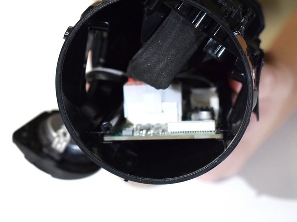

  24. JBL Charge 5 Motherboard Replacement: crwdns2935265:024crwdnd2935265:01crwdnd2935265:02crwdne2935265:0 JBL Charge 5 Motherboard Replacement: crwdns2935265:024crwdnd2935265:02crwdnd2935265:02crwdne2935265:0
    • Pull out the motherboard until a ribbon cable is revealed on the underside of the board.
    • Do not remove the motherboard completely; there is a connected cable that becomes visible once the motherboard is partially removed.
    • Disconnect the ribbon connector on the underside of the motherboard by pinching it with two fingers and pulling it out.

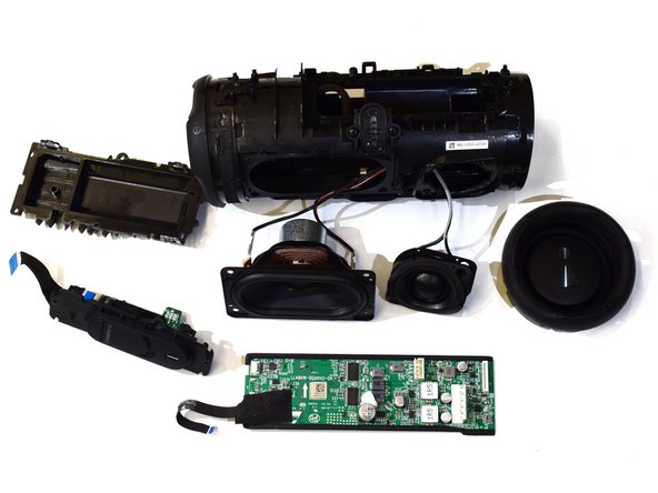

  25. JBL Charge 5 Motherboard Replacement: crwdns2935265:025crwdnd2935265:01crwdnd2935265:02crwdne2935265:0 JBL Charge 5 Motherboard Replacement: crwdns2935265:025crwdnd2935265:02crwdnd2935265:02crwdne2935265:0
    • Slide the motherboard out of the device to remove it.
