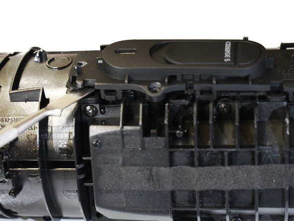

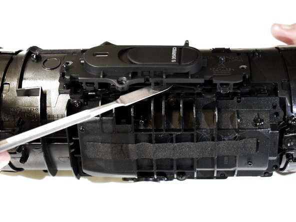

    • Use the opening tool or spudger to undo the clips.
    • Do not immediately remove the charging port.

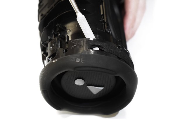

  6. JBL Charge 5 Charging Port Assembly Replacement: crwdns2935265:06crwdnd2935265:01crwdnd2935265:03crwdne2935265:0 JBL Charge 5 Charging Port Assembly Replacement: crwdns2935265:06crwdnd2935265:02crwdnd2935265:03crwdne2935265:0 JBL Charge 5 Charging Port Assembly Replacement: crwdns2935265:06crwdnd2935265:03crwdnd2935265:03crwdne2935265:0

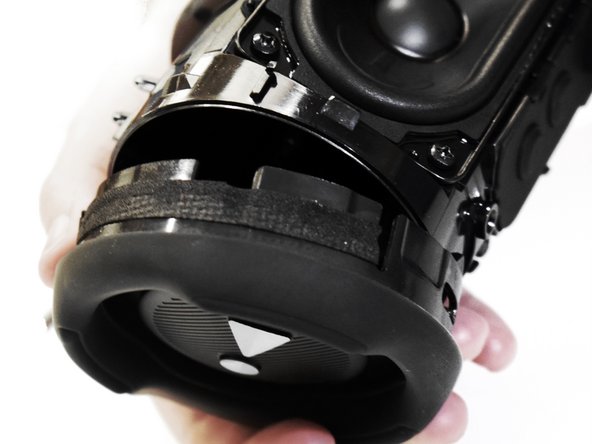

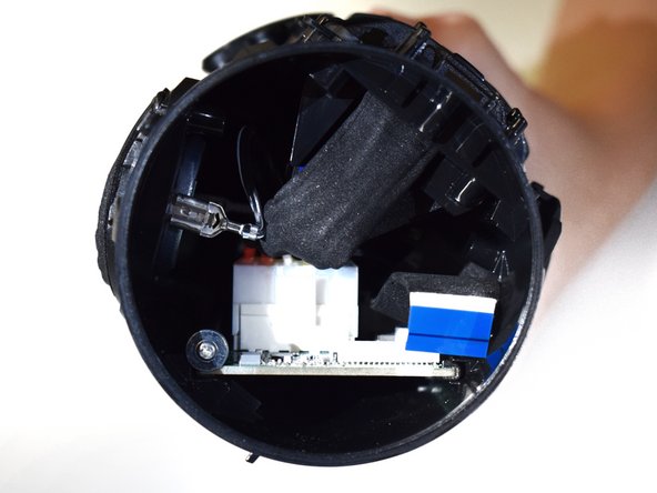

    • Rotate the device to the left, and push the left passive bass radiator off of the frame of the device using the metal spudger.

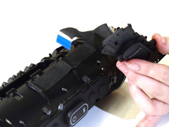

  7. JBL Charge 5 Charging Port Assembly Replacement: crwdns2935265:07crwdnd2935265:01crwdnd2935265:03crwdne2935265:0 JBL Charge 5 Charging Port Assembly Replacement: crwdns2935265:07crwdnd2935265:02crwdnd2935265:03crwdne2935265:0 JBL Charge 5 Charging Port Assembly Replacement: crwdns2935265:07crwdnd2935265:03crwdnd2935265:03crwdne2935265:0

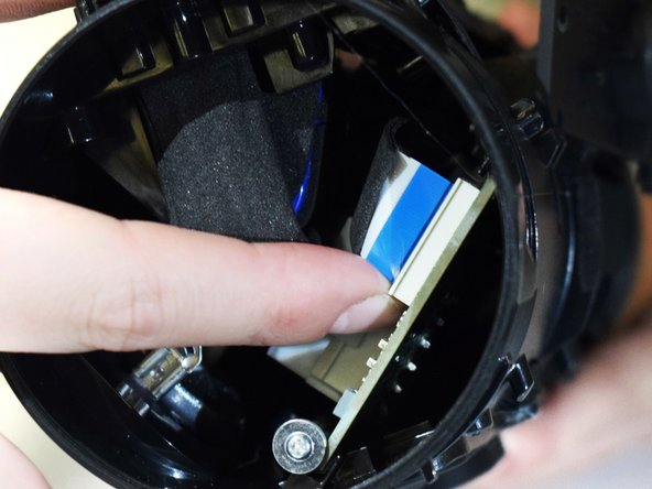

    • Pinch the charging port connector and gently remove the blue and black no-fuss ribbon cable from the board.
    • Pinch the connector with both fingers when removing it to ensure the ribbon cable will not tear.
  8. JBL Charge 5 Charging Port Assembly Replacement: crwdns2935265:08crwdnd2935265:01crwdnd2935265:03crwdne2935265:0 JBL Charge 5 Charging Port Assembly Replacement: crwdns2935265:08crwdnd2935265:02crwdnd2935265:03crwdne2935265:0 JBL Charge 5 Charging Port Assembly Replacement: crwdns2935265:08crwdnd2935265:03crwdnd2935265:03crwdne2935265:0

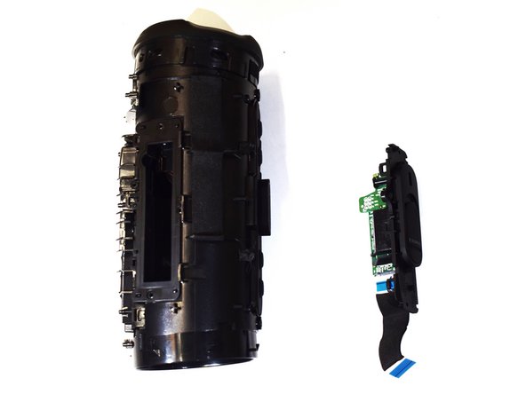

    • Using both fingers, remove the charging port assembly.
