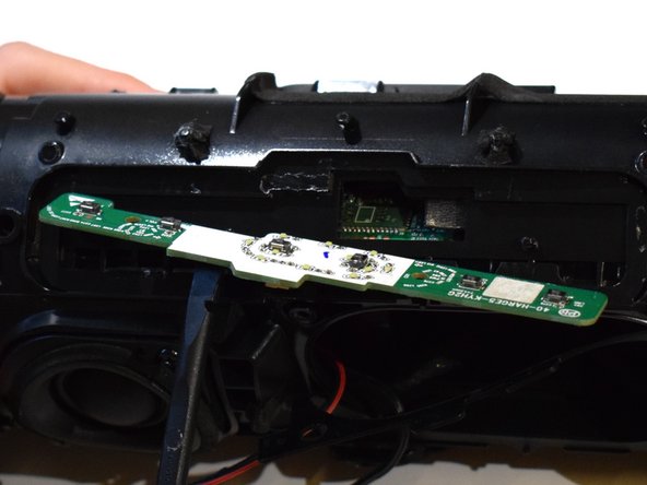

  5. JBL Charge 5 Buttons Replacement: crwdns2935265:05crwdnd2935265:01crwdnd2935265:03crwdne2935265:0 JBL Charge 5 Buttons Replacement: crwdns2935265:05crwdnd2935265:02crwdnd2935265:03crwdne2935265:0 JBL Charge 5 Buttons Replacement: crwdns2935265:05crwdnd2935265:03crwdnd2935265:03crwdne2935265:0
    • Use a plastic spudger, and softly pry up on the sides of the button control board to remove it from the slot.
    • Be cautious and don't pull the board all of the way out. The board is connected to the device by a ribbon cable.

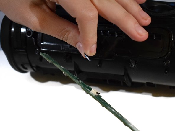

  6. JBL Charge 5 Buttons Replacement: crwdns2935265:06crwdnd2935265:01crwdnd2935265:03crwdne2935265:0 JBL Charge 5 Buttons Replacement: crwdns2935265:06crwdnd2935265:02crwdnd2935265:03crwdne2935265:0 JBL Charge 5 Buttons Replacement: crwdns2935265:06crwdnd2935265:03crwdnd2935265:03crwdne2935265:0
    • Pinch the no-fuss ribbon cable connector, and gently pull the cable out to disconnect it from the board.
    • Remove the button board.
