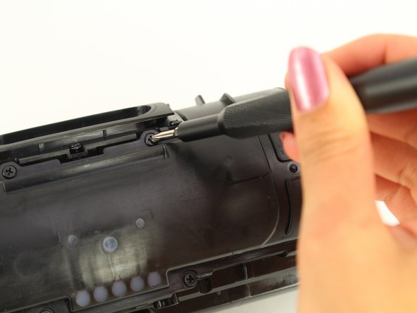

    1. JBL Charge 4 Battery Replacement, Battery: crwdns2935265:06crwdnd2935265:01crwdnd2935265:02crwdne2935265:0 JBL Charge 4 Battery Replacement, Battery: crwdns2935265:06crwdnd2935265:02crwdnd2935265:02crwdne2935265:0
      • Remove the two 6mm Phillips #0 screws on the front side of the port bay cover.
