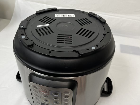

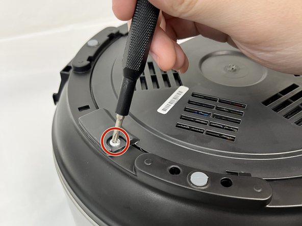

    • Ensure the device is unplugged and cool before beginning.
    • Remove the lid and inner pot from the Instant Pot and turn the body upside down.
    • Remove the single Torx screw.
  2. Instant Pot 60 EPC Circuit Board Replacement: crwdns2935265:02crwdnd2935265:01crwdnd2935265:02crwdne2935265:0 Instant Pot 60 EPC Circuit Board Replacement: crwdns2935265:02crwdnd2935265:02crwdnd2935265:02crwdne2935265:0
    • Turn the bottom face counterclockwise and remove it.

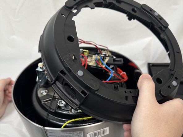

    • In order to reach the circuit board you'll need to remove the secondary frame surrounding it.
    • Remove the three Phillips screws securing the frame.
    • Lift the frame, twist and set next to the body. Take care not to damage any of the attached wiring.

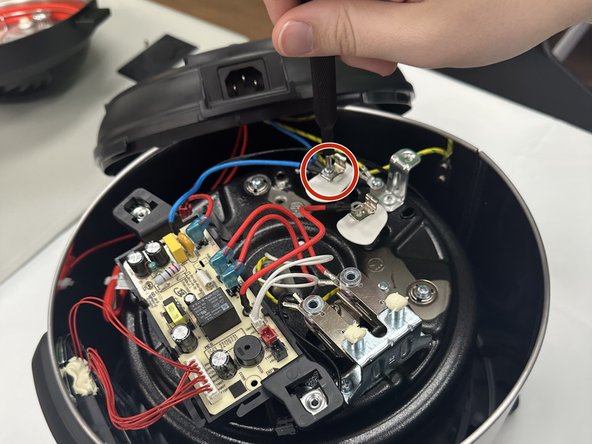

  4. Instant Pot 60 EPC Circuit Board Replacement: crwdns2935265:04crwdnd2935265:01crwdnd2935265:03crwdne2935265:0 Instant Pot 60 EPC Circuit Board Replacement: crwdns2935265:04crwdnd2935265:02crwdnd2935265:03crwdne2935265:0 Instant Pot 60 EPC Circuit Board Replacement: crwdns2935265:04crwdnd2935265:03crwdnd2935265:03crwdne2935265:0
    • Depress the latch securing the red connector and disconnect it.
    • Repeat the previous bullet for the white and black connectors.
    • It can be helpful to gently rock them back and forth while pulling up.

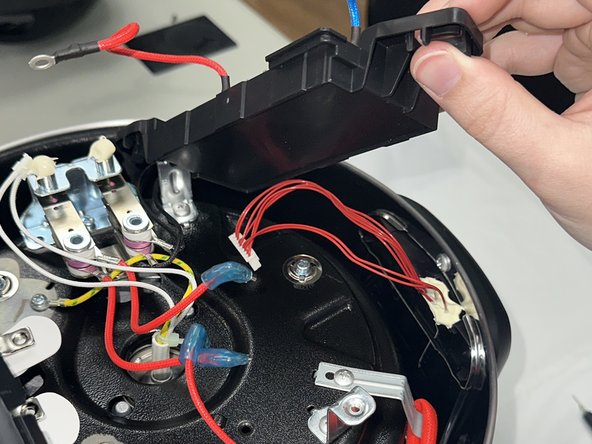

  5. Instant Pot 60 EPC Circuit Board Replacement: crwdns2935265:05crwdnd2935265:01crwdnd2935265:02crwdne2935265:0 Instant Pot 60 EPC Circuit Board Replacement: crwdns2935265:05crwdnd2935265:02crwdnd2935265:02crwdne2935265:0
    • Use a Phillips screwdriver to remove the two screws holding each of the two leads in place.

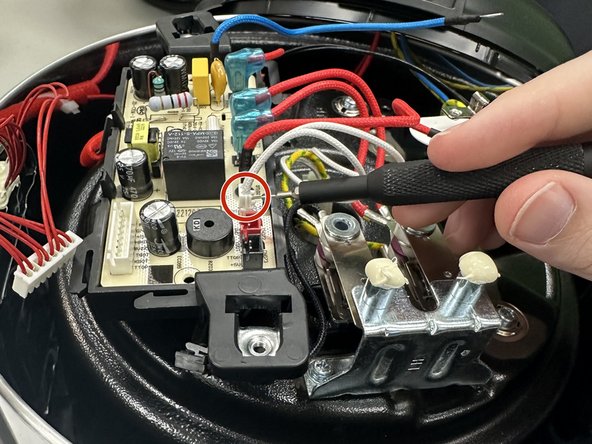

  6. Instant Pot 60 EPC Circuit Board Replacement: crwdns2935265:06crwdnd2935265:01crwdnd2935265:02crwdne2935265:0 Instant Pot 60 EPC Circuit Board Replacement: crwdns2935265:06crwdnd2935265:02crwdnd2935265:02crwdne2935265:0

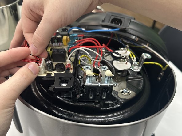

    • Gently walk the 8x1 pin connector out of its socket.
    • It may be helpful to also rock the plug side to side while pulling up.

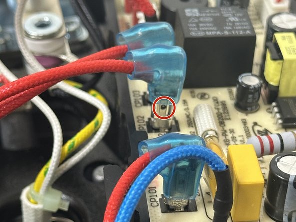

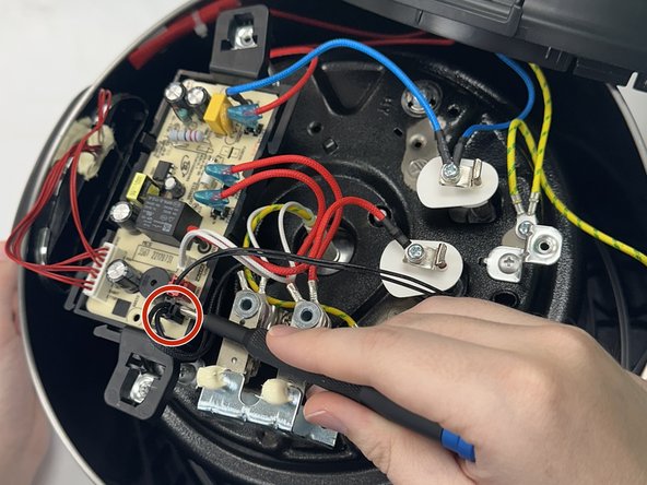

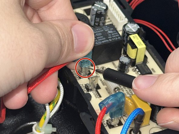

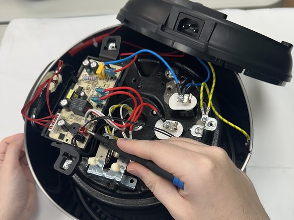

  7. Instant Pot 60 EPC Circuit Board Replacement: crwdns2935265:07crwdnd2935265:01crwdnd2935265:03crwdne2935265:0 Instant Pot 60 EPC Circuit Board Replacement: crwdns2935265:07crwdnd2935265:02crwdnd2935265:03crwdne2935265:0 Instant Pot 60 EPC Circuit Board Replacement: crwdns2935265:07crwdnd2935265:03crwdnd2935265:03crwdne2935265:0
    • Slide the blue sheathing up to expose the small hole in the lead.
    • Place a SIM card punch into the hole to unsecure the leads and pull them up. If a SIM card punch is not available, then a paperclip or earring should suffice.
    • Repeat for the other two leads.
