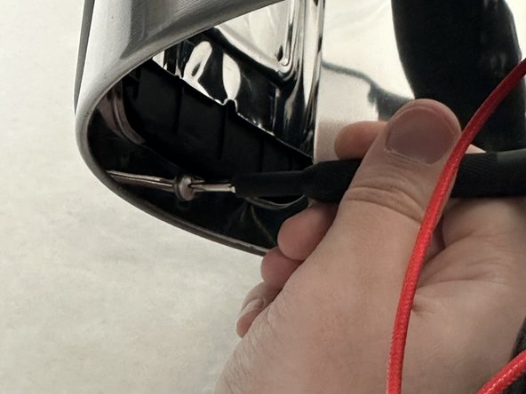

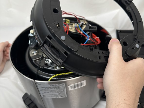

    • Ensure the device is unplugged and cool before beginning.
    • Remove the lid and inner pot from the Instant Pot and turn the body upside down.
    • Remove the single Torx screw.

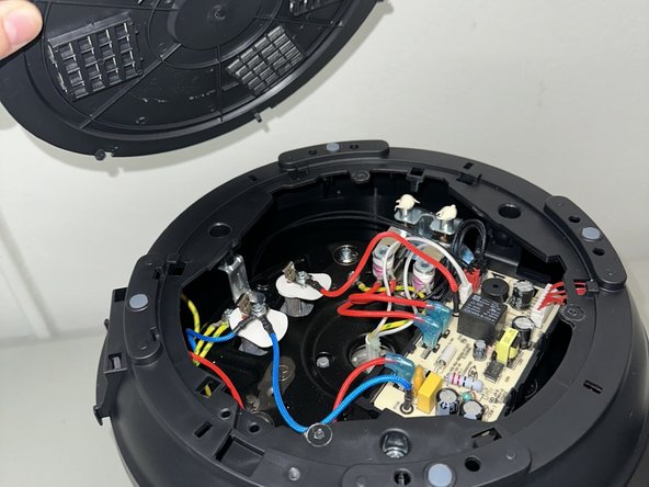

  2. Instant Pot 60 EPC Button Panel Replacement: crwdns2935265:02crwdnd2935265:01crwdnd2935265:02crwdne2935265:0 Instant Pot 60 EPC Button Panel Replacement: crwdns2935265:02crwdnd2935265:02crwdnd2935265:02crwdne2935265:0
    • Turn the bottom face counterclockwise and remove it.
  3. Instant Pot 60 EPC Button Panel Replacement: crwdns2935265:03crwdnd2935265:01crwdnd2935265:02crwdne2935265:0 Instant Pot 60 EPC Button Panel Replacement: crwdns2935265:03crwdnd2935265:02crwdnd2935265:02crwdne2935265:0
    • In order to reach the circuit board you'll need to remove the secondary frame surrounding it.
    • Remove the three Phillips screws securing the frame.
    • Lift the frame, twist and set next to the body. Take care not to damage any of the attached wiring.

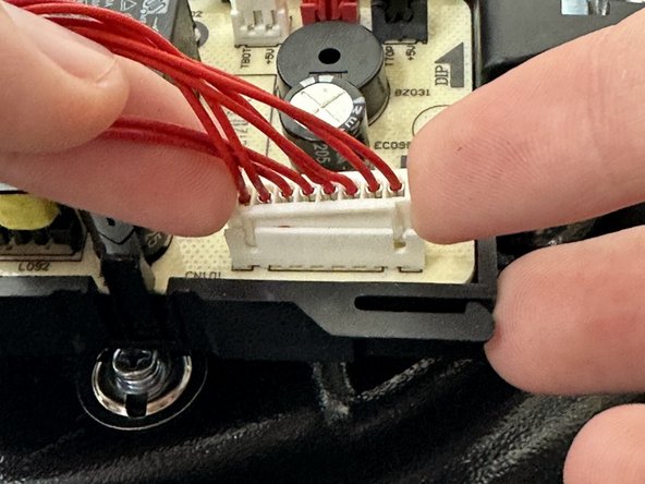

  4. Instant Pot 60 EPC Button Panel Replacement: crwdns2935265:04crwdnd2935265:01crwdnd2935265:02crwdne2935265:0 Instant Pot 60 EPC Button Panel Replacement: crwdns2935265:04crwdnd2935265:02crwdnd2935265:02crwdne2935265:0
    • Disconnect the 8x1 pin control connector from the main board.
    • The plug should easily come up when pulled with slight pressure.
    • It may be helpful to also rock the plug side to side while pulling up.

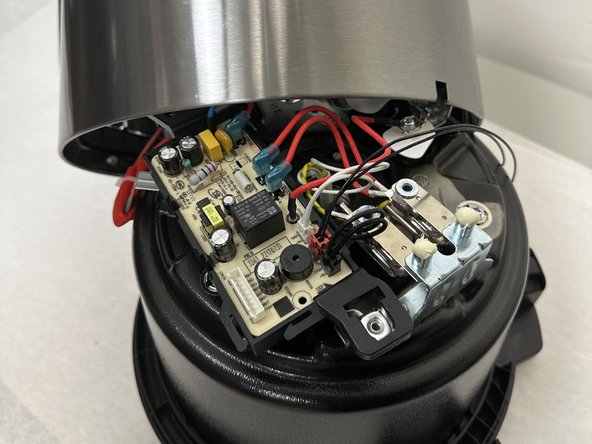

  5. Instant Pot 60 EPC Button Panel Replacement: crwdns2935265:05crwdnd2935265:01crwdnd2935265:01crwdne2935265:0
    • Remove the single screw attaching the front panel to the main body with a Phillips screwdriver.
    • This screw may be difficult to get to; we were able to remove it by threading a screwdriver underneath the main board.

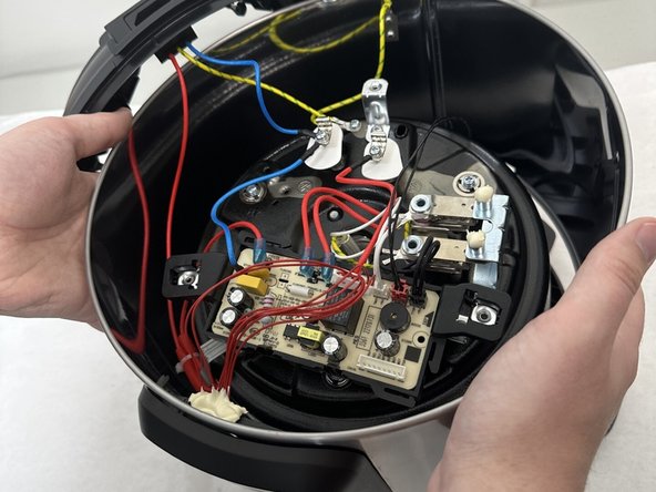

  6. Instant Pot 60 EPC Button Panel Replacement: crwdns2935265:06crwdnd2935265:01crwdnd2935265:03crwdne2935265:0 Instant Pot 60 EPC Button Panel Replacement: crwdns2935265:06crwdnd2935265:02crwdnd2935265:03crwdne2935265:0 Instant Pot 60 EPC Button Panel Replacement: crwdns2935265:06crwdnd2935265:03crwdnd2935265:03crwdne2935265:0
    • Remove the main body from the Instant Pot.
    • It should easily pull up with a little force and be free from the control board.

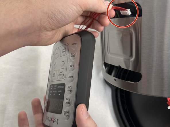

  8. Instant Pot 60 EPC Button Panel Replacement: crwdns2935265:08crwdnd2935265:01crwdnd2935265:02crwdne2935265:0 Instant Pot 60 EPC Button Panel Replacement: crwdns2935265:08crwdnd2935265:02crwdnd2935265:02crwdne2935265:0
    • Pull the front panel away from the body and carefully pull out the wires that connect the front panel to the circuit board.
    • The front panel is now free to be replaced.
