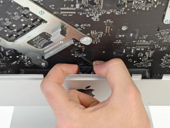

  8. Installing iMac Intel 27" EMC 2390 Dual HDD or SSD Drive: crwdns2935265:08crwdnd2935265:01crwdnd2935265:02crwdne2935265:0 Installing iMac Intel 27" EMC 2390 Dual HDD or SSD Drive: crwdns2935265:08crwdnd2935265:02crwdnd2935265:02crwdne2935265:0
    • Using your fingers, carefully pull the vertical sync cable out of its socket on the LED driver board near the top left corner of your iMac.
    • Be sure to pull the connector parallel to the LED driver board, straight out of its socket.

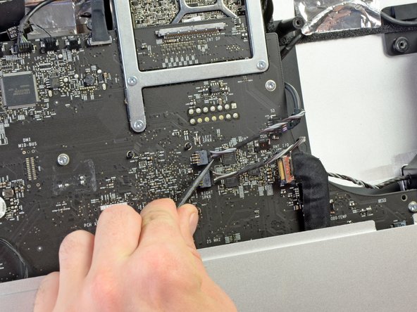

    • Using your fingernails or the flat end of a spudger, remove the three connectors from the right side of the logic board.
    • SD card reader
    • Rear I/O board
    • Left and Right Speakers
  20. Installing iMac Intel 27" EMC 2390 Dual HDD or SSD Drive: crwdns2935265:020crwdnd2935265:01crwdnd2935265:03crwdne2935265:0 Installing iMac Intel 27" EMC 2390 Dual HDD or SSD Drive: crwdns2935265:020crwdnd2935265:02crwdnd2935265:03crwdne2935265:0 Installing iMac Intel 27" EMC 2390 Dual HDD or SSD Drive: crwdns2935265:020crwdnd2935265:03crwdnd2935265:03crwdne2935265:0
    • Remove the six parallel connectors from the top of the logic board using your fingernails, pulling parallel to the logic board.
    • Skin Temperature
    • Hard Drive Temperature
    • Hard Drive Fan
    • Camera
    • Bluetooth
    • Ambient Temperature Sensor
    • Remove the airport cable from the logic board by prying straight up with a spudger.

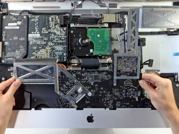

  24. Installing iMac Intel 27" EMC 2390 Dual HDD or SSD Drive: crwdns2935265:024crwdnd2935265:01crwdnd2935265:01crwdne2935265:0
    • Using the flat end of a spudger, remove the SATA power cable from its socket on the hard drive.
  25. Installing iMac Intel 27" EMC 2390 Dual HDD or SSD Drive: crwdns2935265:025crwdnd2935265:01crwdnd2935265:02crwdne2935265:0 Installing iMac Intel 27" EMC 2390 Dual HDD or SSD Drive: crwdns2935265:025crwdnd2935265:02crwdnd2935265:02crwdne2935265:0
    • Simultaneously, lift and rotate the logic board out of the iMac.
    • Do not try to completely remove the logic board. It is still attached by several cables on the back side.
    • Carefully lean the logic board against the front of the iMac, so that it leans out of the iMac.

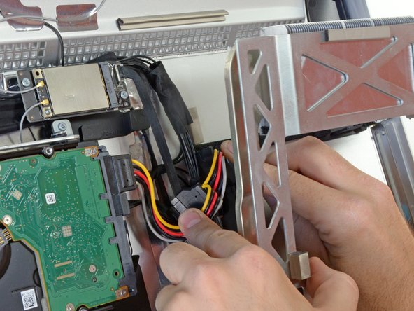

  26. Installing iMac Intel 27" EMC 2390 Dual HDD or SSD Drive: crwdns2935265:026crwdnd2935265:01crwdnd2935265:02crwdne2935265:0 Installing iMac Intel 27" EMC 2390 Dual HDD or SSD Drive: crwdns2935265:026crwdnd2935265:02crwdnd2935265:02crwdne2935265:0
    • Attach the male junction of the SATA power splitter to the original hard drive power cable.
    • Plug one of the branches into the hard drive.
    • The cable is shaped so that it can only be attached in a certain orientation. Do not try to force the cable onto the hard drive.

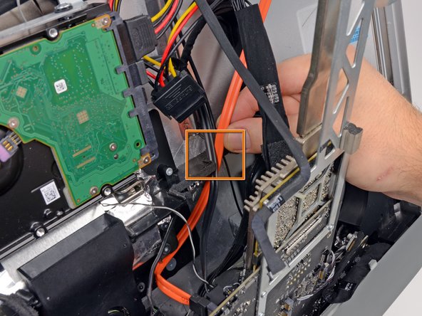

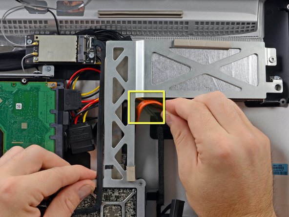

  27. Installing iMac Intel 27" EMC 2390 Dual HDD or SSD Drive: crwdns2935265:027crwdnd2935265:01crwdnd2935265:02crwdne2935265:0 Installing iMac Intel 27" EMC 2390 Dual HDD or SSD Drive: crwdns2935265:027crwdnd2935265:02crwdnd2935265:02crwdne2935265:0
    • Carefully route the other branch of the SATA power splitter underneath the GPU heat sink.
    • There is a cutaway in the plastic near the optical drive frame. Route the power cable through this cutaway.
